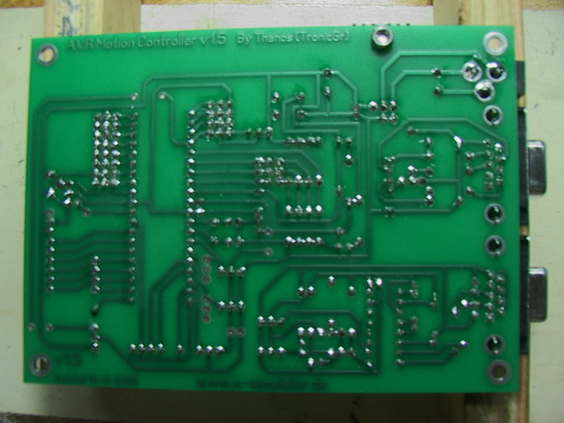

  14. yobuddy
    51,664Coins
    +5,204 / 19 / -0
    Hi Buddy,
    Do you have another way to program your chip?
    If you could find a way, we could figure out if the problem is in the AMC or the programmer part of it.
    Could you post a hi-rez picture of the back of your AMC?
    Did you solder your transistors or did you socket them?
    Sometimes it's easier to find errors with a picture.
    What crystal are you tying to program with? and does it have the right buddy cap's to go with it?
    Like 2 18pf cap’s for the 22mghz crystal?
    I'll try to think of more to help. :cheers:

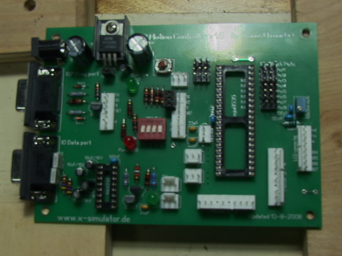

  15. jsmith2307
    jsmith2307 Member
    Oct 2, 2010
    105
    Respiratory Therapist
    Corpus Christi, Texas
    324Coins
    +7 / 0 / -0
    2DOF, DC motor, Arduino, Joyrider, Motion platform
    Hello There,
    Thanks for your response! I do have another computer running the same os, XP, and I get the same response. I think that rules out out problems with the Ponyprog. I have a couple of pics I'll post. Also transistors were solderd, as were the caps, that will change over to sockets. Should I change all 3 transistors over to the sockets and which two caps do I socket, the two caps between the jumpers and the crystal ? I coupled a 22pf cap with 18.xxxx mghz. for the test attempt. :)
  16. jsmith2307
    jsmith2307 Member
    Oct 2, 2010
    105
    324Coins
    +7 / 0 / -0
    Gents,
    I've replaced Atmega8535 16pu x 2 , transistors socketed & exchanged (BC547) 3 each, exchanged 18.432 MHZ (markings on the piece A1840KX) crystal x 2, exchanged and socketed 22pf capacitors, almost a complete rebuild of the avr and still get the same Missing or unknown device (-24) The only capacitors a have not changed out a the two beside the choke and the varible resistor, and the large ones around the voltage regulator. I still get the leds illuminated when I power it up! I've also changed computers, NO LUCK! I need some more ideas...please. :(

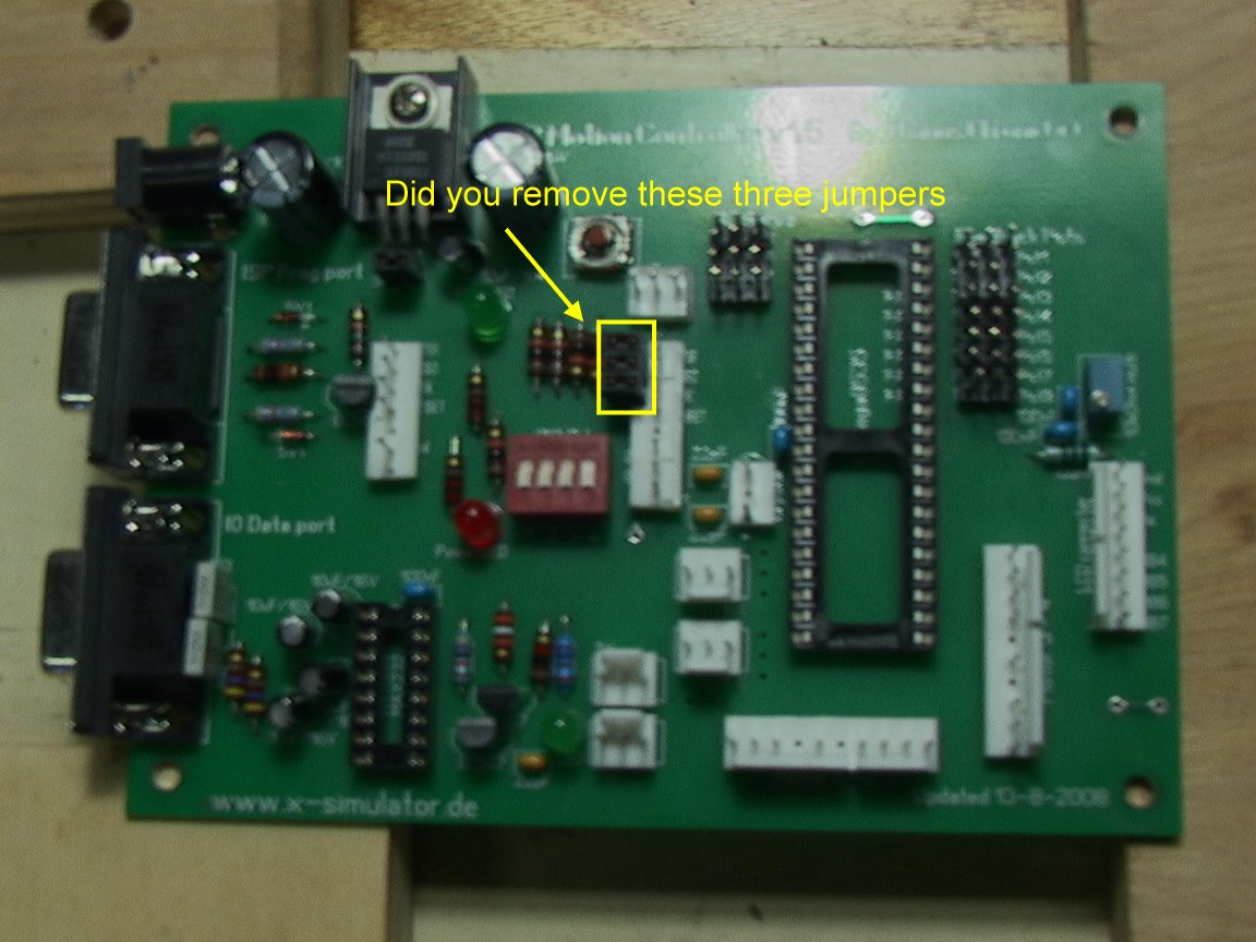

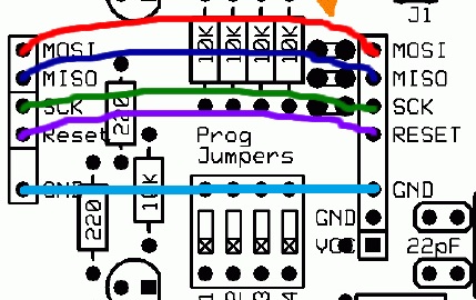

  17. Senetor
    Senetor Member
    Oct 23, 2008
    90
    Australia
    595Coins
    jsmith2307,
    did you remove the three jumpers on the board before you tried to program it,
    if you did not the three programming ports would be held high through the 10K resistors.
    Senetor.
  18. jsmith2307
    jsmith2307 Member
    Oct 2, 2010
    105
    324Coins
    +7 / 0 / -0
    Thanks for the info. That, may be the problem! :) But, sadly it was not the culprit. Now, instead of the usual Missing or unknown device (-24) in addition two new messeges have appeared Bad device, select the correct type (-23) or Unable to probe, bad device or device locked (-25)
    Is it because ofa bad LCD hook up?
    jsmith2307 :(

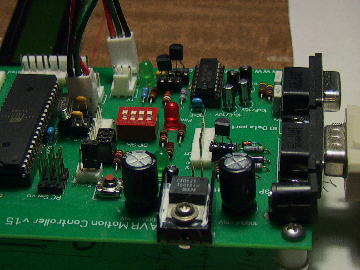

  19. yobuddy
    51,664Coins
    +5,204 / 19 / -0
    I don't think the jumpers do much in real life to change the programming of the board.
    Your work looks good man! Have you checked to see if you place a diode or LED backwards by mistake? (Hard for me to see in the pictures)
    The next thing I would know to do, is to send your chip to me or someone closer to you, to get your chip programmed. Then if it runs ok on your board you know the problem is in the programmer part of the AMC.
    If it does not, then we also know where to look for errors.
