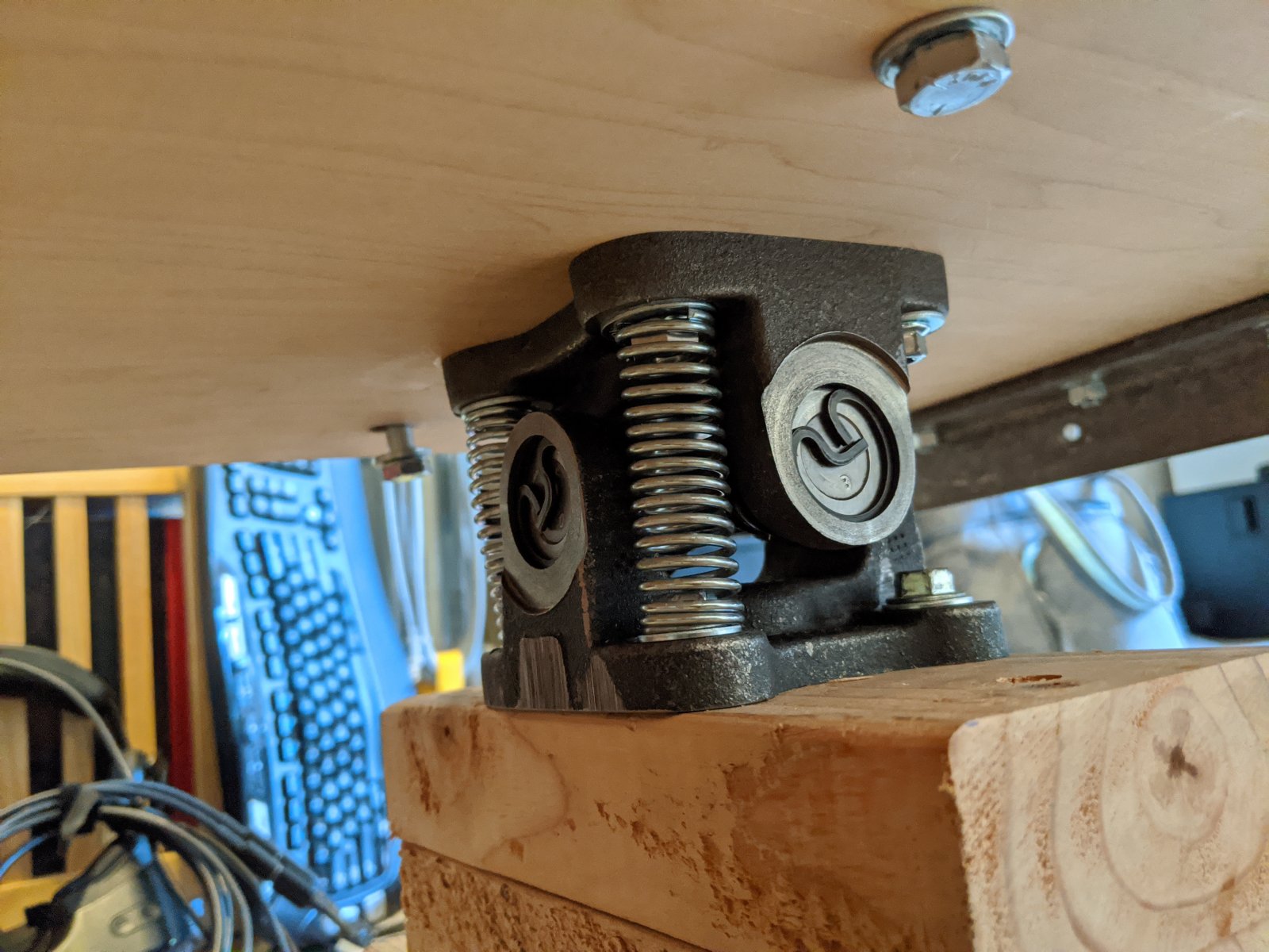

    I was poking around my parts bin and found these stiff springs that just happen to fit my U-joint perfectly. They provide just enough force to keep tension on the gearbox to minimize the play due to backlash.

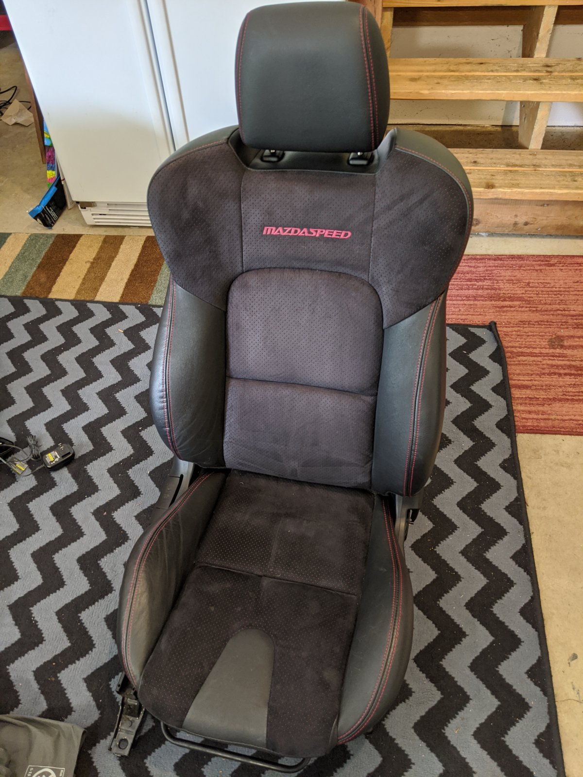

    Just picked up a nice bucket seat from the local parts yard for $45USD! It's the passenger seat out of a 2008 Mazdaspeed 3 GT and in really great condition. This seat is a lot heavier than the old poly seat I have on my seat mover now, but I'm sure my motors can handle it.

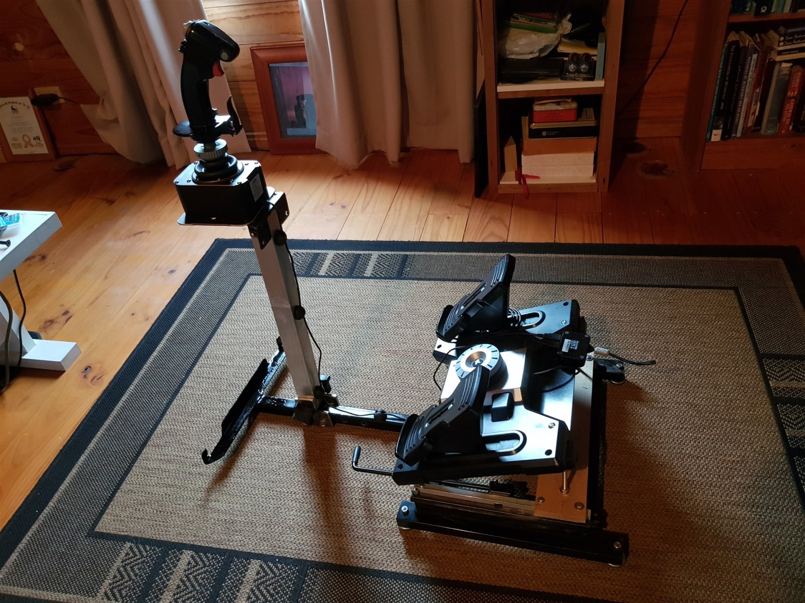

    As a bonus you could use the seat slide mechanism to make adjustable pedals. I did that for my dad's haptic rig, with adjustable tilt via bolts with wing nuts (wingnuts added after this photo), it it pretty easy and convenient for different size users and does not mess up the balance of your seat shaker rig:

    That's a great idea, noorbeast! Unfortunately, I just tried to pull the sliders off my seat and found out the slider frame is integral to the seat back pivot. I could probably make it work with some extra effort, but I'll probably keep the slider on just for ease of mounting.

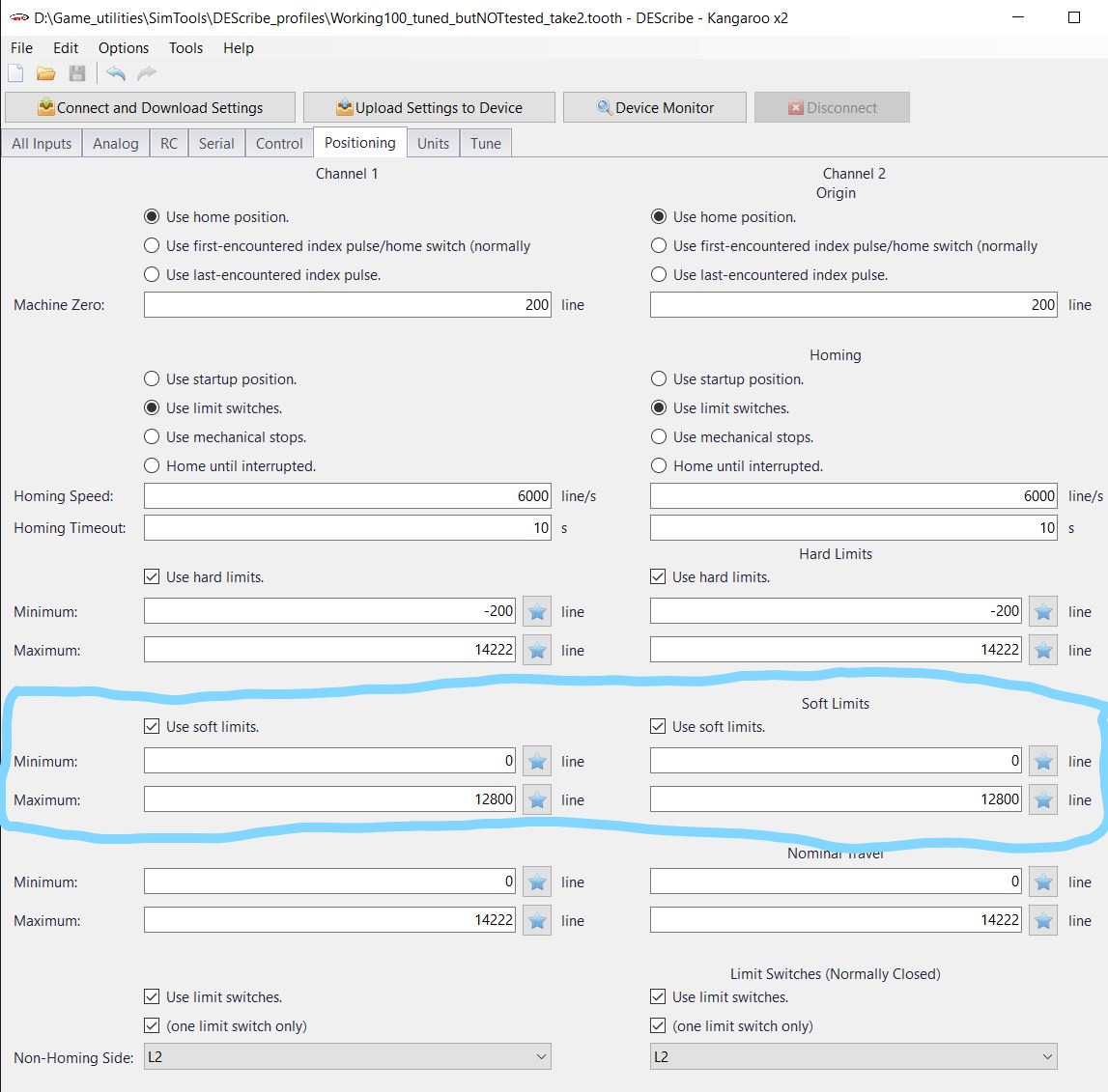

    How to make 90 degrees movement limit by software?
  17. Milt
    Milt Member
    Mar 17, 2018
    60
    USA
    32Coins
    +28 / 0 / -0
    In DEScribe software for the Kangaroo X2. On the positioning tab there is an option for soft limits. I set mine to 12500, which for my system is 90 degrees. That value is a calculation of encoder resolution and gear ratio, it will be different for each system.
