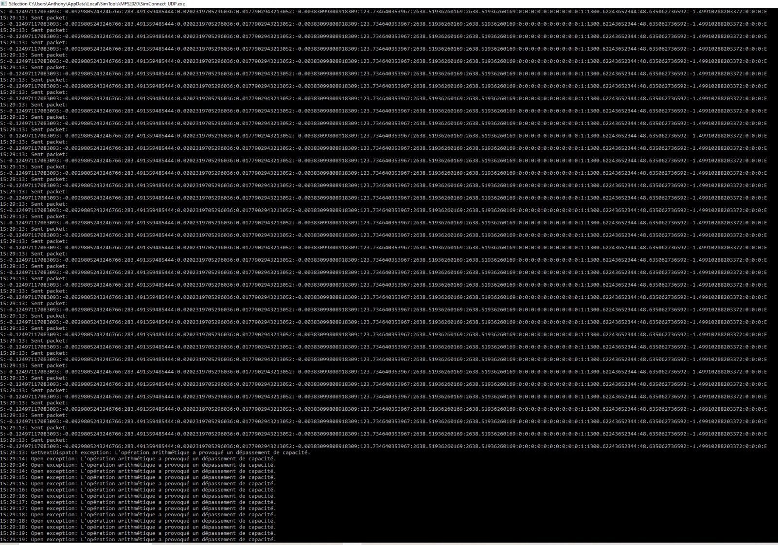

    SimConnect.dll looks right, and the UDP program says that it's sending packets successfully, so I'm not sure what the problem is. I've attached the debug version of SimConnect_UDP.exe, which prints to the console the data sent in every UDP packet. You can replace the file in AppData\Local\SimTools\MFS2020. Let me know what it prints out - this will tell me whether the problem is in the sending of data from the game to SimConnect_UDP, or from SimConnect_UDP to the SimTools plugin. If the print statements are too fast to see, you can lower the packet rate in SimConnect_UDP_config.txt.

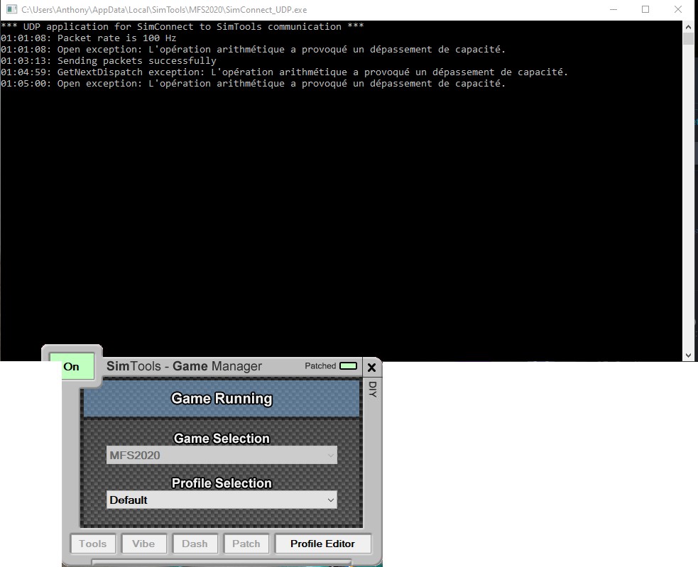

    i replaced the file in AppData\Local\SimTools\MFS2020
    the result after flight in picture
    i think there is problem game to simconnect udp, no ??

    I tried again, i think the first time, the antivirus blocked it

    Are you sure the file was actually replaced? That looks like the regular version of SimConnect_UDP.exe - the debug version should print much more.

    Sorry, didn't see your last message before I posted mine. Looks like the game is sending the correct data to SimConnect_UDP, but SimTools isn't receiving it for some reason. Trying to figure out what the issue might be...

    now, for info,
    i am using 2 pc, first for gaming, second for motion to rig
    settings are same on the PC
    simtools 2.4.0
    windows 10 2004
    flight simulator with last update
    and plugin 1.1.1.0
    patched in game manager on the 2 pc
    (all my others games works perfectly)
    see you when i will have the results of other plugin test
  12. Foxyfoxy
    Foxyfoxy New Member Gold Contributor
    Aug 29, 2020
    15
    - 115Coins
    2DOF, DC motor, Arduino, 4DOF
    i found the problem but not the entire solution
    if i try on the same pc game engine and game manager, that works perfectly,
    but on pc separately game engine and game manager, there is no transmission in virtual axis,
    i will play like that for the moment if you have no best solution
    thanks for your help

    That makes sense - SimConnect_UDP.exe transmits data via UDP packets to SimTools, which it expects to be running on the same machine (IP address 127.0.0.1). I suppose I could allow this target IP address to be changed in the config file, so you could have the packets sent to the other PC.
