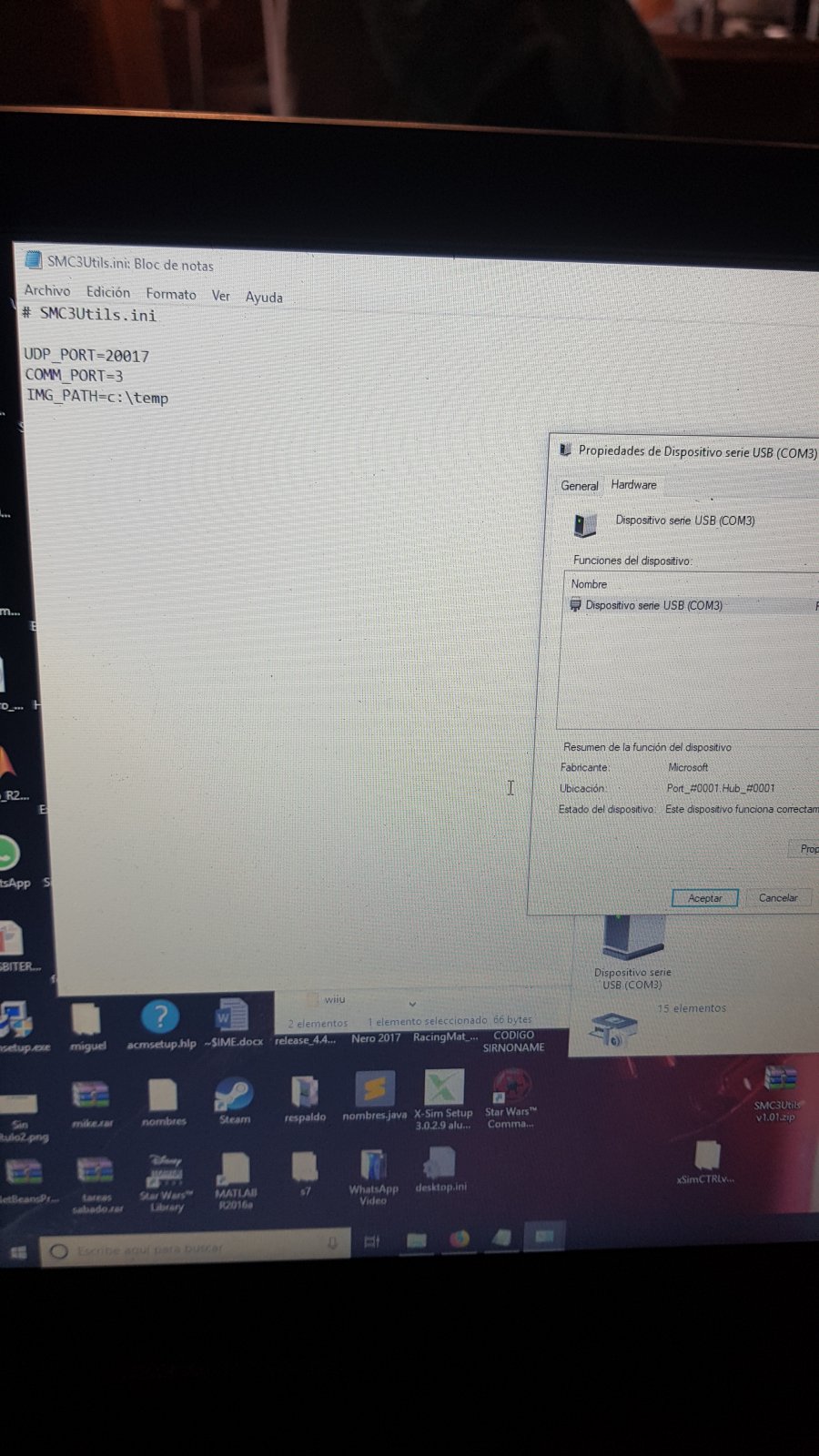

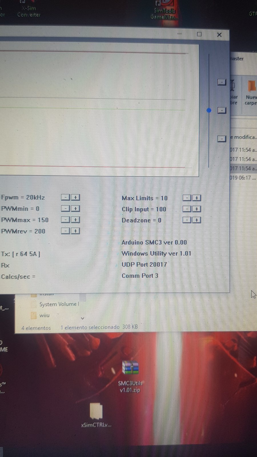

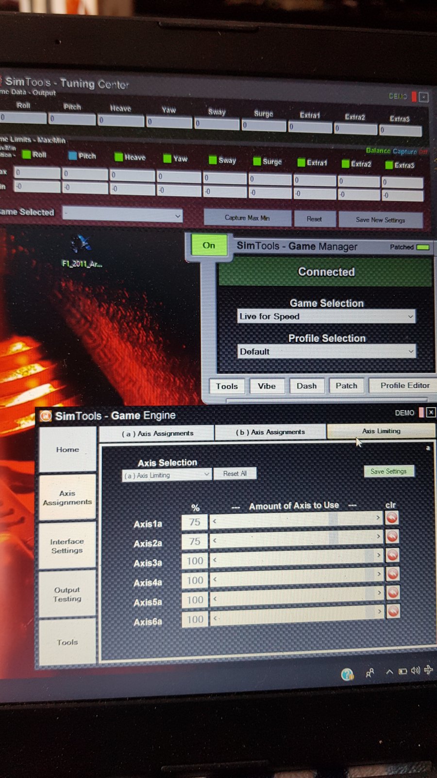

    the SMC3 my PC does not recognize it I have version 1.0.1 but it says does not recognize port com, someone has passed it?

    Everthing needs to be sorted and function correctly in SMC3 before even trying to configure SimTools.
    So if you are having SMC3 issues please post more details and settings screenshots. It could be a port conflict, for example you can't run the SMC3 utility and SimTools at the same time, it could be a hardware fault, or something else.

    thanks, I already change the com port in the SMC3 .Ini file but it still does not recognize it. I do not know what happened this jumping to recognize it, I am also running SMC3 with closed simtools.

    Com3.

    does not recognize the Arduino version could that be the problem,? and how to solve it. ?

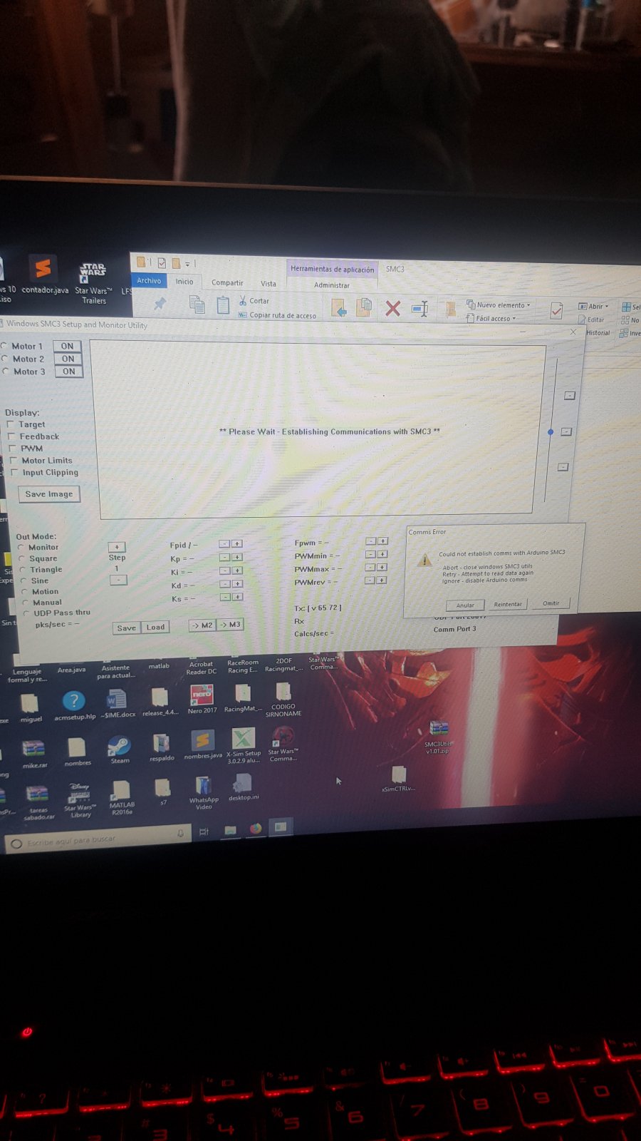

    and update Arduino, restart PC, close simtools, update Arduino drivers. and I keep marking error. I do not really know what to do .

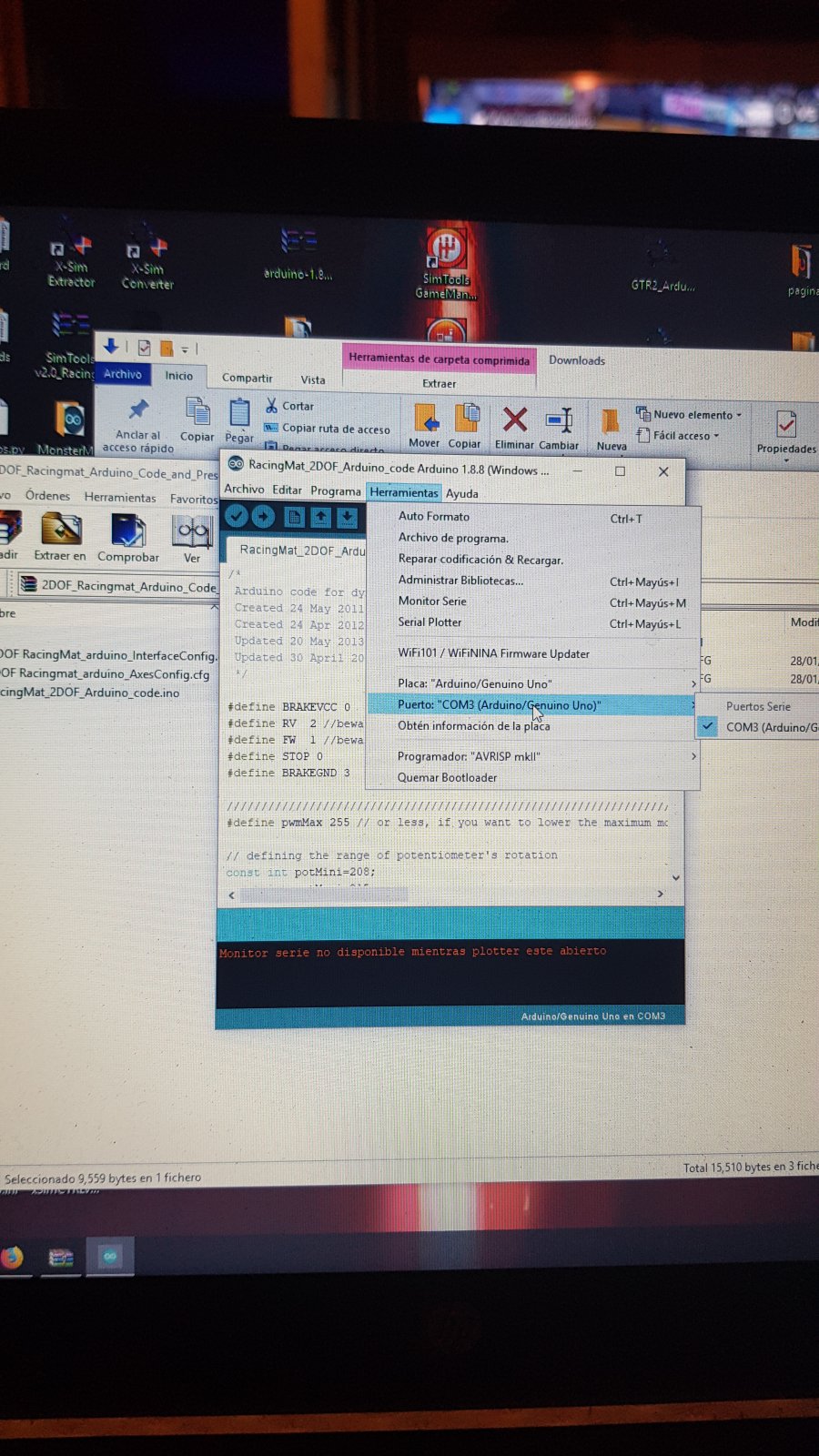

    I am still unclear if you have set the board and post in the Tools menu of the Arduino IDE, can you please confirm by posting a picture of your settings.

    I do not understand very well about the translation. but I do not know if you mean this board where it says the port com.

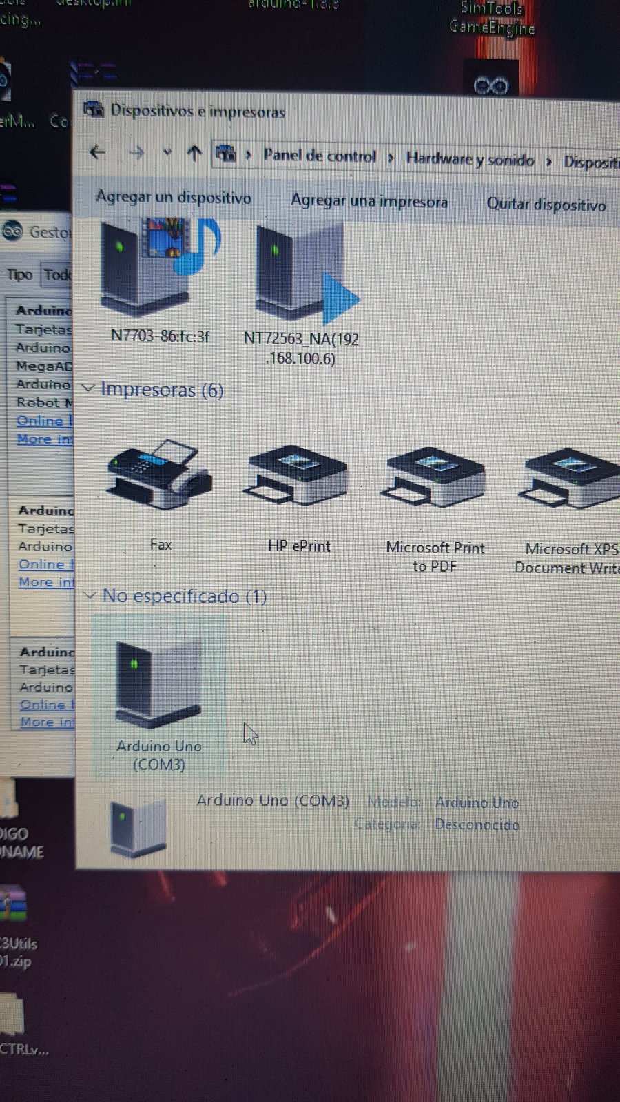

    And does the Arduino register properly in Windows Services as being on com port 3?

    [QUOTE = "noorbeast, post: 172664, miembro: 10786"] ¿Y se registra correctamente Arduino en los Servicios de Windows como en el puerto com 3? [/ QUOTE]
    Yes correct in Windows , show com 3 .

    You said it was but just to confirm is SimTools fully shutdown before you open the SMC3 utility?
    And does SMC3 compile and install to the Arduino without errors?

    Yes, simtools closed desktop and multitasking. completely

    thank you very much I'm waiting. I will try on another PC for now.

    I tried on another PC configure ports com etc, and nothing believe that with another Arduino card?

    The card could be the issue, but first try swapping out the usb cord.

    USB cord already tried others, and nothing. I'll try another Arduino card and tell them what's going on, I hope it's solved with that

    it arrived in new Arduino, I prepared configure, and connect and nothing everything remains the same.
