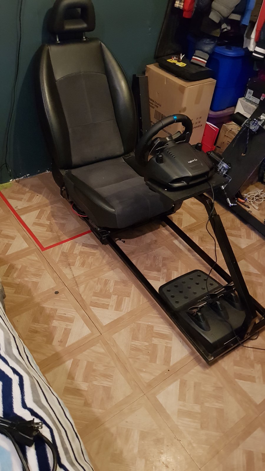

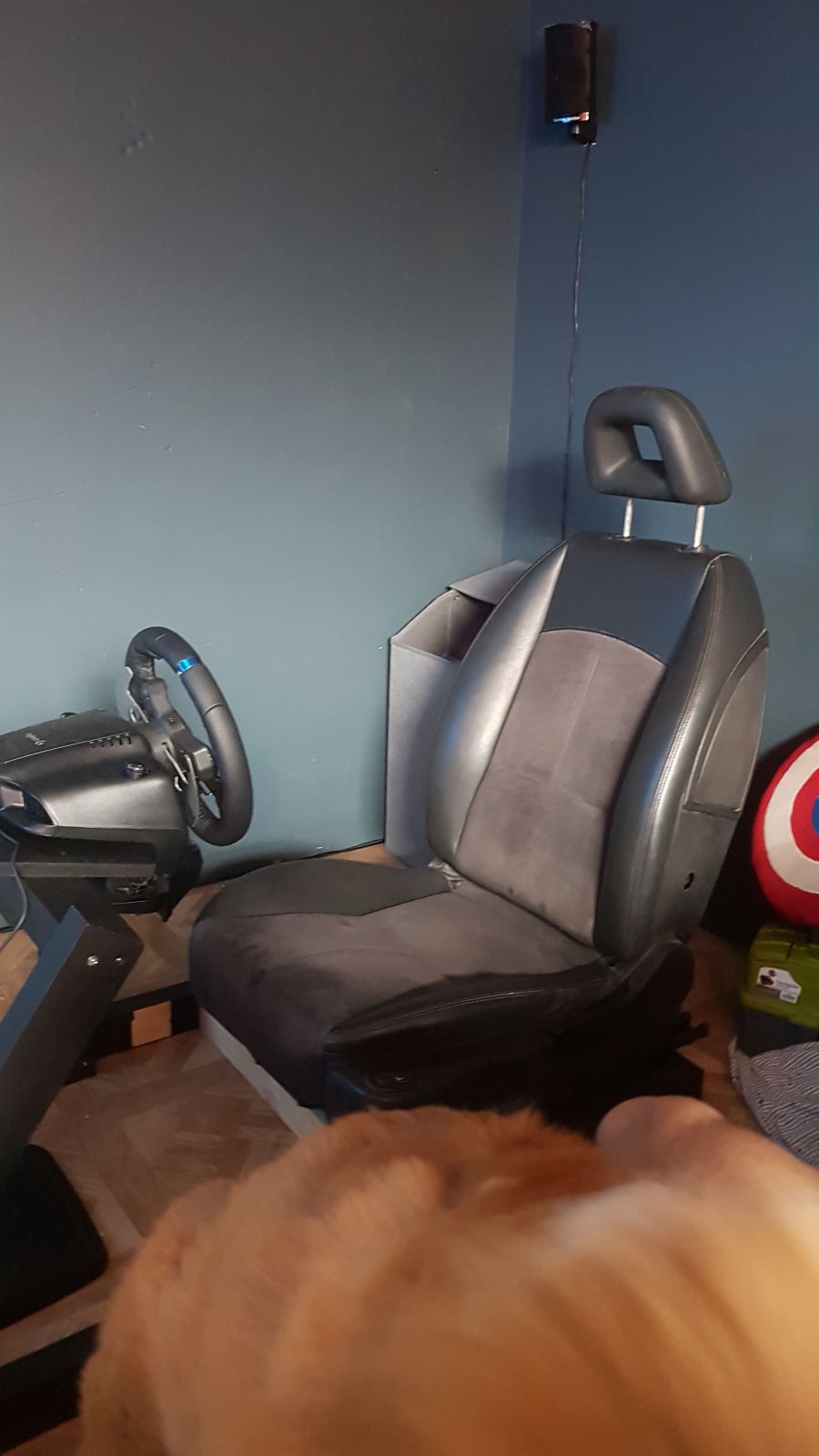

    Hola a toda la comunidad .
    Pues bien me estoy incursionando en esto de simulación por ahora solo tengo un cockpit simple sin movimiento . Les dejo foto
    DeepL translate:
    Hello to the whole community . Well I'm getting into this simulation for now I only have a simple cockpit without movement . I leave you photo

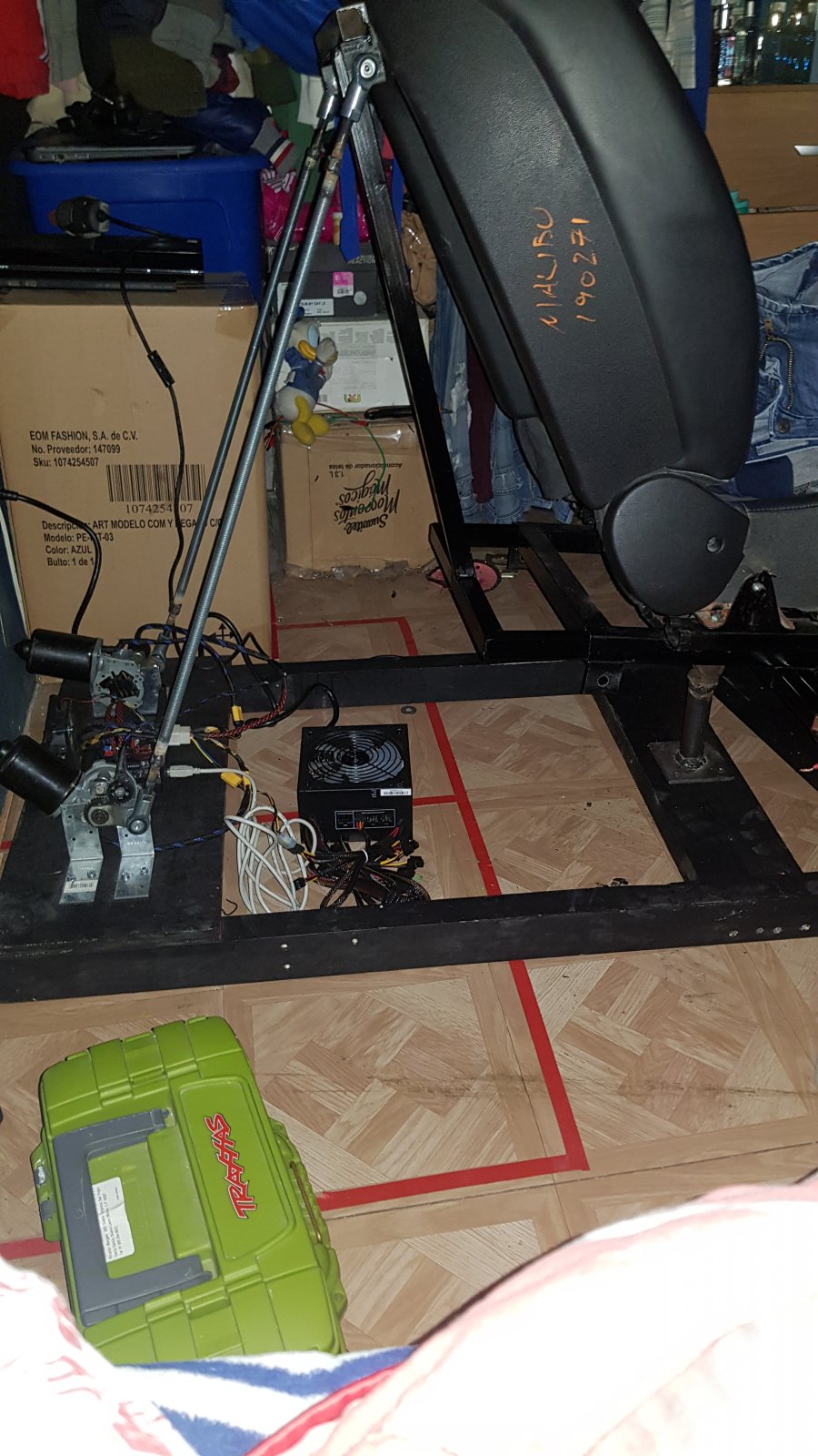

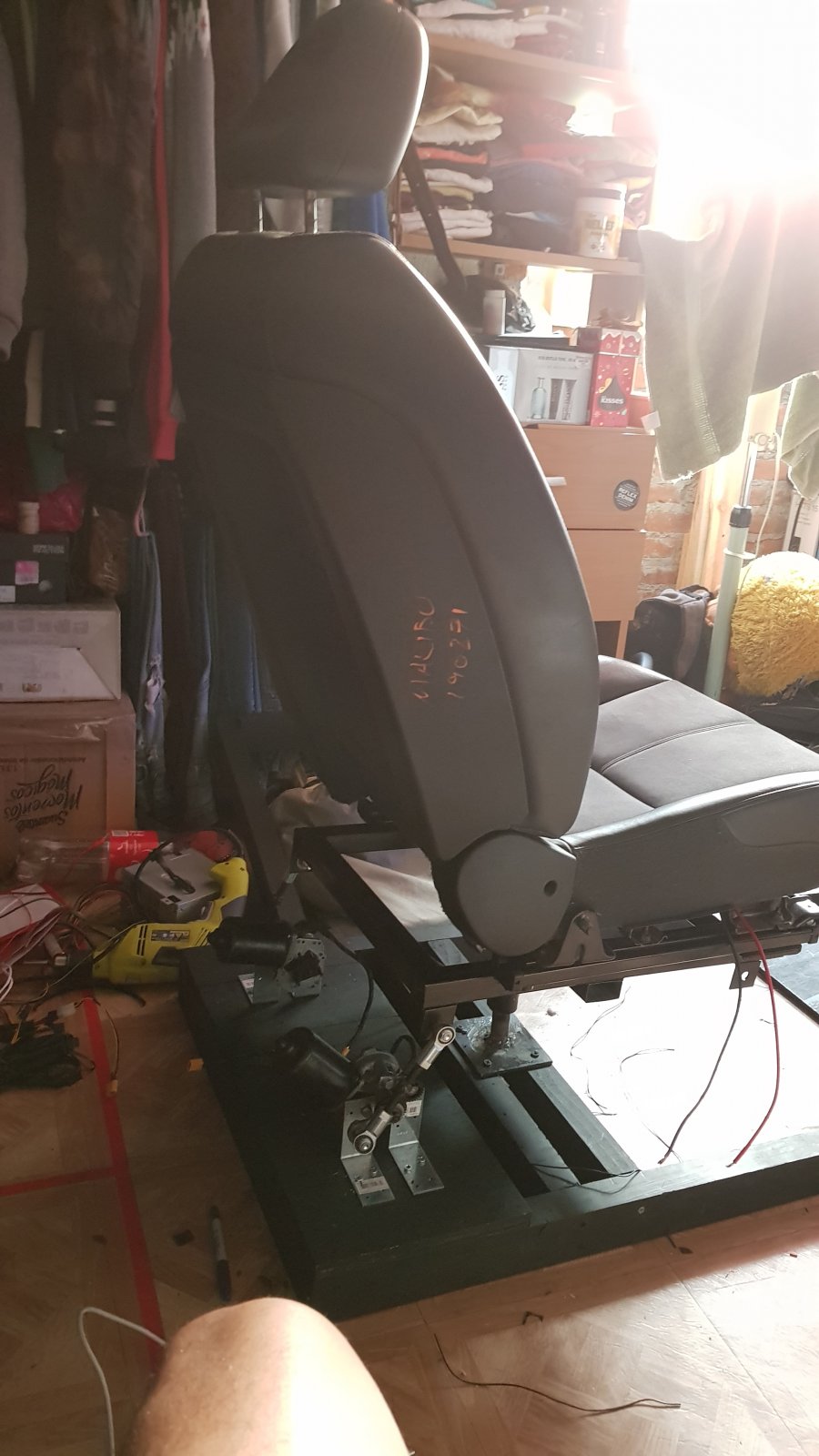

    Gracias por la información .
    Intente poner motor de limpiador pero falta fuerza alguna recomendación de motores?
    Es un 2 DOF para unos 100 kg totales

    That is a compact design, so you likely need all the torque you can get, nothing like these, with 60:1 gearboxes: https://www.motiondynamics.com.au/1...ve-geared-motor-200w-21-256-rpm-7.5-45nm.html
    Another observation to think about, levers and rods are most effective in terms of torque utilisation when operating at no more than 40 degrees up and down, with the levers being at 90 degrees to the direction of applied force when the seat is level. Your rig would likely work better, even with the current motors, if the levers pointed forward, parallel to to the ground, with the rods perpendicular when the seat is at rest position.

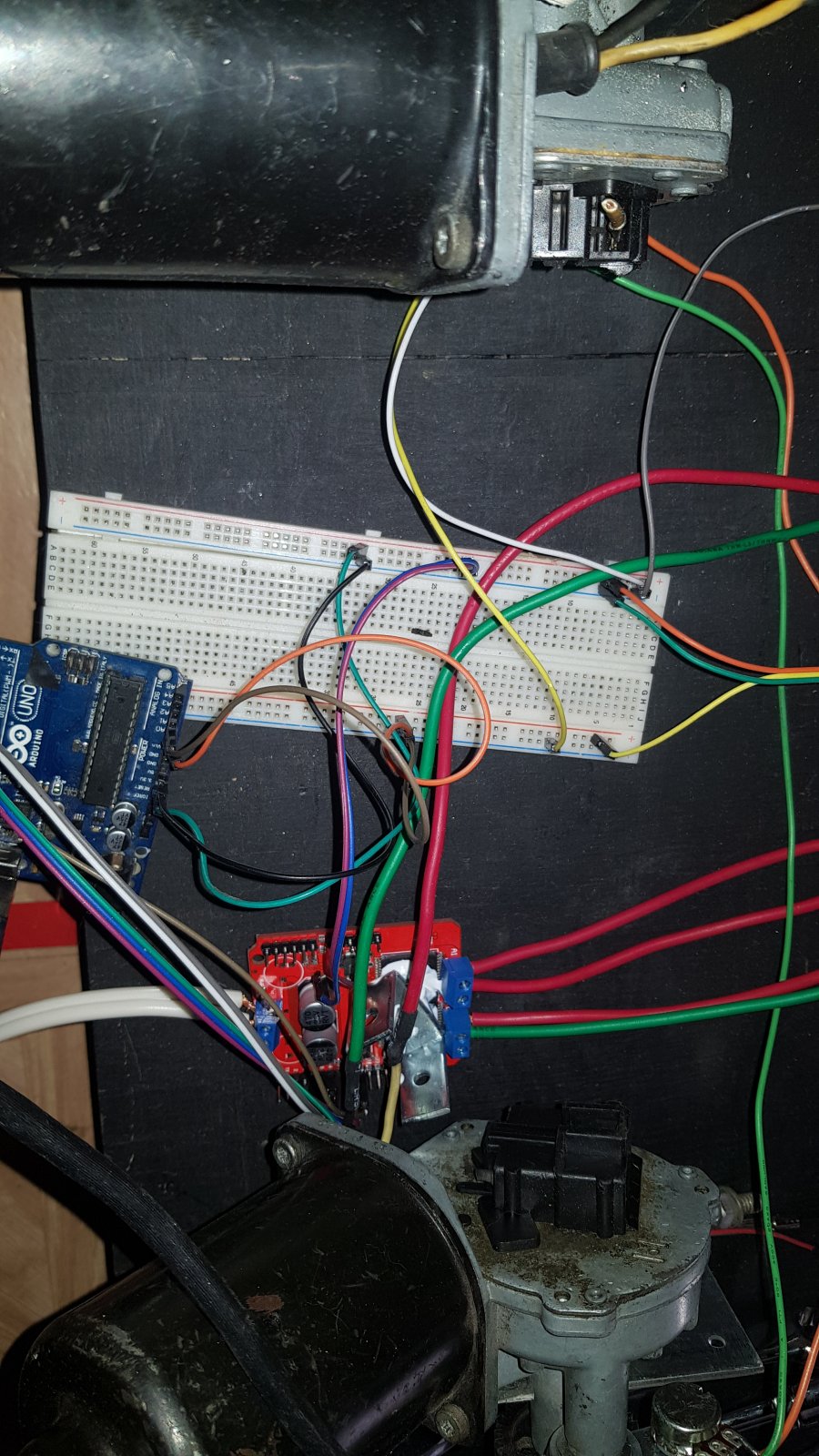

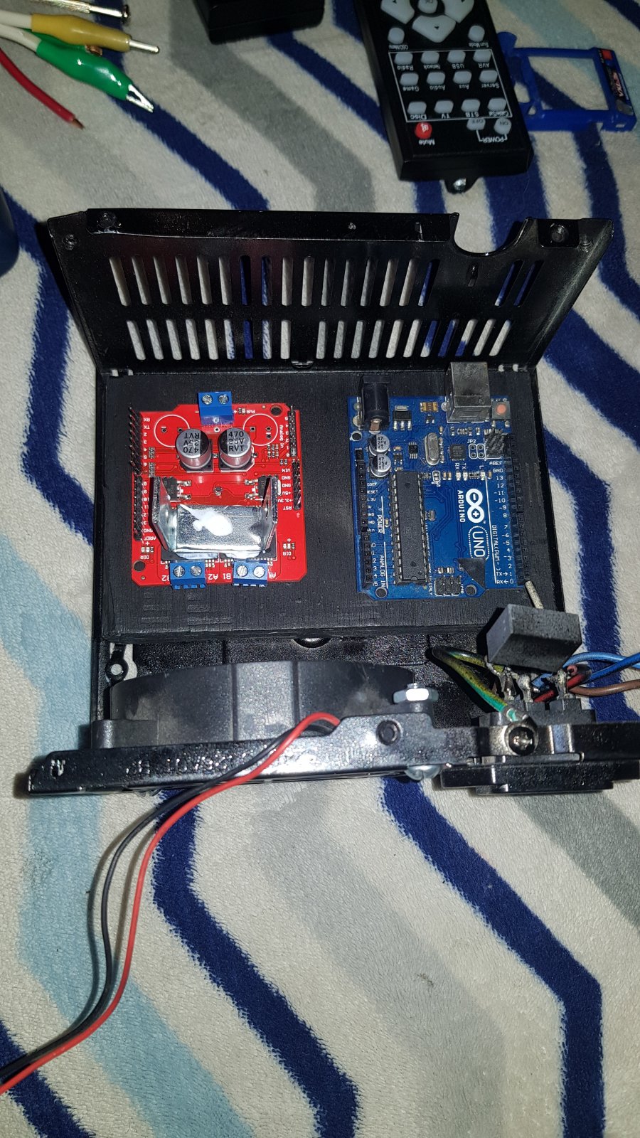

    for now the shipment came out very expensive and I will try the 25: 1. waiting for them to arrive I share photos of my wiring work.

    Wiring
