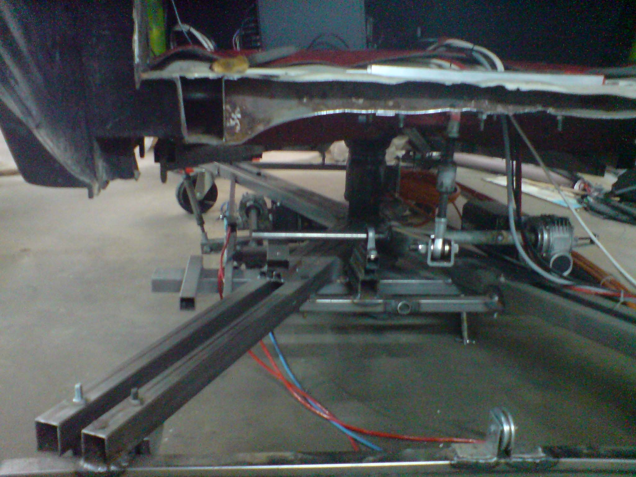

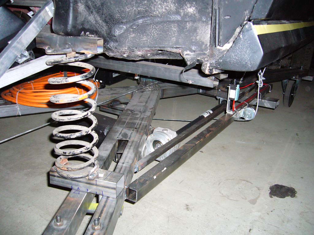

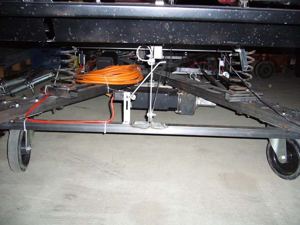

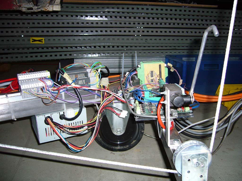

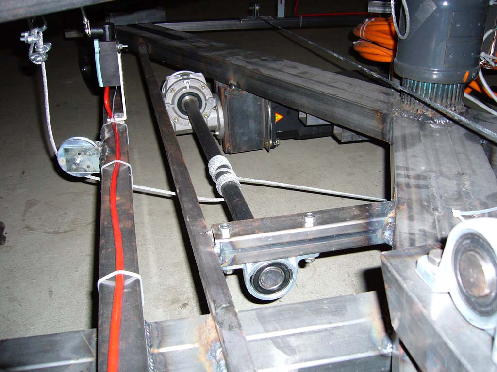

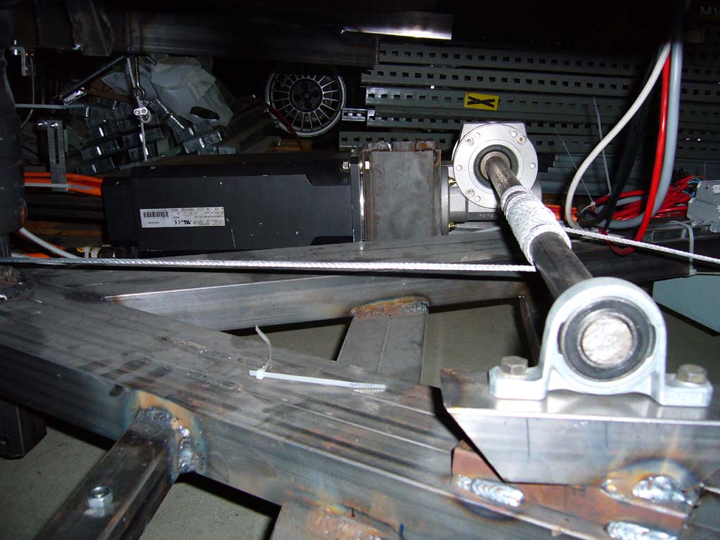

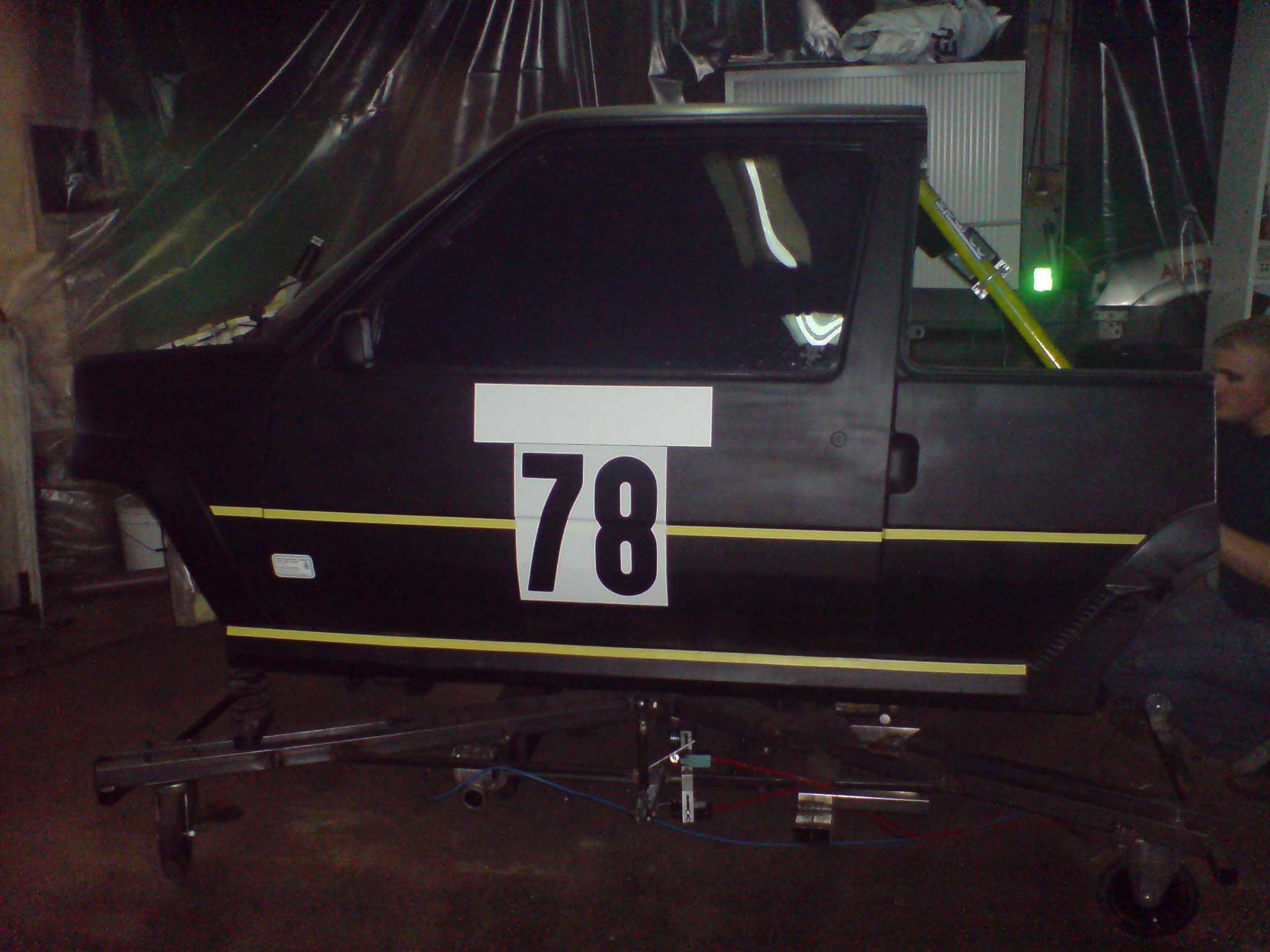

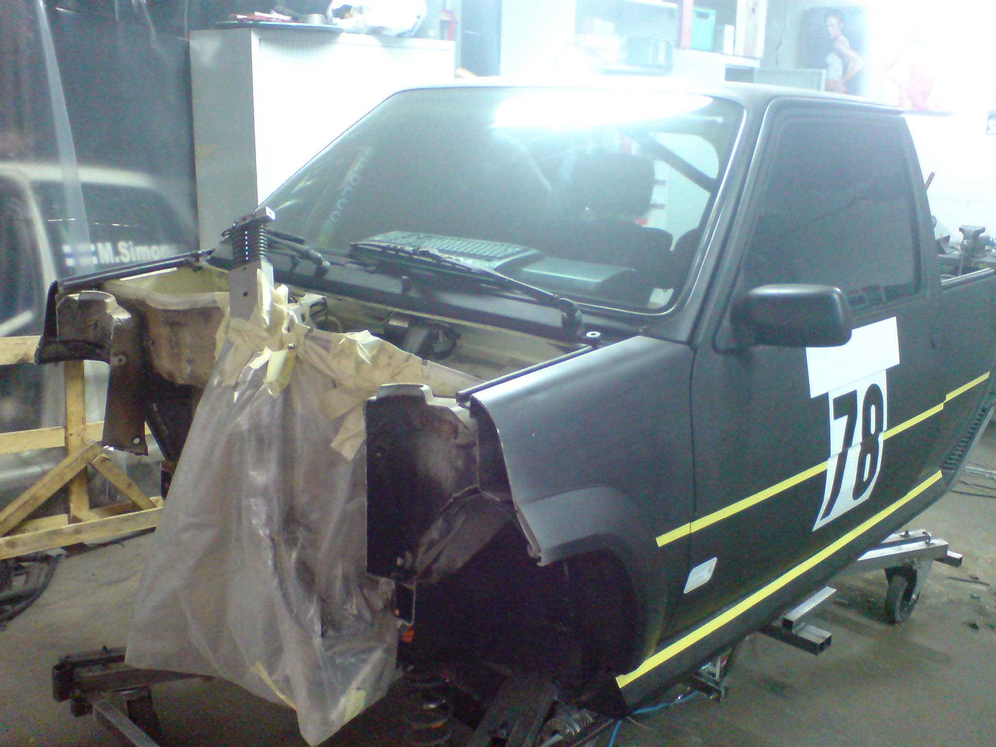

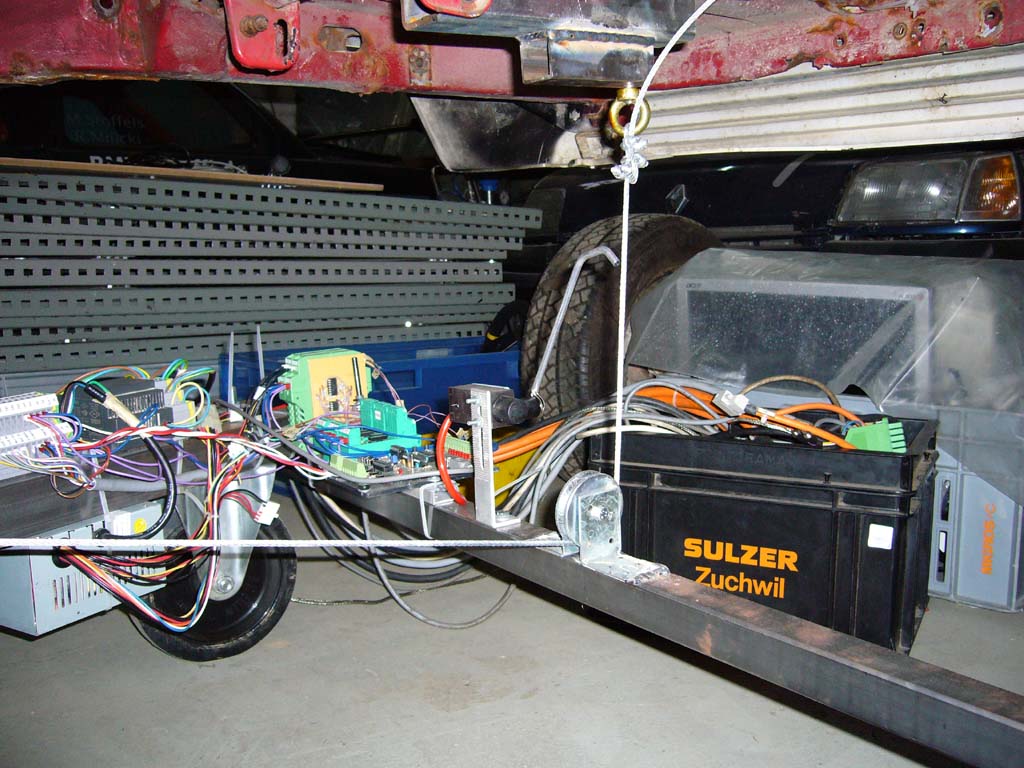

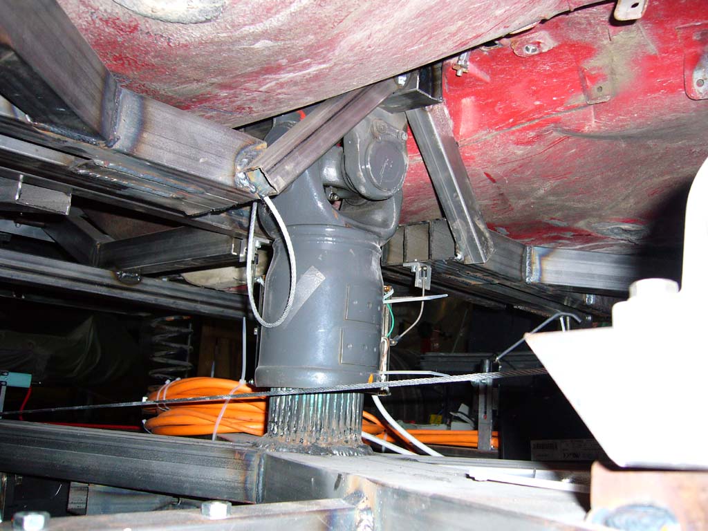

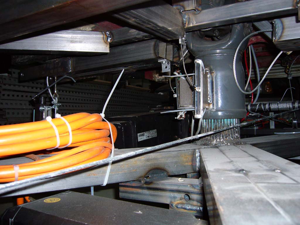

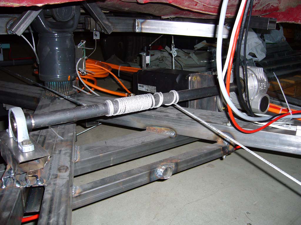

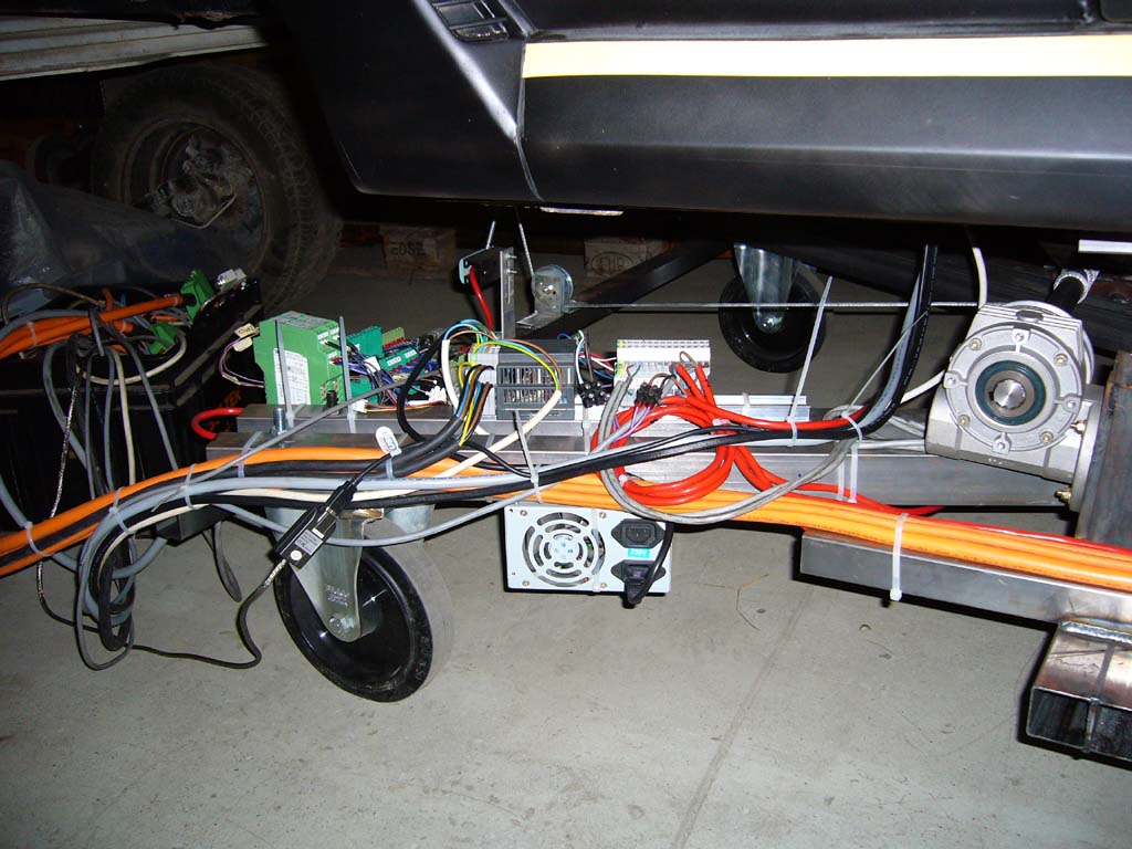

    Hier mal ein paar Detail Fotos:
    (ich weis das die seitlichen Seile zZ etwas locker sind)

  8. wannabeaflyer
    wannabeaflyer Active Member
    Jul 31, 2008
    248
    UK - London area
    973Coins
    +34 / 0 / -0
    wOW excellent photos, great detail. i used cables and pulleys on my 2DOF flight simulator they were connected to Power steering Rack & pinons and driven by windscreen wiper motors. :clap: wicked idea you have for wrapping the cable around the motot shaft that way you get maximum torque :yes: nice touch. exceelent work many thanks for posting the info ( cable drive are not dead LOL:) my sim was about 150Kilos without the pilot and i had 6mm cable what size are you using have a look at my 1st attemp before i put the Body work onto the platform at http://www.youtube.com/watch?v=VOe3hxNcbXI :highfive: it was called dream takes flight & or motion test 1
  9. mboRacing
    mboRacing Member Gold Contributor
    Sep 16, 2007
    231
    Automatiker
    Switzerland -Eiken
    - 161Coins
    +0 / 1 / -0
    Hello wannabeaflyer
    Thx for the flowers :D at beginning i used only a 3mm cable, but i hat problems to fix it on the edges. Now i use a 4mm and thats good, i killed it once but only after a mistake with the controler. It killed the full steel shaft (20mm!!) befor the cabel die'd :no:
    :cheers:

  10. wannabeaflyer
    Jul 31, 2008
    248
    UK - London area
    973Coins
    +34 / 0 / -0
    :hi: Martin Quick question ? did you have any problems with cable streching or loose cable at the extreme travel forwrads / backwards or left to right Roll Motion ? your idea about wrapping the cable around a steel bar is anice way to go for some of our projects :highfive:
  11. mboRacing
    Sep 16, 2007
    231
    Automatiker
    Switzerland -Eiken
    - 161Coins
    +0 / 1 / -0
    The cable is stretching a litle bit, but i hope it will stop after use a little bit (First stretching with new cable is normal i think) but however, in my case is not so important - the base is holding the zero position by itself and i pull with the cable to a side. I have now problem with the cable sliping at all.
    I hope this answers your question!?
    :cheers:
    Martin
  12. mboRacing
    Sep 16, 2007
    231
    Automatiker
    Switzerland -Eiken
    - 161Coins
    +0 / 1 / -0
    So hier mal ein movie in besserer Qualität. (Wir fahren noch immer nicht 100%)
    http://www.youtube.com/watch?v=gDE6sPgr3TQ
    Neuste Erkenntnisse:

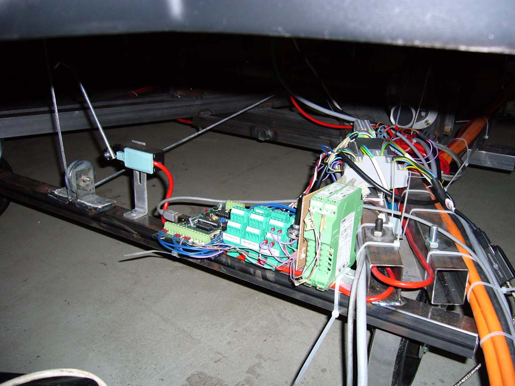

    - Die Positionsrückmeldung über Velleman ist nicht brauchbar, die schwankenden Werte liesen den Sim sogar gefährlich hochschaukeln! Ich habe die mit einem Bodnar Modul
    umgangen (die Positonsrückmeldung kommt als Joystick, 10bit resolution) http://www.leobodnar.com/products/BU0836/
    - Die Lösung mit den Seilen ist nicht befriedigend (die Seile dehnen sich mehr als angenommen) - ich werde mal versuchen mit Hebel und Schubstangen - ich denke die Leistung der
    Motoren wird ausreichen...
    :cheers:
    Martin

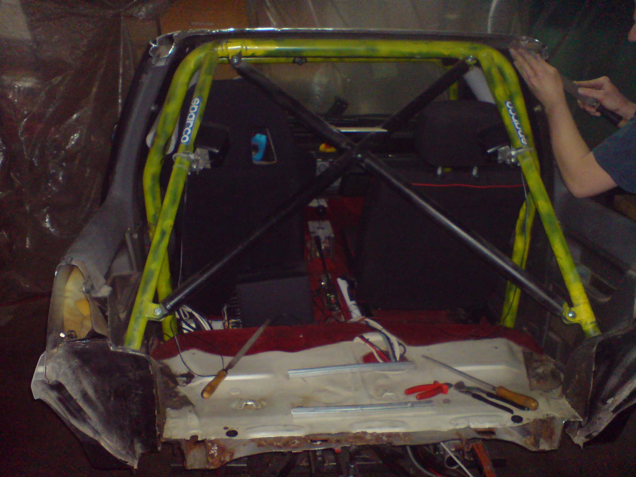

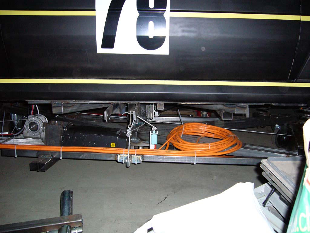

    Sim Update:
    Ja er musste Federn lassen 8) um ein agileres verhalten hinzubekommen musste das Monster jetzt leichter werden:
    Ebenso geändert haben wir jetzt die Mechanische Ansteuerung:

    Hut ab ... Eine echte Tüftelarbeit die Du betreibst ... :thbup: :thbup: :thbup:
    Das Gewichtslifting ist glaube ich auch eine gute Idee um die Trägheit zu besiegen und mit halbwegs normalen Mitteln und überschaubaren Geldbeutel voran zu kommen.

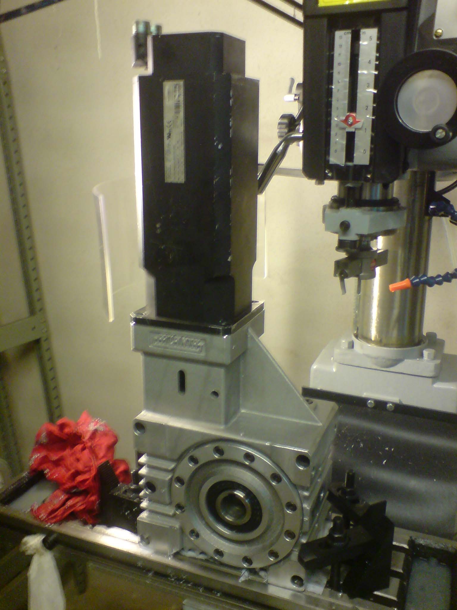

    So hier wiedermal n kleines Foto Update des Monsters:

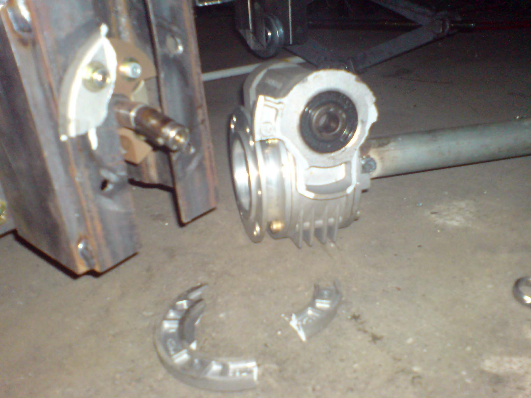

    Leider war die SPS Software und ich nicht ganz eins und so schaukelte der Sim auf, was ein gebrochenes Getriebe Gehäuse zur folge hatte:

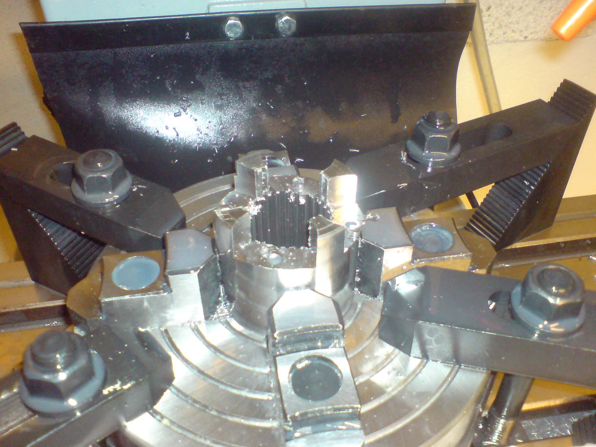

    Dank dem grossen Auktions-Haus gabs dann neue Getriebe welche in der Leistung zu den Motoren passen, lediglich der Zentriersitz musste angepasst werden:
    und natürlich die Kupplung zwischen Getriebe und Motor:
    Als nächstes dann wieder Halterungen bauen und montieren, dann gehts wieder weiter...
    Grüsse, Martin
