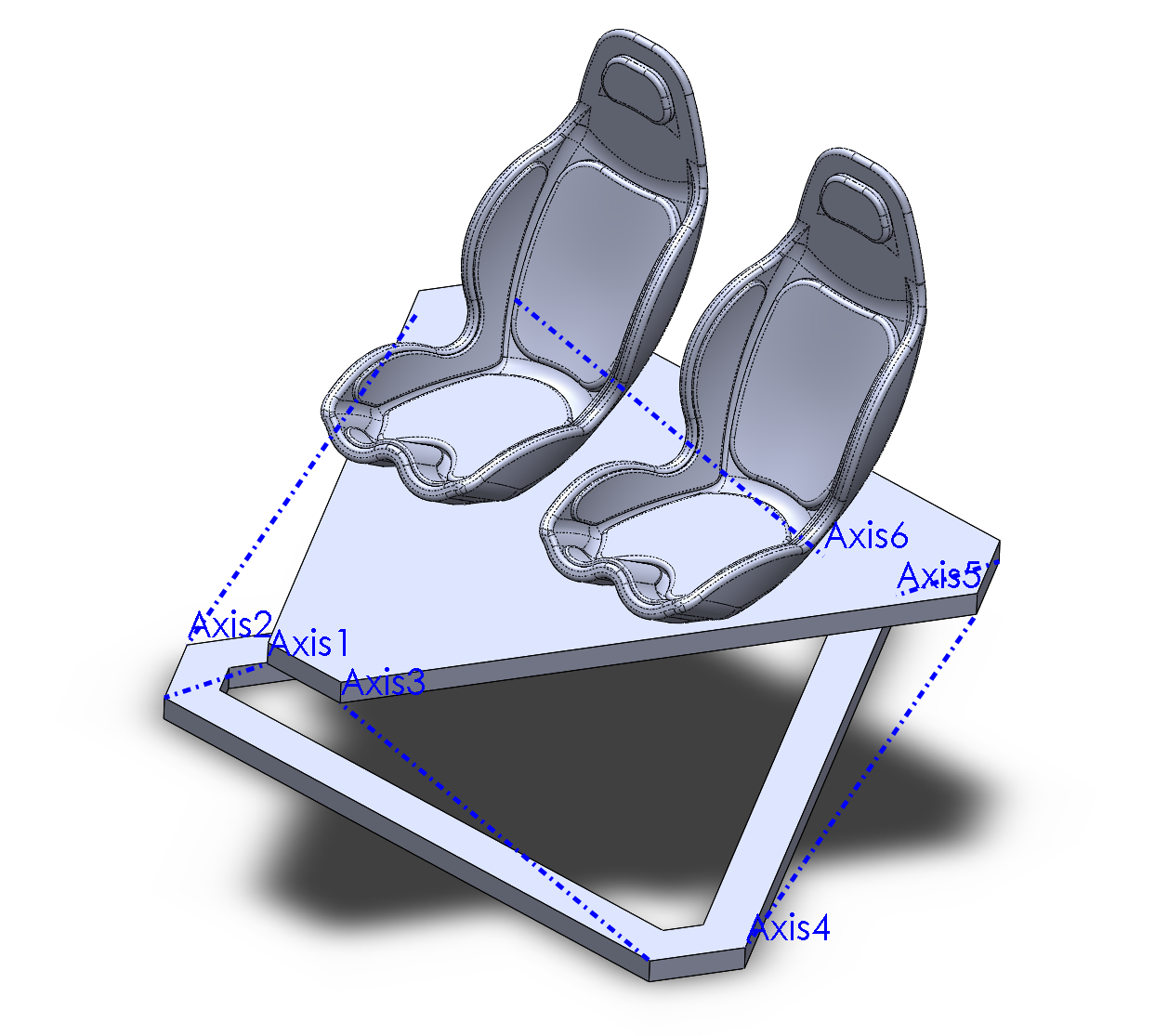

    Heya, planning my 2 seater buggy, I've not got very far before a question comes up.
    Looking at the completed 6DOF projects I see the rear of the rigs (behind the seat) has the 2 axis points, but with my 2 seater its at the front and 4 at the rear? looking at the sketch below would sim tools be able to adapt the if the 2 axis were at the front?
    21,597
    151,245Coins
    Yes SimTools can, it is just a question of axis assignment.

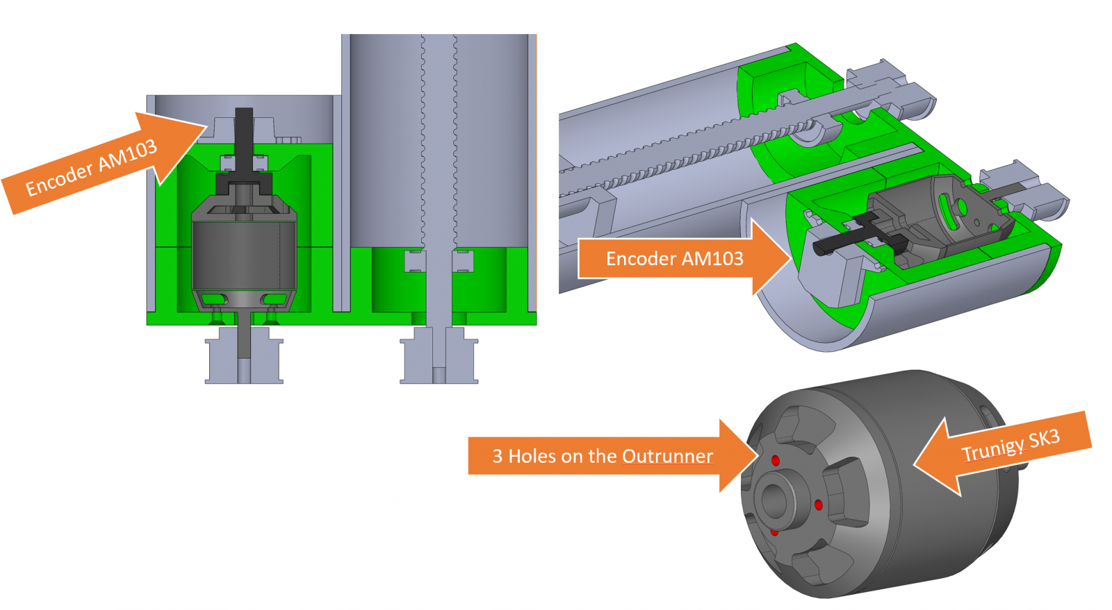

    General question to anyone using the Turnigy SK3 motors (kinda hoping @SilentChill , @PeterW or @Carelsbergh_Stijn bump into this thread ) . My thinking about the actuators is to use a timing belt to reduce the overall height and optional gearing if needed for the weight issue. The thing is, having never held or run an SK3 yet, would I be able to add the encoder to the out runner shown below?

    Hi Mars Buggy
    Yes, it should be ok to add the encoder like shown in your sketches.
    Regarding the high weight of the upper platform, you could think about to have a small reduction from motor to actuator (as an optional feature in case the motor doesnt have enough torque to push your platform). Maybe you can use a littl stronger motor.

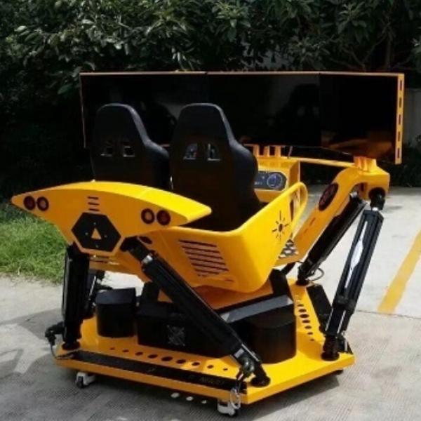

    I’ll have a read of the thread, that thing looks way overkill for my garage. I’ve found this example on robotdigg more the size I was looking at. Although I doubt its ability to have the full 6dof movement without a frame clash.
    Looks like my frame weight guess is not far off. Thanks @Carelsbergh_Stijn for sharing. I’ll keep those upgrades specs in mind.

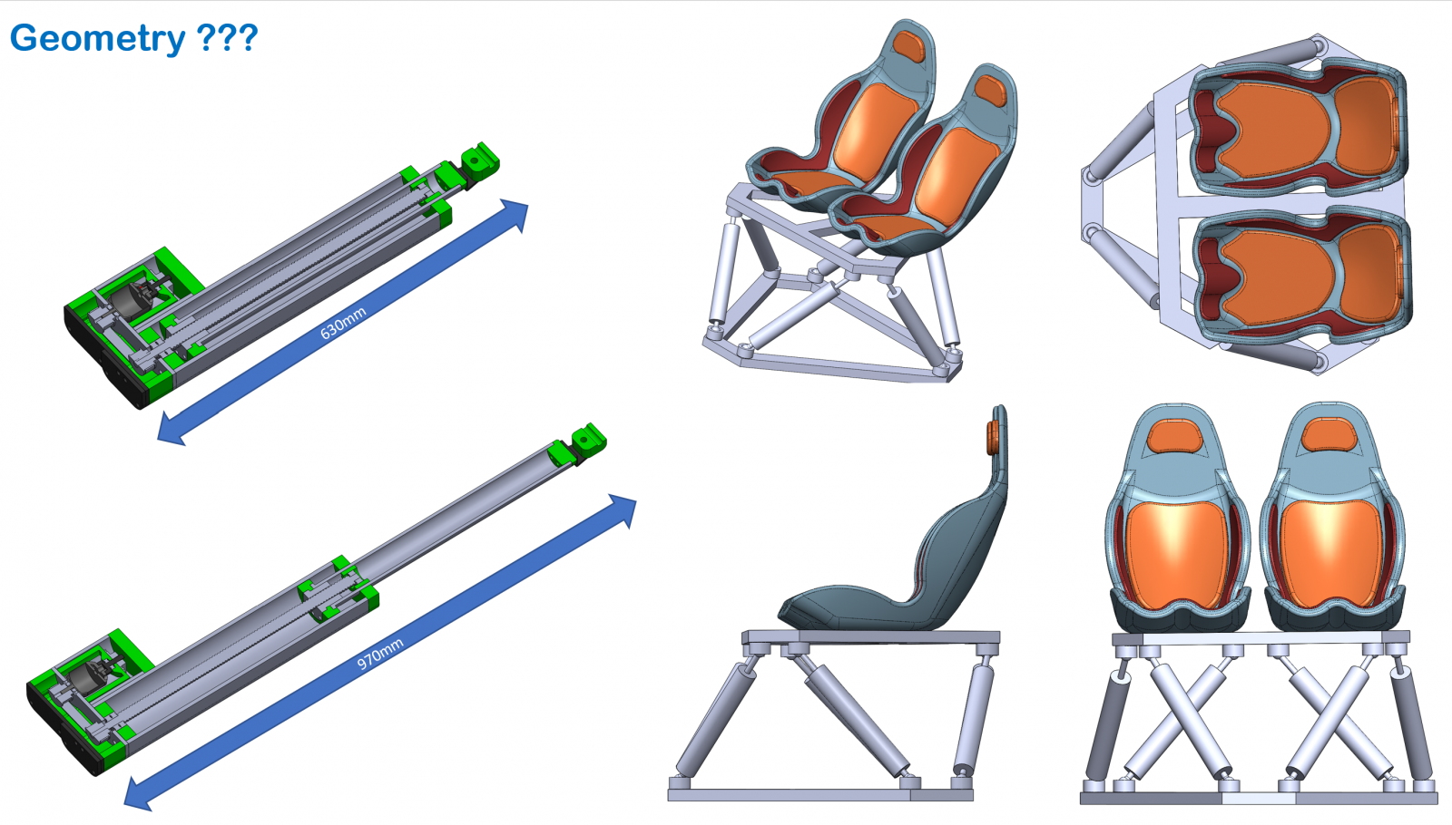

    Moved on a little bit, not much but a bit. Got to say, Wow optimising the hexapod geometry is a tough one...
    Any suggestions on the sketch so far, will be awesome? Tried SimCalc for a little bit but its set up for 2dof and pinion arms (unless I have an old version). How have you guys attacked the balance, GOG calc's.
    Space and the 2 seater is forcing me to be sitting above the platform. Hopefully looking for a proven method to optimise the hexapod dims now that I have a good idea of my actuator travel?
    Thanks for sharing.
