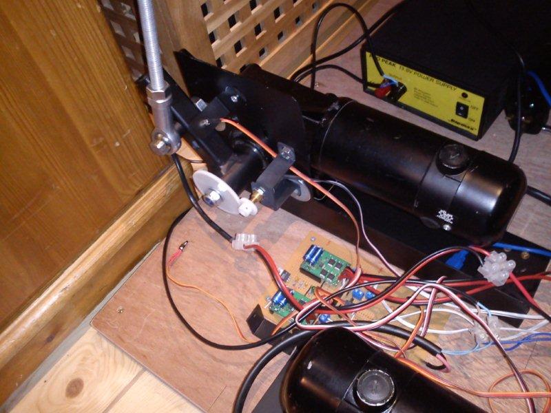

    Hi All,
    I've been visiting the site since just before christmas. Most of my free time between then and now had been spent trawing through the forums gathering all the required, previously learned knowlege and experience of all those who have trundeled down this path to find the Holy Grail of simming :D I'm almost finished my sim so thought now would be a good time to post the details:
    Components:
    2 off Fracmo 24v 11A 40Nm wheel chair motors - £68 - ebay
    2 off Pololu 24v23 cs - £100 - Technobots
    1 off 24v 50A PSU - £40 - ebay
    1 off K8055 kit - £35 - Maplin
    2 off 360' 15% pots without stop - RS Components - £35
    2 off hubs/actuator arms - £55 - local machine shop
    Rod ends and plastic gears - £50 - bearingboys - (thanks TIM)
    Motor mounts made from left over industrial roofing flashing - local farm - £0
    Frame - chopped up an old glass topped metal table - £0
    Plywood - scraps from other projects - £0
    Land Rover steering colum and universal joint - given by a friend - £0
    Other bits and bobs - everywhere - £50
    Total - £437 - so far :D

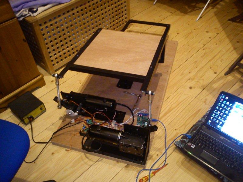

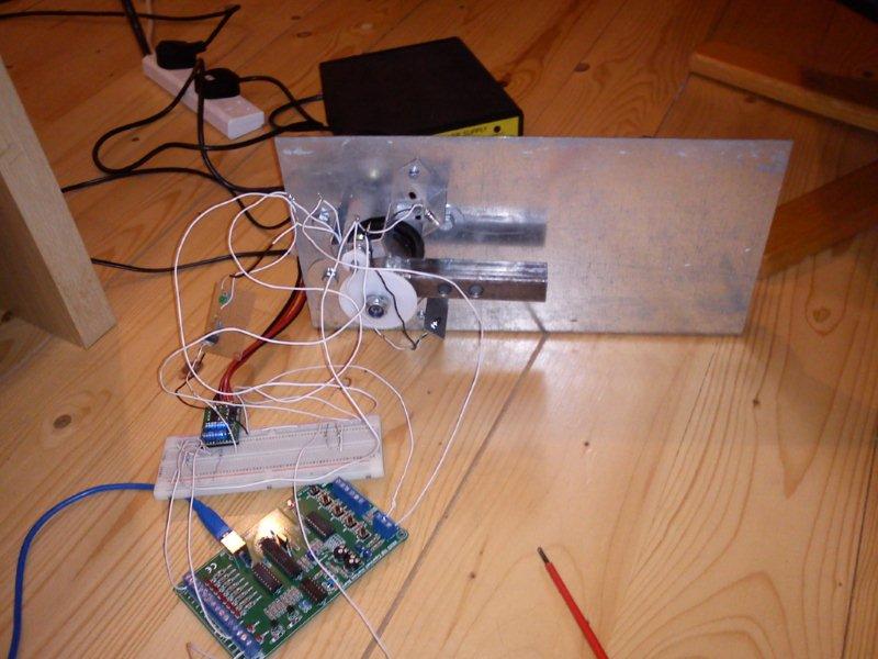

    http://www.youtube.com/watch?v=MnB_n2YsIaQ
    http://www.youtube.com/watch?v=o0swhHqdll8

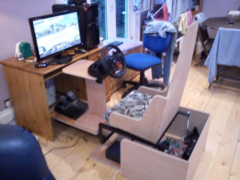

    I ran it with Nimas ( :cheers: Rfactor Megane Nordschcliffe profile. At this point in time my knowlege is too limited to be able to edit this to give acceptable results in my sim and I found the movements to much and the lateral movements were the wrong way around. Maybee later :)
    http://www.youtube.com/watch?v=0co_8XyyShI
    For now I am experimenting with Bernards Rfactor template profile :cheers: modified for the K8055. I am finding this easier to understand and I will add to it as my experience grows.

    At the moment I am running my sim on 12v and the Pololu cards and motors are cool to the touch. I have not used the 24v supply I have as when I tried it the Pololu cards almost melted even when the sim was stationary. I will need to look into this a bit more.
    Overall I am very pleased with the results so far. The K8055 and Pololu combination have offered a quick and resonable priced solution. Now down to the next task of profiling.
