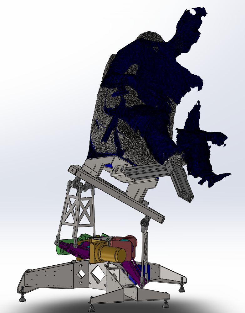

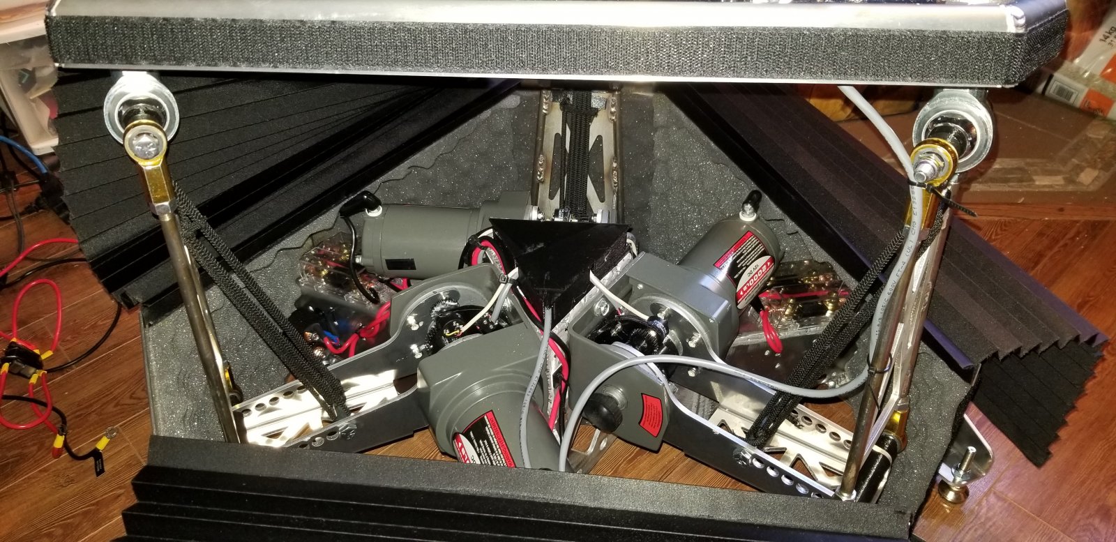

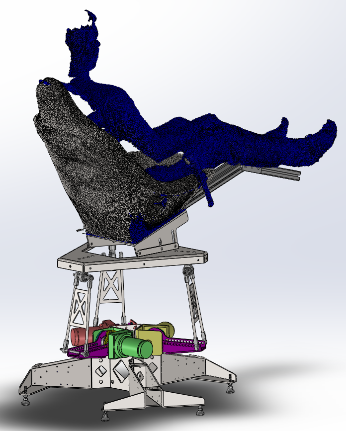

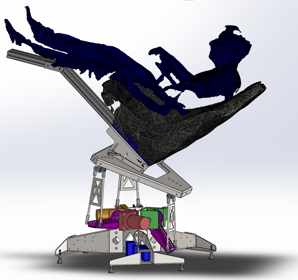

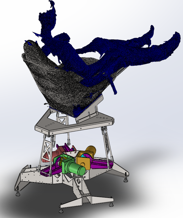

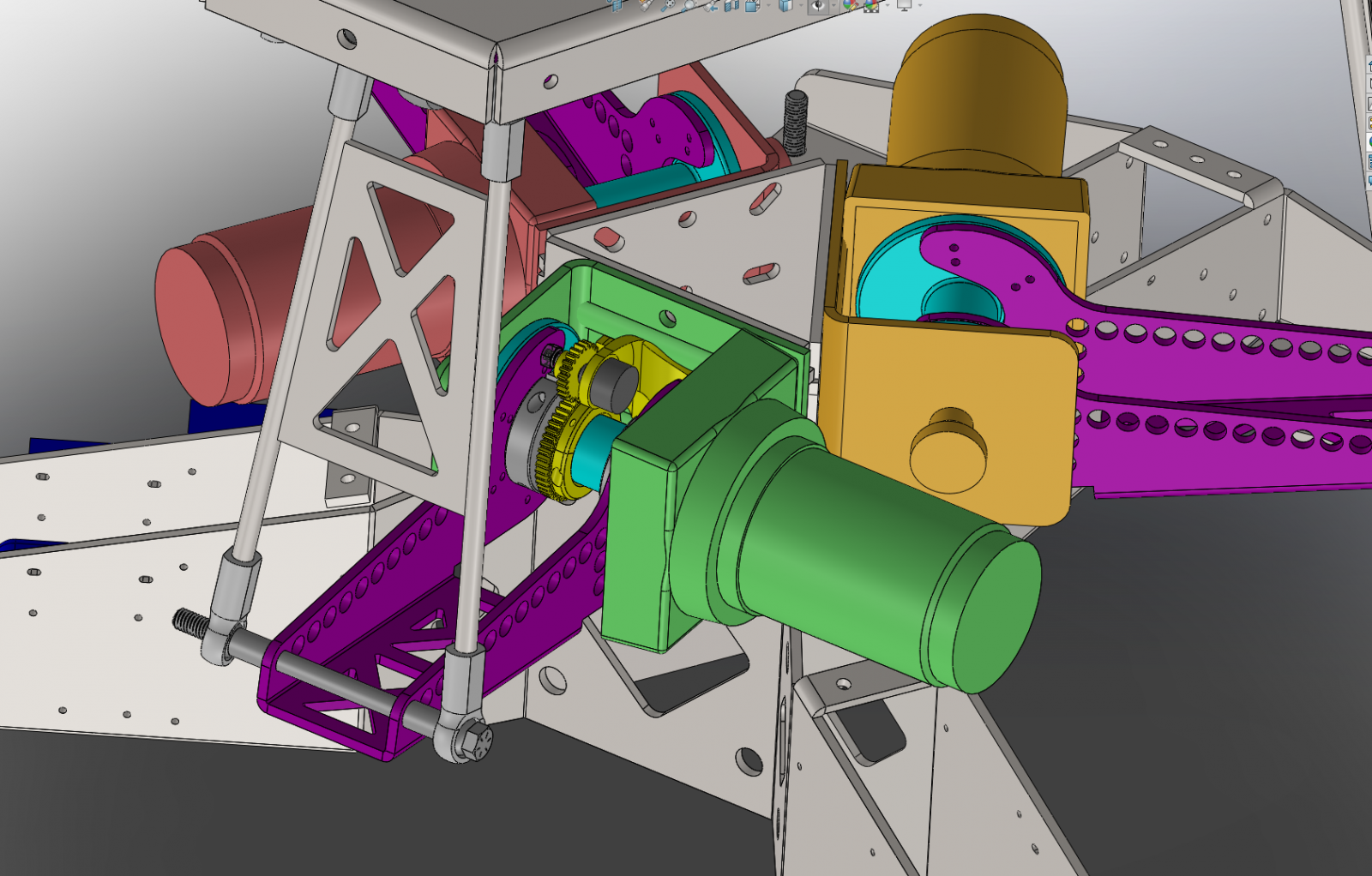

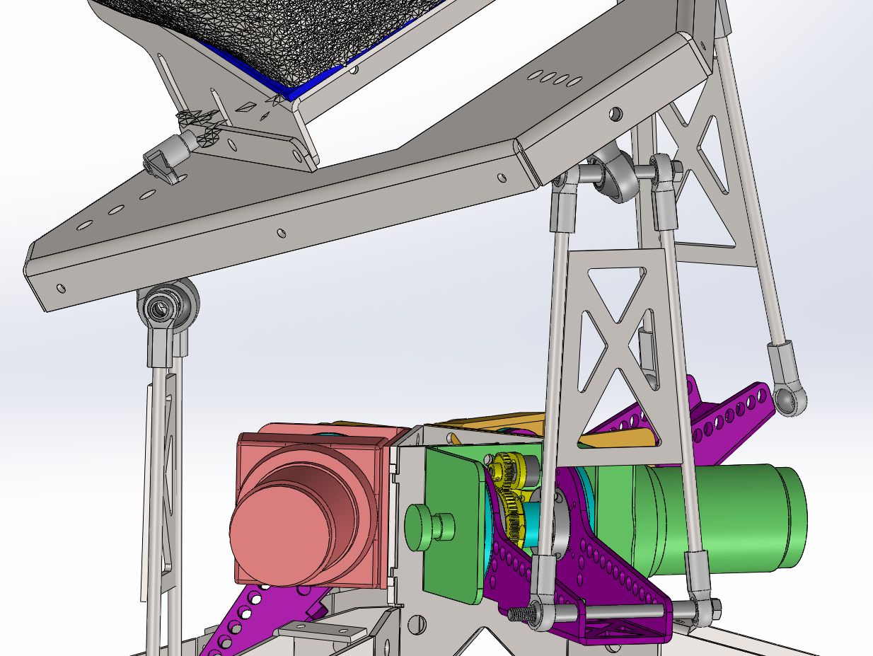

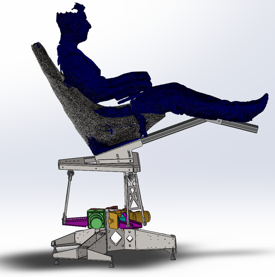

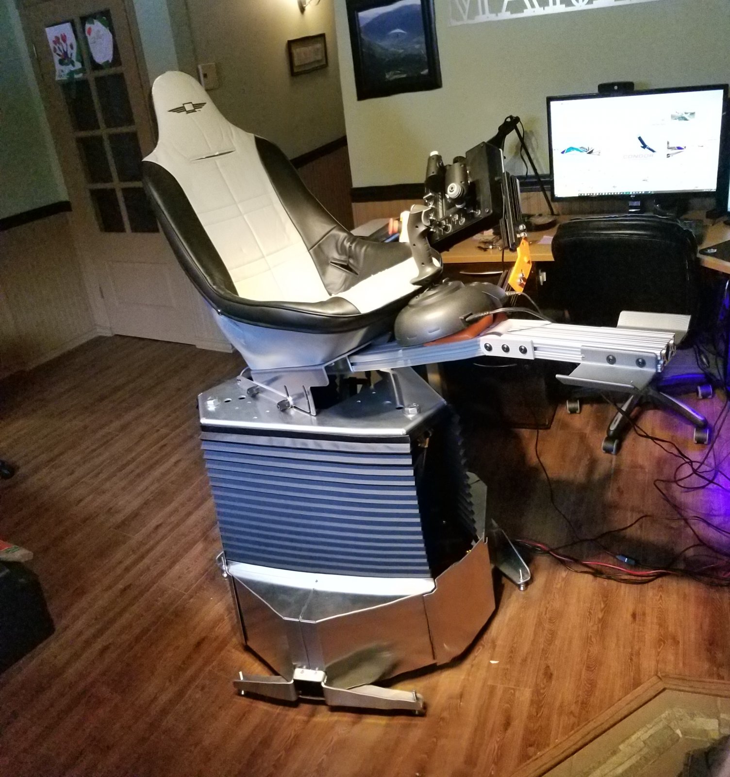

    Hi All ,
    I work on a 3DOF For FlightSimulator, the principal utillity is for Condor 2,
    My Config,
    -3x Standard Winch 2000lbs 750W motor/1HP (153/1 planetary gears)
    -2x Sabertooth 2X60
    -2x Arduino Uno
    Specs;
    -12in Travel in Heave
    -Allow 45 deg in Pitch and roll
    Construction :
    -3D printing for positionning feedback parts (Yellow)

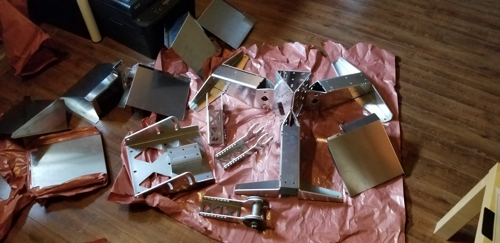

    -Laser cutting and CnC folding Sheets (Grey) After my built i will share the drawing and tuto to make yourself a command of lasercutting parts on a supplier)
    In Blue its a 3DScan of my seat and me , you can see my big nose :)
    See my Drawing image
    @Flymen

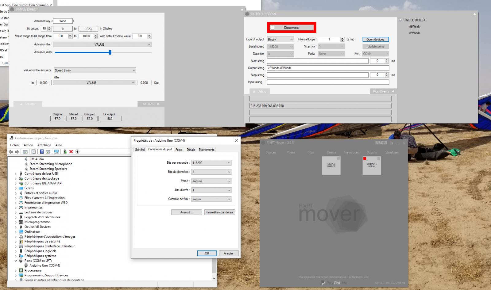

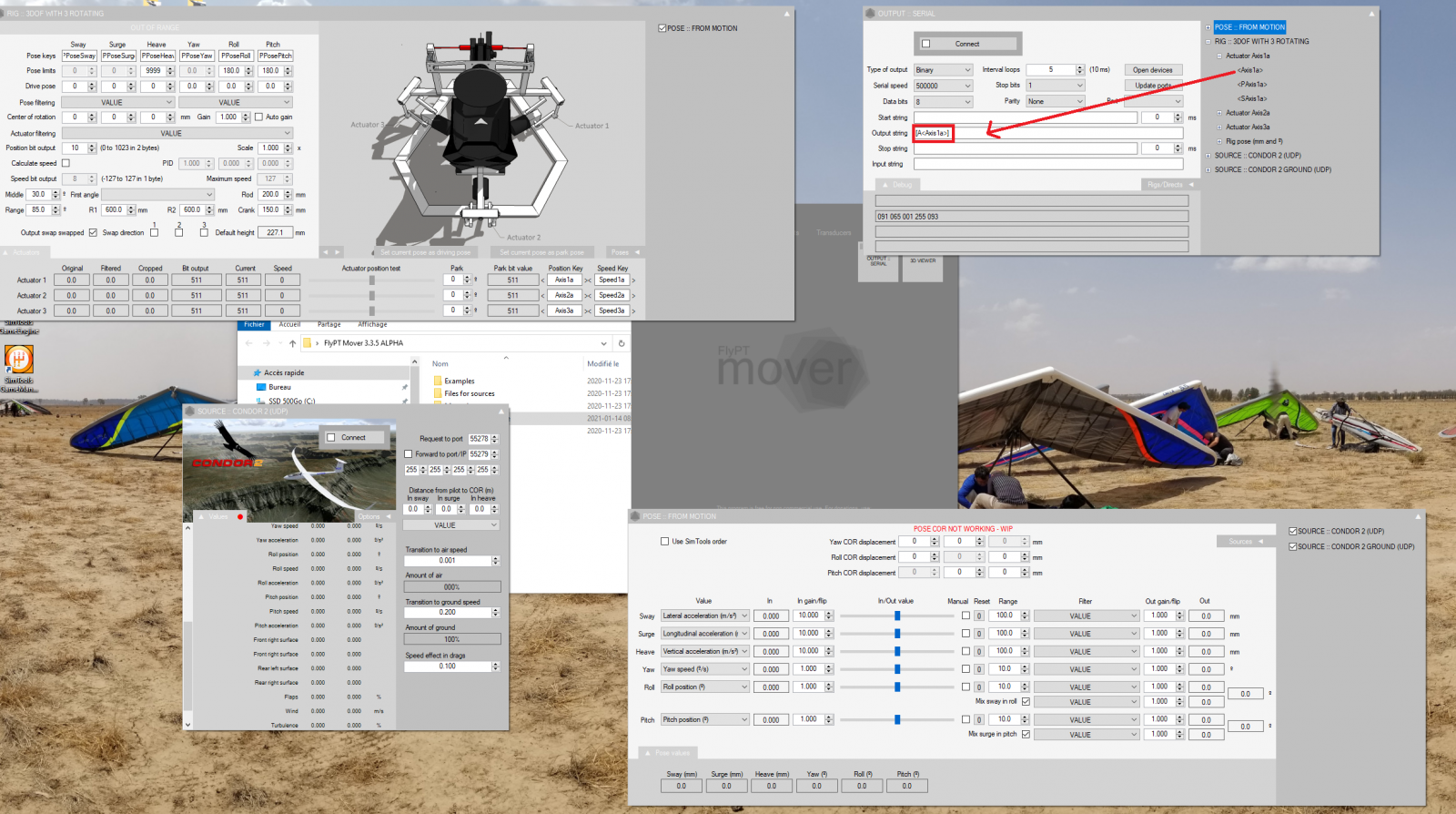

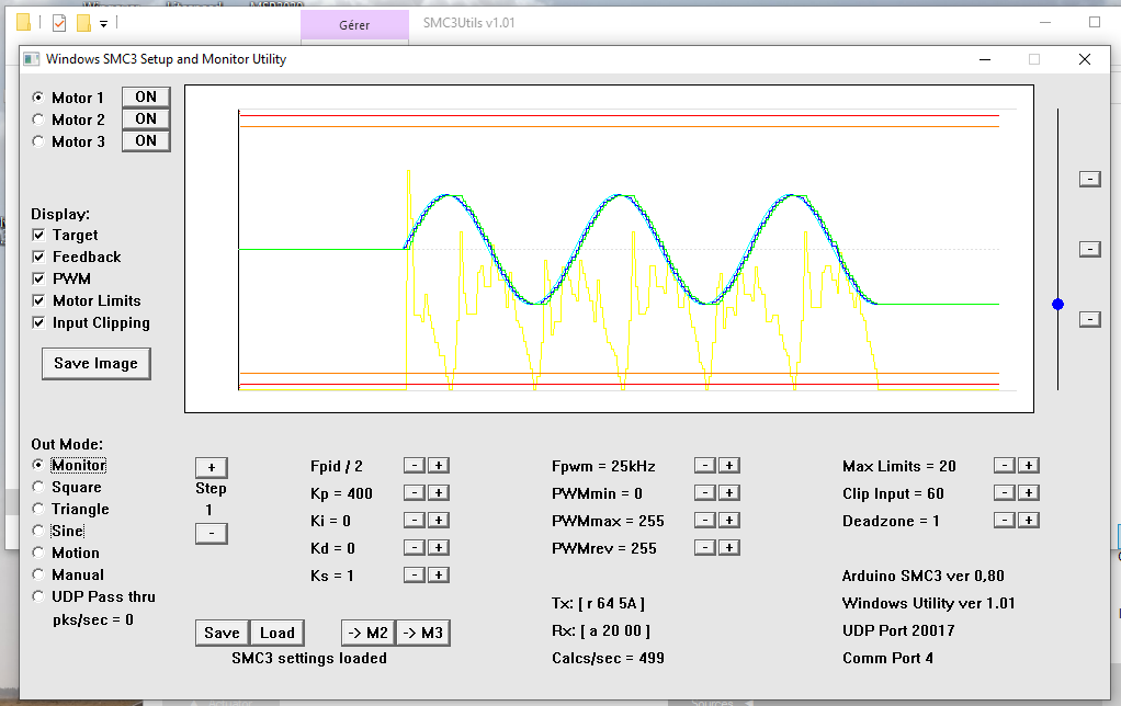

    Troubles,
    i succeeded to Connect The Ardruino and the sabertooth 2X60 on SMC3 with
    @BlazinH Tuto, i Use the SPS_8.2 Soft Start.
    I Resolve With @Flymen My first Trouble , To enable the connection on the Mover Output Serial , you have to close the SMC3 setup. i learn your com4 or others ports Cannot use with 2 application in same time :nerd
    Now im blocked to Connect the Ardruino and the sabertooth To Flypt Mover
    When i move the Simple Direct cursor , the Binary change at the bottom Output serial page , but the motor dont move?
    Im direct on Flypt mover , i dont pass with Simtool . This is the Trouble ?
    Many thanks
    @Pierre Lalancette
    @pmvcda

  5. Marki
    Marki Marki
    Nov 16, 2020
    19
    électromécanicien et Concepteur mécanique
    Montreal, Canada
    128Coins
    +14 / 0 / -0
    i explain my problem in video
    @Pierre Lalancette
    @pmvcda
    (P.s @Flymen you dont recieve the notification because my tread was blocked beacause i put a weblink to SPS tuto.)
  6. Marki
    Marki Marki
    Nov 16, 2020
    19
    Montreal, Canada
    128Coins
    +14 / 0 / -0
    My trouble is Fixed ! All work, i test with condor 2 game .
    My trouble was, i fogot to put [ A < ] in output line [A<Axis1a>] .
    I thought I could click and drag the axes, and it would work like that, but we have to add[ A < ] to work
    Thanks to @Pierre Lalancette and @Flymen to help me! :):)

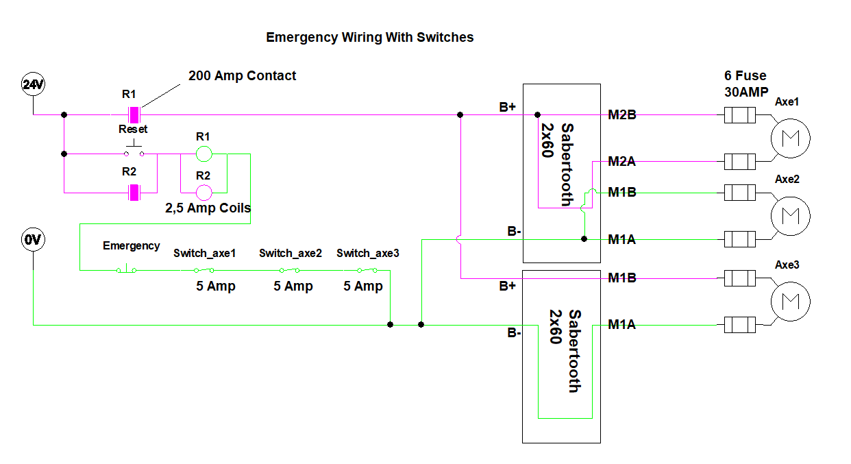

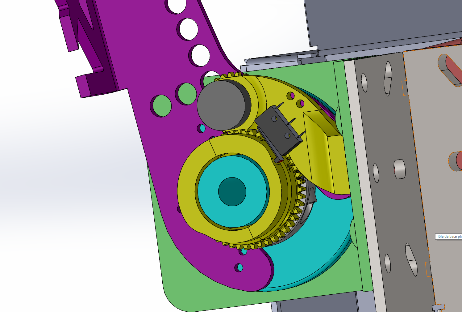

    I don't see any limit switch to your design. Is it something you thought about? It is quite important. I do not recommand to do any moving test without it, once the rig is assemble.
  8. Marki
    Marki Marki
    Nov 16, 2020
    19
    Montreal, Canada
    128Coins
    +14 / 0 / -0
    @Pierre Lalancette
    Thanks for your recommendation.

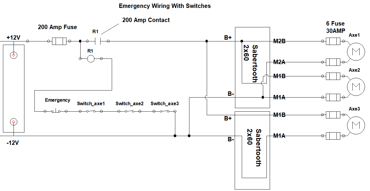

    I'm curious to know How you have connected your limit switchs?
    I have planned a emergency stop with 200 Amp relay.
    Does your limit switch cut the main power or you have another alternative?
  9. Marki
    Marki Marki
    Nov 16, 2020
    19
    Montreal, Canada
    128Coins
    +14 / 0 / -0
    Limit Switch Drawing Done
  10. Pierre Lalancette
    Dec 11, 2016
    1,009
    Tech Artist
    Quebec, Canada
    8,043Coins
    +945 / 6 / -0
    3DOF, DC motor, Arduino, 6DOF
    The way I do it is a closed circuit in all the switches (5 volts) that drives one relay. This relay drives 6 relays (12v) that let the power goes to the motors. If a switch is triggered, the circuit turns open, there's no more curent to any relay and all stop.
    That's my way.

    My Wiring Diagram
    (not tested)

    Hi ,
    Your power supply switching is 24 v dc motor 12 v dc ?
    With your power supply 24vdc you can drop maybe at 18-19 v dc if you play with the potentiometer !
    Don’t forget the batterie 12 vdc on your wiring Diagram .
  13. Marki
    Marki Marki
    Nov 16, 2020
    19
    Montreal, Canada
    128Coins
    +14 / 0 / -0
    My final and tested wiring for emergency
    @Flymen

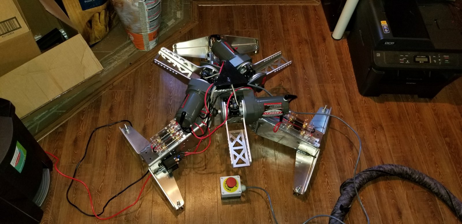

    My project avancement

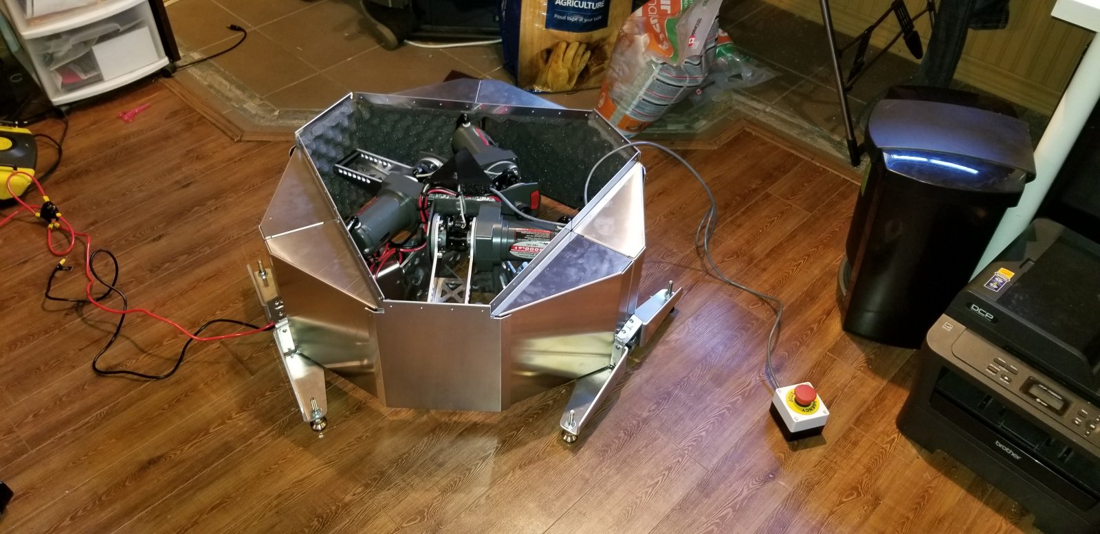

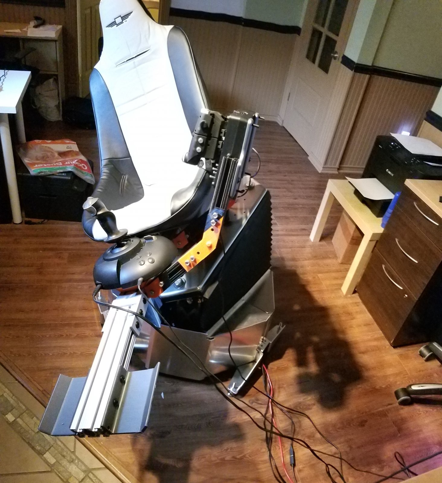

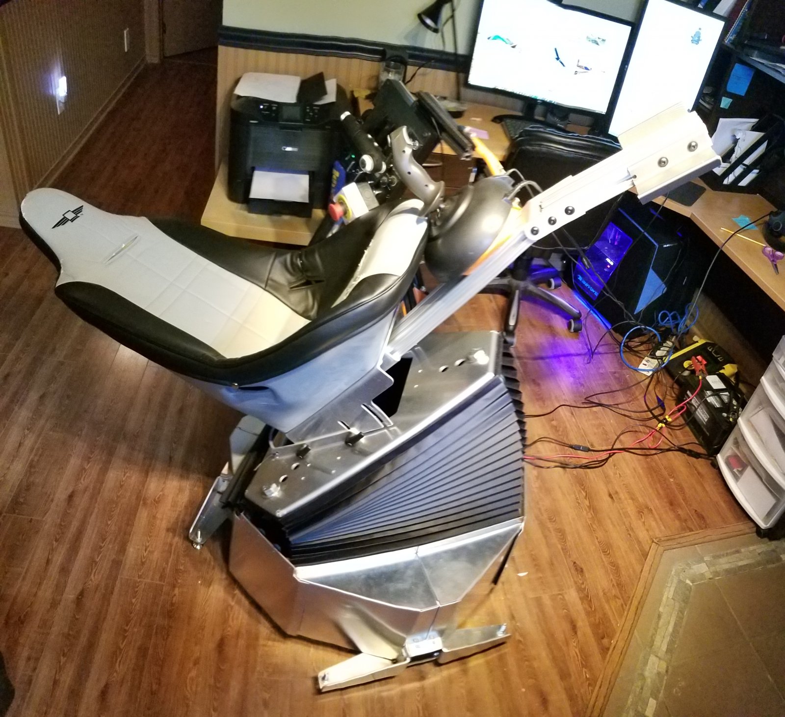

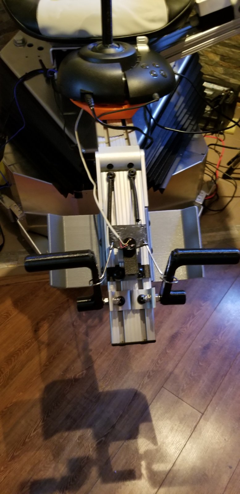

    Assembly is finish!
    I had a terrible backlash as a problem, I fixed it by adding is elastic to keep the arm down and I widened the rodends in the top and centered my position
    Now , my problem is the power supply, i use truck 12v batterie and standard batterie charger (25 amp). but when the battery is in charge , it smells of sulfur. im not sure that good for health . i need to change my power supply . any suggestion for 3x 750w motor DC in 12v ?
  17. Marki
    Marki Marki
    Nov 16, 2020
    19
    Montreal, Canada
    128Coins
    +14 / 0 / -0

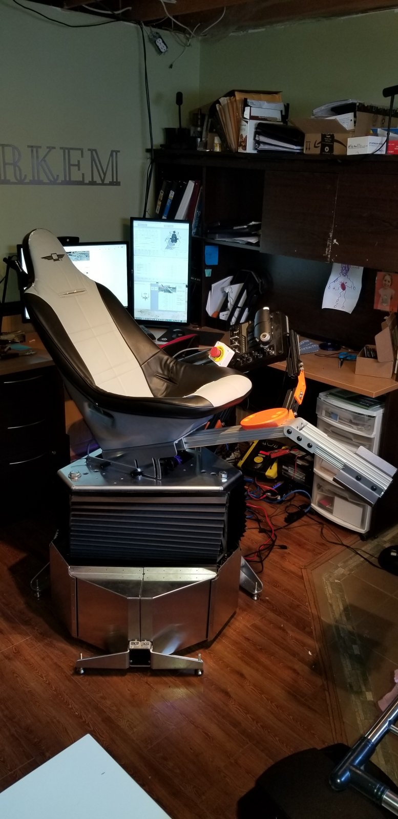

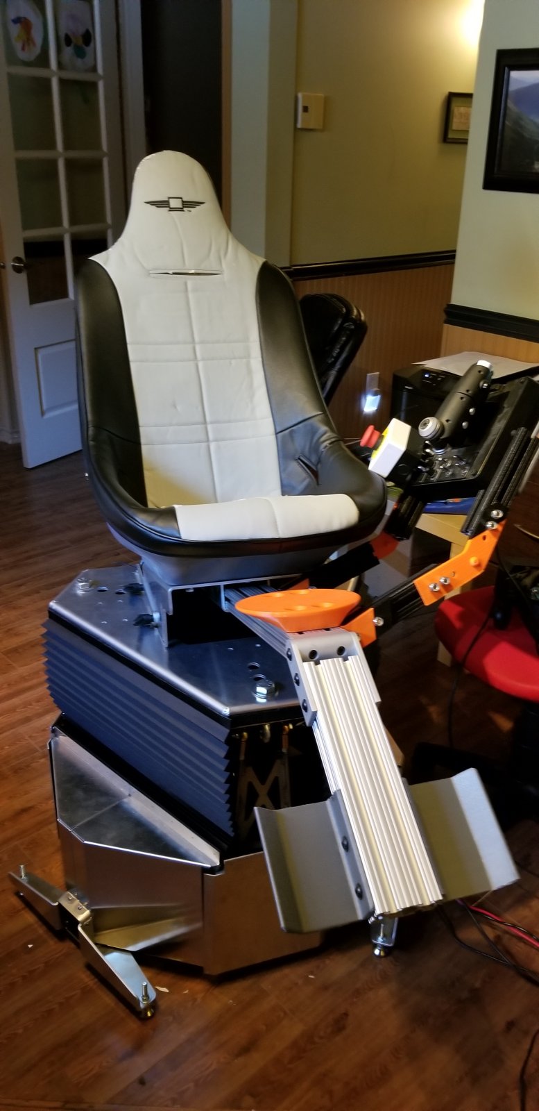

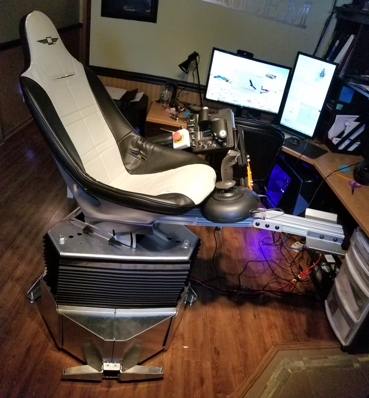

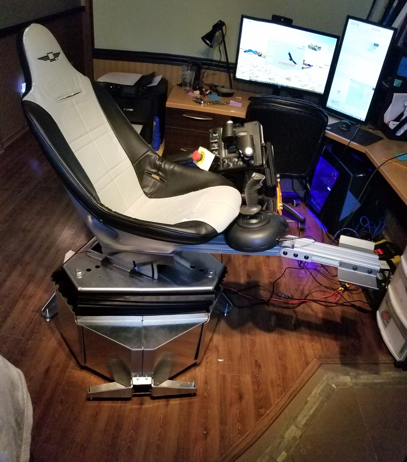

    Hi ,
    Here is the final result of my platform motion
    it largely exceeds my expectations, contrary to what I thought it is silent !! and respond well to the little jerk like the rough terrain when I take off or the bang when I land! that's great!!
    I fixed the backlash problem with 4 bolt here ,
    and for the battery I reduced the leveler of my winck from 8 "to 5" now to draw 10 Amps continuously on the 12v. this is very good and my 25amp car charger is more than enough

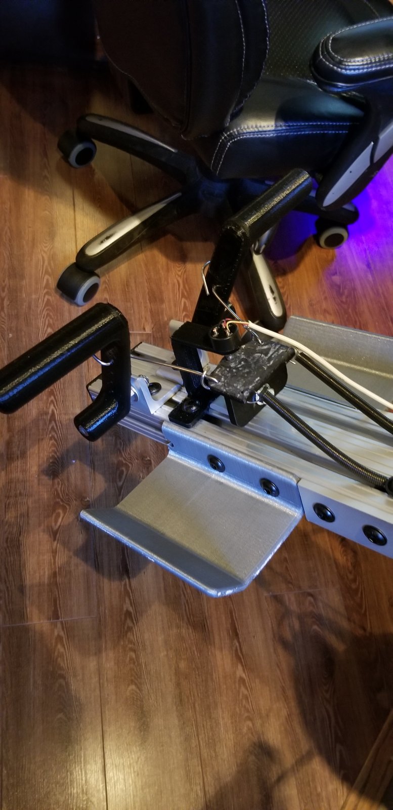

    i added Rudder pedals With arduino code
    https://www.ingeimaks.it/come-creare-una-pedaliera-joystick-con-arduino-uno/index.html
    I recommend this platform to all of you! I am impressed with his performance
