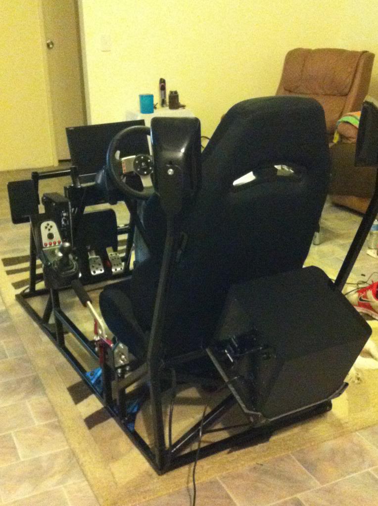

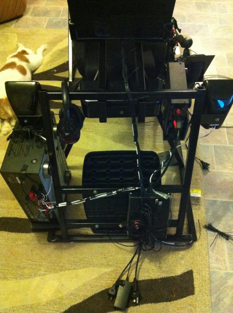

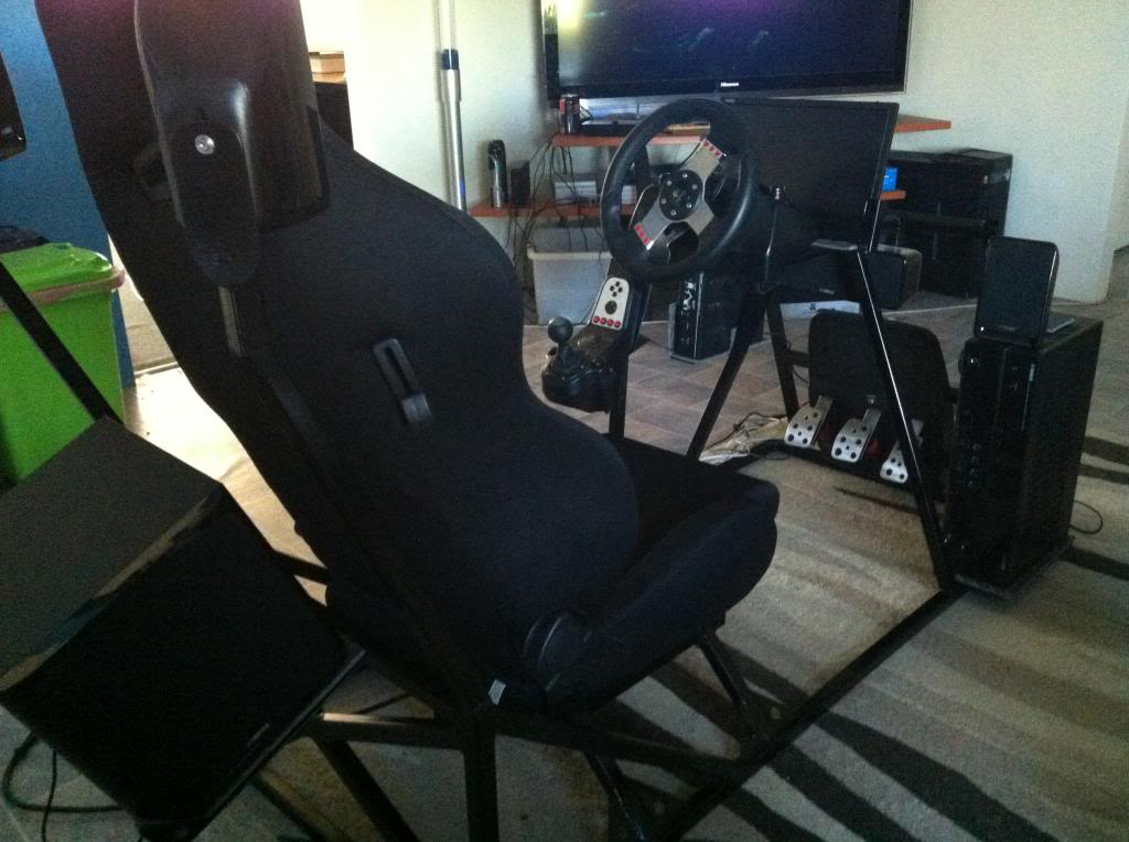

    hmmm well if this motor will struggle to give any compromise to fluid motion i think i might take the conservative approach and get one single motor\wormdrive
    and make a traction loss system on roller bearings , just to figure out how it all works with the PC and pots ect then make a platform+ new alloy rig later on.
    I'm not too sure how to post small pics so i'll put some up the only way i know how and change them once advised
    Specs of rig in sig
    Thats with the buttkicker amp and yamaha 5.1 amp mounted onboard.
    It works well enough but i cant for the life of me figure out how to setup the buttkicker with x sim , at the moment i just have a splitter on the sub output on the yamaha amp. I can build a water cooled gaming PC and a sim rig but no idea what to do with x sim :sos:

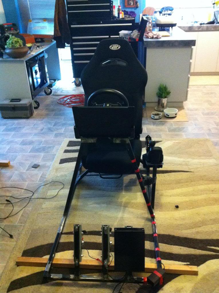

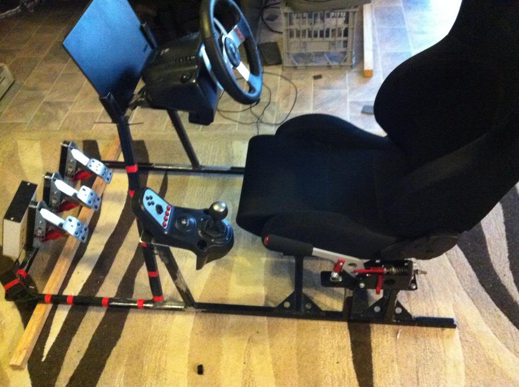

    hey guys ,
    Its been a few weeks since I last posted and I have been a bit busy modifying my static sim to trim some fat
    to see if I can get it down to a reasonable weight in an attempt to use this sim for a motion setup instead of starting from scratch.
    So before I started trimming it weighed 77ish kg on a crappy old set of bathroom scales so +\- 3kg I recon.
    I also jumped on the scales and to my dismay im the heaviest I've ever been :( 95kg ,looks like i'll be trimming some fat too.
    I think the redesign is a lot more practical although I have nowhere to put my screen in the meantime :?
    so without further ado
    All amps\speakers removed , whole backend removed and a major frontend redesign.
    The weight loss program (lol) has my sim now sitting at 40kg+\-3 with all the gear on it, so effectively i'v halved the overall weight and will only need to move 130kg-150kg hopefully less once I get my ass into gear and loose a bit myself lol.
    All of the red electrical tape is only temporary and will be replaced with zip ties once fabrication is complete and rather than add more weight with a triple screen setup i'm considering the possibility of using an Occulus rift ,maby helmet mounted ? hhhmmmmmm
    My tax return is on the way and im hoping on having enough to buy some bits for this and the CNC router project I have going.
    so do you think I have a chance of using the worm drives linked in the OP now ?
    or do I still need to do some serious physical training to shed some more kg's myself ?
    Cheers,
    Travis

    Yep, that will work.
    Either build a big t-bar at the back of the seat and move it from the shoulders at rear (better option overall for moving a frame, but takes up space), or mount motors towards the feet underneath (more compact).
  12. eaorobbie
    20,463Coins
    +1,686 / 23 / -2
    Well, well, the fat is trimmed, as value1 stated its now time to find the balance point for the rig. Need to mount the screen and driver, place something like a broom stick under it and have a friend push you forwards and backward till you find the exact longitudinal balance point on the base. This will show you where the uni joints centre needs to be to achieve a balanced design, as in the point where the force that's needed to pitch forwards is equal to the force need to pitch backward. I would strongly recommend that you mount the motors push rods to the shoulders on a T Bar to help with the weight, mounting them higher (greatly) form the pivot points centre will majorly decrease the force that is required to hold lever/push the sim. Simple physics of leverage.
    So cut to the chase, you are on the right track , Well done, time to move on and build a base, buy some electrics and join in the fun.
