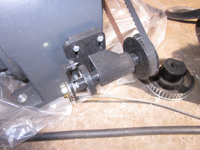

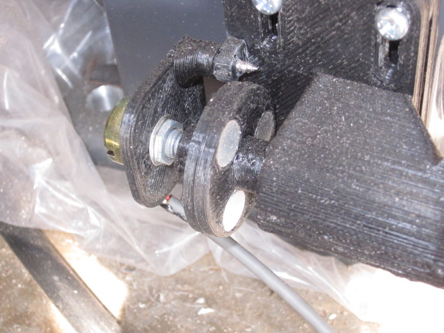

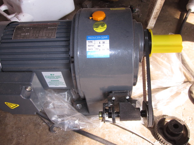

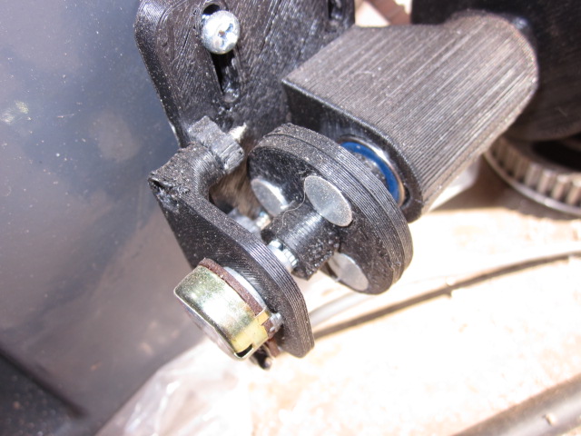

    I made by 3D printer. For protect POT from some error by software or controller.

    Excellent work, trying to understand how it works if there is an error and the motor over-runs - some type of slipping clutch?
    Looks like your building a big AC rig - nice.

    Yes, same slipper clutch.

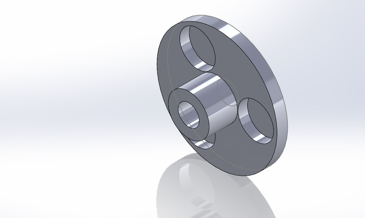

    Sketch. I'm use 6 magnets (3 per side).

    Ah, now I understand, excellent work.

    Excellent idea
    Also a shearpin of some soft material (matchstick) will work
