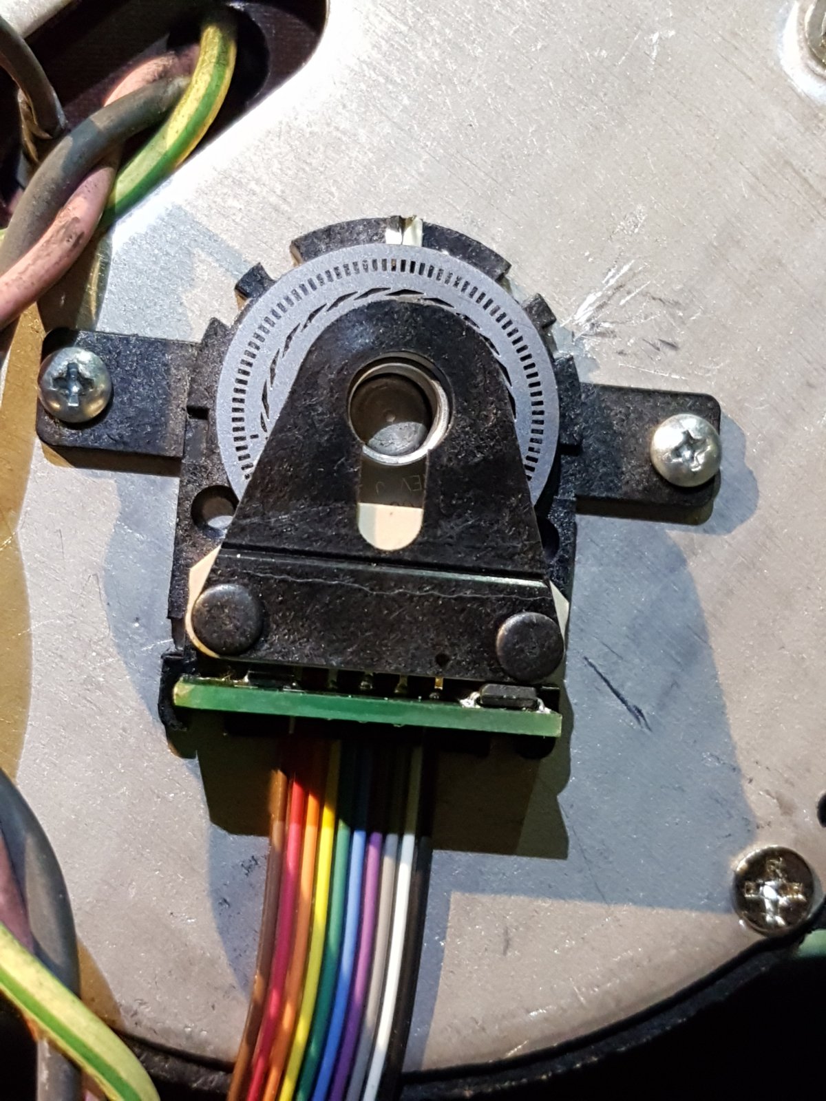

    how about a cool picture of the BEI optical encoder with the cover off , its pretty amazing how small the holes are in that disk. 20160916_234440[1].jpg
