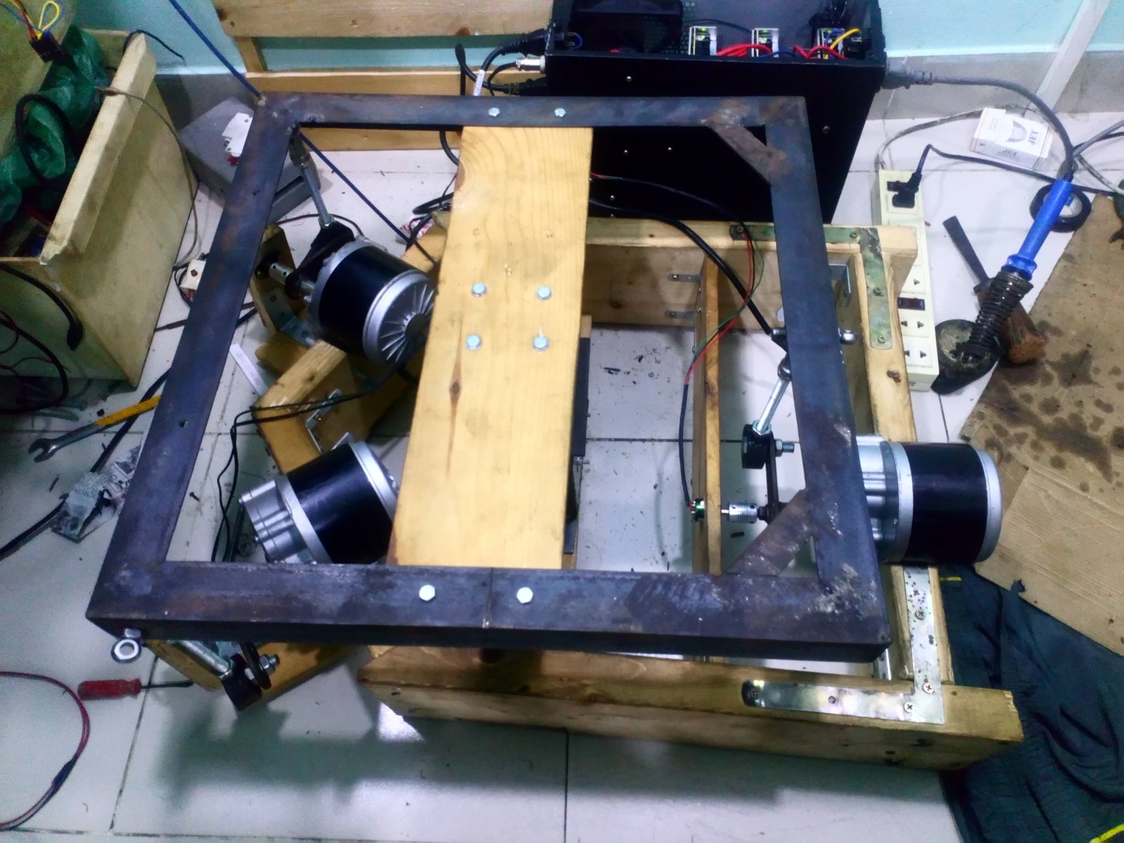

    I read somewhere on the forum that you said this motor is suitable for mounting on the back of a shoulder chair.

    i use 3 motors for the up and down "heavy" shaft. I weigh 70 kg . when operating the engine is hot and drops

    i plan to change 3 other engines using the gearbox so i should not use any ratio 50.1 or 60.1

    Hard to say without knowing the full specs of the motor and gearbox, I use 200w motors with 60:1 on my compact rig, which has unusual sprung heave assist.

    Unrelated to the question but motors that are shorter and have larger diameter like these, have larger rotor inertia. That means they are more difficult to change direction and some small details in motion feedback will be loss.
