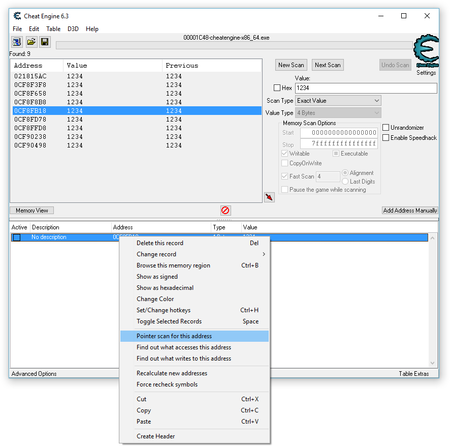

    @value1 you must have a secret to finding memory pointer addresses, you have the patience of a saint :)
    With LunarFlight I can get the memory locations for Roll/Pitch/Yaw only problem is that there are about 3 addresses producing the exact same information so other than doing a pointer scan to the start of each address then restarting the game then finding the same 3 memory addresses again then trying rescan of these addresses in each of the 3 pointer scans. That means a possibilty of 9 rescans and then I restart the game to scan them again and there seems to be the real chance of me getting muddled up that I rescan all the pointer scans and get nothing lol.
    I'll get there, I can find the values easy enough its just the pointers I'm having a hard time with.
    I can get the values into simtools and get movement so its just these bloody pointers !!!!
    hopefully tonight I will have a breakthrough :)
  20. value1
    Jan 9, 2011
    2,184
    Zug, Switzerland
    14,981Coins
    +3,332 / 11 / -1
    Hi Craig

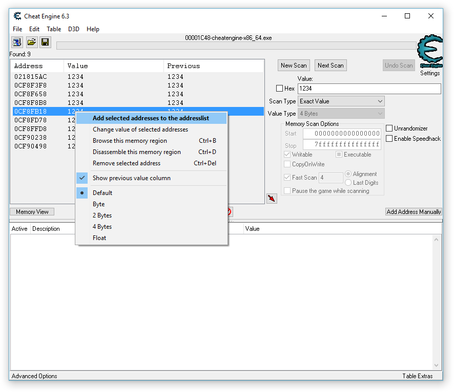

    To find a pointer, find your Roll, Pitch or Yaw memory location. Add this location to the lower window in CheatEngine:
    In the lower window, right-click on the address and select Pointer scan for this address:

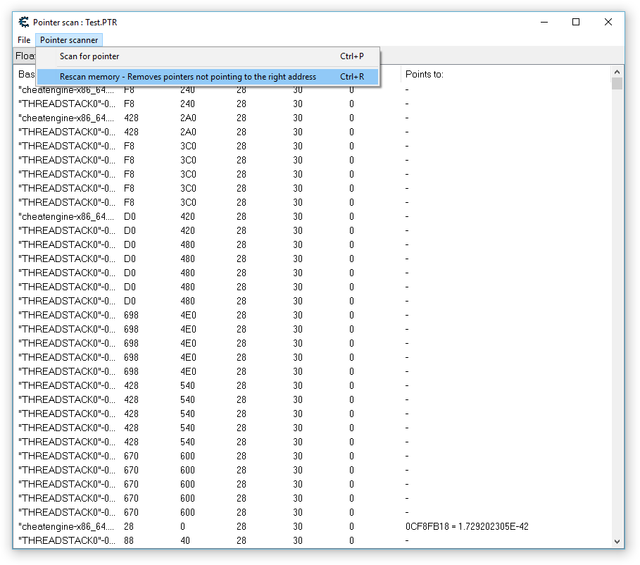

    This will take a while until all the pointers are found (there might be thousands…)

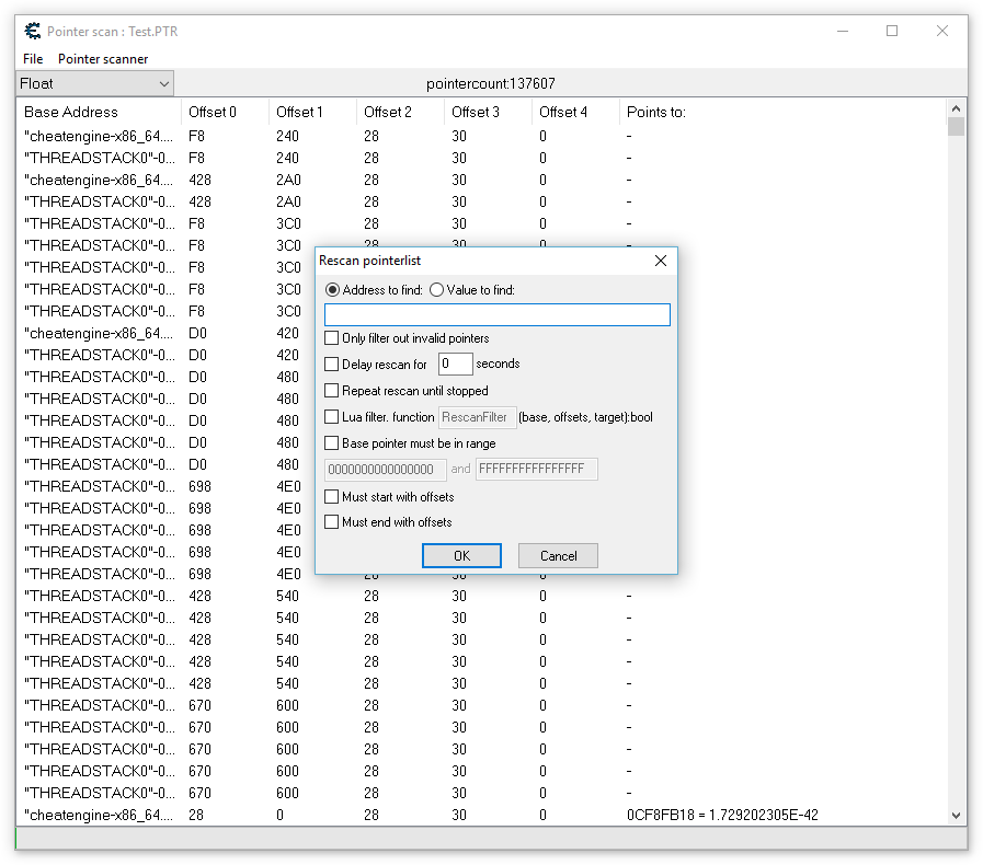

    Restart the Lunar Flight simulation and find the (changed) Roll memory location again.
    In CheatEngine re-do a pointer scan by rescaning the memory with the new Roll memory location
    Repeat this step several times until you have found a *really* stable pointer to the Roll memory location.
    It can be that there still are thousands of stable different pointer combinations.
    Just take a simple one.
    Hope this helps!
