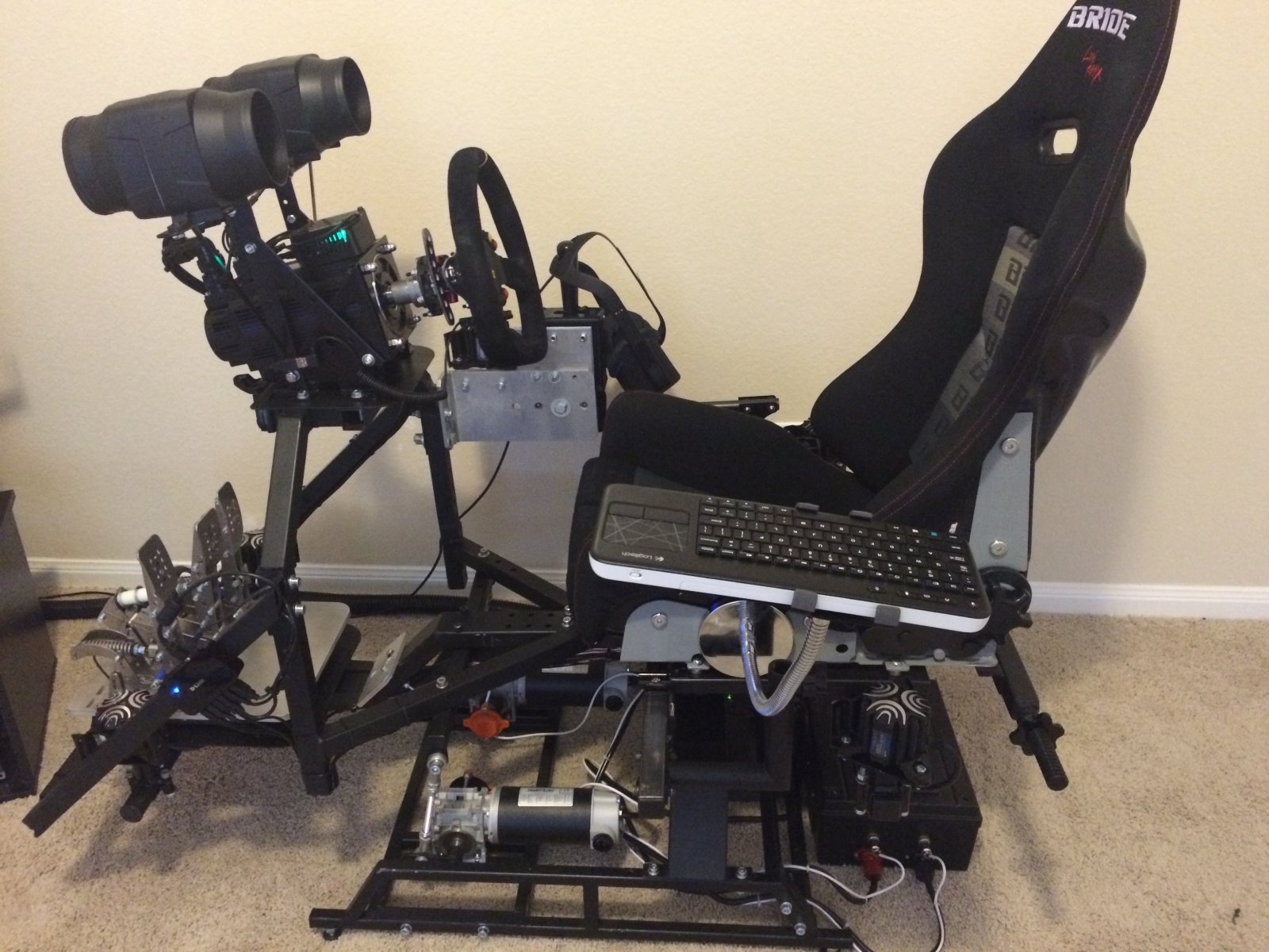

    I don't plan on switching to 2.0 until I absolutely have too. After spending countless hours getting dirt rally to work im sticking with 1.3
    Now I'm just waiting on my upgrade 3dof add on I ordered to arrive. :)

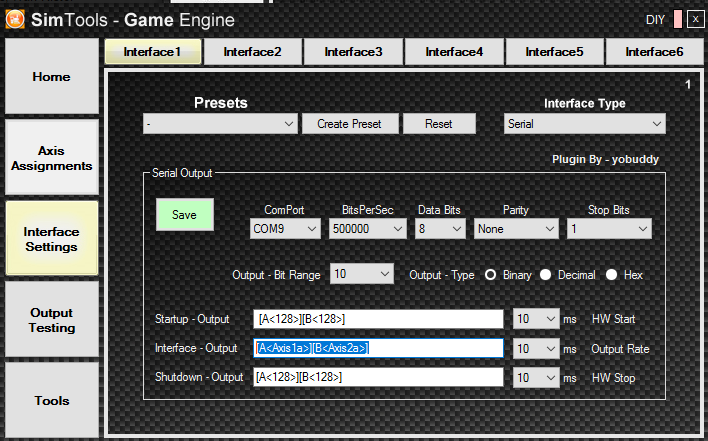

    Guys I just installed simtools 2.0 but I have lost all the communication with the control box.
    I have configured the interface settings again, but im not absolutely sure the settings it used to work in 1.3 are the same in 2.0.
    Could any one confirm this?
    Thx

    I found the problem,
    I changed the interface output including the "a" letter after the 1 and 2.
    I hope this
    Perfect It works!! Thx

    @aceinthesky Is this the standard motors in the kit, or are they upgraded?
