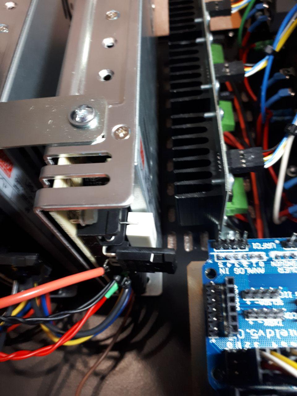

    1. PSU noise, it seems like fans run way too fast, i believe its a common issue as many other users reported it too. Afaik it could be fixed by adding resistors, not sure how, but will look into it later cuz its not that much of an issue.

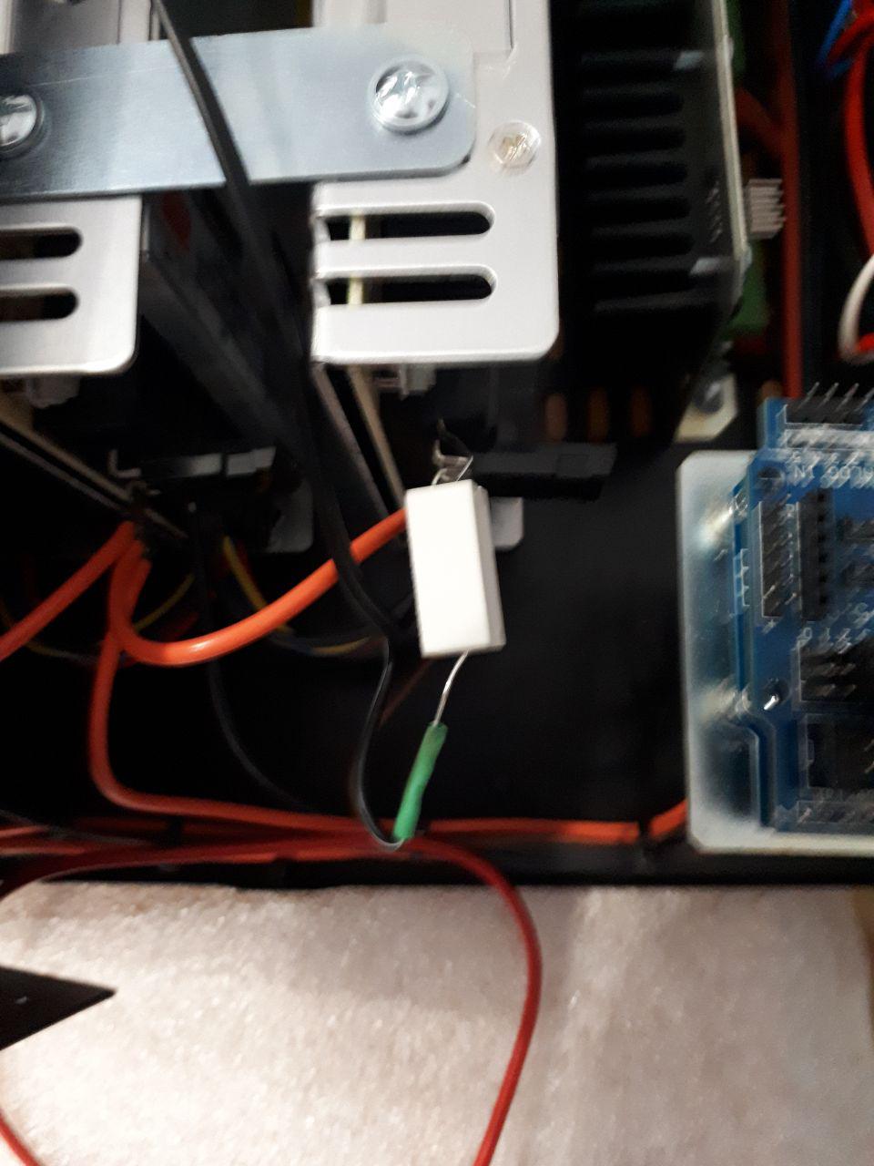

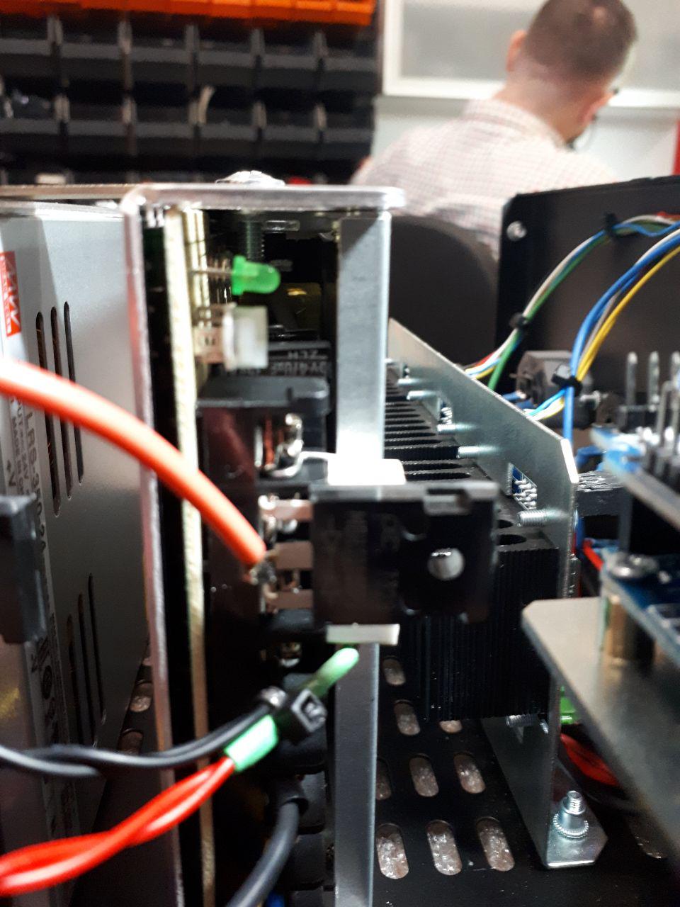

    hug:if you want to reduce coller noise you can install 130-150 Ohm, 5 Watt resistor in the collers line, as serial connection on the way of black or red wires

    collers noise is solvable with the post above. rear motor high pitch is solvable by replacing Arduino UNO with Mega. we just indroduced all this changes to a all upcoming batches

    for MEGA replacement pls contact sales@dofreality.com. there is a need of new firmware flashing and shortening pin 9 to 8 and 10 to 12 soldering wires on the back of it.

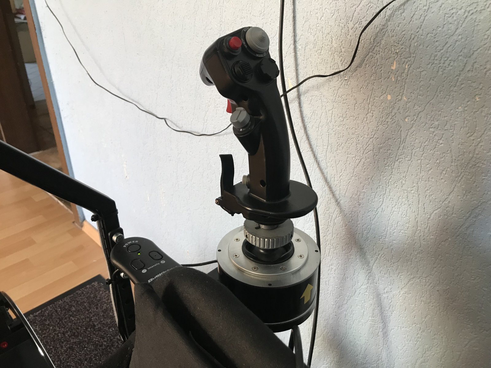

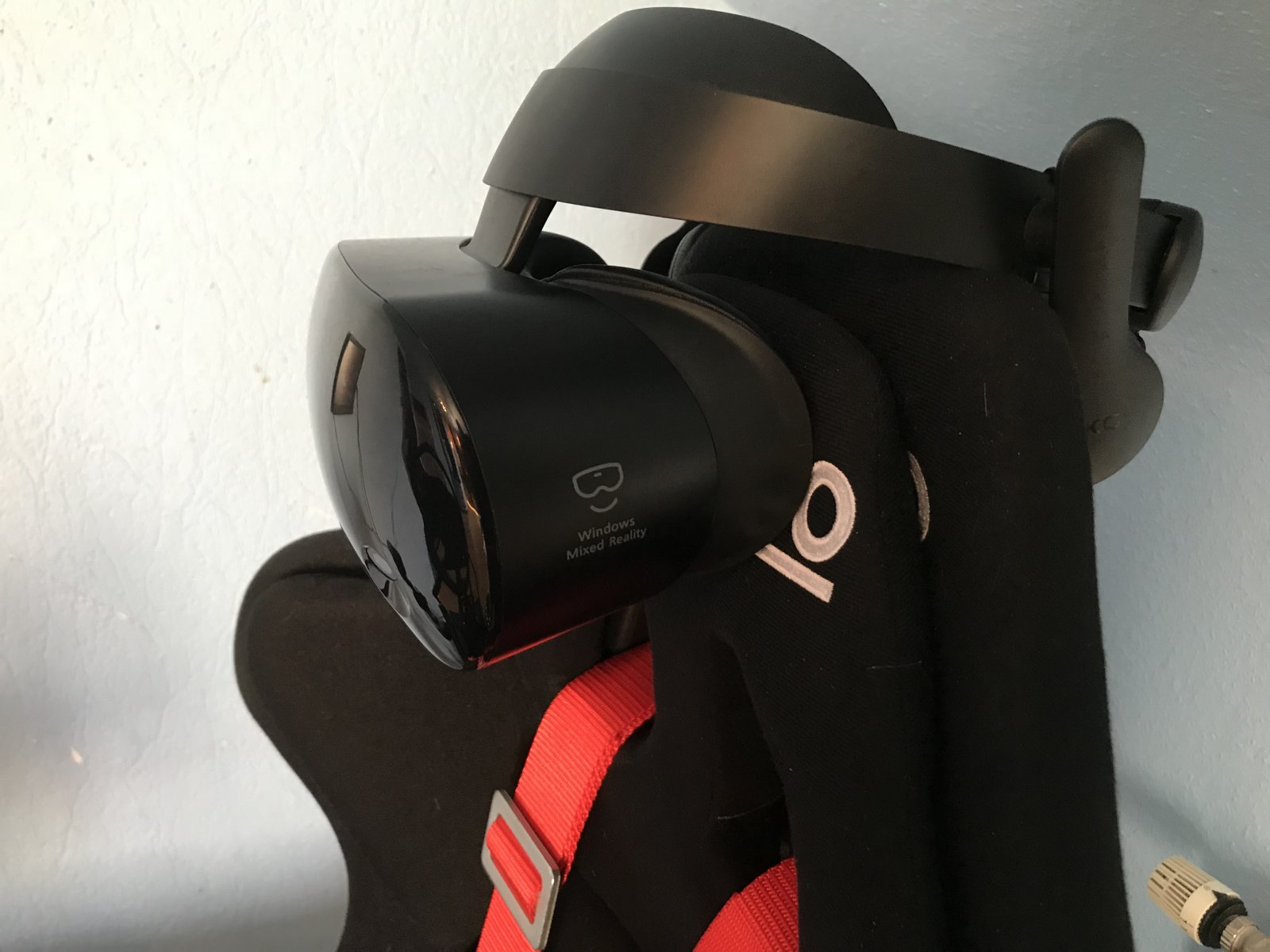

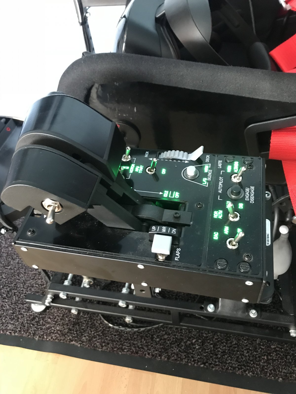

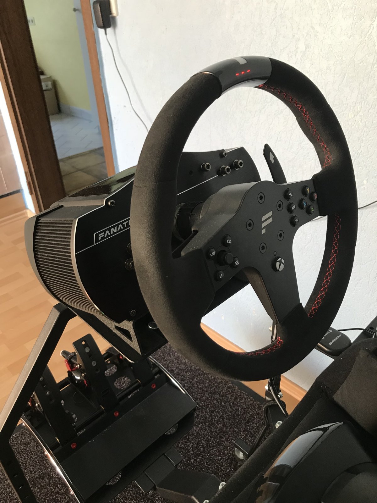

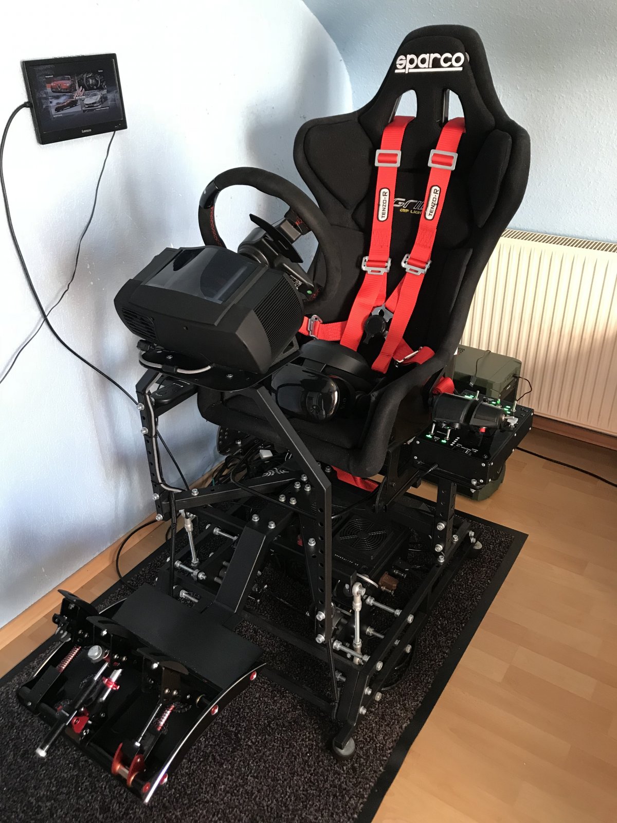

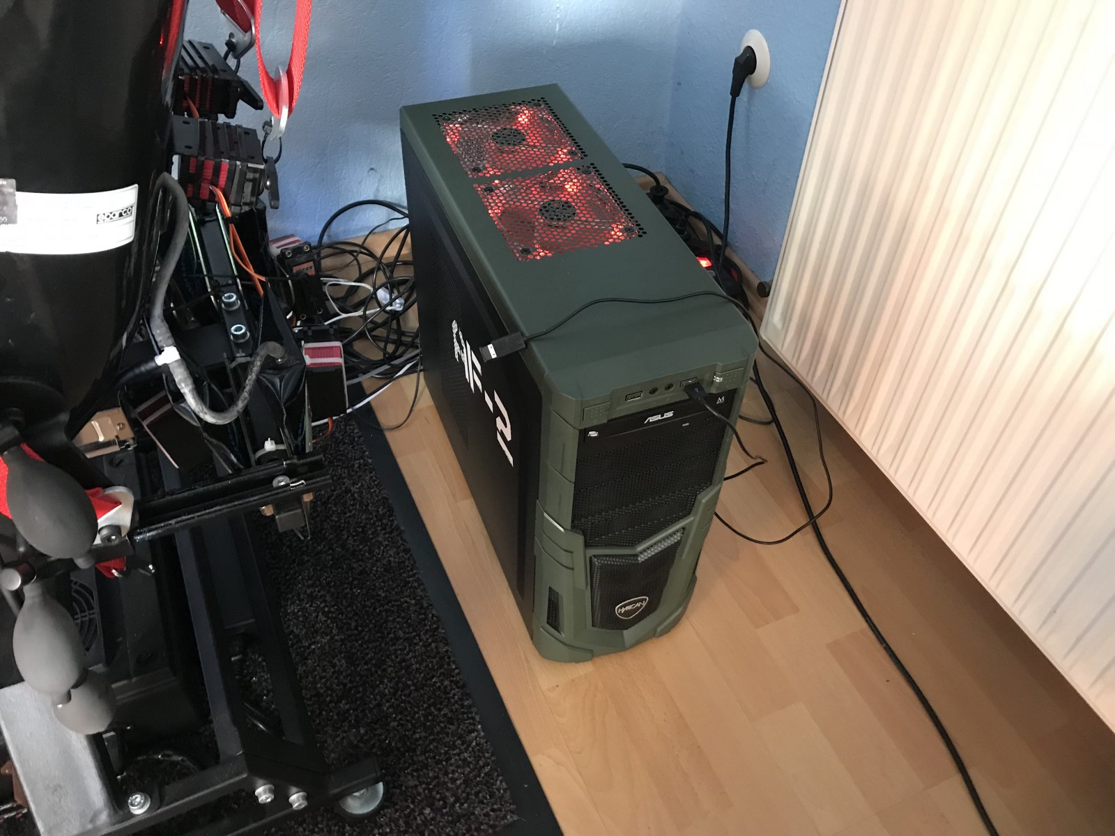

    My H2 from DofReality

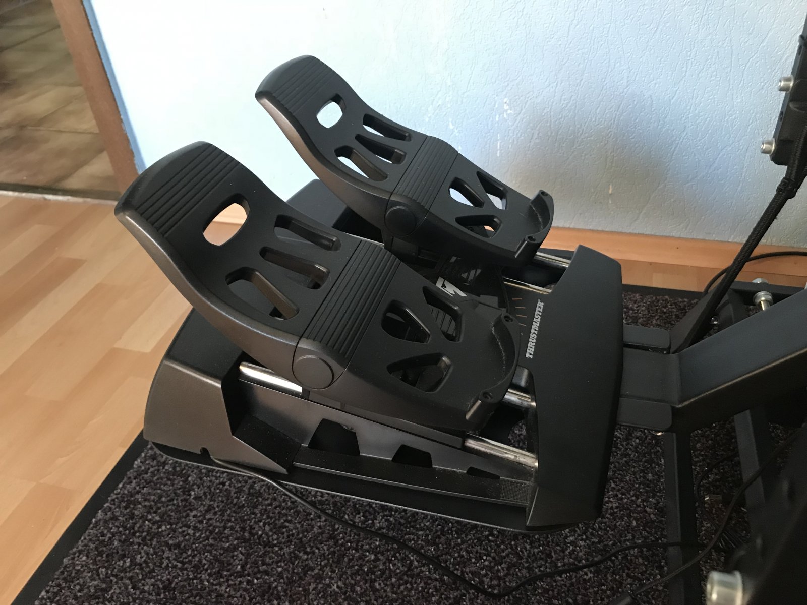

    equipped with Fanatec clubsport v2.5 base and P1 steering wheel...

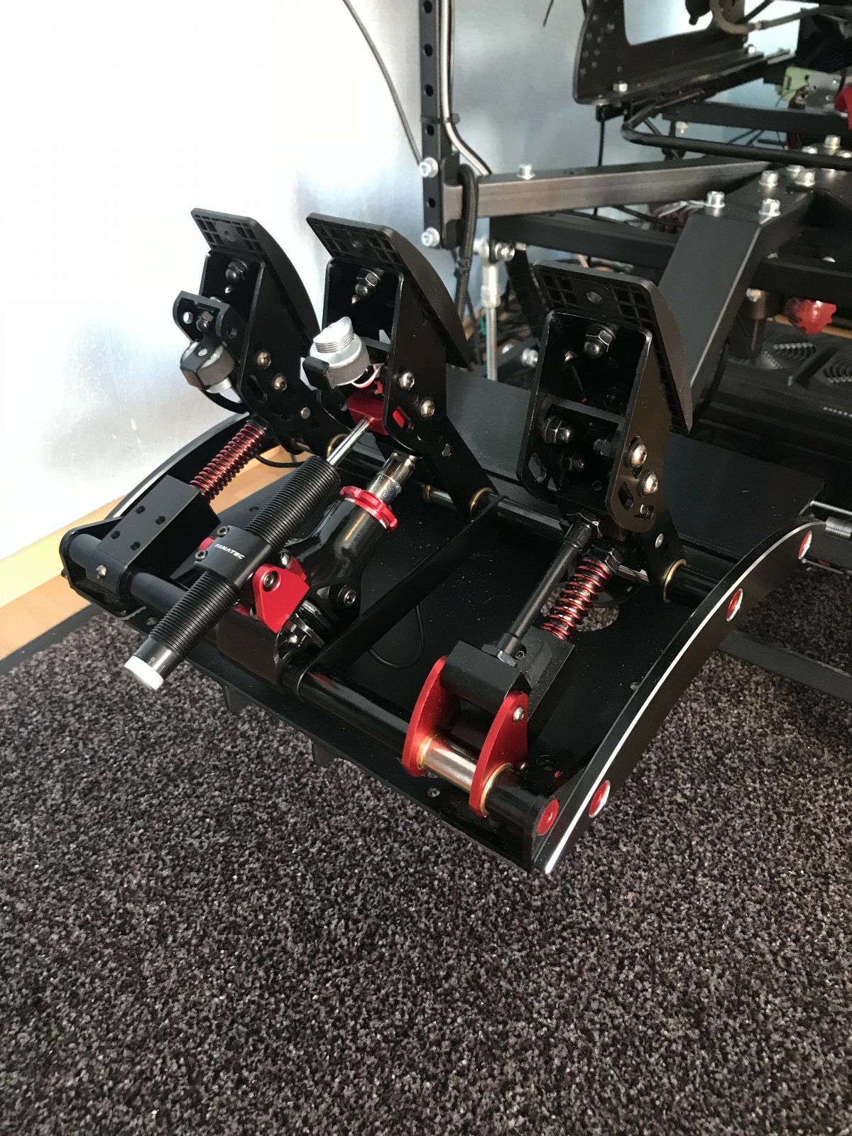

    fanatec clubsport pedals v3....
    Gaming PC I5 GTX1070ti...
    Samsung Odyssey...
    and fly thrustmaster hotas warthog stick....
    thrustmaster flight rudder pedals...
    thrustmaster flight control system...
    ButtKicker...

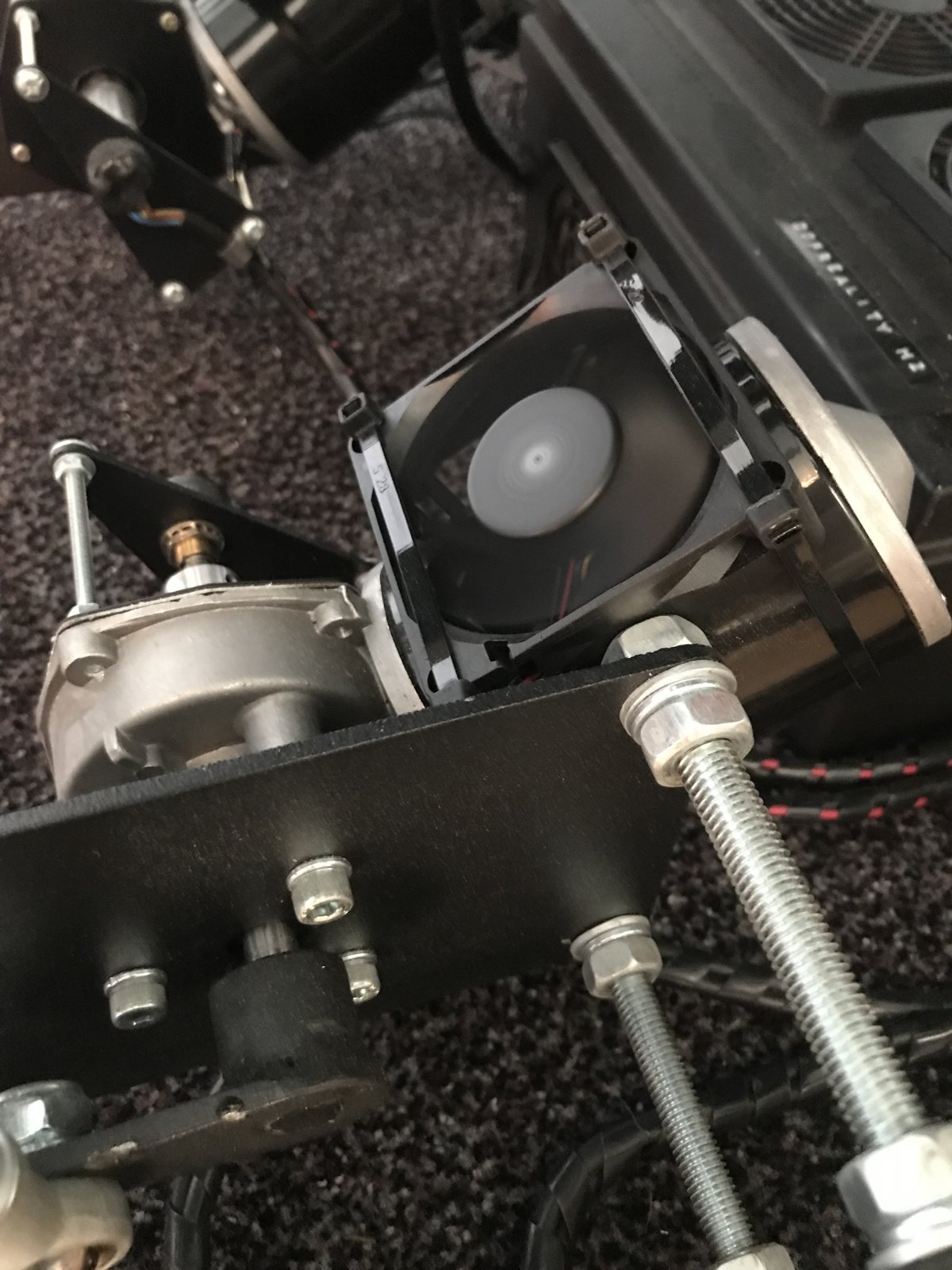

    Extra cooling for the engines...

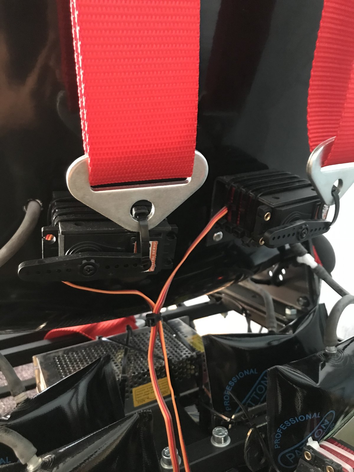

    Harness Tensioner...

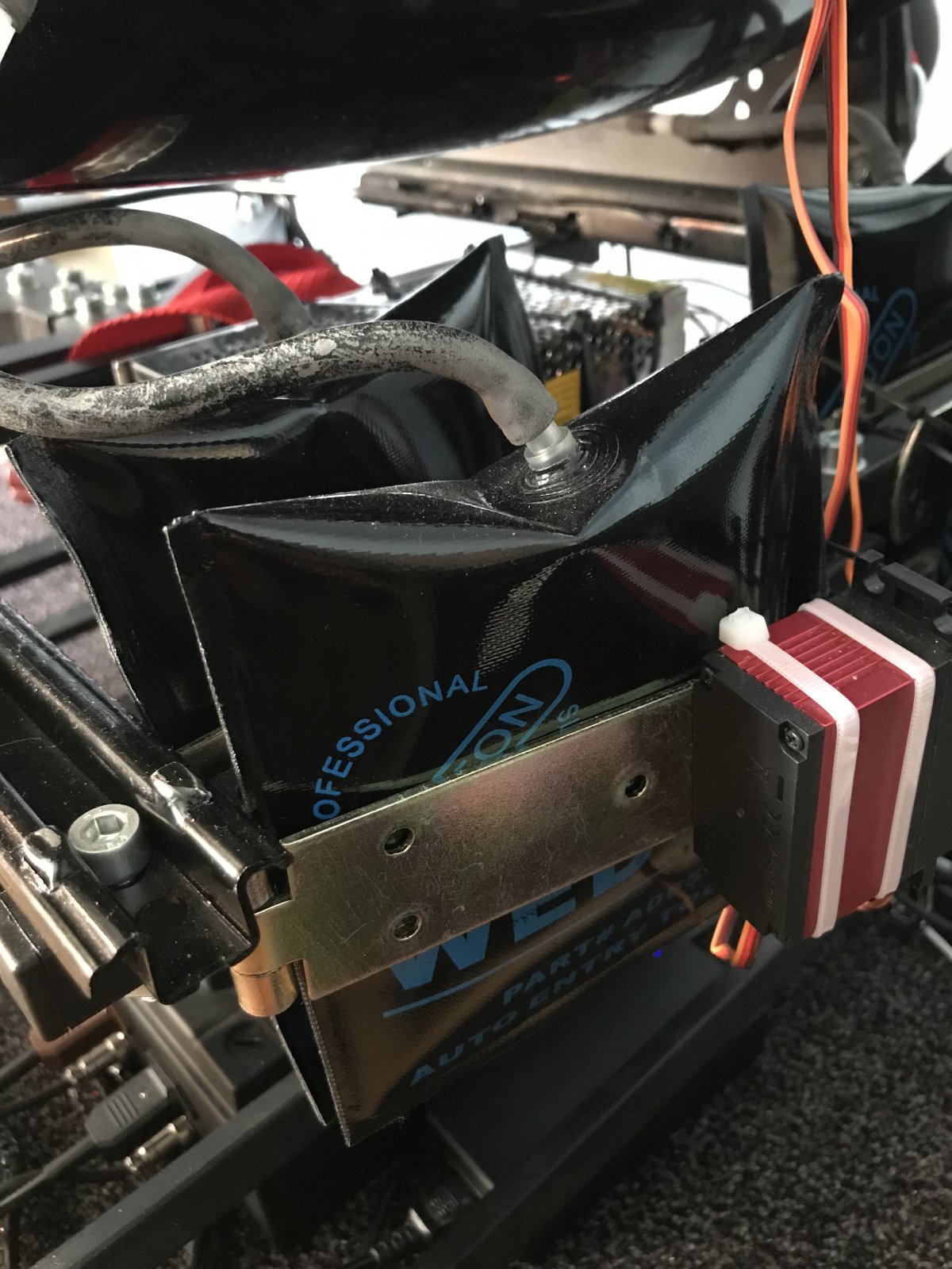

    pneumatic G Seat...
    everything works great with SimTools

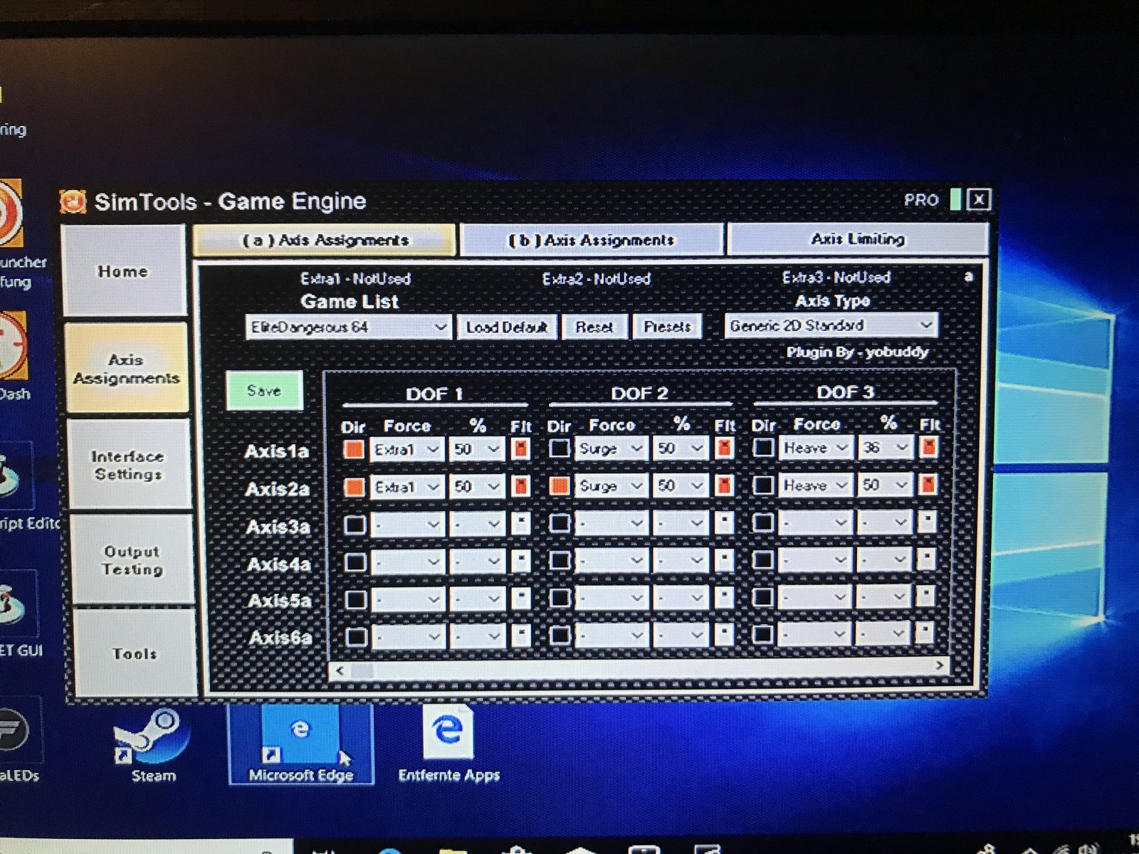

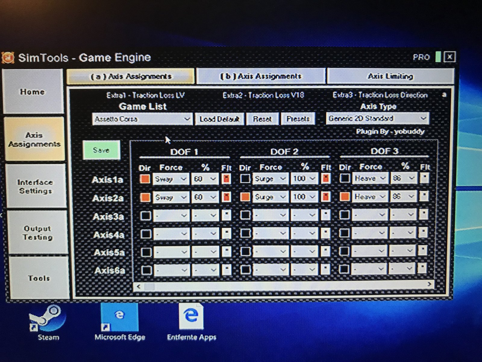

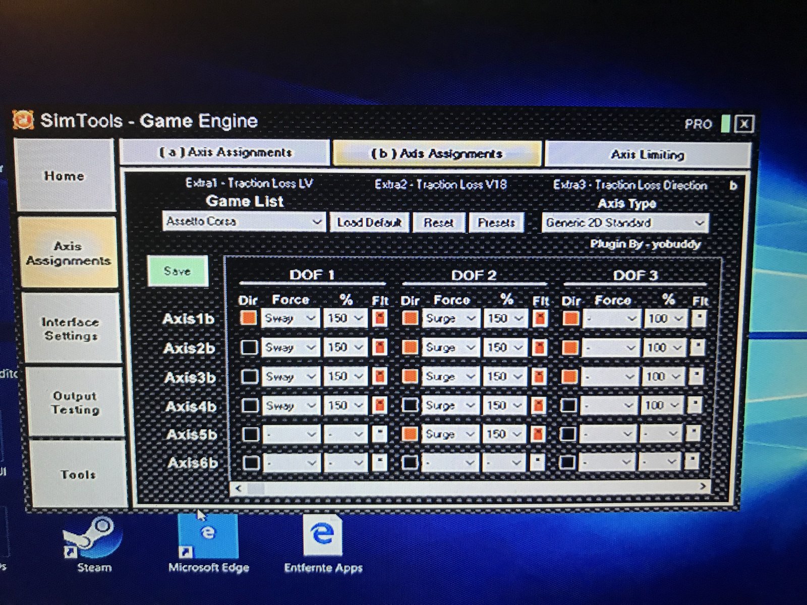

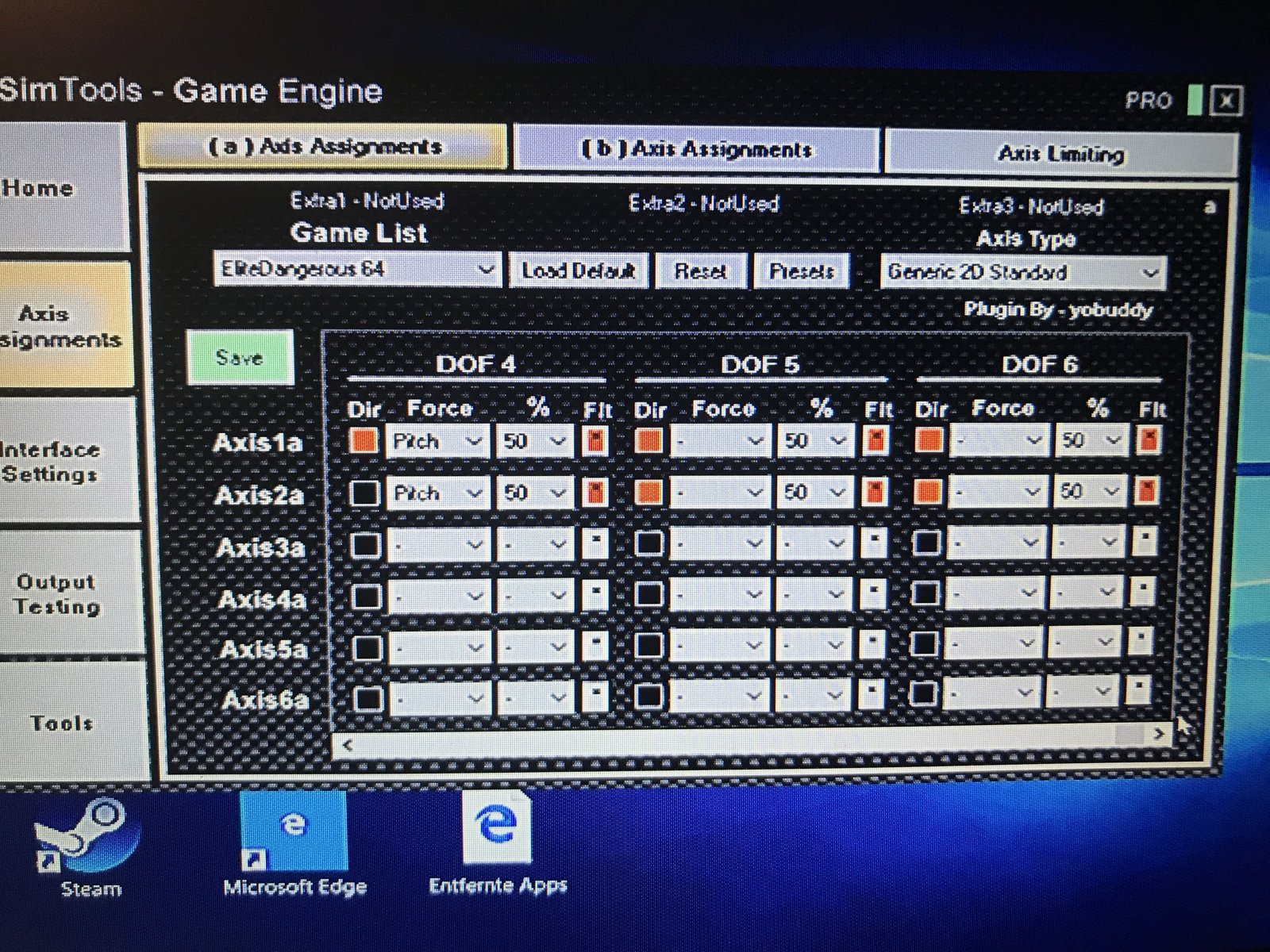

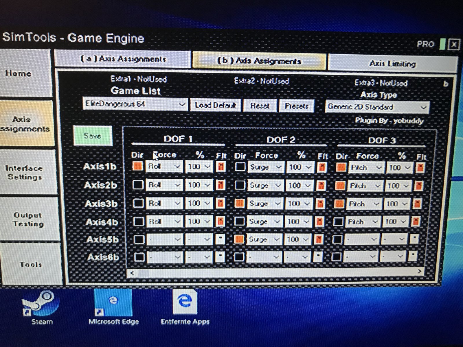

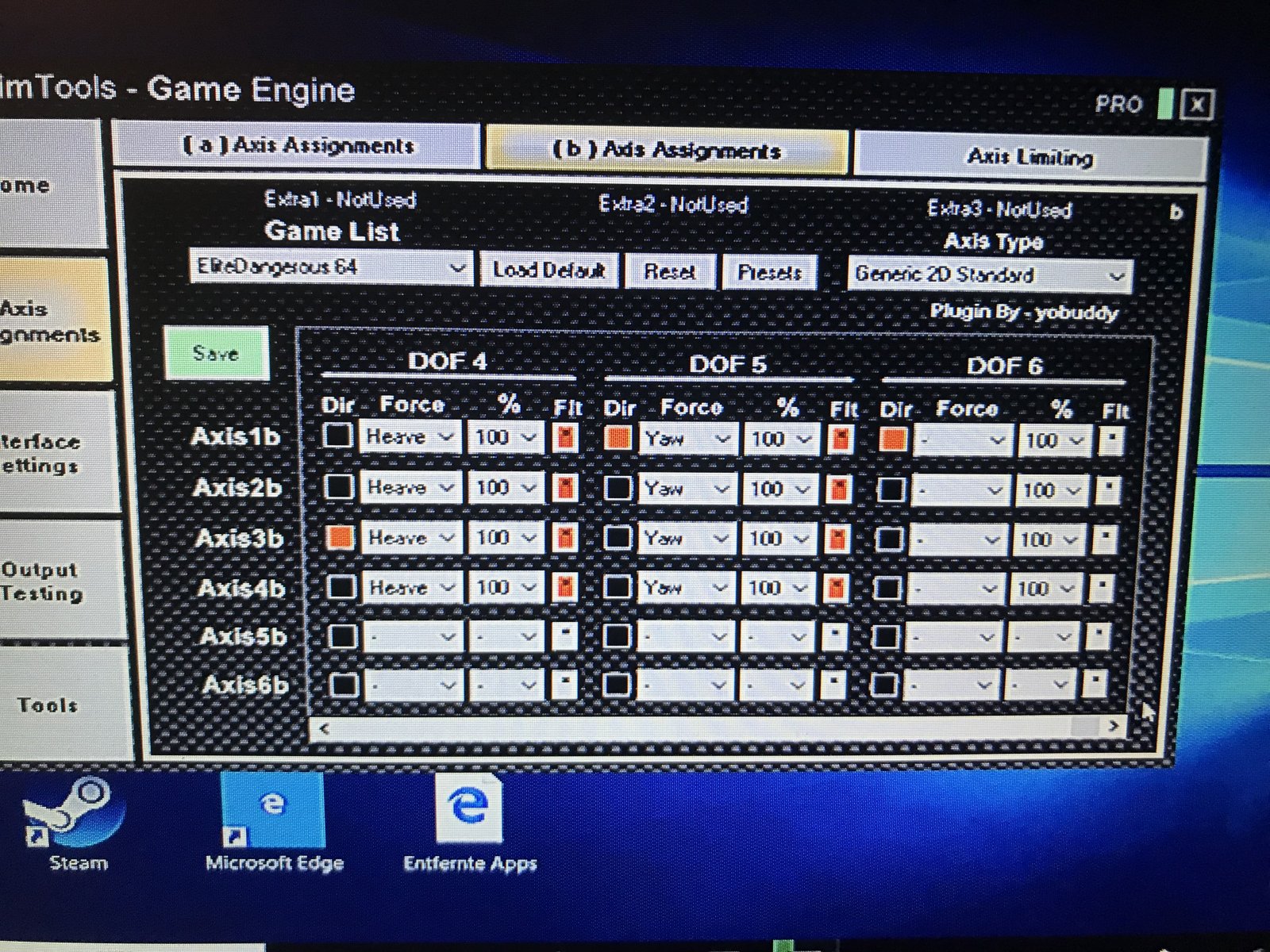

    My settings ...
    AC for H2
    ...G-Seat...
    Elite for G-Seat "Axle 5b is the Harness Tensioner"
    and H2..

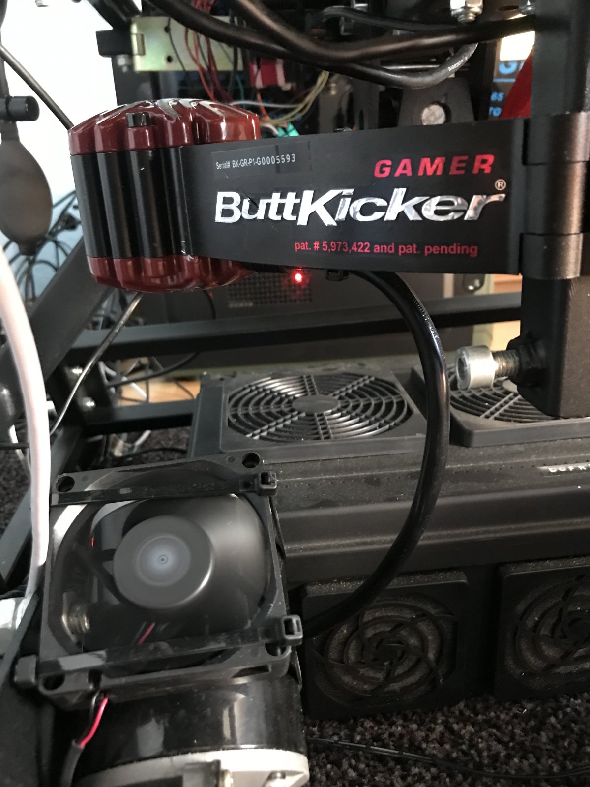

    What do you think about the buttkicker 2?
    Do you think that using transducers and generic amplifier meant for sim is better?
    I live in USA
  15. marco balletta
    marco balletta Member
    Jul 7, 2018
    187
    1,445Coins
    +33 / 1 / -0
    It is a beauty ! Thank you for sharing !
    Do you think the buttkicker is enough?
    Have you tried other solutions?

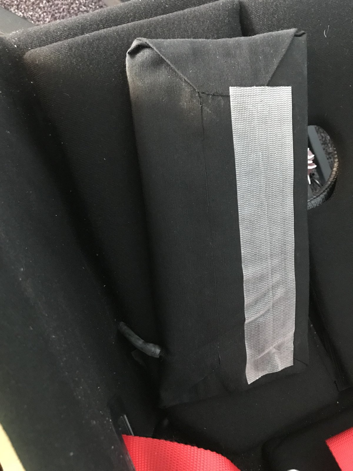

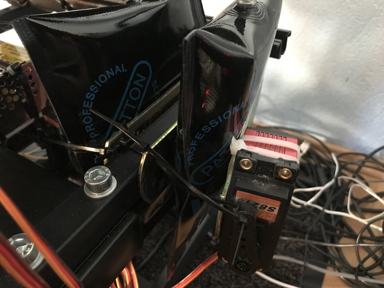

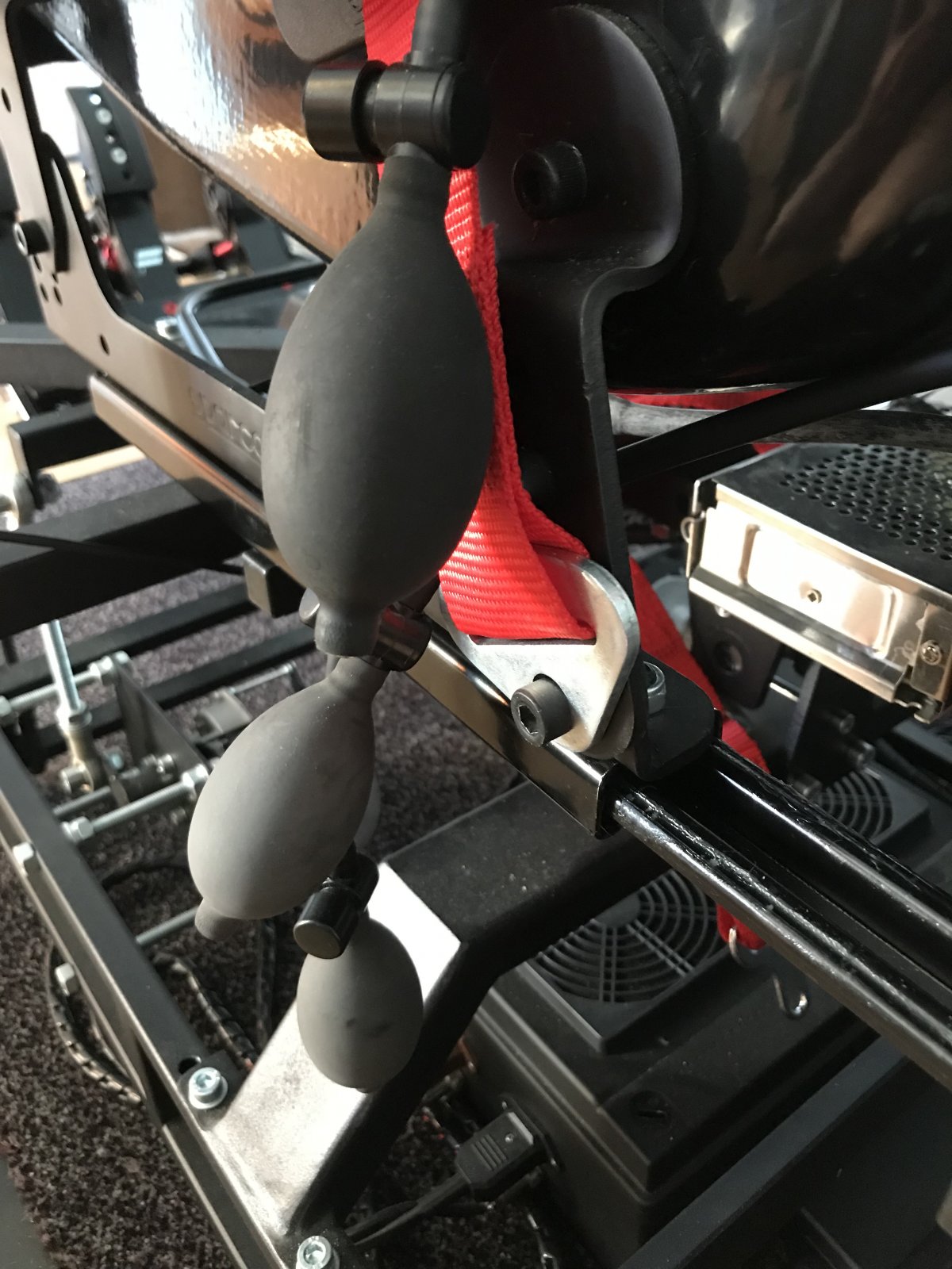

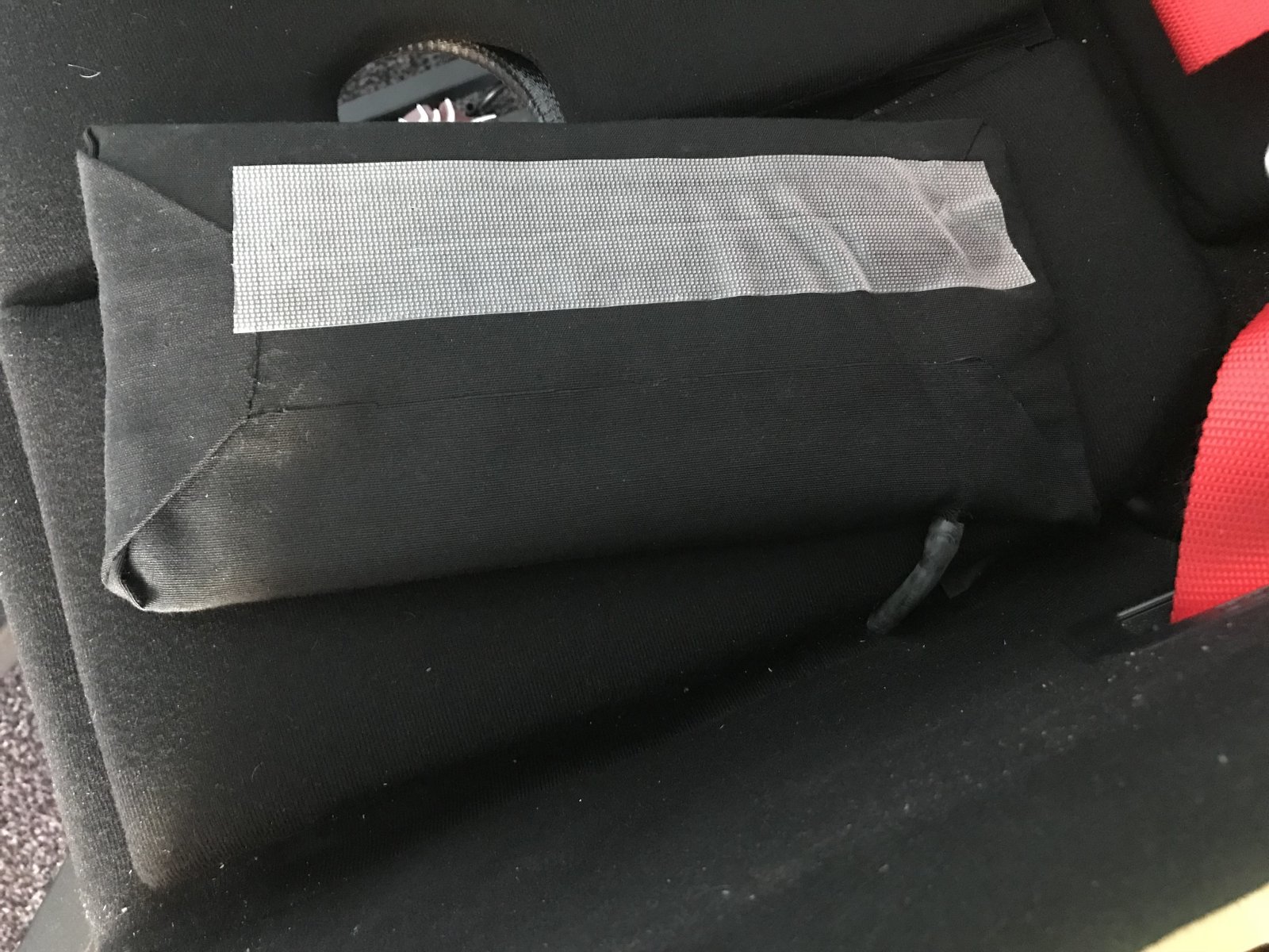

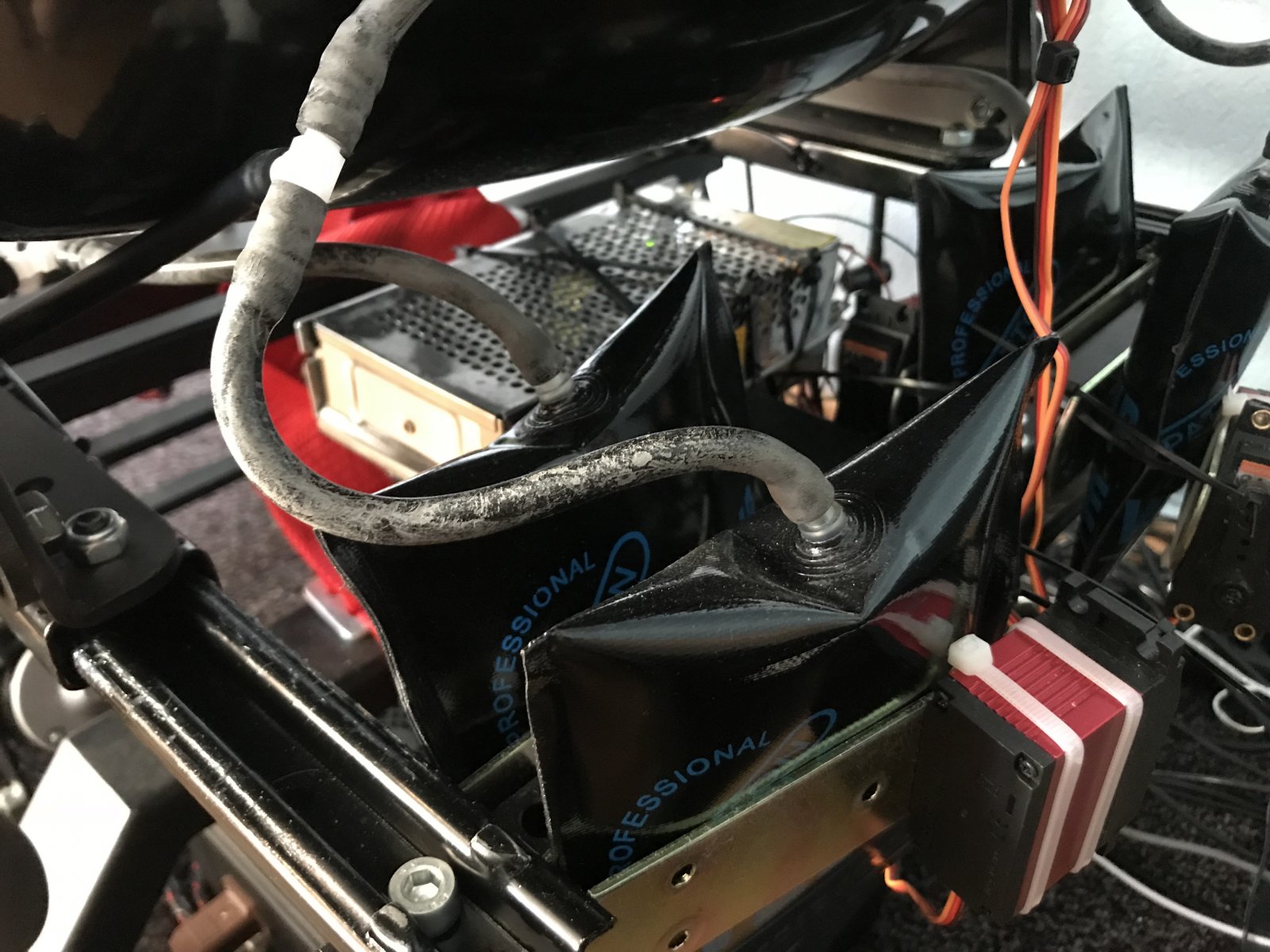

  16. SeatTime
    2,573
    Now that is one different looking pneumatic G Seat setup - have not seen one like that before - seems like the servo presses on one bladder outside the seat which then transfers the air into another bladder inside the seat. The question would be how does the air get back quickly? Maybe the servo releasing pressure on the outside bladder 'sucks' the air back... :think. Anyway very innovative :thumbs.

    Function principle Pneumatic G-seat

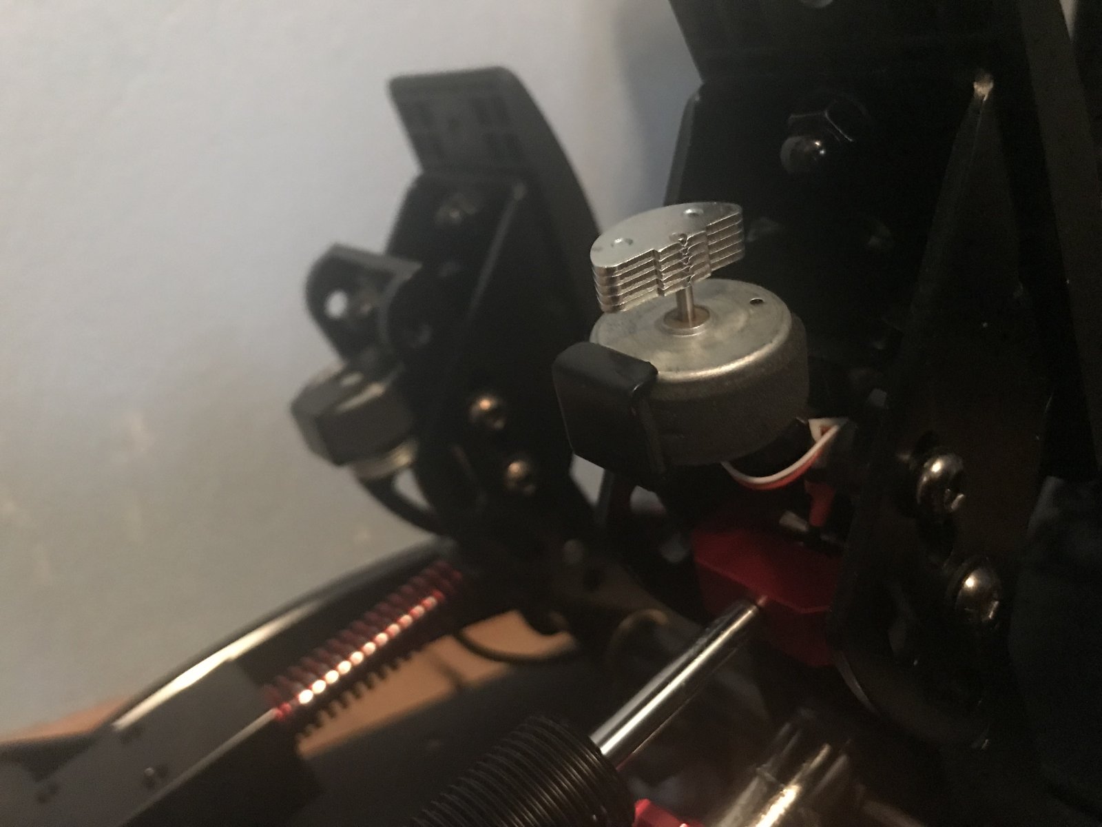

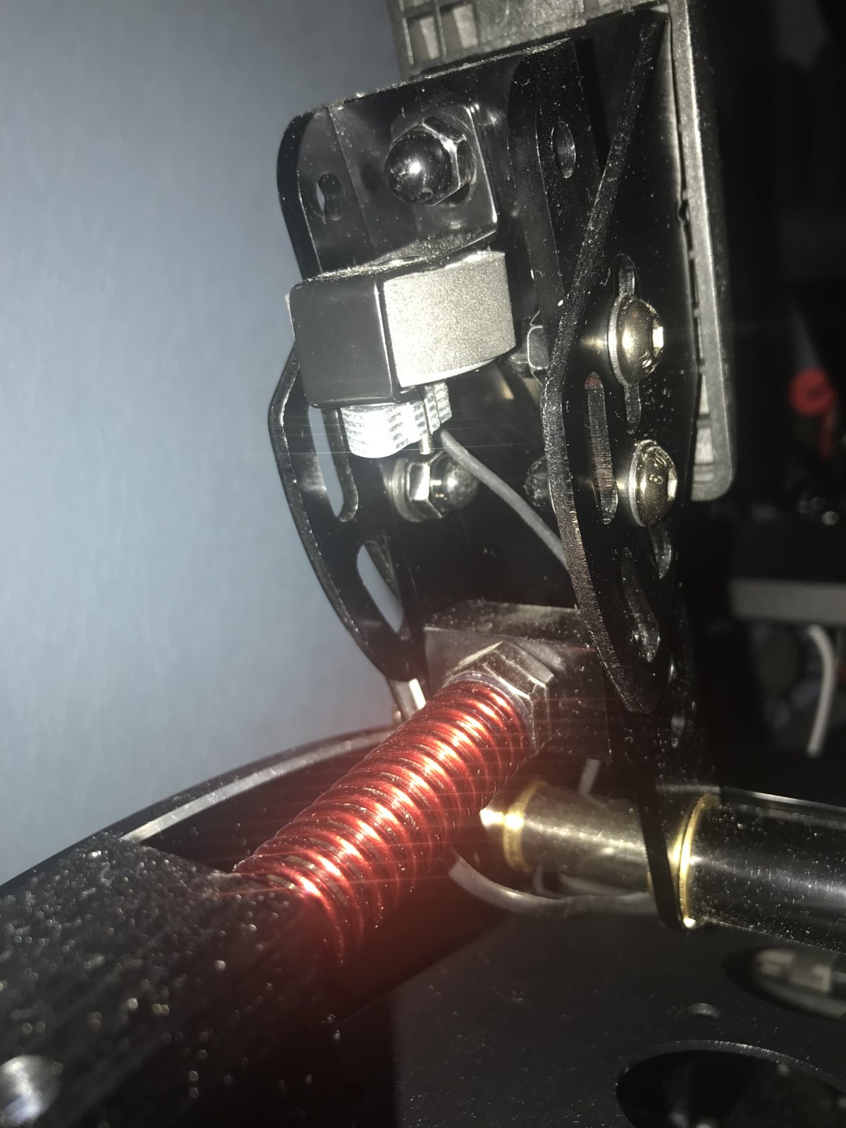

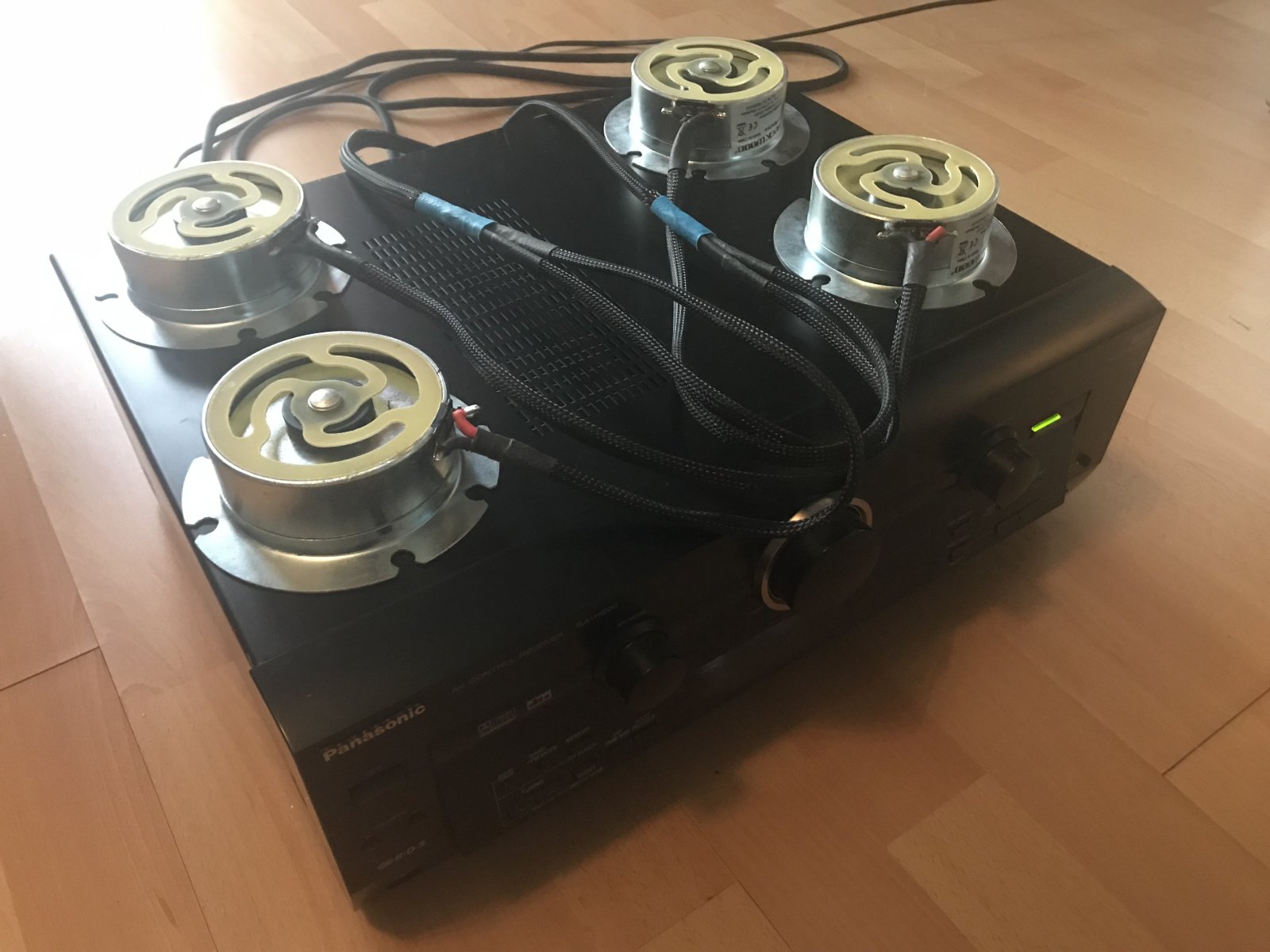

    This is my old Transducer System from my first own rig.
    That works perfectly.
    The ButtKicker simulates the engine and the gearbox completely enough.
    And is easier to install
    In addition, the pedals have vibrators that are controlled by FanaLEDs

    I did not know the system yet.
    Definitely cheaper than the buttkicker.
    in a non-moving rig, the 4 channel sound is better
    with my rig it will be difficult to install everything
