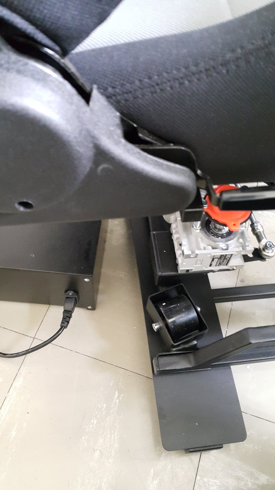

    B4 i forget looks like the P3 rear 3rd "extra" motor roller wheels & assembly have been improved, now larger exposed & angled?

    Wow, that's one bigger roller.
    I feel somewhat inadequate now......
    Andy
