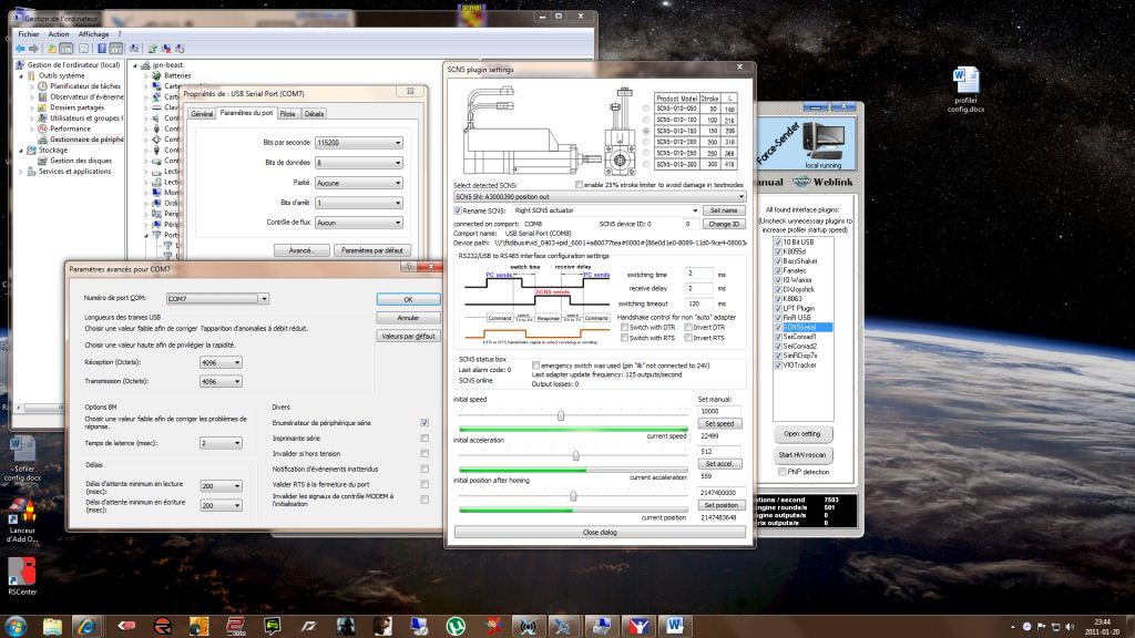

    I have been able to run 3 laps at Spa using your advice so So far so good but I don't understand why this issue has began and even if I don't really notice it during gameplay, output per secondes are much lower now...
    Using a timing of 2-2-120 in the profiler scn5 config and 2-200-200 in the usb comport settings it did not disconnect yet... I not sure the values in the usb comport are good ... looks like this;
    Nothing unusual is running on my PC either ... Why would it suddenly be a timing issue ??? Devantech adapter failure? usb port failure ? I will try plugin the usb cable in another port just to test it ...

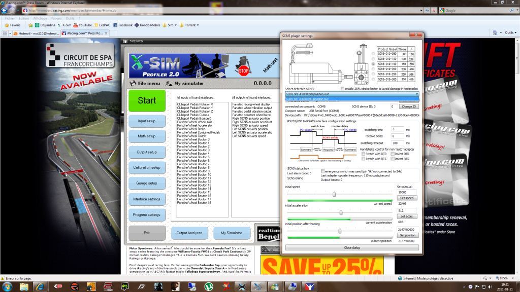

    The issue only occured 1 time yerterday using 3-0-100 timing. The hardware check boxes were not checked at that time however ... I am having poor actuator performance with these values also... I get better results with 1-0-100 and it was always very stable until I began having the problem.
    I will do more testing over the week-end ...
    Here is a shot of the interface page and scn5 advanced settings page when the problem occurs... Both actuators are listed in the main interface page but only 1 in the scn5 advanced settings page:
    Thx!
