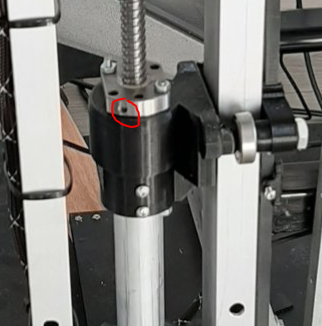

    @Joey If the design is the same as your previous photos, then you might not need to do any modifications. The grease port is circled in red in the image below. It is not immediately obvious what it is it - but this hole goes right into the ball nut. Put grease in here while slowly turning the screw until you see it coming out of the seals. Seals should be tight for exactly the reasons you mentioned, to keep any dirt/dust entering the ball nut.

    Oh that hole! Nice! Thanks!hug:
    I've seen those plastic caps on the inside thinking those were for the oil.
    I guess those plastic caps are where the balls can be inserted right?

    Hoi Joey
    In de rode cirkel op de foto zit een gat met schroefdraad voor een vetnippel in te draaien, zodat je hem met een vetspuit kunt vullen.
    De witte plastic kappen zijn stofkappen de vul opening voor de kogels zit normaal in de sleuf van het ronde deel boven de flens.

    @Joey The plastic caps on the side of the nut are not designed to be removed from the outside. They are pushed in from the inside. The caps have a little guide inside them and is where the balls in the ballscrew nut cross over from one thread to another. I made the mistake of removing one of these caps from the outside to try to reload the balls (after the nut came off the end of the rod), but the balls cannot be loaded from this position and the cap cannot be refitted from the outside.
    If the nut does come off the rod, there are some good videos on youtube on how to reload the balls into the nut, but it cannot be done from the plastic caps.
