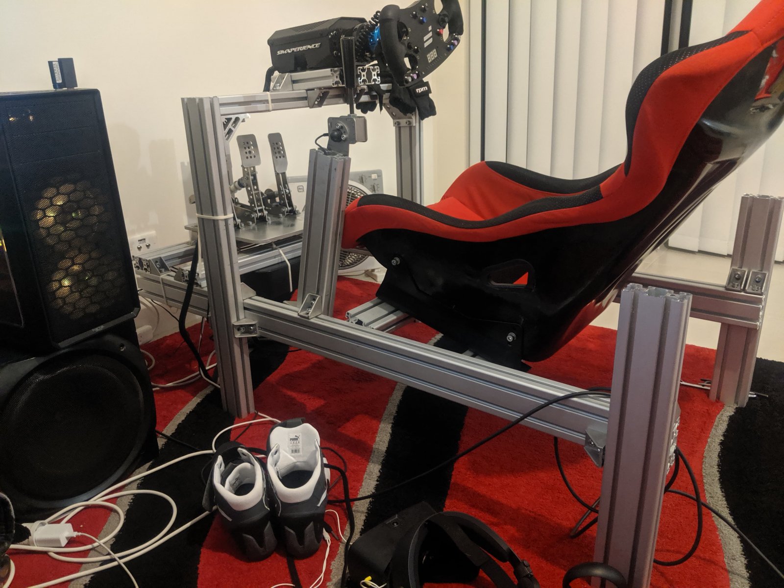

    So as the title says, been hanging around along time and now my Im ready for my first build. Now Im going to be diving straight into the deep end and build a 6dof as Ive been quite impressed with the performance of @SeatTime and @SilentChill builds and would like to do something similar. I do have a series of questions and will definitely need some help along the way.
    After browsing through some parts I have decided to go with servo drives instead of straight dc motors as it will be more cost effective. (The servos will cost a similar amount to dc once you factor in all the parts and shipping costs) So my first 2 questions are going to be for @Thanos regarding his AMC-AASD15A servo motion controller and if it will work with these motor and driver?
    https://www.alibaba.com/product-det...2700.7735675.normalList.66.37fa6eaeIxgOag&s=p
    My next question is with the torque of these servo motors being greater than the dc motors in those builds will I be better of using a 1610 ballscrew instead of a 1605 as the rpm on them is also a bit lower?
    Also if anyone, especially those Ive tagged, have any suggestions/input otherwise Id like to hear it as I need to try keep this to a rough budget but I also dont want to do something that might be counter productive to getting this thing up and running or something that may cause me issues down the line. I much prefer driving my rig than working on it, lol.
    I should also add that I pretty much only race in iracing so if there are any issues on that title that anyone might be aware of Id like to know also.
    Thanks in advance and cant wait to get this done. (pic of my rig currently)
    Brett
