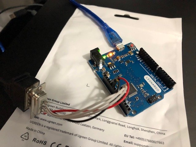

    that's the reason i created that piece of hardware.
    it is not big at all (Arduino Leonardo, 5 wires a DB-9 female and of course the USB cable.)
    Description of what it does and why!

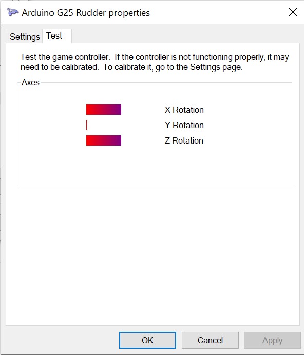

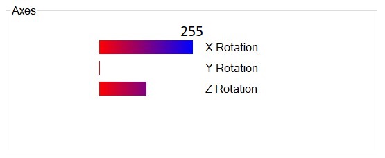

    First let's look at it from windows 10 point of view!
    Looks good isn't it?
    Now have a look at the Axes
    as you can see, there is 3 axes (X rotation, Y rotation, Z rotation). and you guessed it, you have 3 pedals, DUH...
    Just to be sure, sometime i forget things..
    Yep, i was right, 3 pedals, hehehehe...j/k
    now that i posted some pictures, they will be useful to understand what this contraption does and the reason why i made it.
    First of all:

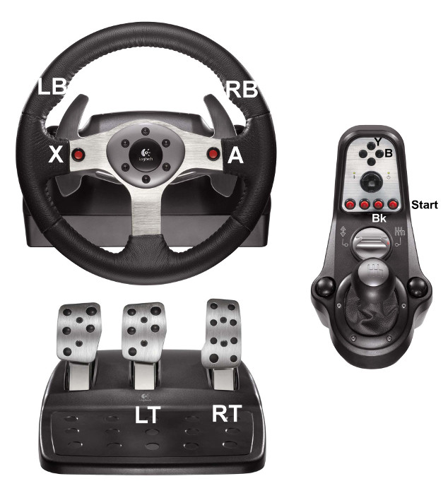

    the arduino takes 2 axes, the clutch and accelerator.
    Clutch is the left rudder and accelerator is the right rudder.

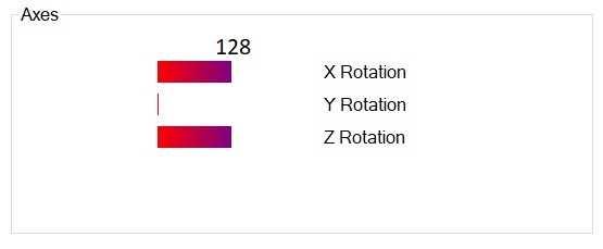

    when you don't touch any pedals in the properties on the G25 rudder (windows 10)
    the X Rotation is in the middle of it's range (128), as all good rudders should be.
    if i press the Left Rudder (Clutch) all the way, the red axe goes left to zero value.
    and if i release the left rudder (clutch), the red axe goes back to the middle (see picture)
    Now we assume that if i press the right rudder (accelerator), the red axe will go all the way to the right,
    with a value of 255. you're right just like the red axe! :)

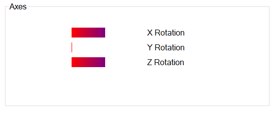

    Quiz time:
    What happens if i press both the clutch and accelerator at the same time?
    "Come on don't be shy!"
    I'll give you the answer, it will go back to the center, NEAT huh?
    some of you would say: "why you did this this way?"
    for those who don't fly plane on a simulator, a rudder works only on one axe,
    but since a 3 pedals for racing has 3 different axes and it is not just made for a set of rudder.
    what i did is take half of the clutch value (like zero to 127) and half of the accelerator value (128 to 255).
    By combining Both value together, i can merge those values into one single axe. X Rotation now have a scale of (zero to 255).

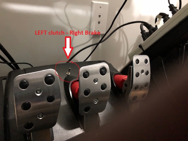

    YOU would open your logitech G25 and put a DPDT switch to exchange the brake and the clutch
    Like on this picture.
    if you're still interested in doing this project of swapping the clutch for the brake. i can show you how in another thread.
    Second solution:
    there's NONE, i already modified the firmware of the arduino!
    with a SPDT (center OFF). SPDT center pin to ground, left to pin 2, and right to pin 3 of arduino.
    when the switch is on Center (OFF) position, the pedals are working like a normal 3 pedals racing set.
    then if i switch to left position(pin 2 on arduino to ground), the racing pedal set becomes a rudder set.
    clutch = rudder left and accelerator = rudder right are combined together, brake pedal is a simple full axe.
    now to play games, any games that needs to have accelerator and brake on same axe, just
    set the switch to the right (pin 3 on arduino to ground) and, Clutch = one full axe, brake and accelerator are combined into one axe.
    All that without any virtual joystick software (vjoy, etc...) just an arduino circuit that does the job!
