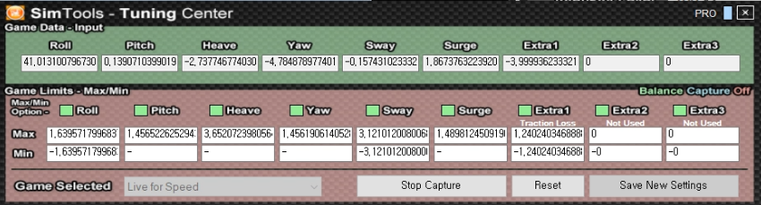

    Hello, I am the first user who created the simulator. The data values received from the live speed game go back and forth between the lowest and the highest. Is there a solution? I haven't been able to run other games because I don't have coins.
    It is the tuning center value when it is stopped still.

    Not yet, but I recall @yobuddy saying he believes he has squashed this bug in the upcoming V3 of SimTools.
    It has been a awkward Windows related bug, as it only affects a small number of computers that are not set to English Local, not all of them
