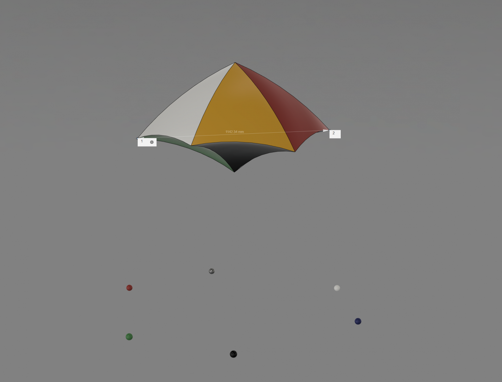

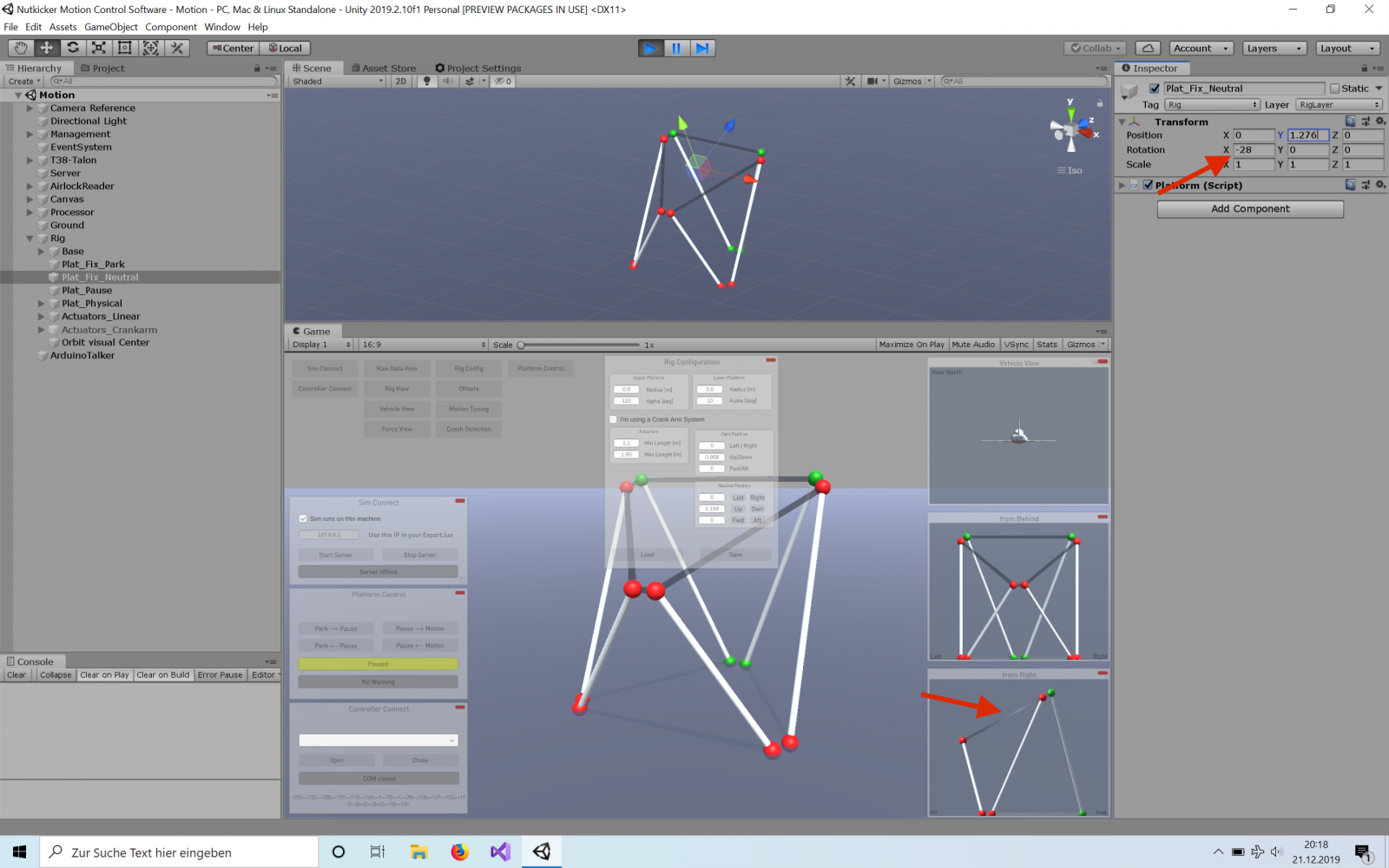

    To be honest, I didn't even know the pitch or roll limit of my planned rig. I had to check and I found it can reach a pitch of 28° before an actuator reaches it's max travel.
    Be aware that there are other limits you can run into, like the max angles of the U-joints or the max motor speed or the max motor torque.
    If ever someone asks about the max angles (Pitch, Roll Yaw) of a rig, the only sensible answer would be to ask back: At which translational position (X/Y/Z)?

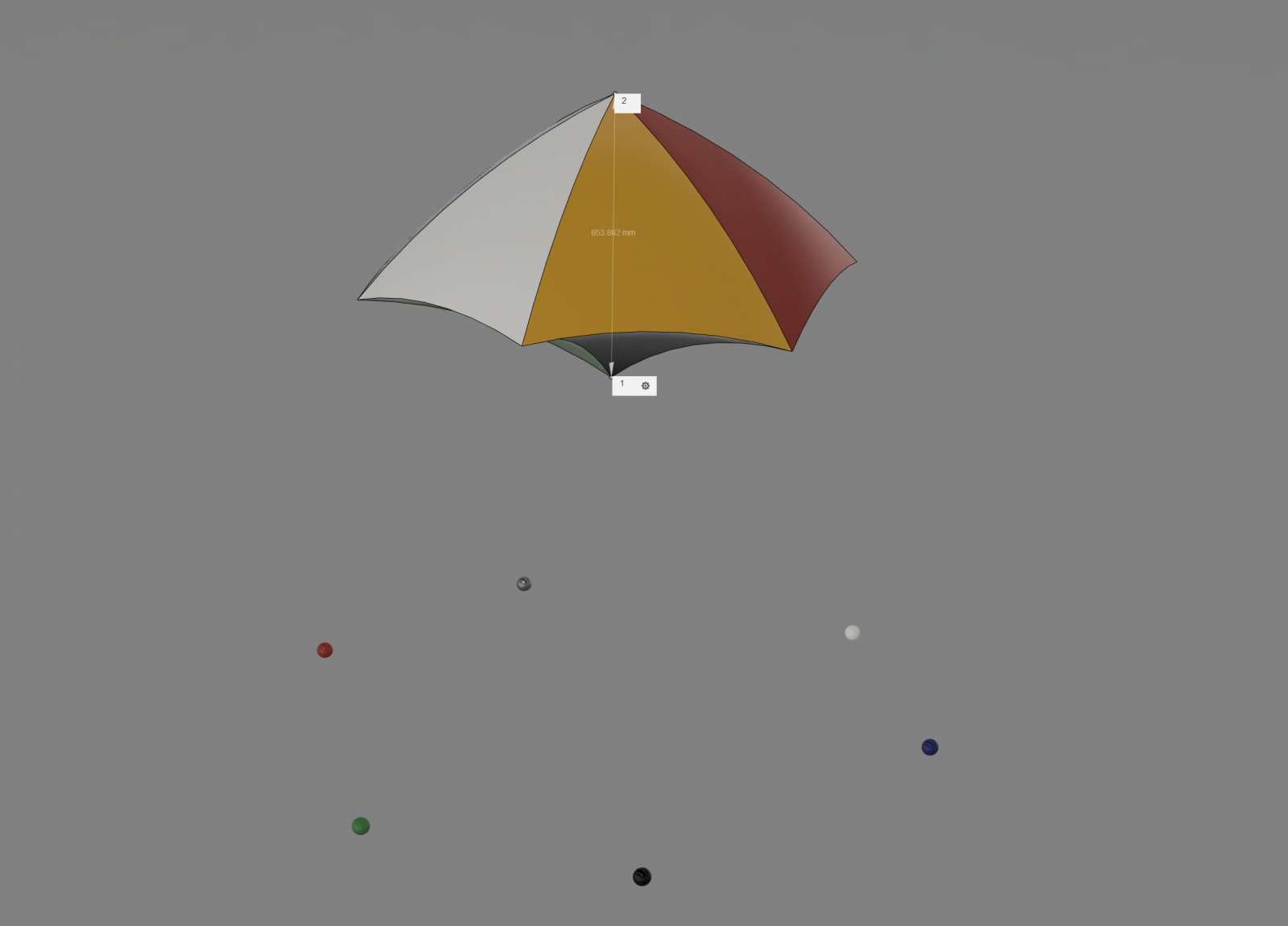

    This body represents all possible XYZ coordinates the center of the upper platform can go to:
    - You can reach the true max Pitch only when the platform is in exactly one point somewhere close (but not exactly in) the middle of that body.
    - You can reach the true max Roll only when the platform is in exactly one point somewhere close (but not exactly in) the middle of that body.
    - You can reach the true max Yaw only when the platform is in exactly one point somewhere close (but not exactly in) the middle of that body.
    ...funny thing is: Those points are not identical :confused:
    I find it non sensical to specify max values for Pitch/Roll/Yaw/Surge/Sway/Heave and in my software I don't have them. All I have is a little knowledge on how filters work, and an hour of time to do some tuning. All I can say is that it is highly improbable that the rig will reach an end stop, not impossible.

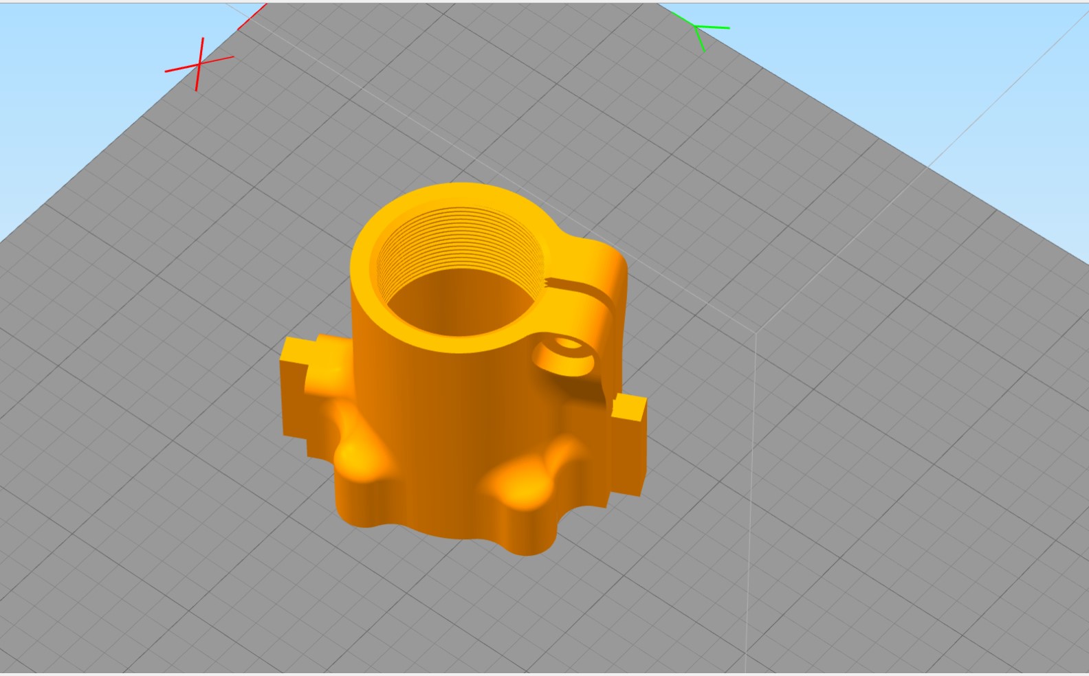

    Finally got fusion 360 to load on my pc..
    I am interested in printing out some of the plastic parts.
    I think I have exported the Slider....
    maybe someone could take a look.
