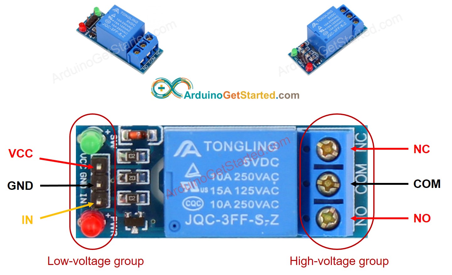

    I'm working on my budget 2DOF project on the (SMC3 firmware) + 2x IBT2 drivers + PGSaw motors. I decided to put limit switches to the frame, so motor arms couldn't crash into a frame if soft limits failed or hall sensors detached or anything else. I use 2 x micro limit switches. They are quite small and cheap (Ali) - see image. They are rated 5A on 125/250V, but I wasn't sure I can put the main motor current through 2 of these (for each motor), so I interrupted the PWM leads to Arduino pins 9/10, thinking "no PWM - no movement". Wrong. After I cut any of the switches, the motor does 2-3 random small movements in one direction. So what line can I put these on, what should I interrupt to immediately stop the motor upon hitting the end switch?
    My connection is like this:
    Maybe I should cut +5V to IBT2's instead? Or something else? I can only cut one line per IBT2, so can't cut 2 or 3 of them together.
    My version of the rig works, but I would like to have a real protection from crashing it in case of any failure.

    You could use a suitable spec relay so the limit switches then in turn trigger the relay to cut the power on both motors on the PSU side.

    I was thinking of that, but not sure it's fast enough. I was hoping somebody knows that already. I do have end switches mounted on foam panels 2cm thick, to give the arm some room to stop...
    I do have suitable relays in my Arduino related stash. Just thought things could be simple. I'll see if cutting 5V to IBT2 is fast enough, if not I can do the relay dance.

    It could be like kill switch of the main power. I have used one for building kill switch. The only problem is that the switch is nor momentary switch. Maybe some kind of on/off switch would be better.
    Relay module I have used: [​IMG]

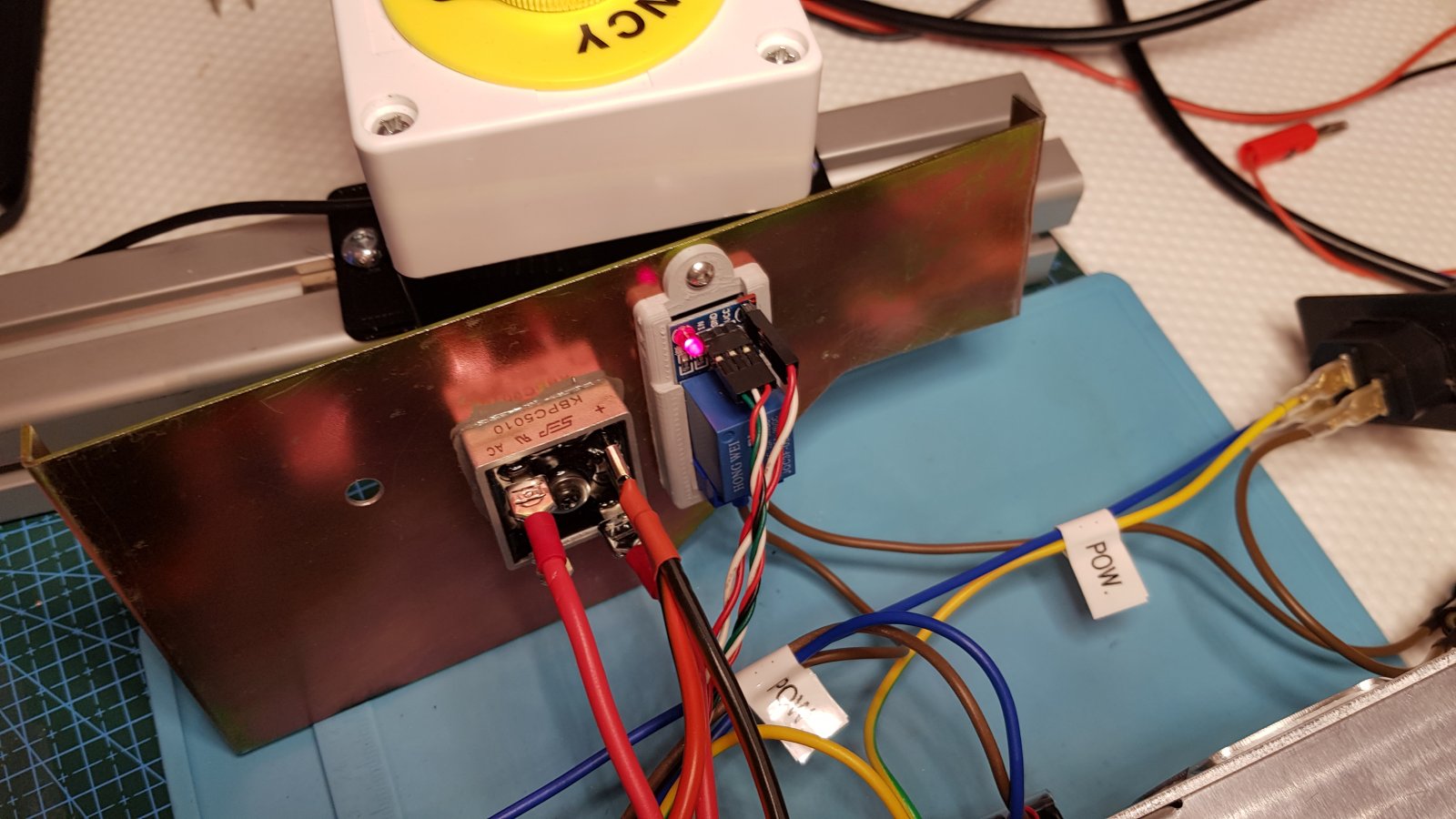

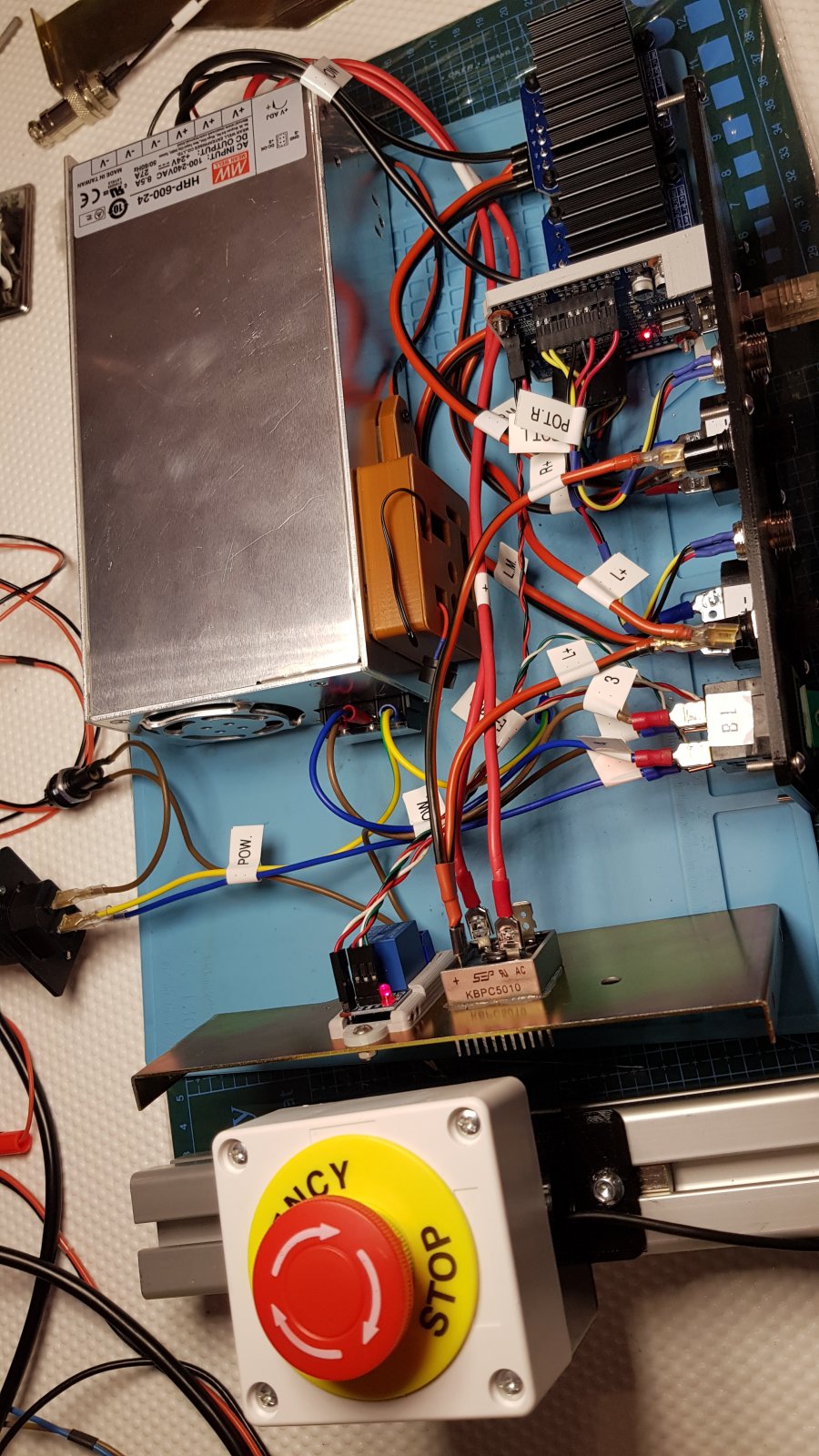

    Perfect, thanks! That was a great idea. I have 2 of those lying around. Just connected it to each motor lead - to Normally Open. I connected 5V and GND from Arduino, then my end switches which are Normally Closed to short IN and GND on the relay. Voila! When I plugin in Arduino, both relays open and light up (red and green), but if I trigger any of the 4 end switches, power shuts off instantly and motor stops immediately.

    I think it's good enough. It's duplicating both FlyPT Mover CMC3 software limits anyway. If it hits the switch it must be something really wrong: like hall sensor or magnets detaching from the motor etc. In that case if it just stops - it's good enough for me.
