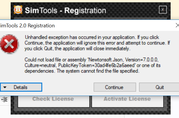

    My License Key expired and I had to buy a new one. When entering it in ST-Registration getting an error below. Continuing doesn't help. ST Manager and Engine are closed. Switched from ST 2.1 to 2.2: no result. Any recommendations? Note that I'm still using ST-Registration 2.0 (couldn't find ant newer).

    The problem was the old ST-Registration file from 2/6/17. When uploaded and ran the newer one from 10/12/17 was able to register the new license key.
