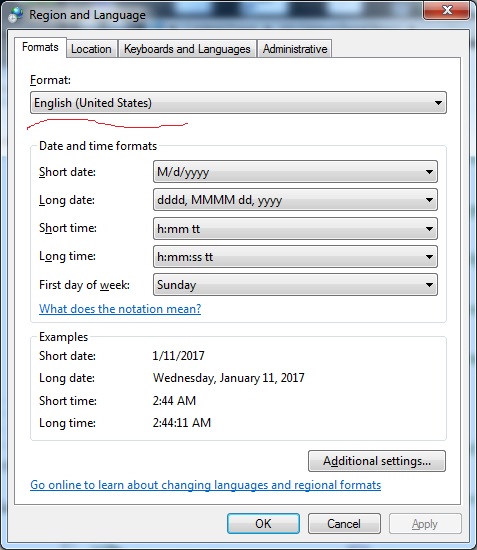

    I'm having a really big issue with the activation. I've entered my key, says it's well and activated, then when trying to start up Manager and Engine, I get the following message:
    "There seems to be a problem with your PC's Date & Time.
    Please click 'Check License' within the registration app to correct the problem."
    I've checked both windows and bios clocks, I've re-checked the license a bunch of times.
    Now I really need some help.

    @yobuddy will get in touch with you ASAP, meanwhile you could check if you had run the registration with admin privileges...and check your computer if set to the right time zone

    yes, will you please make sure your pc clock is set to the right time zone and that it is correct.
    Is anything running that may be interfering with communications to SimTools.us during registration?

    No joy.
    - adminstrator-ed all the exe-s
    - firewall OFF
    - time zone automatically UTC +02:00, which is correct
    - time synced successfully to the internet
    Any logs I could give you?

    Could you please try this?
    Set your region and language for the pc to English (United States)
    Then open the license app and press "Check License".
    Then try to launch the Game Engine and Manager.
    Let me know how it goes buddy.
  10. stelian78
    stelian78 New Member Gold Contributor
    Dec 10, 2014
    25
    - 353Coins
    3DOF, AC motor, Motion platform
    That was it! We've got output, now time for the axes setup..
