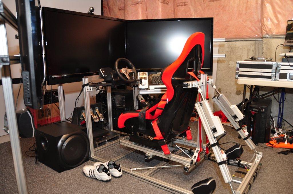

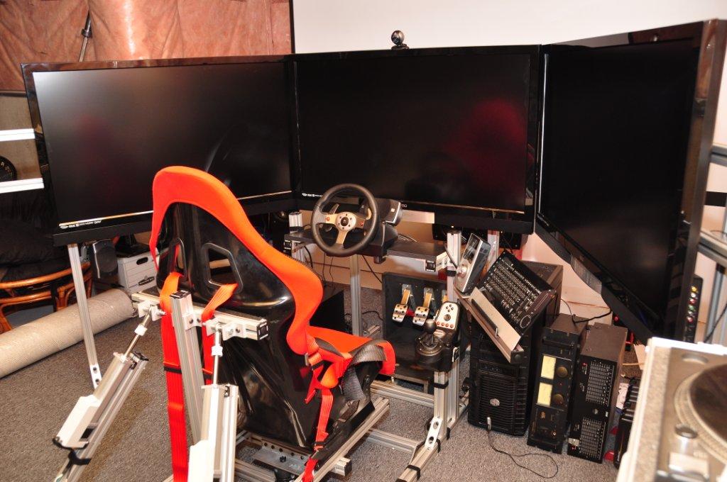

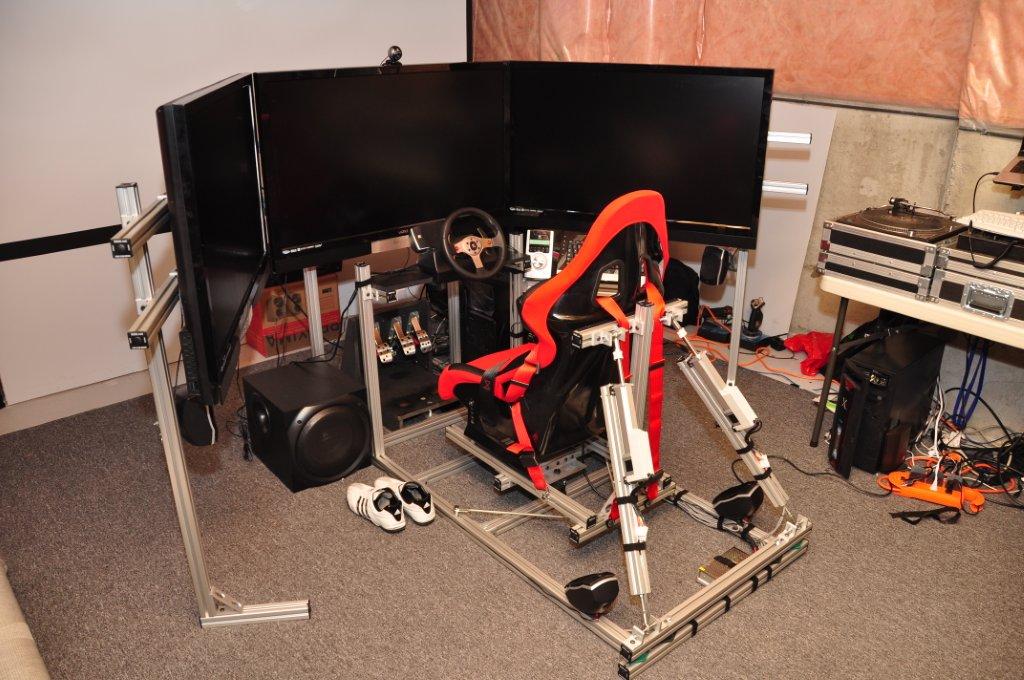

    Here are some pics of my current setup that I thought I would share. Next batch of upgrades will be a button box, Hydrolic brake (looking to try the Perfect Pedal for the G25) and another bass shaker (one currently undrer seat).

    nice look.is a better feeling now with more angel on the screens?

    Yeah Mike, this setup ROCKS :clap: !!!
    I see, that you use the same sound system now like I do - it's great !!! I have mounted the rear speaker higher than you, just the same height as my ears...
    Regarding the brake: Take a look at the motoPC from Karsten - it's the best you can get at the moment. I also have the motoPC brake system, but I haven't installed it yet (still driving the JL hyperreal brake) - no time at all :blush: !
    I already built a button box (have to take a few new pictures) with a Leo Bodnar Controller - it's great.
    Keep on racing :thbup: !

    Thanks Niels. Yes, using a 60deg angle makes things much better.

    Thanks Chris,
    The Logitech system rocks :D
    The MotoPC bake system is very nice but I'm not sure if it will work with my existing G25 pedals so I'm assuming I would have to upgrade to a differenct set of pedals first or make a custom design. I'll definately look into it though :)
    I would appreciate it if you could send me some more information about you button box as I'm planning on building one this weekend.
    ....Mike

    Hi Mike,
    I chose this controller from Leo: http://www.leobodnar.com/products/BU0836X/
    I'm using the VPP pedals and changed the built-in Joywarrior controller with this net Leo BU0836X controller. Among other things it has also a higher resolution...
    You can take simple buttons and connect it to the BU0836X. Once plugged in the PC recognizes it and you can set any ingame-function to the button(s).
    It was NO PROBLEM at all, everything's working fine with my button box.

    To get your Eyefinity to work are you using an active displayport adaptor?
    About the peddles, I am very happy with the FANATEC ClubSport Pedals, are made of aluminium good and sturdy and also use this contactless load cell sensors event the brake pedal a little force feedback and are fully adjustable. check em out.

    Yes, I'm using an active displayport adaptert that I purchased from Dell. The eyefinity setup has been flawless since I upgraded the bios on my video card. Thanks for the link. I will check those pedals out :)

    There are many tracks that have good pitch, roll and yaw effects. All of the profiles that I've been working on take full advantage of these effects. I modified my g25 shifter so that it no longer has the clicking sound when shifting as well as giving it some more resistance when shifting. There is another mod to get rid of the wobbly feeling when in 3rd and 4th gear but I have not done that one yet. I have been looking for an alternative shifter as well but have not yet tried any others. The TSW does look pretty good so I would be interested in hearing your thoughts about it.
