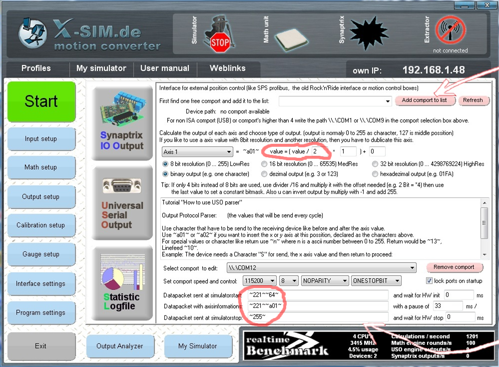

    I just finished the AVR Motion Controller Board 1.5 and Dual Simple Mosfet H Bridges.
    It´s working Ok in my tests, The wiper motors move side by side well. The lcd indicates the pots values.
    I can comunicate with Hyperterminal too!! and change KP settings.
    BUT...
    I have a problem to configure the X-Sim software to setup the board.
    I´m using Native Serial port COM1, but I don´t know how configure it...
    I´m searching about 1 week (8 hours per day) of reading... but I can´t find a tutorial or video guide that works.
    I don´t know what version of X-Sim is best for AVR.
    There is any tutorial, for the Tronic AVR controller? If so, I can´t find it.
    I hope you can help me.
    Thanks a lot for your time.

    The test plugin is built into the x-sim software. Select it from the list of plugins in the force sender software. You will also need the test pofile that is supplied by bvillersjr. You can find the instructions here:
    http://www.x-simulator.de/wiki/Testing_Your_2DOF_DIY_Motion_Base_To_Prevent_Damage_To_Your_Actuators
    Ne02005,
    I am using SCN5's in my setup so I am not exactly sure how to configure x-sim to use the AVR boards. I am interested in experimenting with a 3DOF platform based on wiper motors so I will be doing some reasearch on how to set this up. I'll send you the information if I find it. Don't get discouraged if the information is not easy to come by as I'm certain that someone with knowledge of the subject will answer eventually. 3 Weeks ago, I knew nothing about motion based simulators and now I'm enjoying one every day :).
    Perhaps if you let me know exactly what the issue is you're having, I can help you research it and find the answer.
    ....Mike
