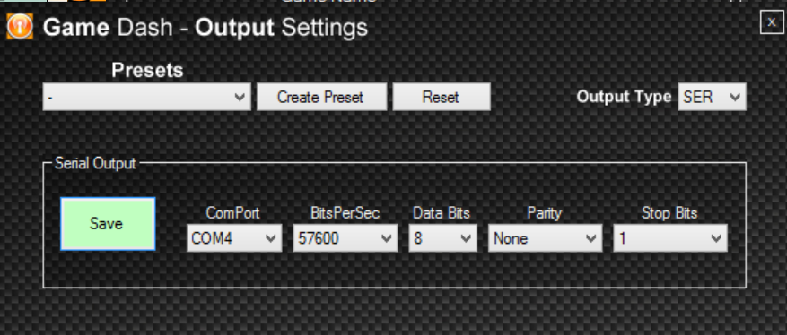

    Every one I have orderd all parts to build TM1638 Multiply page display ,with GameDash from eaorobbie.

  6. eaorobbie
    20,471Coins
    +1,686 / 23 / -2
    Sorry we use GameDash which is SimTools supported not sure if this would work along side.
    To me I would prefer people to get behind the GameDash and start helping us to support more games and idea in with the use of it.
    Then we would have a free application with a world of support and open options on what we can drive with it, most popular is the TM1638 board (at $8) its one of the cheapest option on the other side we mananged to use a porshe dashboard running steppers to reproduce the dash in Rfactor with analog guages looked very neat for sure.

  12. hyper1966
    hyper1966 Domenic
    Jan 18, 2014
    94
    Edmonton QLD Australia
    833Coins
    +40 / 0 / -0
    2DOF, JRK
    I have attached Details, of settings I used for Gamedash.
    Which eaorobbie help me create them.
    GAME DASH SETTINGS
    RFACTOR
    DASH 1 SPEED
    math * 3.6
    round 0
    pad 3 0
    DASH 2 RPM
    round 0
    pad 5 0
    DASH 3 GEAR
    replace -1 9
    pad 1 0
    RACE 07
    DASH 1 SPEED
    math * 3.6
    round 0
    pad 3 0
    DASH 2 RPM
    math * 10
    round 0
    pad 5 0
    DASH 3 GEAR
    replace 254 0
    replace 255 9
    pad 1 0
    GT LEGENDS
    DASH 1
    math * 0.625
    round 0
    pad 3 0
    DASH 2
    replace -1 0
    Math * 10
    Round 0
    Pad 5 0
    DASH 3
    replace -2 0
    replace -1 9
    pad 1 0
    RFACTOR 2
    DASH 1 SPEED
    math * 3.6
    round 0
    pad 3 0
    DASH 2 RPM
    round 0
    pad 5 0
    DASH 3 GEAR
    replace -1 9
    pad 1 0
    Here is link for what you need for this to work http://www.xsimulator.net/community/threads/tm1638-multiply-page-display-with-gamedash.5003/
