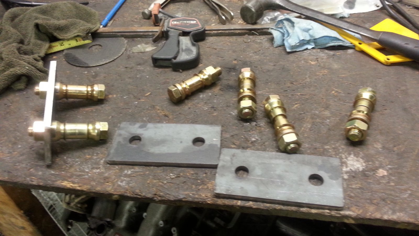

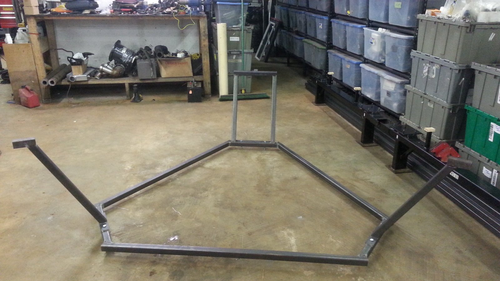

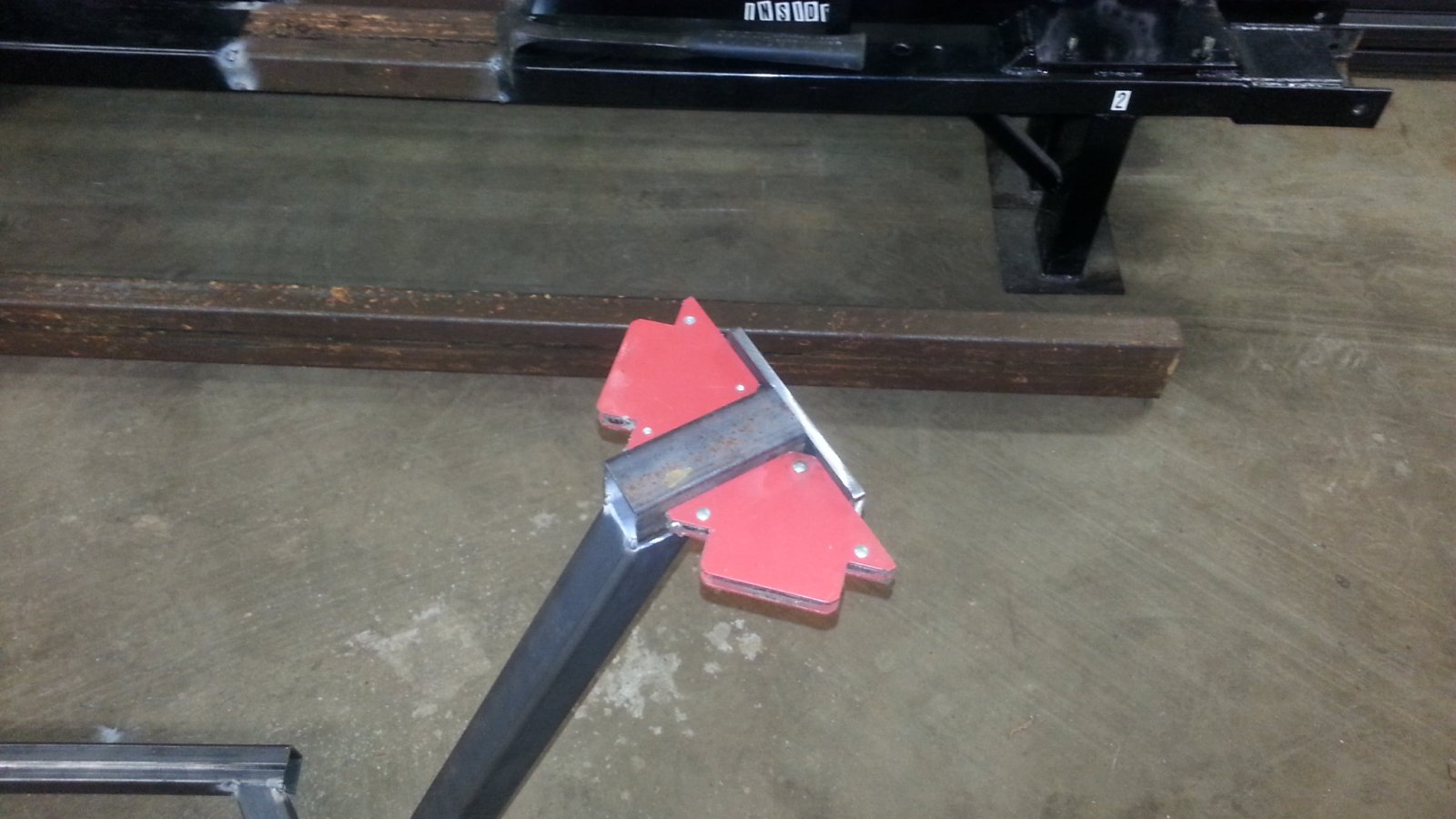

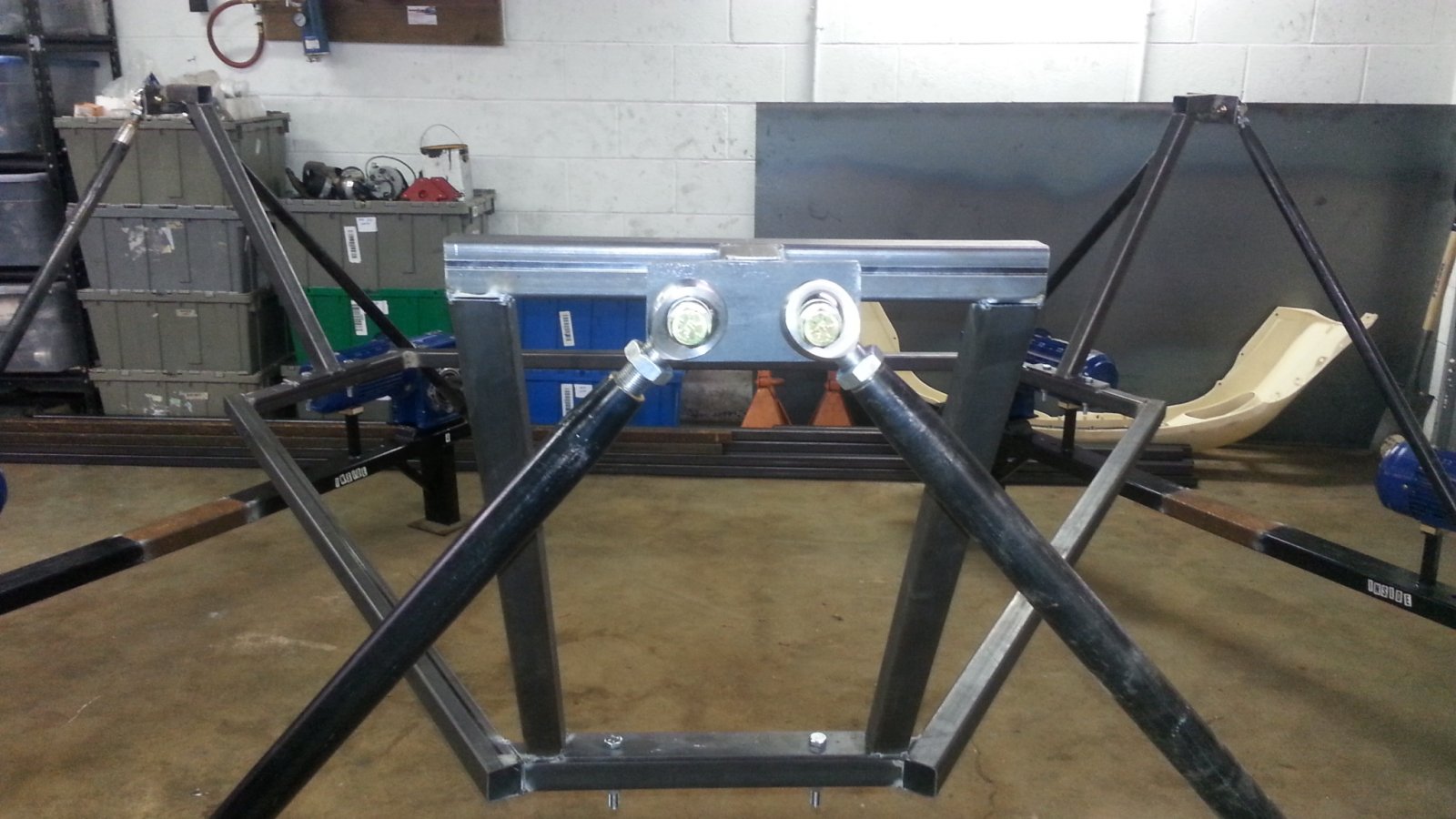

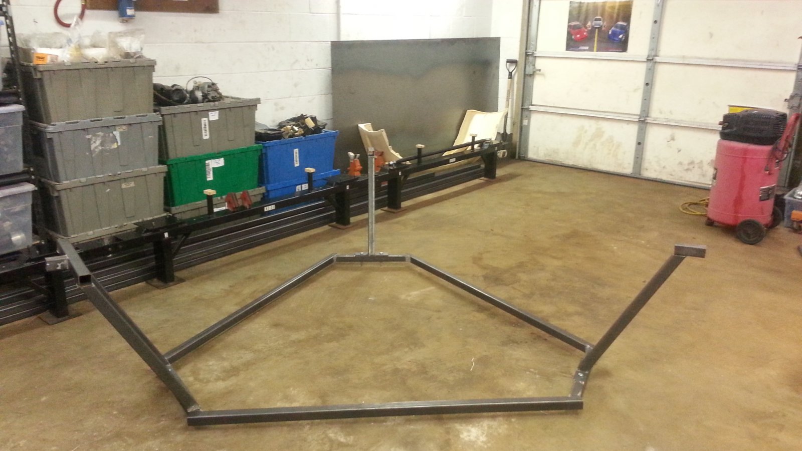

    Soooooo i have been working on my motion base and have gone for a significant re-design. Basically i scrapped the idea of a pod mounted on top of the arms and opted for a basket design instead. The reasoning behind this is vast. First of all the head room required. i would not be able to use a room with anything less than 24 feet of head room. Second i know it has been done before but i just don't like the super high center of gravity and going with a basket design significantly lowers the center of gravity. So i took the whole rig apart and went to work with the band saw and welder. First try turned out to be waaayyyyy too big so i had to reduce the basket size in order to reduce the total foot print. second try went really well and i ended up with a 10 foot foot print which i am much happier with. Ok enough blabbing .....
  20. jthiani
    jthiani Member
    Jun 15, 2015
    34
    Knightdale, NC
    588Coins
    +38 / 0 / -0
    DC motor, AC motor, Motion platform, 6DOF
    So this first image is the first mock up of the basket. it was a little bigger than i expected it to be, but i went ahead and put it all together the get the true scale .....
    The double uprights are at the front and will be used to hold the foot pedals in place
    20150729_140923.jpg 20150729_171927.jpg 20150729_172210.jpg 20150729_180219.jpg
