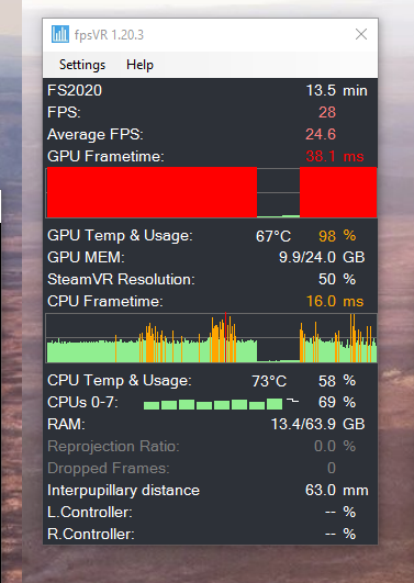

    Hey guys,
    I'm experiencing a lagging in MSFS. It freezes for half a second, at random intervals. Otherwise my experience is smooth. The lag goes through the motion rig and my Pimax 8kx which loses tracking for an instant and shows the grid.
    Tonight I turned off Game Manager and Engine, and all the lagging/freezing went away. I flew along for about ten minutes without a stutter. As soon as I turned Engine/Manager back on, it started freezing again. Interval is about 3 times a minute.
    I'm not really sure how to troubleshoot this? Attached is a screenshot from FPSvr showing the freeze.

    The demands of MSFS2020 vary, depending on what you have enabled, where you choose to fly and what you choose to fly.
    I would suggest first try without VR, but with motion enabled. Do you still get the glitches? If not it is likely a computer hardware/resource issue based in the settings you are making in MSFS2020.

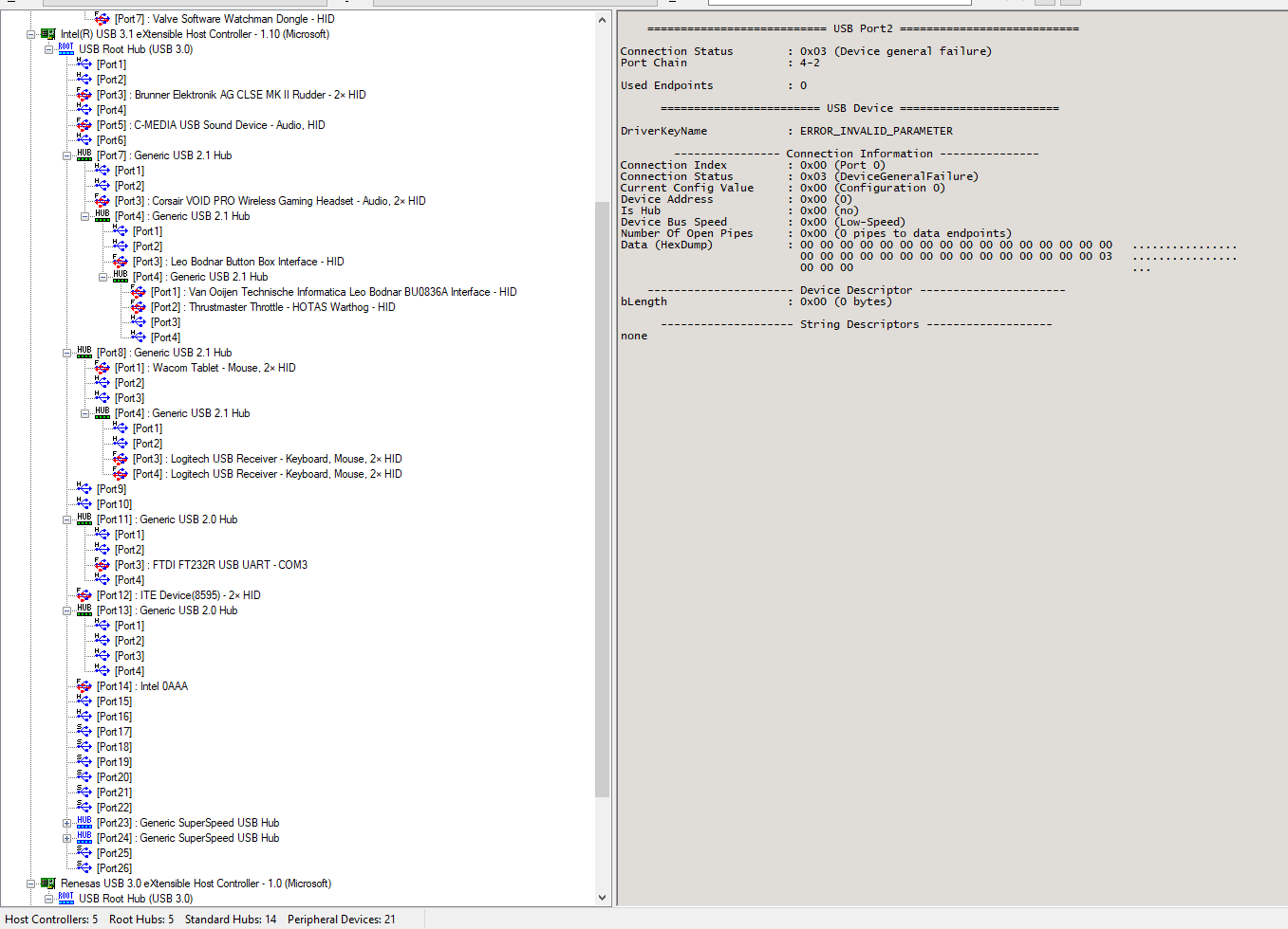

    Thank you for the links. I changed the windows USB setting, swapped out a powered hub that I found was connecting/disconnecting.
    I put the Thanos board on a 2.0 port, and both hubs on 3.0 ports. Pimax is on the USB3.0 PCI card.
    Still getting the freezing, in and out of VR. Killing game manager resolves the issue every time. Here's a snapshot of what USB tree gives me. I'm not sure what those unknown devices are. USB deview shows everything in the green.

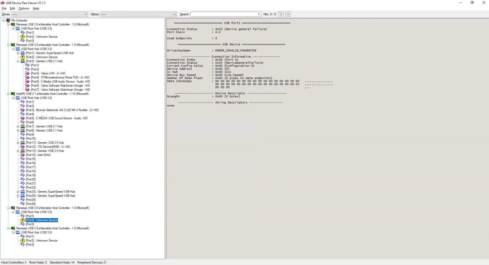

    Here's a better shot of what I have plugged in. USB hubs are showing as 2.1 even though they are 3,0? Maybe the extension cables I'm using?

    Lots of Unknown Device: https://techcommunity.microsoft.com...ce-is-an-quot-unknown-device-quot/ba-p/270739
    I would try having just the Pimax on a USB3 controller, not shared with anything else, the Steam stuff on a separate USB 3 hub, not shared with anything else, and dump the rest together on what remains.
    Though keep in mind that implementation of USB3 standards can often be a bit shoddy, so in those circumstances USB2 tends to be more reliable, which may also be worth a shot for particular devices.
