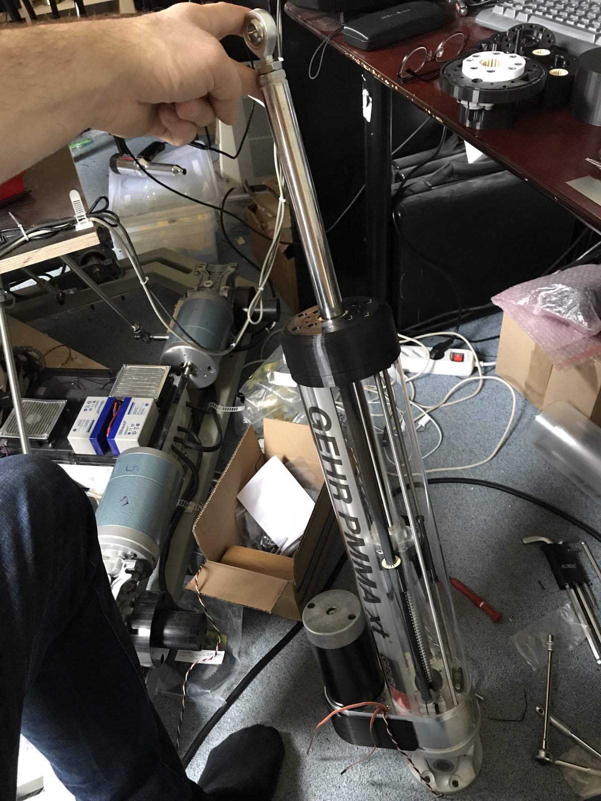

    now its time to show up the next milestone for the Actuator.
    The tube is made of PMMA, fully transparent.
    here a quick video which shows the stuff in action.

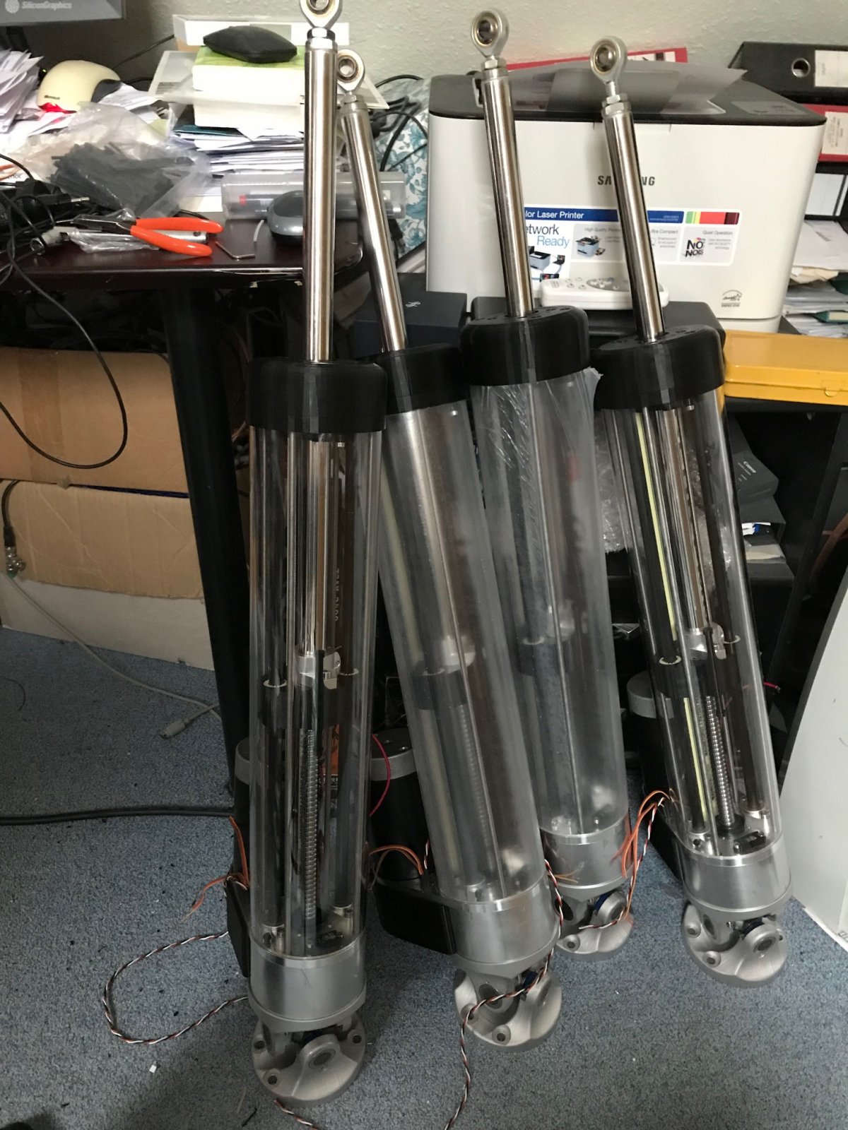

    now i had time to assemble more actuators. 4 out of 6 actuators were assembled and pretested.
    The rest 2 actuators will be completed next weekend.

    Those PMMA tubes are beautiful! What a way to show off the actuator mechanisms! Very nice work!

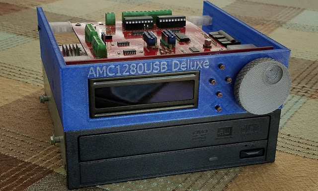

    Good Morning Mate. Excellent design. I've being following your Linear Actuator design for the past weeks .
    I'm going to build mine with a 1kw Servo motor for my 6DOF Simulator with my Thanos Kickstarter controller. Can I ask if you can send me the CAD or designing files of the design in case I need to change something on for for the different motor. The one I'm after is the Actuator Motor side mode mounting plate being made from Aluminum . Thanks Aussie

    Thank You for the reply.I will be using Thanos AMC1280USB Delux controller. I might change to a 750w AC servo motor instead.

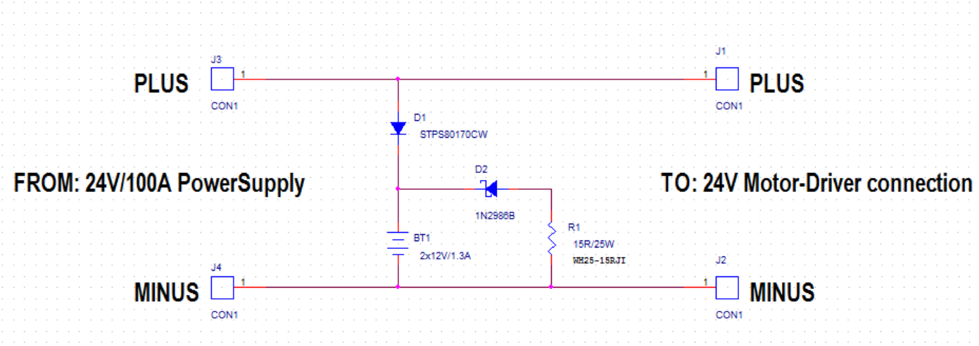

    but the battery of car is much of 1.3 A

    That’s right, I found out that the Regen energy (in my setup) in terms of power (watt seconds) is relatively low, so the smaller batteries are OK.
