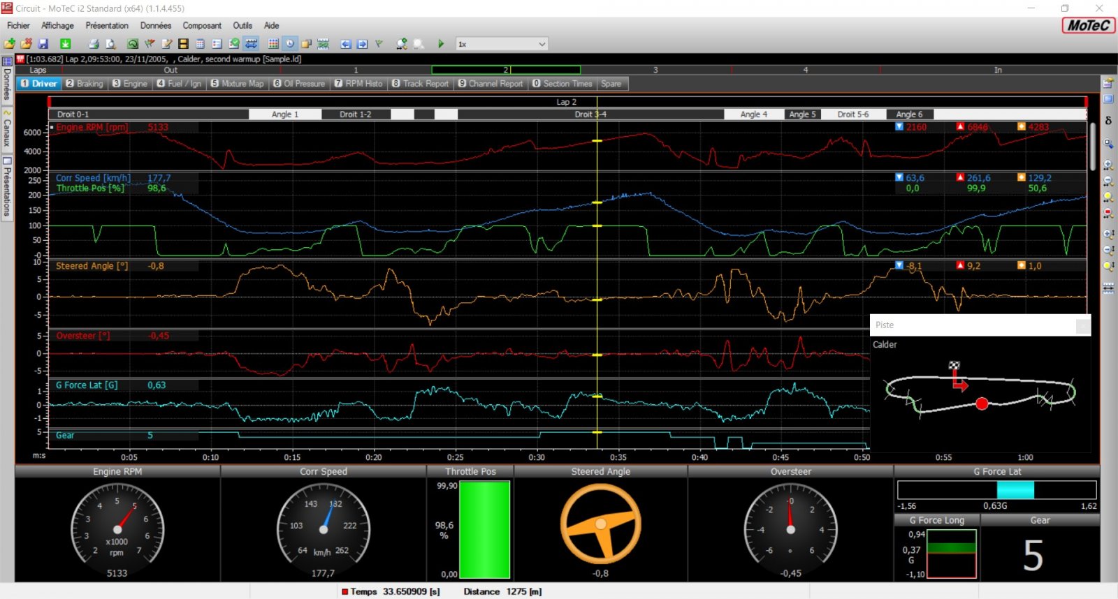

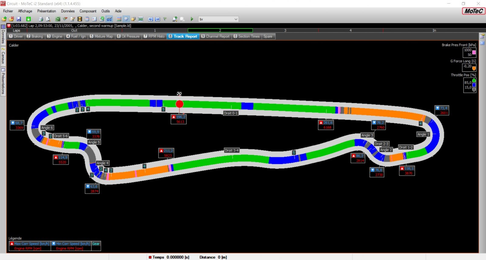

    Hi all,
    Maybe my question is strange for you, but I want a confirmation.
    I'm very interested in Kartkraft, i want to get the telemetry of the laps in a session, to study brake, accelerator, position, RPM, speed...
    So, my question is : If i use Simtools with the kartkraft plugin, can I get all theses informations ?
    The perfect would be a presentation like Motec
  12. noorbeast
    22,197
    154,645Coins
    +11,206 / 57 / -2
    On the plugin Download page the plugin Dev lists the following as currently exposed:
    Motion data:
    This plugin provides pitch, roll, yaw and surge, sway, heave acceleration and traction loss.
    DashApp Data:
    Speed, RPM, Gear, Position, Lap, Lap Time, Total Laps

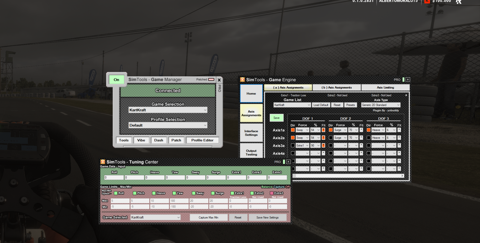

    I´ve recently bought KartKraft and install the plugin, but nothing works. I think it is due to the process name. Game Manager doesn´t detect project_k
    Any help?
  14. JohnCrichtonFR
    JohnCrichtonFR JohnCrichtonFR 5 DOF Gold Contributor
    Jun 4, 2018
    20
    Maintenance Technician
    22Coins
    +12 / 0 / -0
    4DOF, 6DOF
    Hi Alberto, have you activated on the game the telemetry and verify the UDP port (default is 5000) ? Or you have another problem... Have you patched the game plugin ?
  15. AlbertoMoralo15
    AlbertoMoralo15 New Member Gold Contributor
    Jun 10, 2020
    14
    - 21Coins
    Yes I have installed amd verify only UDP is on
    My port is 5000
    I don´t know why my Game Manager doesn´t detect the game is on
    i mean it is in green but not on blue
  16. JohnCrichtonFR
    Jun 4, 2018
    20
    22Coins
    +12 / 0 / -0
    4DOF, 6DOF
    I d'ont understand what you will say, can you send some screen pictures please, maybe it can help...
  17. AlbertoMoralo15
    Jun 10, 2020
    14
    - 21Coins
    Here you are
  18. AlbertoMoralo15
    Jun 10, 2020
    14
    - 21Coins
    There has been an update recently, that could be the problem. They have introduced a new series
  19. JohnCrichtonFR
    Jun 4, 2018
    20
    22Coins
    +12 / 0 / -0
    4DOF, 6DOF
    OK, so, I see "patched" in "Red" on "game manager", this means that your plugin is not patched. re-patch the plugin first and then it should work ... you will see "patched" on "Green" when it's OK.
  20. AlbertoMoralo15
    Jun 10, 2020
    14
    - 21Coins
    Now it works perfectly, thank you a lot!!!!
