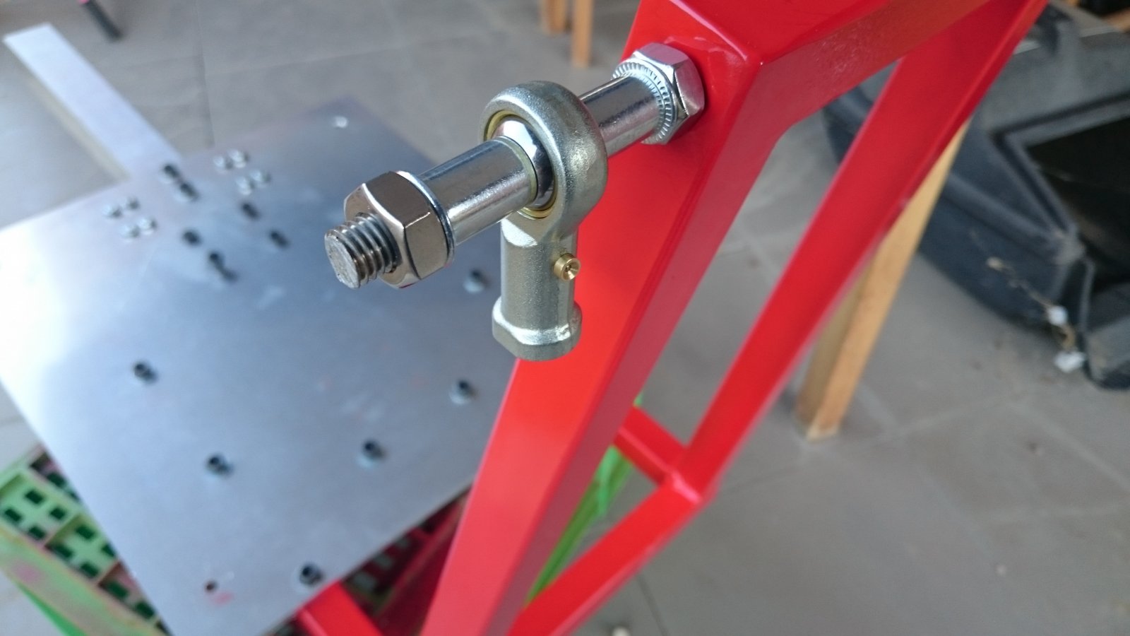

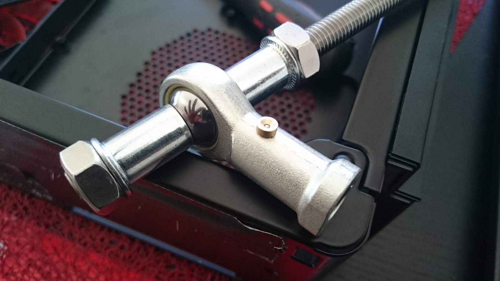

    So I have prepared the mounting system for the seat shoulder frame consisting of a M10 Rose Joint with 10mm threaded rod and a couple of push in rivet locks @ 10mm DSC_0130.JPG DSC_0131.JPG ....

    Nice idea with the Stand offs, Little long maybe you could cut them down to size.

    @Nick Moxley Thank you. And yes.
    They will not have ends visible when I am finished with them. They are currently there to give me a little 'adjustment' room if I need it whilst testing...

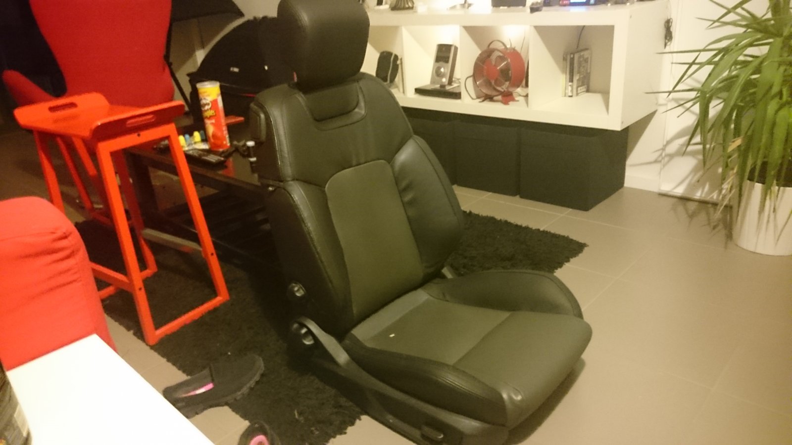

    Nice seat, I am guessing it is pretty weighty, how heavy is it?

    It's actually out of a Holden SS/V ute I believe. I bought the pair of them with the rails and was going to use them with the rails to form some sort of adjustable pivot point and that weighed in at just over 22Kg's. Once I had removed the rails and weighed just the seat itself, that came in at just over 10Kg's, so its about 30% heavier than say a Tillett or Recaro Race Seat....

    You can use the rails to make adjustable pedals. An adjustable pivot point is only useful if you are switching between modes of a simulator, say full frame to seat shaker, and it is more easily achieved with a center post that clamps to rails.

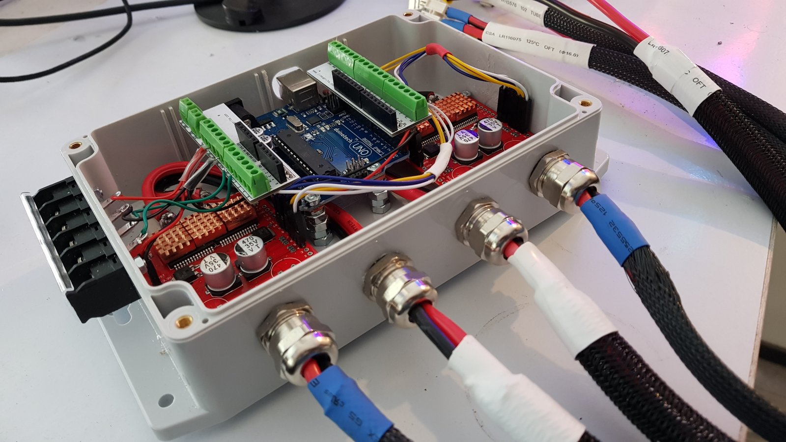

    SO, I also last year came across a commercial fixed frame simulator (TrakRacer) and decided to purchase one. Since my initial inception was always to build 2 simulators, one for race and one for flight (ED), I decided to build up the car simulator first as my children were all bugging me for one. I had a whole series of photos as I built the frame for the motion platform but as Murphy would have it I lost those so the only photos are those of it completed I am afraid.Now having completed the electronics I am about ready to delve into the Sim-tools installation and setup and naturally would rely heavily on the expertise by all you wonderful people on this forum.
    I'll start by posting some photos...

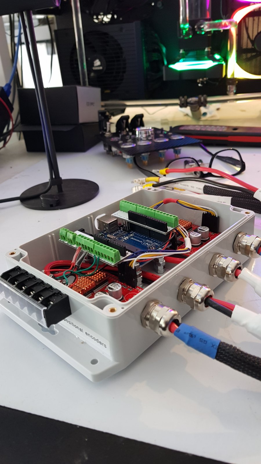

    This is the arduino and motomonster controller box. I have it ready and cabled and ready following the SMC3 config

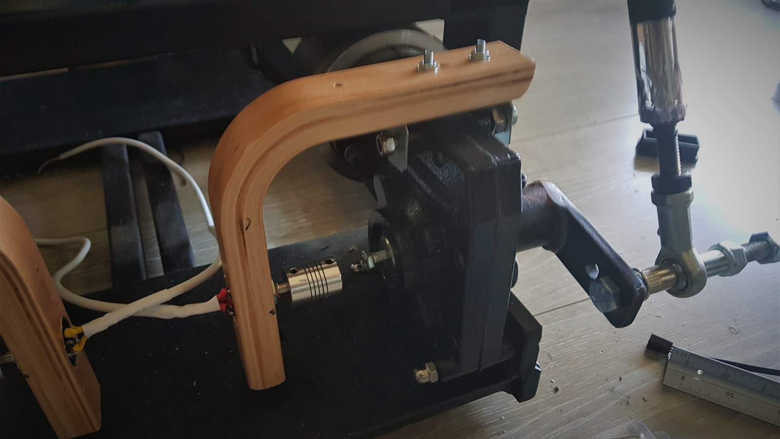

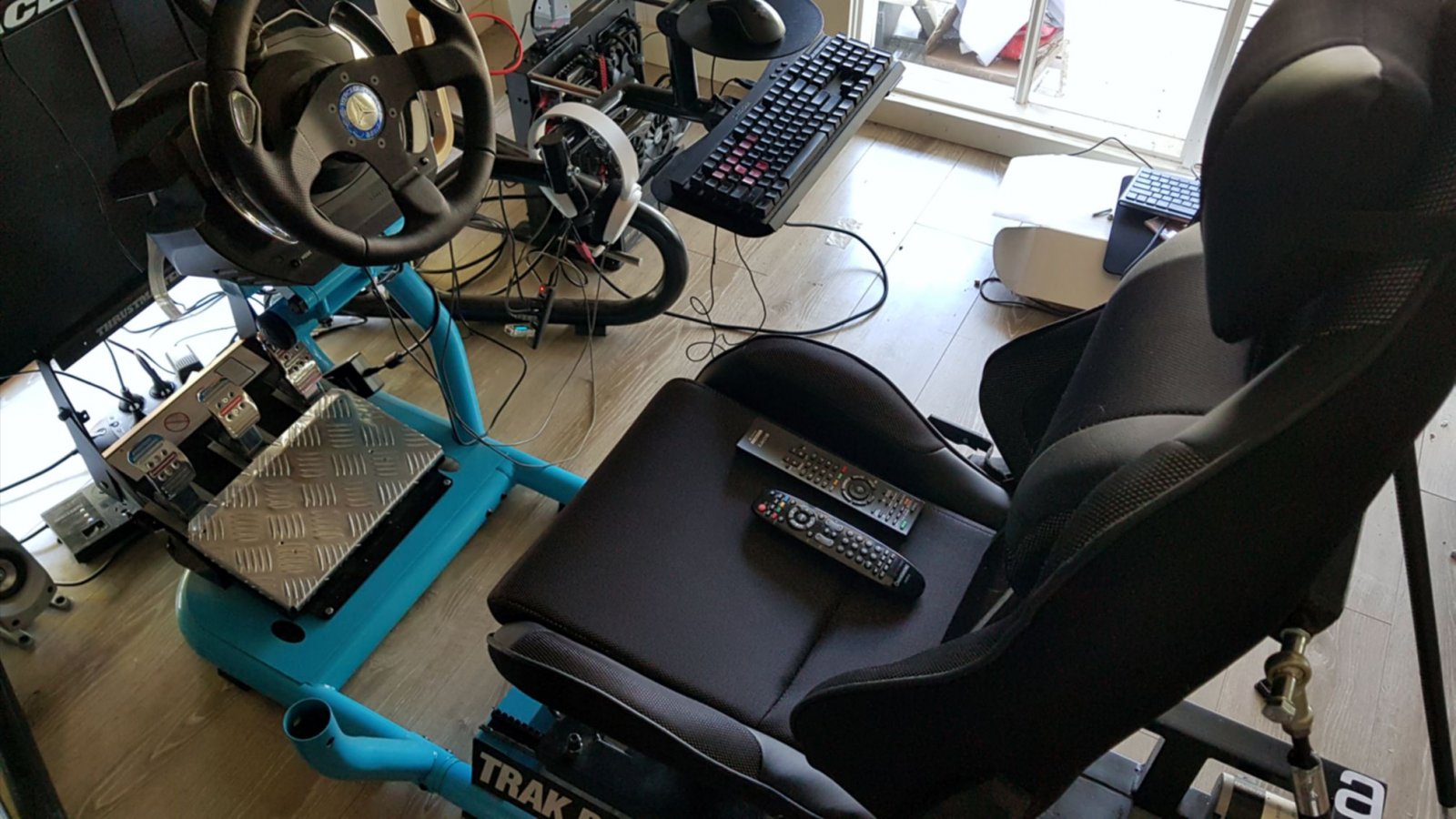

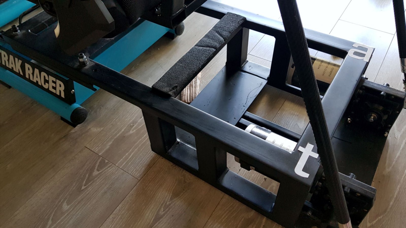

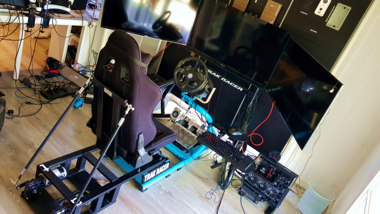

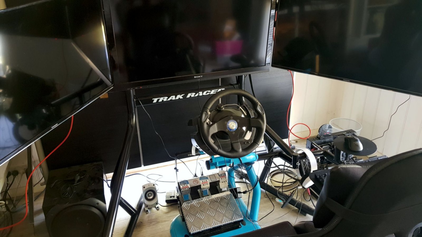

    Here are the photos for my 2DOF simulator

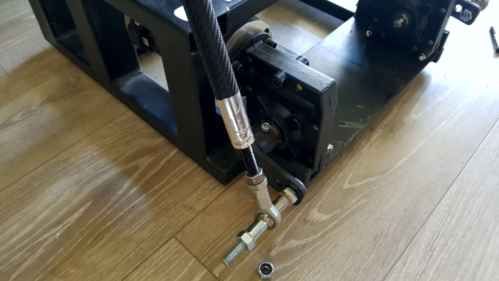

    The actual frame. I designed and built this so that I can have freedom of choice re the model of fixed race sim I want to purchase and utilise. As one can see, the frame of the seat mover is able to fit and bolt up to the rails of any simulator out there as long as it uses the standardised mounting system for either a normal or bucket type seat with brackets....

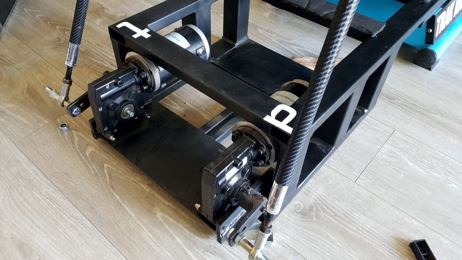

    The levers and connecting rods...
    I'm utilising the 200w motors here from Motion Dynamics with 50:1 gearboxes which ought to be ample for the purpose....
    The Wheel and pedal set mounted....
    The seat I'm using (it's a DX Racer type copy... probably going to creak!)

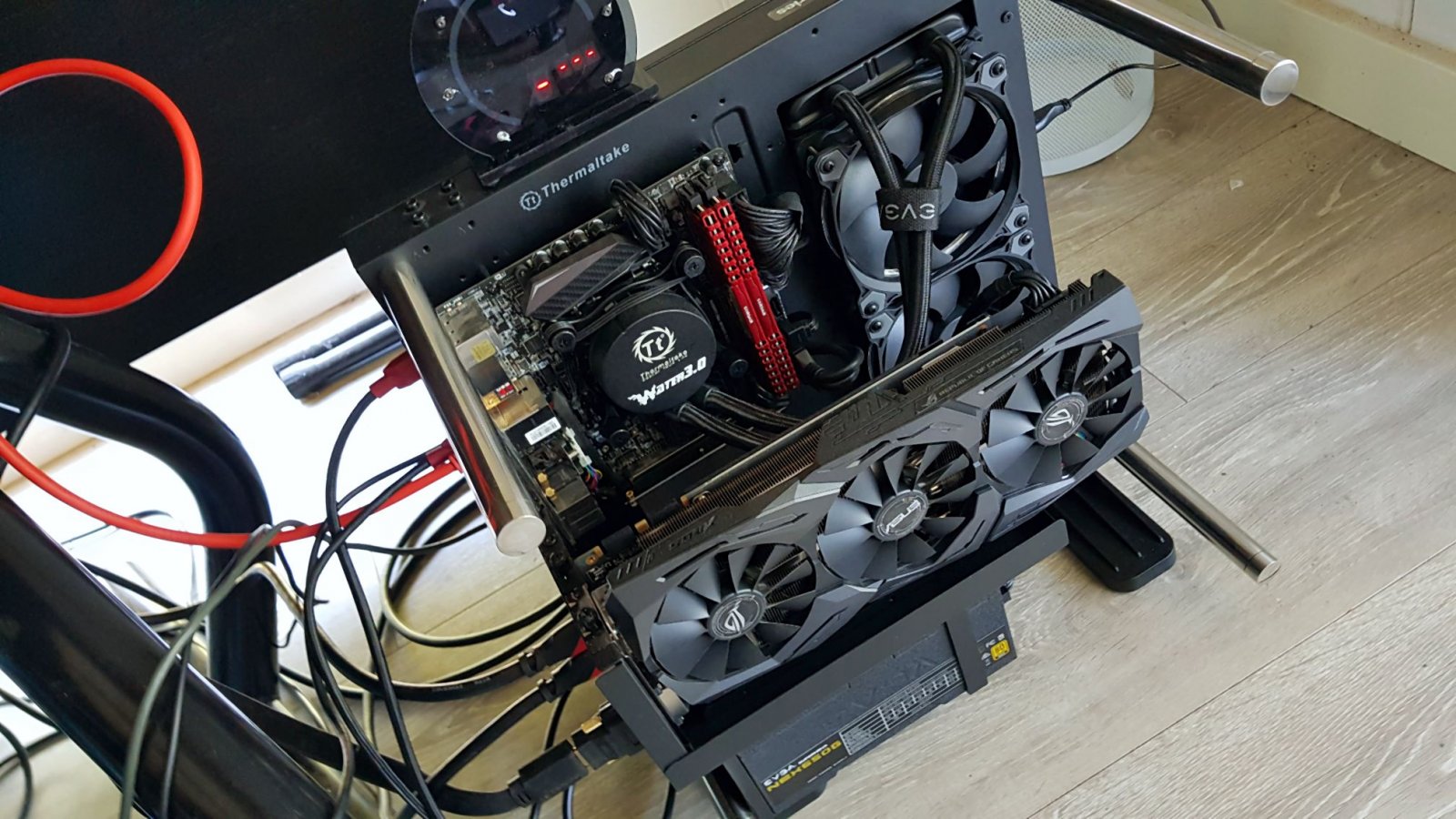

    The pots ( Thanks @noorbeast for the recommendation!)
    The PC I built custom for this chair..... :)

    The chair as it is at the moment (Please excuse the mess!) :eek:

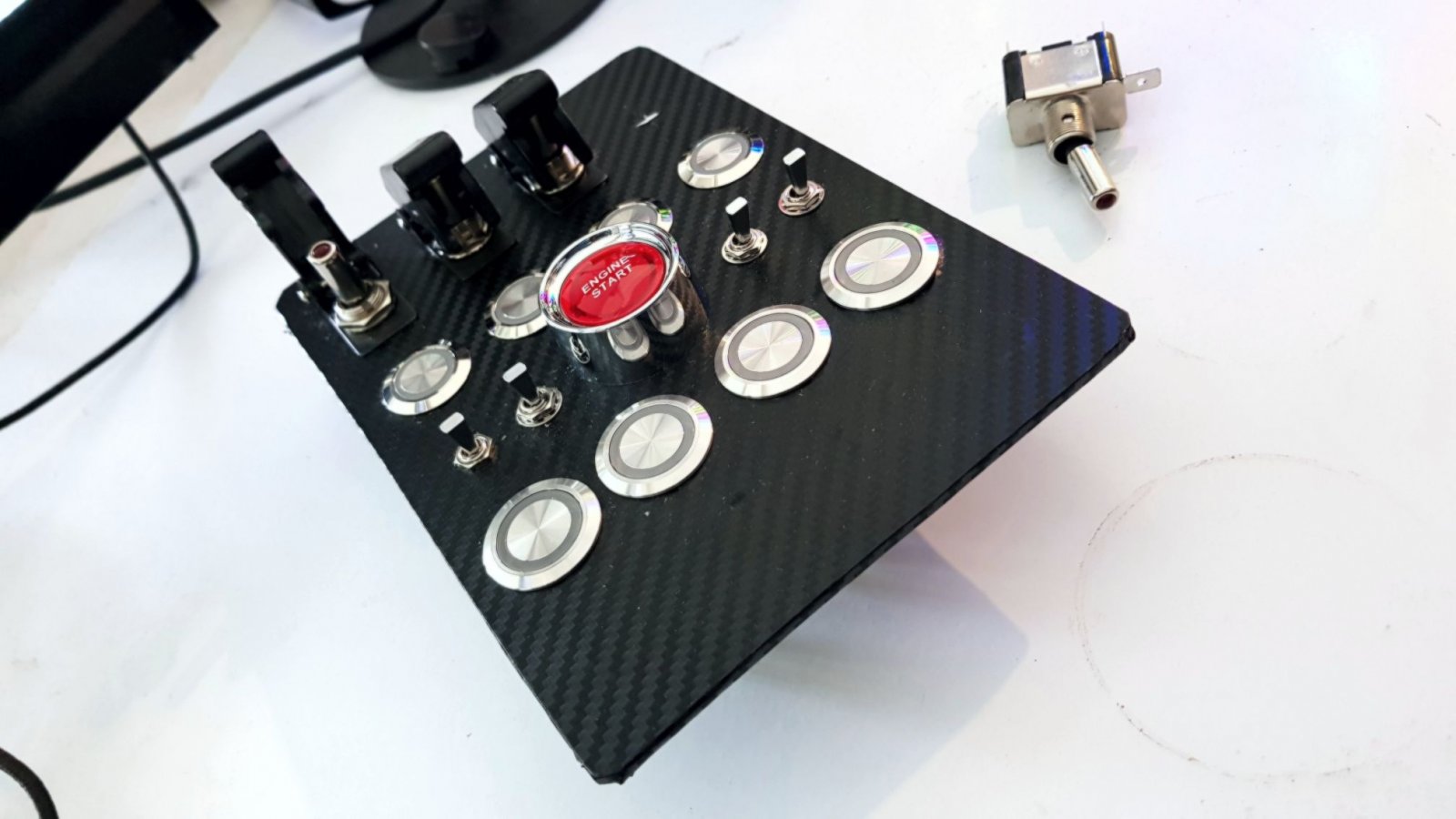

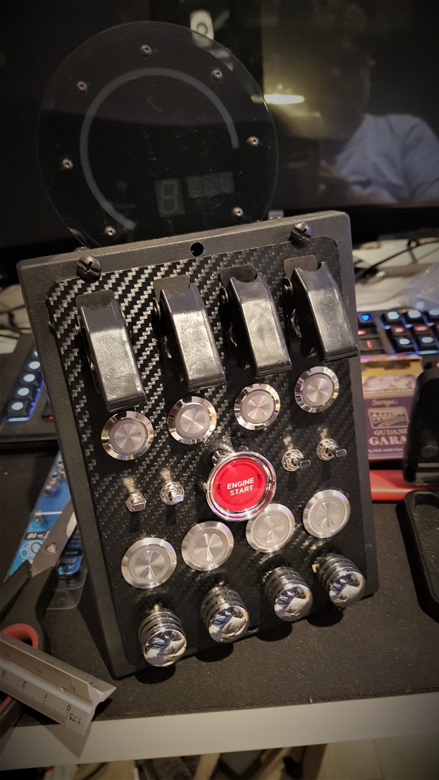

    And this is the button box I am currently building!

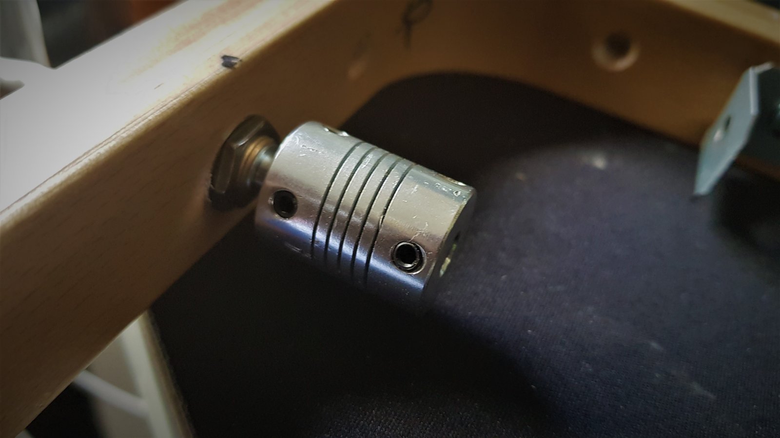

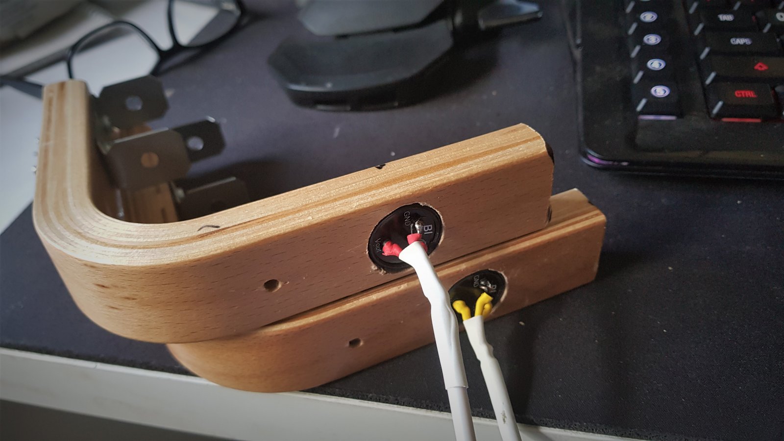

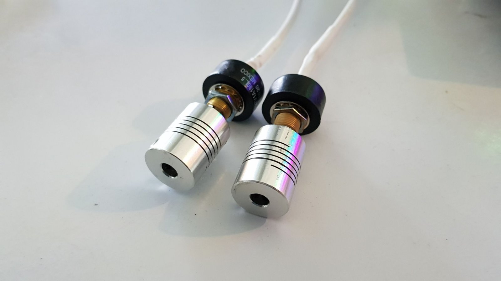

    I used these brackets to recess and mount the pots.
    Fitted the couplers...
    And mounted them so that they are ready to go.

    I got it all wired up and fired up tonight. And I would like to say that its all working according to the SMC3 utils step by step!
    No blown ard and no blown MM's! yay!
    Now on to installing simtools.....

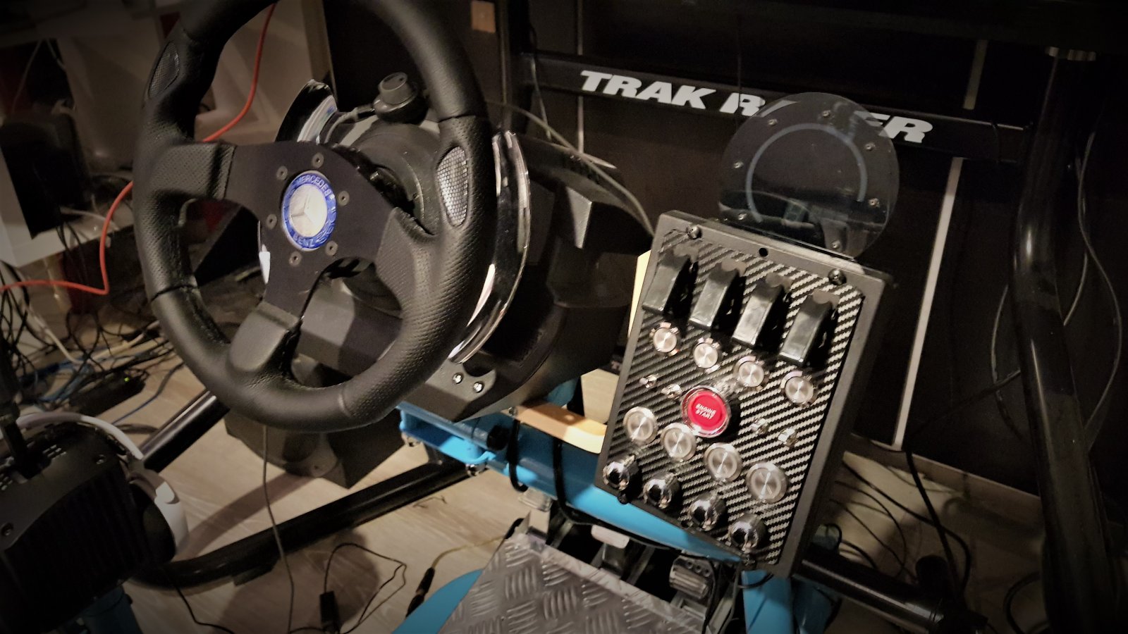

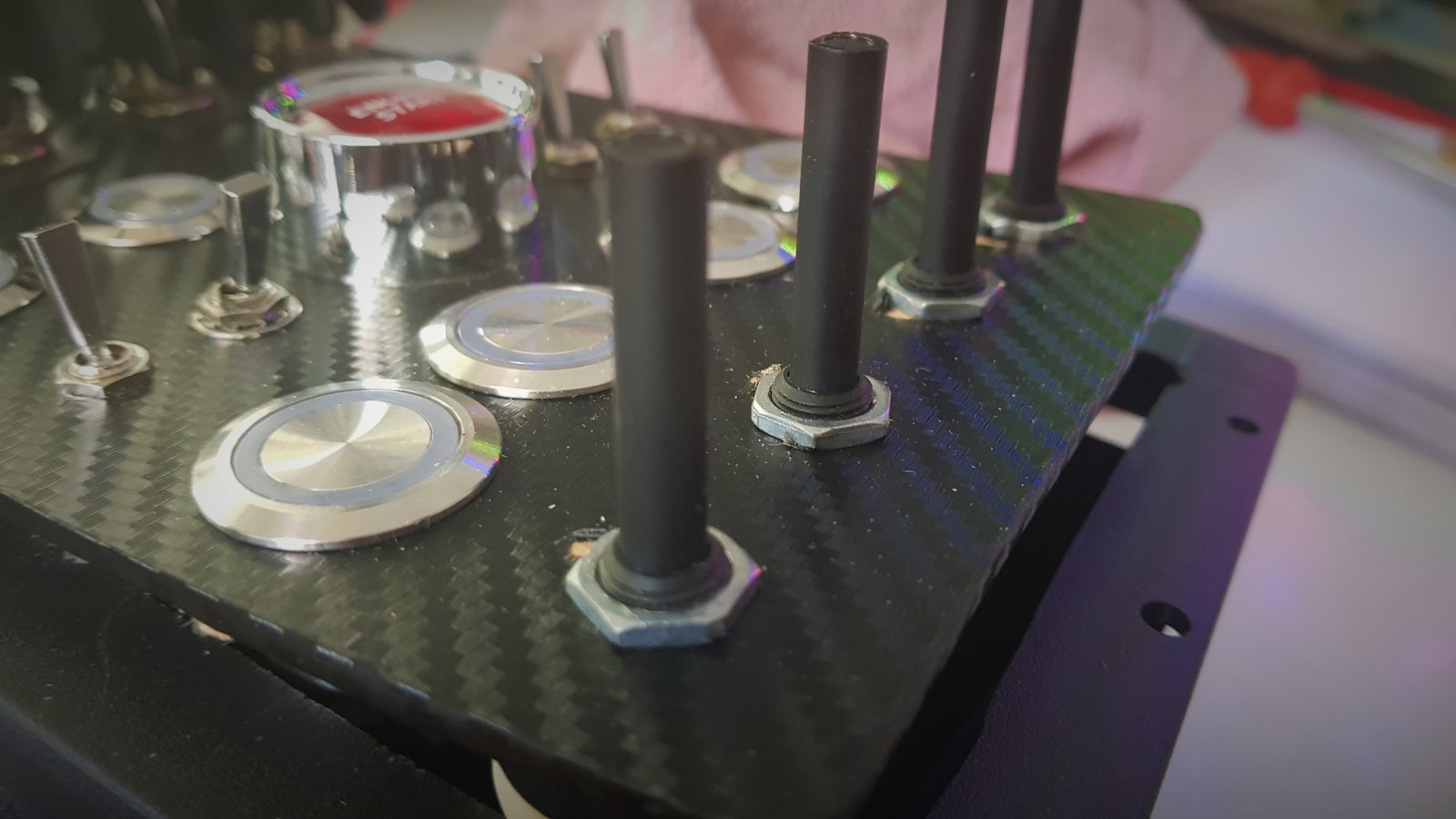

    Mounted the 3 way switches on the button box
    Cut the switch shafts to size and dials in place and added the renovatio dial....
    And now mounted onto simulator
