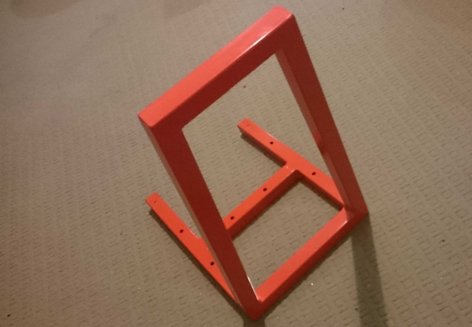

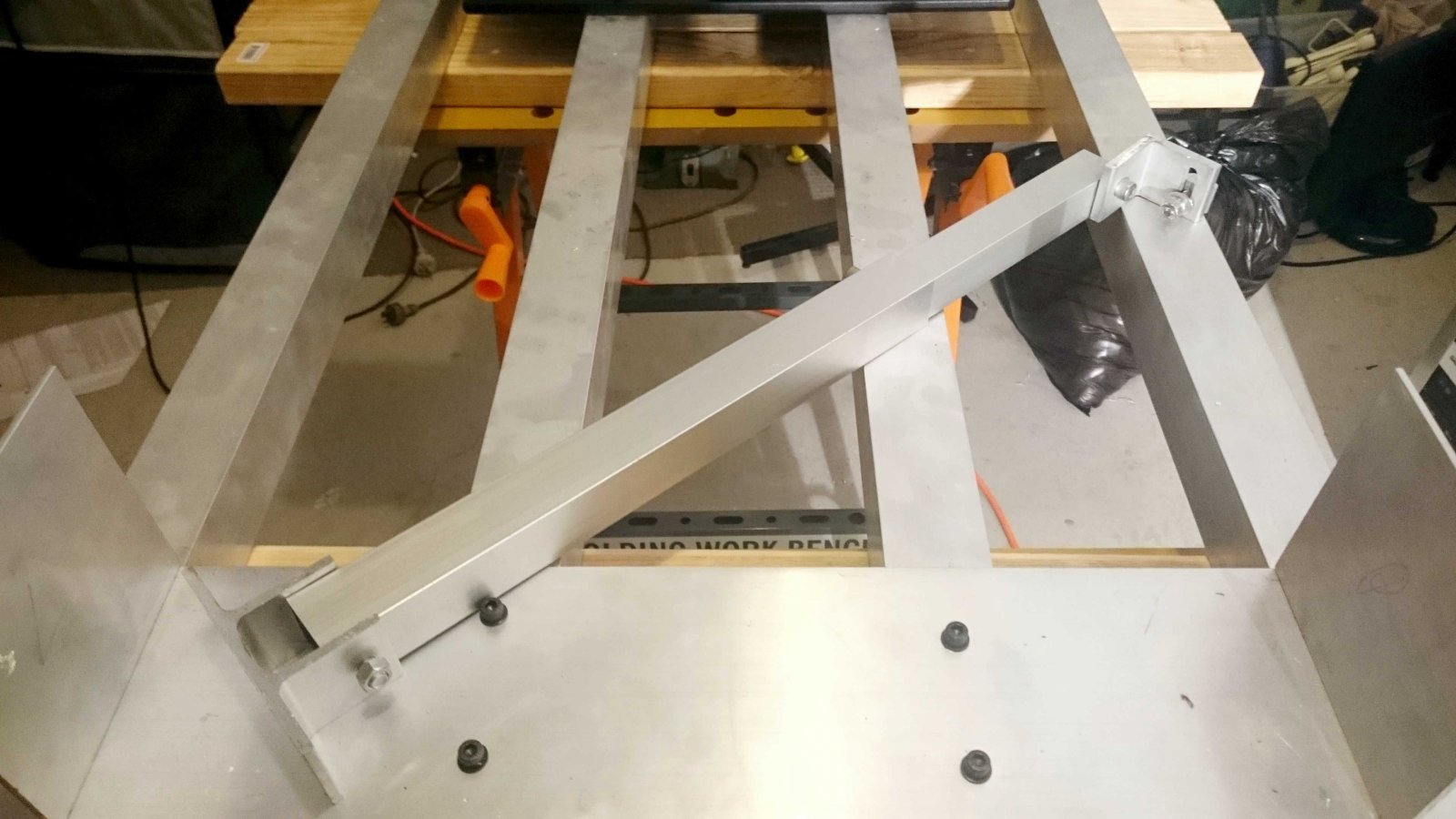

    Extension braces to minimize base twist....

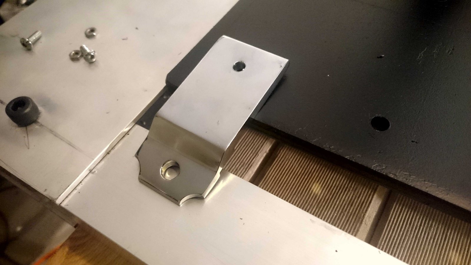

    oh! And back chair brace is painted and drilled :)

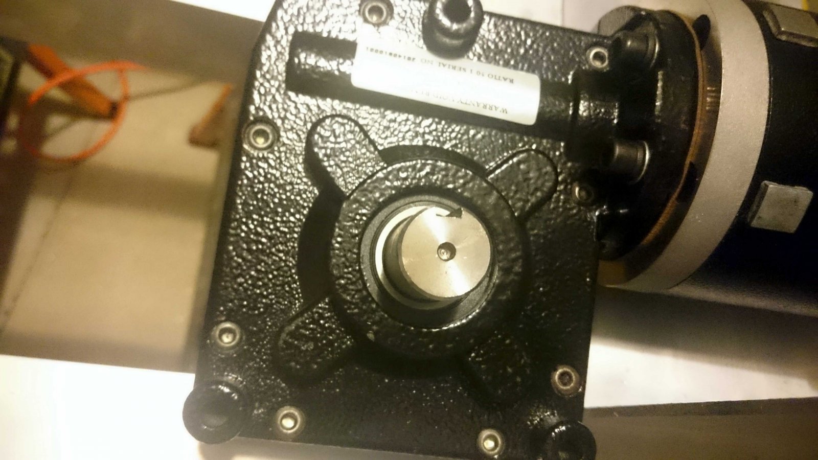

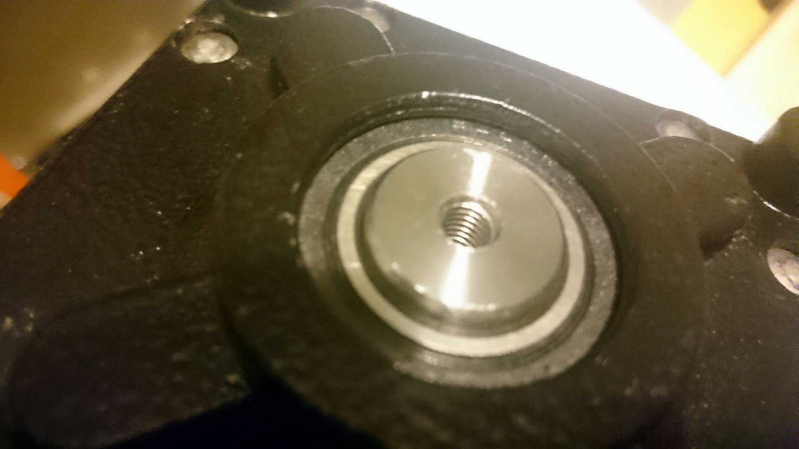

    And I have also drilled a push hole for the motor shaft (thank you to @noorbeast for the tip!) for ease of removal and tapped a 6mm threaded hole for the potentiomenter couplers (will have a 6mm threaded rod for coupling)...

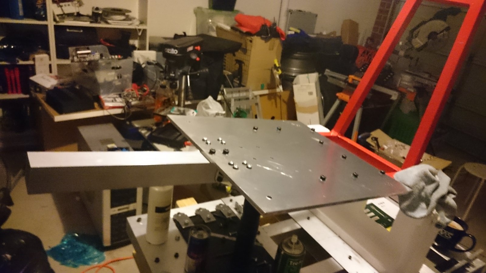

    I also created a sliding arm for what I envisage to be my throttle and joystick mounts on my chair. I had some profile alum and some interesting bits and pieces from my solar panel installation and thought I would use it here....the base pivots forward and back and the the entire thing is a 2 part telescopic arm with a right angle mount to have the plate. Is suspect it may be too long but I'll shorten it if I have to..... :)

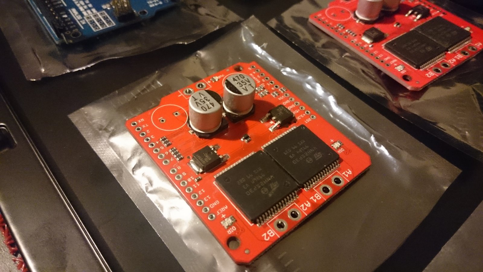

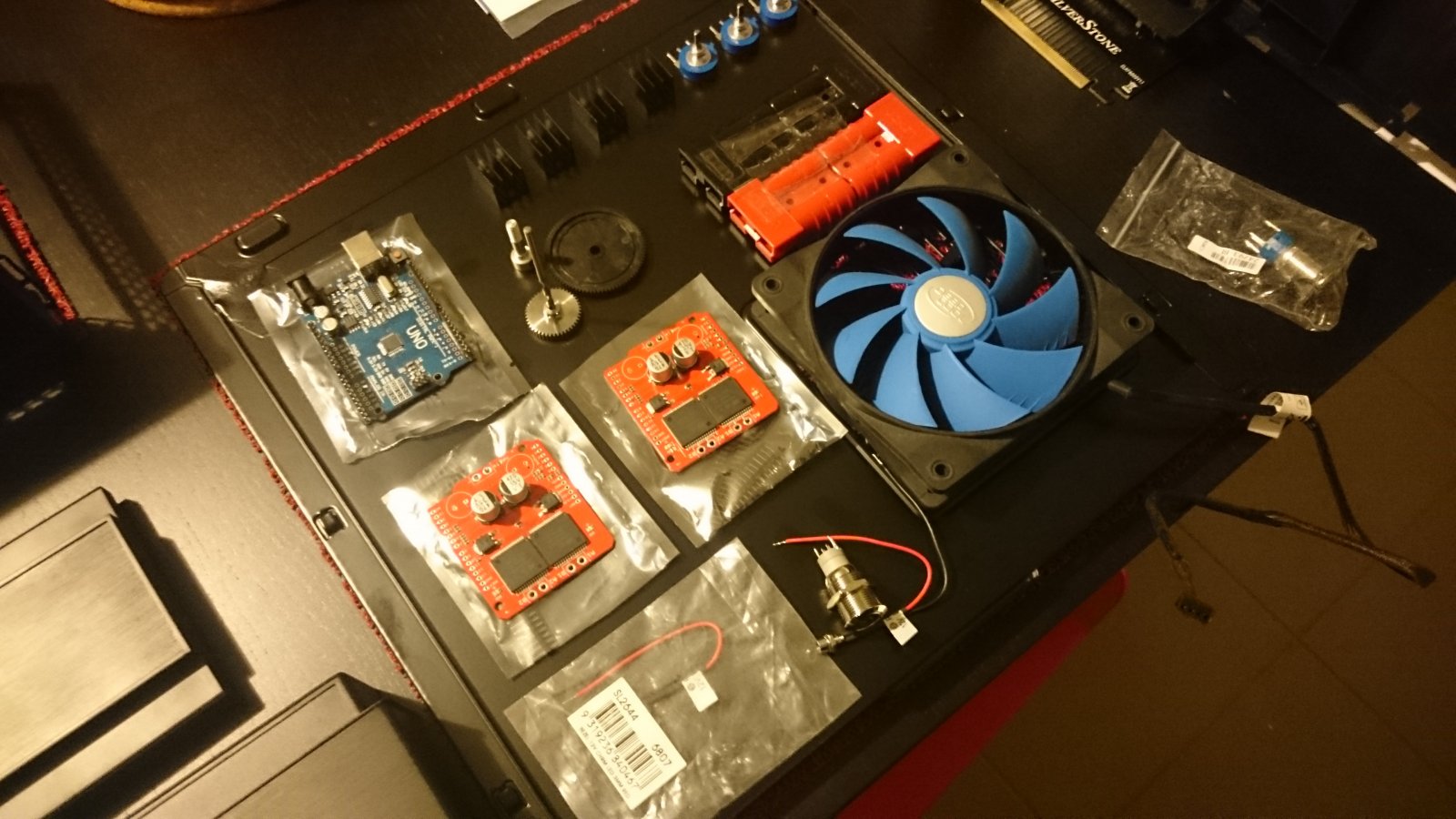

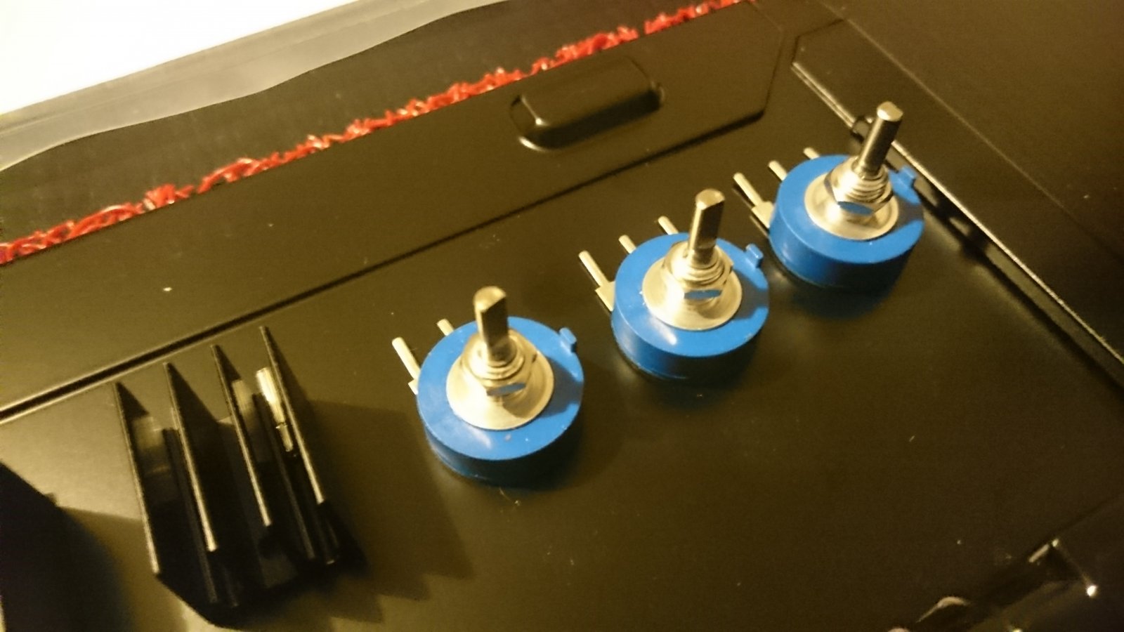

    the components...

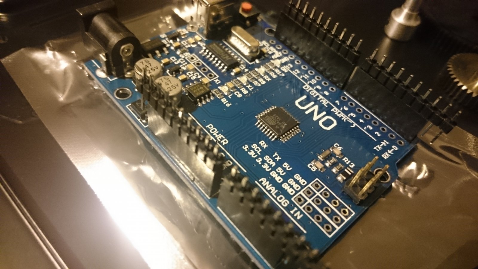

    arduino clone board (hope this works!)
    Sparkfun Moto Monster Shield
    Cermet Pots - Bournes 10K

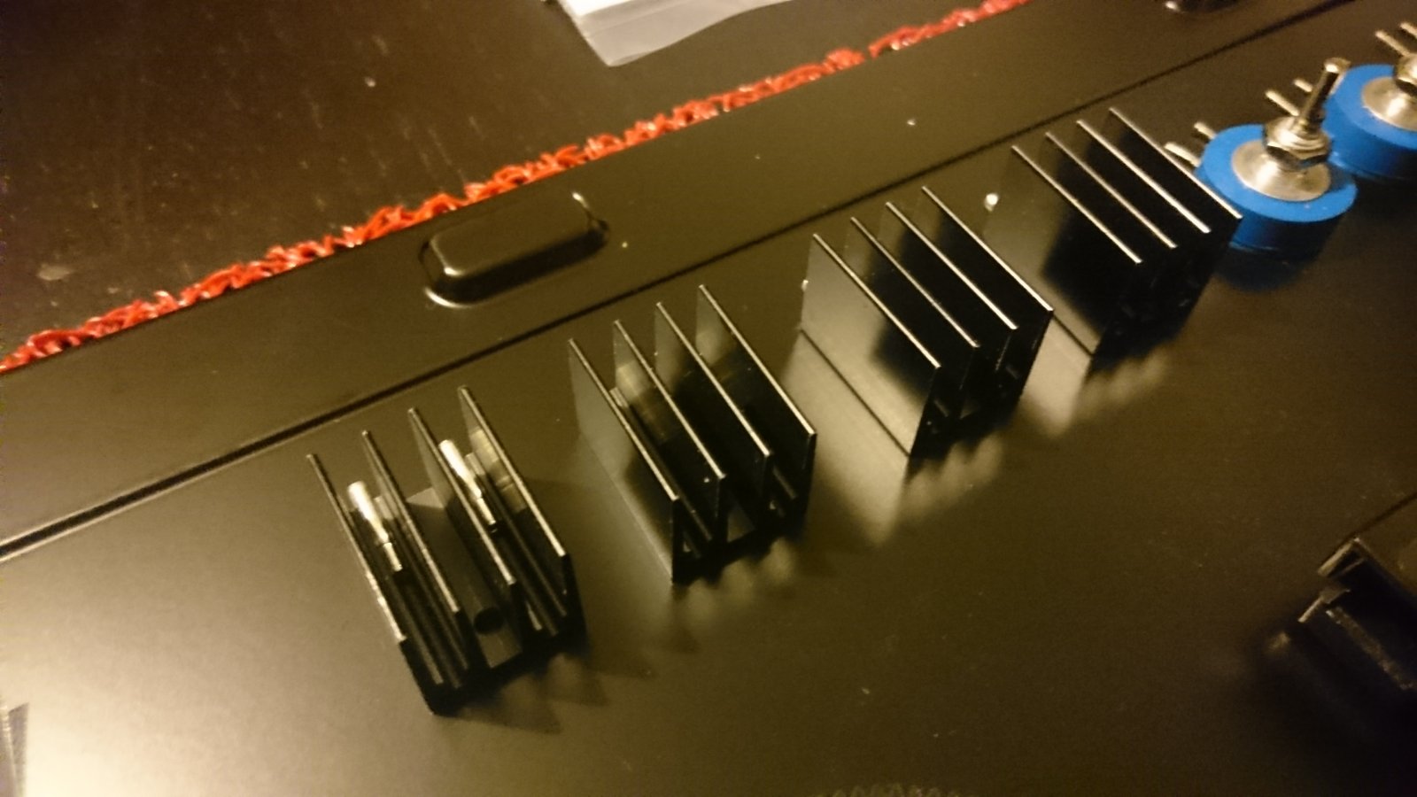

    Heatsinks for the Moto Monsters

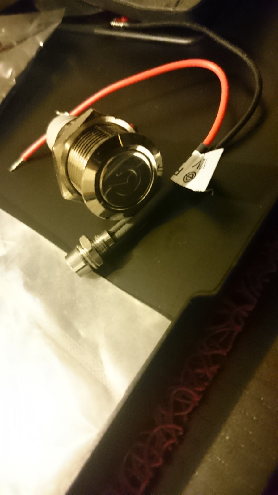

    The power switch

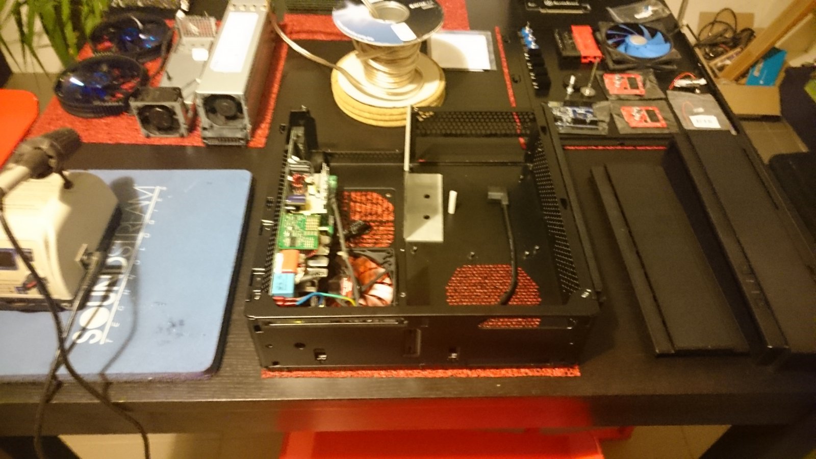

    I started the case mod. I have dismantled the 2950 PSU so that its out of the case and I can now rid it of its 'Jetfighter' fan, plus make it a little more compliant in terms of wiring and neatness.
    I have modified the actual case to hold the PSU's and have divided the compartments so that I can place the arduino and moto monsters on the other side with a fan blowing right through to the top of the shield driver boards. And there is additional space for the future electronics eg. dashboard arduino etc.
    I have placed a fan right under the power supply to keep them cool and silent.

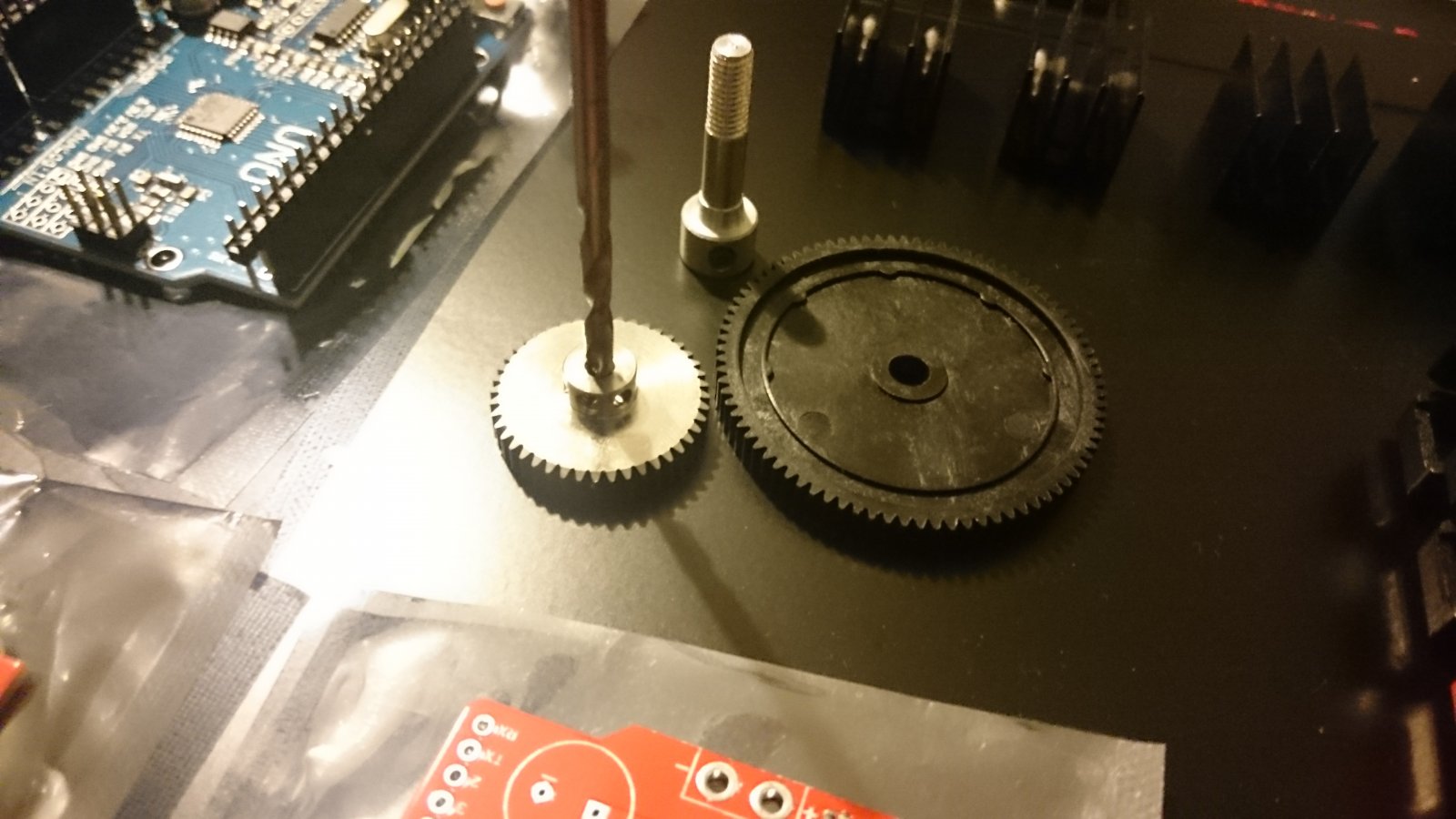

    These are the gears I am going to be utilising for the feedback pots
    Spur @ 84T / 48 Pitch & Pinion @ 44T / 48 Pitch - incremental ratio of 1.909 (100 degrees to 190.0 degrees on the pot)

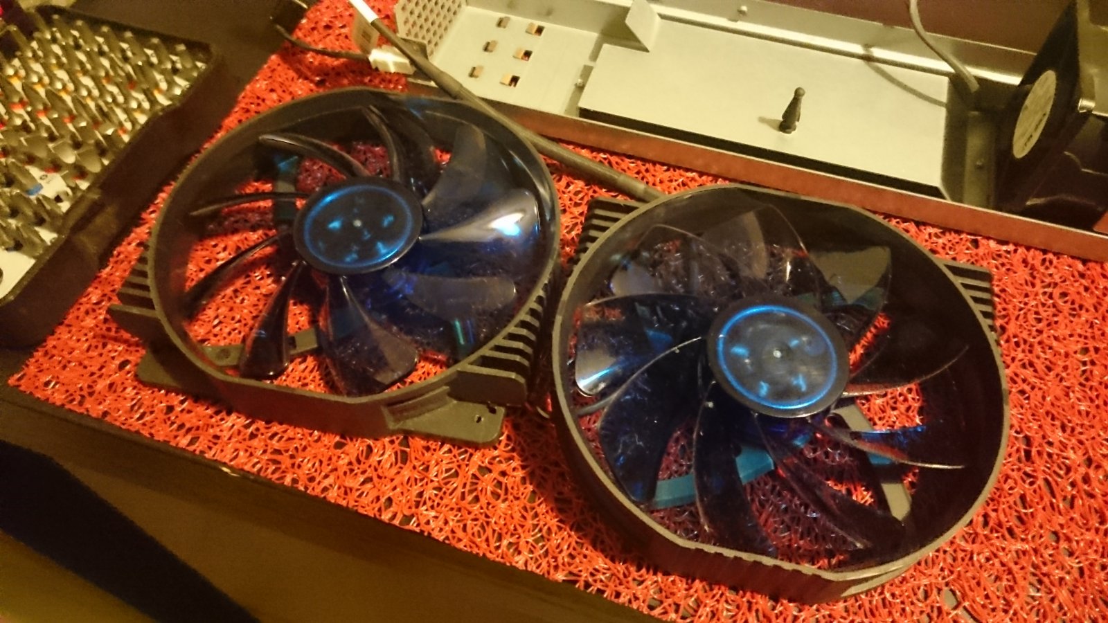

    These are the fans I will use to cool the motors at the moment until I work out the water cooling...

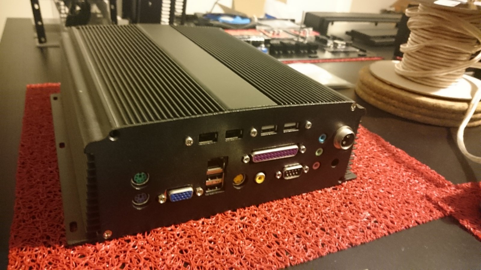

    And the Mini PC I have put together in order to run SimTools separately.
    Atom 1.6Ghz with 4GB ram, 250GB HDD and will be running Windows 8 (a lightened version)
  18. pipis2015
    pipis2015 over-boost
    Feb 18, 2015
    222
    Athens, GREECE
    10,248Coins
    +272 / 1 / -0
    Why not go all the way to 270?

  20. kanuk
    Jan 24, 2015
    214
    Eng
    Melbourne Australia
    2,380Coins
    +202 / 1 / -0
    One of the reasons were that they dd not have a smaller spur at the local hobby shop (and I did look for one) but also decided that it may be a blessing in disguise considering if the motors do overshoot the pots would have plenty of leeway for safety and not shatter upon themselves :)
