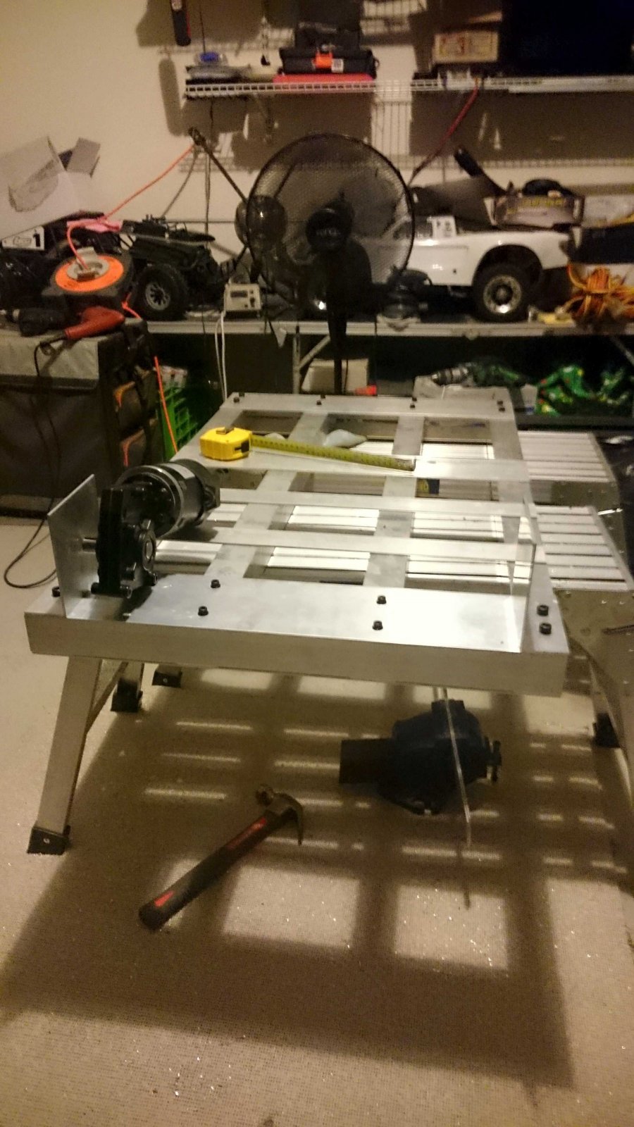

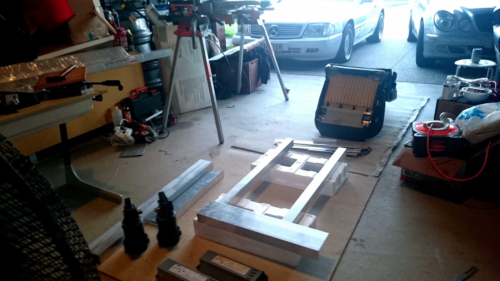

    It has begun!
    And @noorbeast you are so right when you say the project starts simple...and then all the additions come creeping in! You should see what's in my head now! LOL
    This weekend is one of progress.... I have everything in my hot little hands right now bar the moto monster shields.....
    Wish me luck!
    PS. Please don't judge the condition of my garage... that's DSC_0006.JPG what happens when you have just moved and then decide to start a project without unpacking properly! :D

    :thumbs Keep them photos coming!

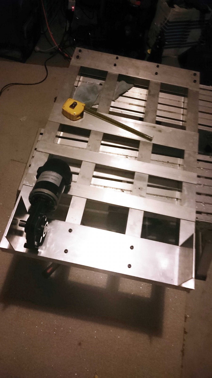

    Great! I have ordered those and I presume that 12mm threaded steel rod would be perfectly functional yes?
    And the base is now together. The bracing is going on now.... It seems to have no torsion twist whatsoever at the moment, so the bracing is only going to help it along further.....

    Looking good @kanuk :thumbs
    Most use square box tubing with nuts welded either end for the rods, with some threaded rod either end to connect to the heim joints. Mine are unusual as I created them from solid aluminum round bar, which I tapped either end.

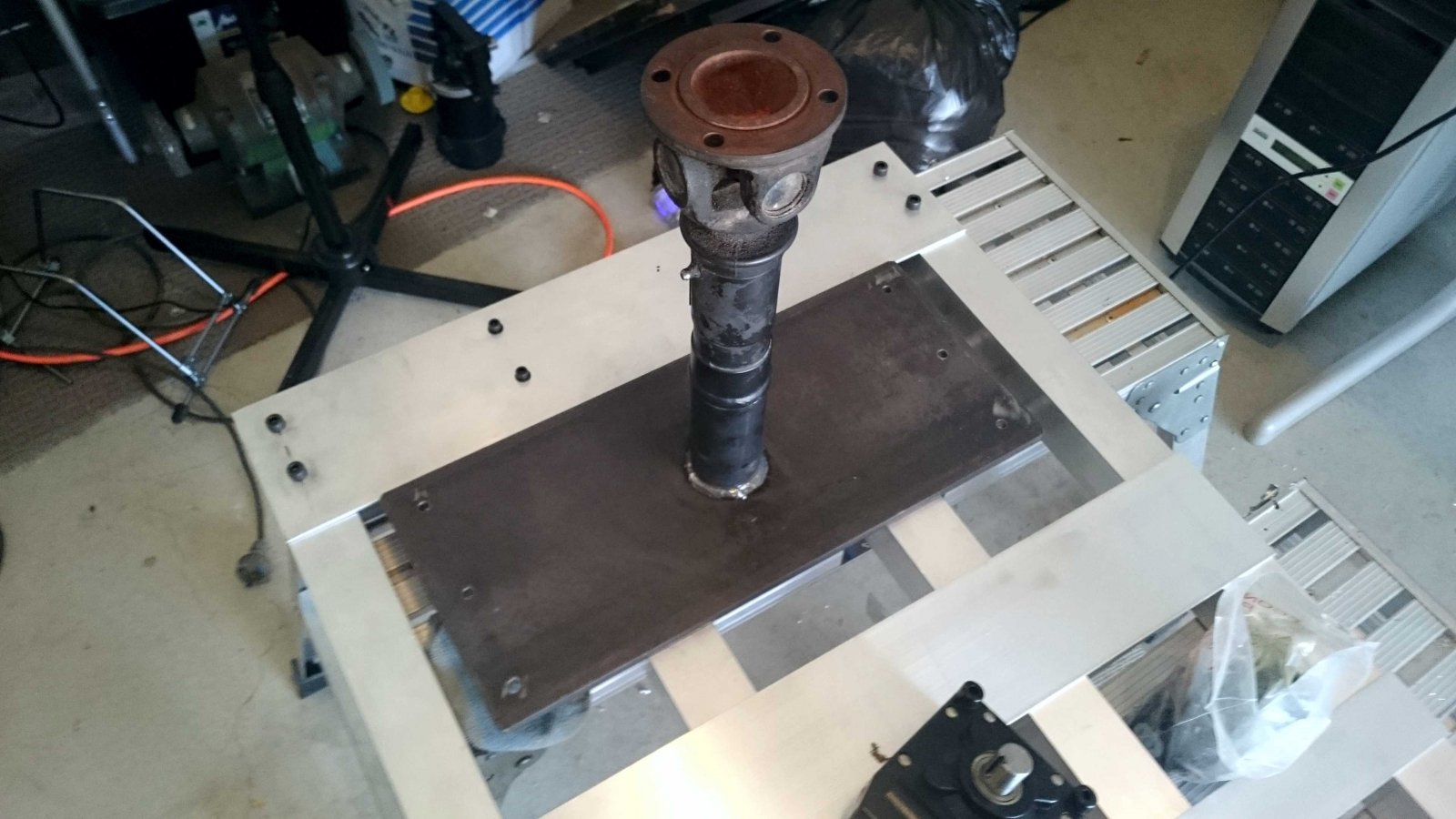

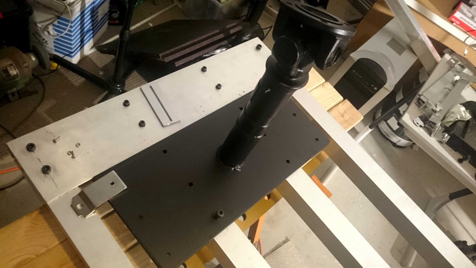

    So, here's the completed Uni-joint on the plate....
    Now I'm gonna clean it up for some paint......

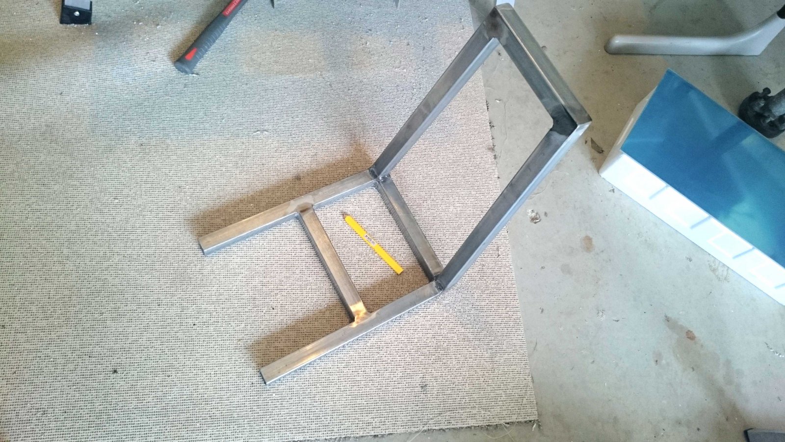

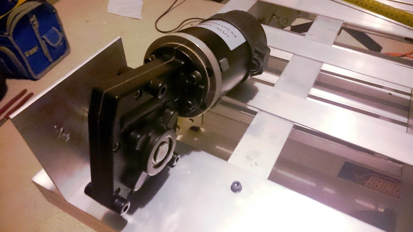

    DSC_0011.JPG And here is the Chair brace.... tested my welding and grinding ability (both of which I am not very good at! LOL) :)
    And also about to be painted.
    21,663
    151,632Coins
    +11,043 / 56 / -2
    It looks just fine @kanuk, and plenty strong enough!
  12. RacingMat
    2,237
    21,042Coins
    Looks very good! :thumbs
    You will have to reinforce the motor mounting, it's too weak with a simple L square shape ;)

    @RacingMat
    Indeed sir! There is a lower half on the inside that's not mounted yet and the motors will be strung together with a reinforcement bar between them.... so yes. they will be sufficiently braced (onehopes anyway!) :D

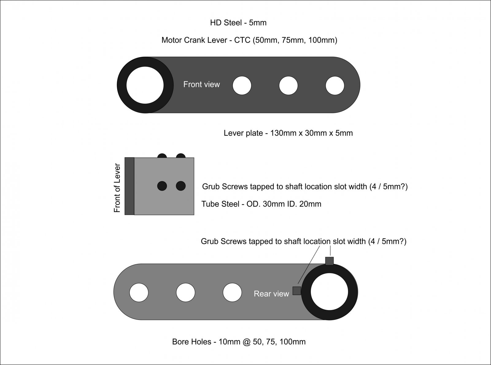

    so.... ctc levers that i've designed. Does it look alright?
    Any advice?
