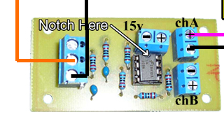

  15. eaorobbie
    20,503Coins
    +1,687 / 23 / -2
    Im sorry to bring bad news my friend, maybe a circuit to change the output voltage to 10v range is more suited to what you need.
    This board was originally designed by @yobuddy.
    Sorry can not remember where it is posted.
  16. yobuddy
    51,533Coins
    +5,204 / 19 / -0
    The PCB above is posted in the AMC EZ thread.
    for those who need it.
