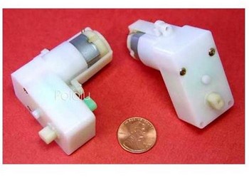

    Motors
    Of course you need motors.
    This project were developped with little DC motors : Solarbotics gear motors, supporting 3V-9V.
    I have connected a 6V power supply adaptor to the Sabertooth.
    I suppose you will be interested to plug wiper motors, and I believe it is possible with this configuration (K8055 + Sabertooth).
    Indeed, the new Sabertooth model supports 12A continiously and 24V motors.
    This is the good news, even if until now, I had not the possibility to test with wiper motors.

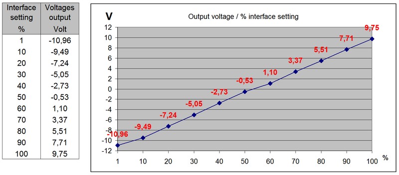

    The first test I propose is to move the motor through X-Profiler menu. This is a good solution to check all the connexions and to be sure that everthing’s working well.
    TEST : In the menu of “Interface setting” of X-Profiler, select the analog output from the list “All outputs of found interfaces” (normally DAC1 = Output analog 1), and fill in a percentage into the field between 0 and 100%, click on the button “Set output” and look to the motor reaction.
    [img600px]http://nice.maurice.free.fr/Tutorial/Interface_setting.jpg[/img600px]
    Please, try the figures below and look directly to the motor effects ;
    · 0% will make the motor moves at a full speed in one direction (0V)
    · 100% will make the motor moves at a full speed in the other direction (5V).
    · 50% will stop the motor (2,5V)
    · 60% will make the motor moves slowly in one direction.
    · 40% will make the motor moves slowly on the other direction.
    · 50% will stop the motor.
    Please read the “speed and direction” section in this tutorial (Sabertooth Dual motor). You can look directly the effects of X-SIM configuration on the motors, through K8055 + Sabertooth boards.

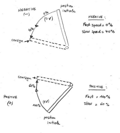

    Create 2 speeds for the axis :
    Repeat the same procedure with a new speed. At the beginning of my tests, I had problem with keeping the consign. It was solved by creating 2 speeds in the X-SIM profile (slow and fast speeds). To summarise, you must configure a Slow speed and a Fast speed :
    Slow speed : positive (60%), negative (40%) and stop (50%)
    Fast speed : positive (100%), negative (0%) and stop (50%)
    Keep in mind that 50% means 2,5V. With 2 speeds, motors will move quickly at the beginning when it is far away from the consign.
    The motors will move slowly when it will be very close to the consign. Then, the motors will stop at the consign.
    A summary :
    Fast speed :
    100% is full speed in positive direction (5V)
    0% is full speed in negative direction (0V)
    50% is stop (2,5V), when the consign is reached !
    Slow speed :
    60% is slow speed in positive direction
    40% is slow speed in negative direction
    50% is stop, when the consign is reached !
    With the picture, you can see the speed of the motor when the initial position has not reached the consign.
    The motor turns in fast speed when the consign is far away
    The motor turns in slow speed when the consign is almost reached.
    Then the motor stop at the consign.

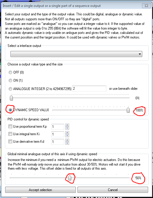

    Dynamic speed : Solved ? (06/03/2012)
    A simplier solution may exist with the dynamic speed of X-SIM profiler. I suppose this will represent an other possibility instead of configuring 2 speeds in the analog interger mode of X-SIM profiler. But I did not suceed to configure a profile until now.
    If someone manages to find a solution with a dynamic speed, I would be really grateful to use it.
    Other projects are based on a dynamic speed, but there are not using Sabertooth board.
    06/03/2012 : A Dynamic speed solution has been found (I hope it works, because I can't test at the moment)
    Look a this solution, proposed by Libory (thanks to him).

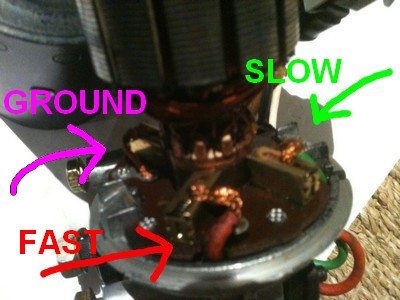

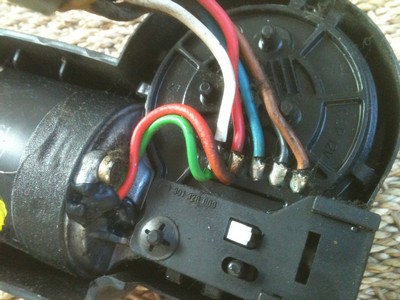

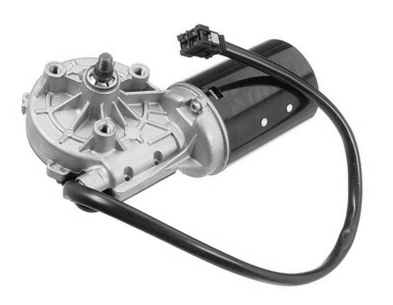

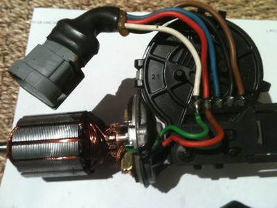

    Prepare the WIPER MOTORS :
    I would like to thanks Riton, Bigtalltim, Frakk and Mahaow for their helps. Indeed, I though it was easy but it is not so easy as I expected.
    Here is a wiper motor of 12V (from a CLIO), bought 20€ in a scrap-yard :
    There are many cables and I was surprised to discover this rainbow of colors. In fact, there is only 1 cable interesting for us : the RED one. Usually, the RED cable concerns the fast speed, and the GREEN cable concerns the slow speed of the wiper motor. We will let the GREEN cable apart.
    We need also to isolate the GROUND. For this, we must remove the wiper motor to look inside.
    We will use the RED cable (fast speed). But we have to cut the other cable (GROUND) to remove it from the body of the wiper motor and to pull it outside of the body. A BLACK cable would be a nice color to use for it because it corresponds to the GROUND. In this way, we obtain a 2d cable (GROUND).
    When the wiper motor is prepared, You can test the direction of the wiper motor. Here is an example with fast speed of the wiper (RED cable):
    + connected to RED and - connected to the GROUND will move in one direction.
    - connected to RED and + connected to the GROUND will move in the other direction.
    A video to show the result :
    The motor is able to turn on both side : clockwise and counter-clockwise. The speed can be controlled : variable speed. K8055 is connected to the Sabertooth. The Sabertooth is powered by a PSU (12V molex). Everything is controlled by the software Velleman.
    http://www.youtube.com/watch?v=dbhPugbAYJ0

    My own tests have revealed :
    - When the wiper motor is NOT connected, I can pick-up +10,7V and -11,7V output voltage from the Sabertooth (no load).
    - When the Wiper motor is connected, I can pick-up +9,8V and -10,9V output voltage from the Sabertooth (full speed in both directions).
    http://www.youtube.com/watch?v=TFfPkJyXJLs
    The voltages were lower until I discover that the 5V from the output DAC1 / K8055 was only 4,4V at its maximum. My K8055 is now supplied by the PSU, and the DAC1 output reaches 4,6V, still under the 5V that I expected but better than the initial 4,4V.
    I have realised a test and pick-up Voltage output from the Sabertooth, compared to the % of the Interface Setting menu of X-SIM :
    The middle (0V) was exactly obtained with 55% (it does not appear on the graph).
    Last test with a wiper motor and Velleman Software :
