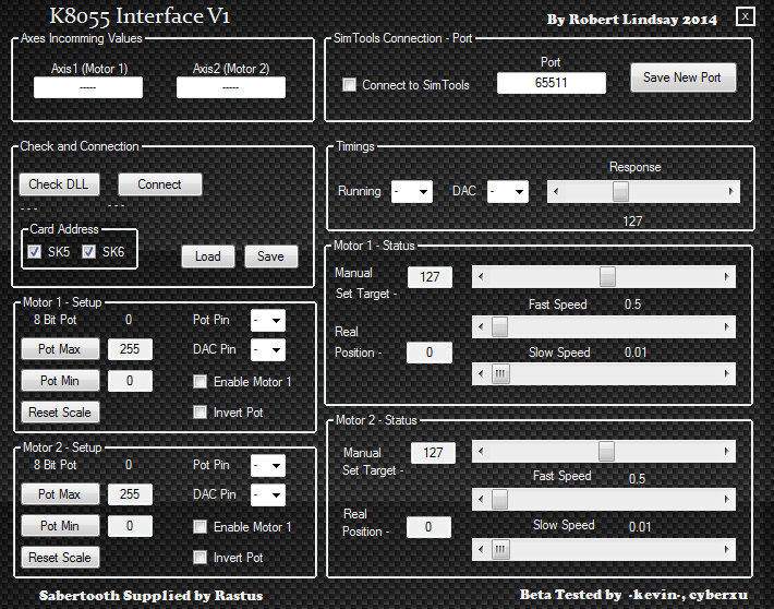

K8055 Interface V1 - 2 DOF Original EXE 2016
K8055 Interface 2DOF

    Yes it's ok now ! Thank you very much for help, now my k8055 working perfectly !!!
    I will post later my progress . when i will have more time to play on it .
  8. eaorobbie
    20,471Coins
    +1,686 / 23 / -2
    Thanks , new app is coming along a little slower but think I better put it away for now and build some instructions for newbies to follow.
    There is a lot going on , on one page, can be a little confusing , hence Im building a more user friendly app, first one is to prove it can be done, without the need for an Arduino. Let the K8055 live long.

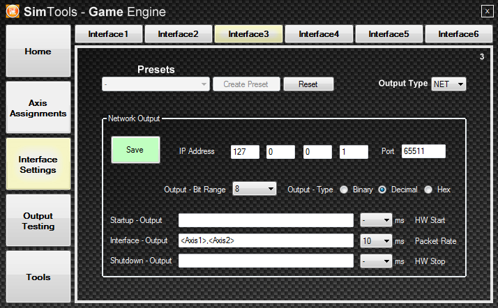

    grazie ma ho gia visto quella pagina, appena apro il setup "impossibile avviare l'applicazione, contattare il fornitore dell'applicazione"
  15. noorbeast
    21,592
    151,215Coins
    Google translate -
    thanks but I've already seen that page, as soon as I open the setup " impossible to start the application , contact the application vendor "
    Is this on a 64bit machine and if so have you followed the earlier thread advice?
