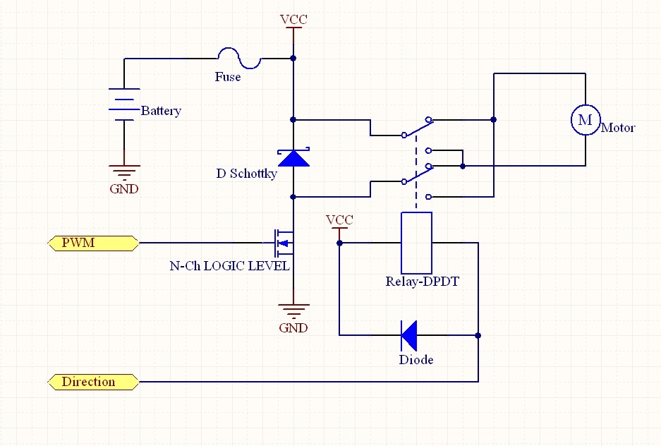

    Easy enough Fred - there are only 6 components in the relay board, and 2 of them are the same thing! :D
    I used the following for each relay circuit:
    1 x DPDT relay (Maplin code N08AW) 12V, 10Amp if i remember correctly
    1 x Relay Socket (Maplin code N32AW)
    1 x 1K resistor
    2 x power rectifier diodes
    1 x NPN Transistor
    I later added heat sinks to the transistors, and mounted a fan over them... other than that, thats it!
    On the diodes and transistors, I am reluctant to advise my components as the ones to use, because they were selected purely on the basis of what I had available, and I have not yet got round to reselecting these components!
    :blush:
    Have a look in the stocklist of your supplier, and select something more suitable based on what is available... There are so many components in the world, and not all will be available to you - see what you can get your hands on first.
    By all means post the specs of components that you are looking at and I'm sure someone more knowledgable than me would be able to say whether or not they would do the job... I'll have a look too... I'm not an electronics guru, but there is one around these parts! ;)
    On that point actually, Frakk has offered an alternative circuit quite early on in the thread using Mosfets... I havent yet been able to get hold of suitable components - maybe you could try the upgraded version he suggests... It would be interested to see how it performs!
    Here is his alternative circuit:
    Tim

    Now I will order parts to make this driver, first checking if I can use some parts I alredy have. At least the waiting-time for parts can be used to shorten that list (exept it has a tendency growing as fast a its been shortened :uups: )
    If I make this work with amc it will be a cheap solution! Might try also with mosfet, anyone think the mosfets from the dSMHB will work (irlz44 or irlz34)? or even the transistors? (bc546) They are NPN.The dSMHB have general purpose diodes, you are using power diodes, so I guess I need to order them.
    Is 10amp enough on the relays? On my anmeter the vipermotors spike shortly up to 30 amp once they are started (stable around 5)
    Is there a lower risk burning mosfet (or transistor) in this driver than the h-bridge? in that case, is it because switching direction is a critical part ? (Alredy have a fan ready from my dSMHB)
    Fred

    The 10 Amp rating is for a continuous value with acceptable spikes - the wipers themselves are recommended for a 10Amp fuse, so I figured it would be ok for now!
    When I eventually connect a car battery rather than the PC power supply I will be including 10Amp spade fuses in the build to protect the circuits

    Small question in my lunch-brake: Is Solid state relays also an alternative in this driver? (more exspensiv, longer life and silent) Like this one http://www.futurlec.com/Relays/SSRDC100V40A.shtml well...they might switch only one direction!? :blush:
  9. Frakk
    Frakk Active Member
    Apr 15, 2009
    1,144
    328Coins
    You can use solid state relays, but you have to make sure the electrical operation is the same as a DPDT (2circuits/2position)switch to route current properly in 2 directions. You can alternatively use 2x SPDT relays.
    The one you posted is equivalent to a SPST (1circuit/on-off) switch. You can parallel 2x SPST with one's input inverted to get a SPDT.
    If one goes that route, it makes more sense to get 4 MOSFETs instead of 4 relays. But then it would make more sense to just go with a proper H-Bridge! :D

    So here is the part-list I think about ordering to try this.
    2x 2N2102 - NPN General Purpose Amplifier
    http://www.futurlec.com/Transistors/2N2102.shtml
    2x GR12V10ABL - DPDT 12VDC 10A Blade Terminals Relay
    http://www.futurlec.com/Relays/GR12V10ABL.shtml
    2x GRBLADE - Socket for Blade Terminals DPDT (10A)
    http://www.futurlec.com/Relays/GRBLADE.shtml
    4x BYW29 - BYW29 16A Fast Recovery Rectifier Diode
    http://www.futurlec.com/Diodes/BYW29pr.shtml
    A protoboard
    I have resistors, and if the mosfet from dSMHB is suitable I might try with them also. And Frakk... I see there is mosfets in the solid state relays but i was not planning to develop a new mosfet h-bridge (bad idea :lol: )
    Happy for confirmation on my part list. This will cost me less than 20 usd incl shipping, so its worth the try!
    Regards Fred
  11. Frakk
    Frakk Active Member
    Apr 15, 2009
    1,144
    328Coins
    Those transistors are rated for 1A, I hope you realize. :) If you don't want to use MOSFETs, you should get a 10A NPN.
    IMO, it is easier to go with the FETs since you already have them, and worst comes to worse, you can order the regular BJTs too.
    MOSFETs are not that evil, trust me. :D
    The blade socket has screw terminals as I see, it will be easy to mount too. I would go with the DIP relays to save, but thats because I have no problem soldering.

    Thanks again Adam, there was a reason i posted that list! :yes:
    So the IRLZ44N mosfets I alredy have for my sDMHB is suitable to use in the diagram you posted then!? I am not afraid of soldering, after all I managed to solder amc with sucess, and I only use a ordinary solder rod. (not solderstation with temp. controll) I did not find dip relays with 10amp at futurlec, but will look elswhere also. If transistor: http://www.futurlec.com/Transistors/2N5881.shtml getting closer?

    Yes, the IRLZ44N is going to work good. It is logic level, so the 5V signal from the AMC should operate it nicely.
    The 2N5881 is good, just be careful cooling the case, it is connected to the collector and will have some voltage on it.
    I would get this: http://www.futurlec.com/Relays/JQX-115F-12.shtml
    Similar in characteristics to the blade type, 8A isn't that much different than 10A. The short spikes will go well above 10A anyways, the average current will be much lower than that. You can connect them in parallel too, but that might need the direction signal to be amplified with a small NPN transistor.

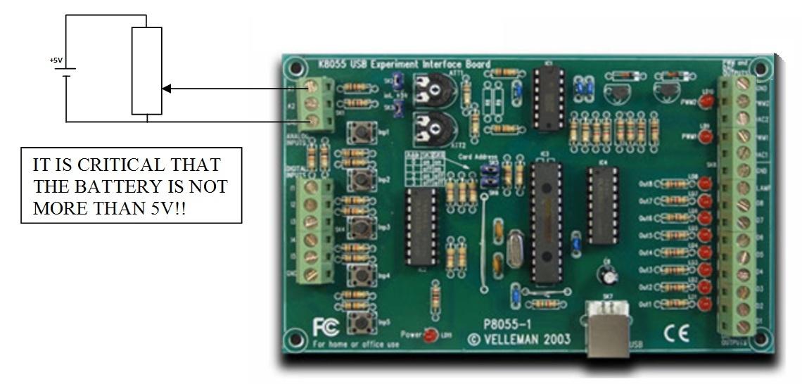

    Re: Connecting Position Indicating Pots to K8055...
    It's not too bad I suppose Historiker - at least I get another hour each way to play with designs and read the forum! :D
    Some advice for anyone using the inputs on a K8055 as per the connection diagram below:
    I have found 10K linear pots to be much more reliable and less jittery than 100K linear pots.
    Here is a video of my latest test, showing the PID control available by using a 10K pot connected as the diagram above:
    http://www.youtube.com/watch?v=if0nzgkNcgk
    A question to anyone that uses Thanos setup - how does the performance here compare? (I have no other setup to compare it against... yet)
    Tim

    Seem to me that there is a small delay but you also said you do not have full effect on the motors yet. It will take some weeks before I have parts to build this driver and test it with amc, and it will be interesting to compare, both different controllers and different versions of this driver (transistor and mosfet) And if there is a delay, is it in controller or driver?
    btw. In your list you wrote power rectifier diodes, and Frakks diagram says schottky diode. I ordered both, and they are all rated for more than 12v.
