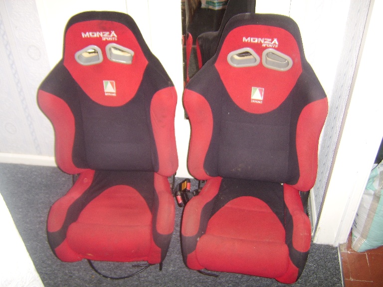

    today was a good day...
    I've just been to a car boot sale near to me in belfast and picked up a bit of a bargain...
    2 old rally car bucket seats for £30 for the pair!
    A little battered, but perfectly functional...
    now I just need to find time to redesign the frame!... lol - will this build never end?!?! :D
    Tim

  6. bigtalltim
    bigtalltim New Member
    Sep 10, 2010
    189
    Belfast
    361Coins
    :lol: - aint that the truth!! I can't imagine a time when I'm not tweaking one detail or another...
    Pretty much every time I have been happy with something, new parts/equipment that is better than the old stuff arrives, and more than once the whole build has gone back to basics!
    For instance, the VW seat I was using has proved to be too flat for the pneumatic rig... with extremes of position, you just slide off!... now these buckets arrive, and its total rebuild again!! (though I needed to reduce the centre of gravity anyway).
    Should hopefully get some work done on it during my Paternity leave at some point in the next few weeks and again over the Christmas holidays ;o)
    Tim
