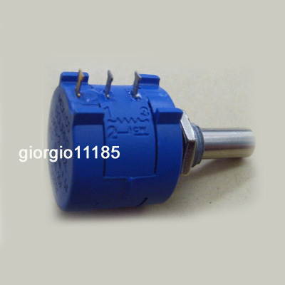

    Multiturn pot - superb performance with K8055
    Hi to all!
    As promised earlier in the thread:
    I have now extensively tested, and can confirm that I am completely happy with the following 10Kx10Turn multiturn pot which is freely available from ebay (though you may have to get it posted from Hong Kong, which takes a bit of time!)
    I got 5 for £21.99 (makes them about €5 each) and they are worth every penny :thbup:
    They give a superbly smooth track of resistance into X-Sim via the K8055 - no jitter whatsoever, which makes for rock steady position control
    As you can see from the diagram (which shows the side of the pot) legs 1 and 3 are for +5V and 0V, with leg 2 picking up the variable signal...
    ... weirdly enough, the numbering order of the legs as shown in the diagram above (and this is confirmed by the datasheet)
    is 2, 1, 3 - remember that when wiring it up, or it just won't work!! 2 is the back leg. ;)

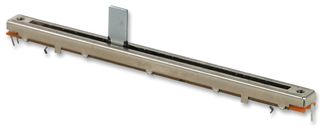

    A couple more offerings found whilst on the search for hardware:
    100mm 10K Ohm slider potentiometer:
    The slider is as smooth as silk, and gives an excellent trace into the K8055 (£4-£5ish)
    Go to http://www.farnell.com , click on your country, and search for 100mm 10K

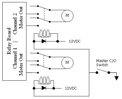

    However, I'm encountering one stumbling block:
    Given the way the K8055 PWM output interacts with the relay board, as soon as you connect power to the board, the motor starts running.
    As part of the Force-Profiler setup, there is an option to calibrate the system.
    This involves connecting everything up: Computer -> K8055 -> Relay Board -> Drive Motor.
    As soon as you connect power to the relay board the motor spins and the frame moves to the limits.
    I 'm sure that this same behavior will happen when in game play mode. I'd feel much more comfortable if the drive motors did not receive power (and move) unless a specific signal was sent from Force-Sender.
    Have you encountered this, and if so, how are you dealing with it.
    As it is, I can only think to install a cut-off switch (removing power to the relay board) that will be in cut-off mode until I begin game play.
    By the way - is seems that frequently at night, the x-sim website is down (at least for me here in the States). Are you seeing a similar behavior? For example, it was not accessible last night from 0200-12:00 GMT (approximately).

    Yes - this is because the PWM output of the K8055 is active low... to find out what this means, check out the K8055 manual, or Page8, Post10 of this thread for the relevant extract.
    This is only a problem if you apply power without control... NEVER a good idea!!...
    ...or if you lose control (software crash) and this is why you need breaker switches with recovery diodes on you extremes of position
    (OR a design that accommodates the over-run)
    See Page6 Post4 for a video examining my early design, where this is taken into consideration and the over-run solution discussed.
    For breaker switches at the extremes of position which act to stop the motors at maximum, and can be reversed when the setup is ready, See Page18, Post5 for explanation, and Page18, Post7 for video explaining how this works.
    As before - never a good idea to apply power without control... I guess all you have to do is break the 12V power to the board/motors with a switch that you dont throw until everything else is ready...
    ... also, breaker switches just in case ;)
    Yes indeed - solutions as referenced above.
    Remember also that it is very important to set your profile so that stop means that the pwm output is set to 100%
    Keep going - from the sound of it, you're nearly there!

    OK - that all make sense.
    I do have cutout switches installed at the max point of movement along with recovery diodes so I'm good there
    I'll work on installing a power shutoff switch between the the relay outputs and the motors.
    Thanks again.

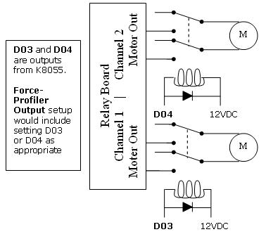

    Tim,
    I was thinking about adding another relay, but have the K8055 control it's operation:
    This would ensure power is only sent to the motors if the K8055 is allowing it...
    What do you think?
    Thanks, Kevin

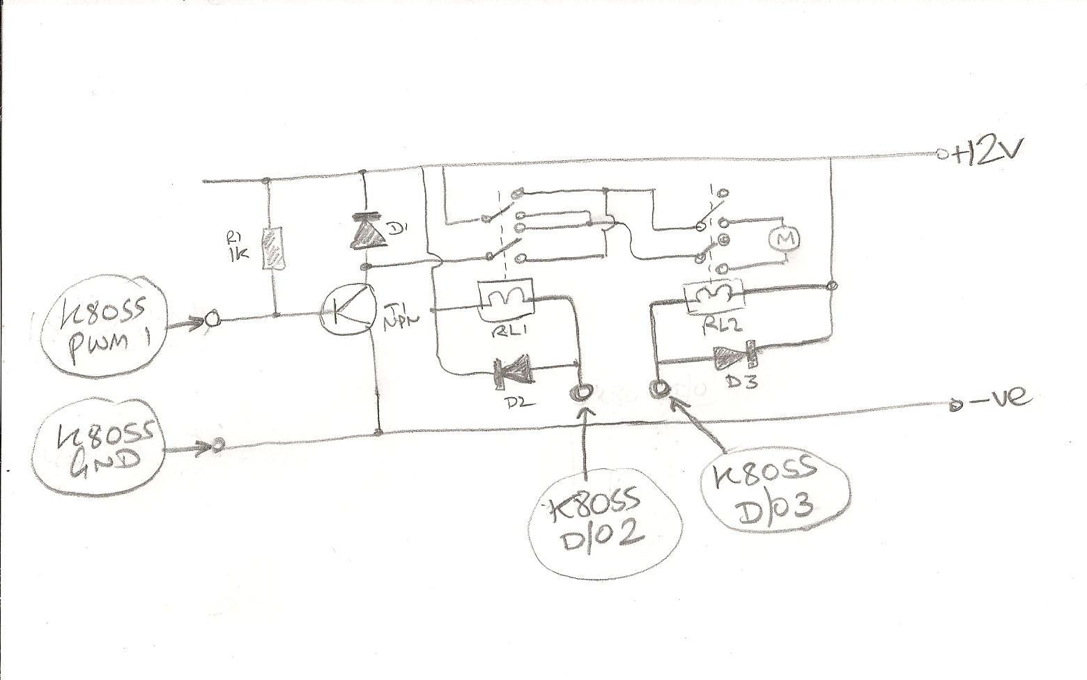

    Hi Kevin - nice thinking... I reckon it could look like this for one motor (just double it up for 2DOF):
    (Apologies for the hand drawn circuit - I am working on my pneumatic setup tonight so dont have time to do a digital version ;) )
    but (and here come the downers...) though it is an excellent solution, it only solves one issue... that of the motor spinning up before control is established. If the board crashes with the new digital output on, you will still have the same problem as before
    I still think isolating the motor/power supply is the easiest and by far the cheapest solution.
    Also, the extra relay/relays double the cost as the relay is the most expensive component (still pretty cheap though!), and unless you are using solid state relays (even more expensive) the clicking would drive you mad - 4 relays going for it would be quite some noise!
    Tim

    Those are definitely valid issues.
    I'll still go with the relays (I can afford them if I get them via EBay for $5 US each) but I'll use a master cutoff switch to activate them.
    That way I get the digital outputs back for other uses.
