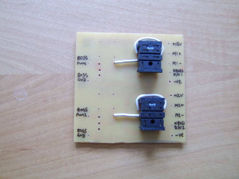

    For all those who have asked about the Velleman K8055 and it's use for wiper motor control...
    Here's how I have done it ;)
    This setup allows variable speed through the use of Pulse Width Modulation (PWM) and bi directional motor control of two windscreen wiper motors. Other solutions I have seen (including the basic preloaded profile in X-sim for the K8055) do not use PWM, and have to have complicated pulsing routines built in to slow and change direction...
    This is way simpler than all that!
    Also, this uses relays so there is practically no power loss to heat unlike MOSFET H-bridge alternatives.
    Better than any other single benefit, this setup is cheap - super cheap!
    The complete double wiper setup shown in the video has cost me no more than £75...
    I costed the components for Tronics AMC alone at about £73 locally to me, and then you have to buy the hbridge bits... and then the motors...
    Way too much for me to spend right now! - besides... I already had a K8055 :D
    Below is a list of my spend so far:
    Velleman K8055 prebuilt £30
    Wiper motor from ebay - £14 no postage
    wiper motor from ebay - £12 + £6 postage
    DPDT relay £4.99 each (x2)
    Relay Socket £1.69 each (x2)
    1K resistors £0.14 each (x2)
    4 diodes (from a lucky bag... about £0.10 each)
    2 NPN Transistors (from a lucky bag... about £0.15 each)
    PCB sheet £1.54
    I already had some bits lying around (so there was no cost unique to this project):
    Power supply from an old dead PC
    Etching fluid
    Solder
    USB Lead for K8055
    Old wires to connect it all together
    PC Fan to cool - not required for test, but may be needed for the transistors under full load
    Connectors to hard wire into the board to connect to power supply
    2 Junction blocks to make connecting the wiper motors easier

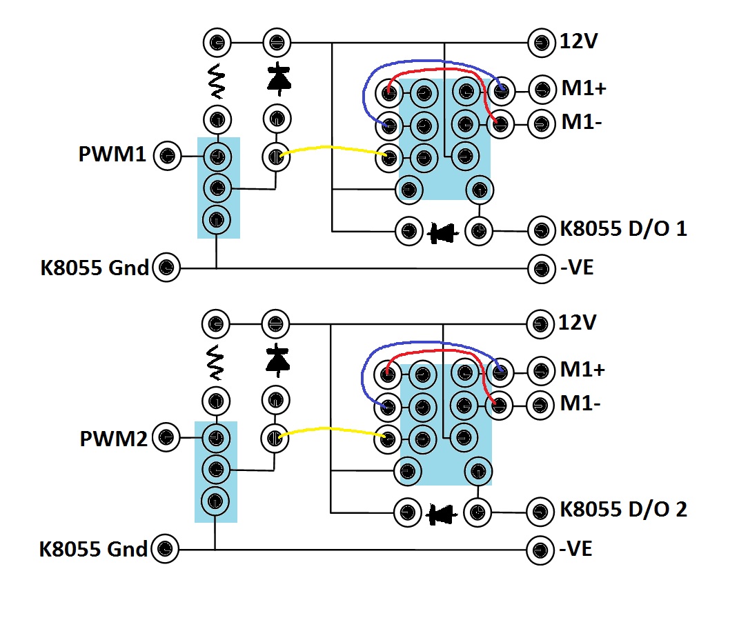

    The circuit solution I found in the velleman forum:
    all credit to paledin micro for the circuit design
    From this circuit, I designed my own PCB to use cheap locally available relay parts.
    The circuit is simple and takes little time to make - even for an inexperienced PCB maker like me!
    To use other relays the design may need to change, but if anyone is interested, and I will draw it up and scan it in - I'm afraid the photos I have aren't great (as you can see here! :D)

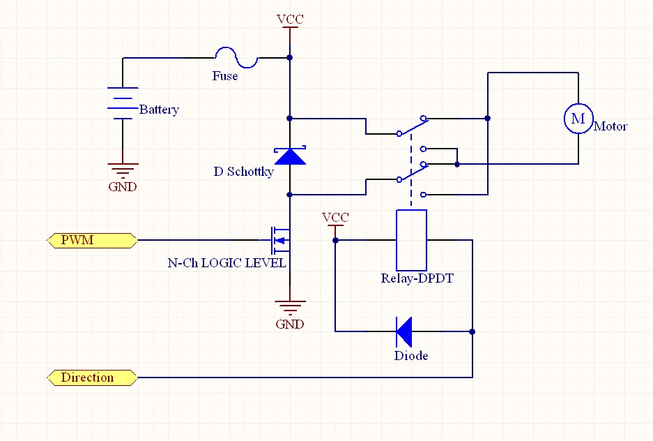

    Here is a diagram if you want to try it with MOSFETS:
    Make sure to use LOGIC LEVEL ones if the PWM voltage from the K8055 is ~5V.
    Current rating should suit the motors, about 15A continuous should be good for those wipers. Don't forget heetsinks. :)

  13. Frakk
    Frakk Active Member
    Apr 15, 2009
    1,144
    328Coins
    Depends on what components you are using.
    Relays can usually carry a lot of current! The bottle neck is the PWM MOSFET and the recirculating diode (if used).
    It will be cheaper to buy 1 MOSFET than 4, so you can go even larger on it.
    You can get more current out of this bridge for the same money and much simpler build. It is more reliable IMO, even though the relay contacts will wear out over time.
    The disadvantage of the relays in performance: You cannot change the motor's direction as fast, and you hear the clicking when it does.
    This could be a good thing too, to protect from high spike currents when they are quickly reversed.

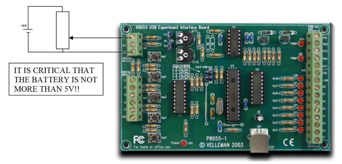

    The position feedback pots go onto the 2 analog input channels on the K8055 - just like JimNZs flight sim.
    Just as Frakk says, the position processing will be software... so the AMC will still have the edge! ;)

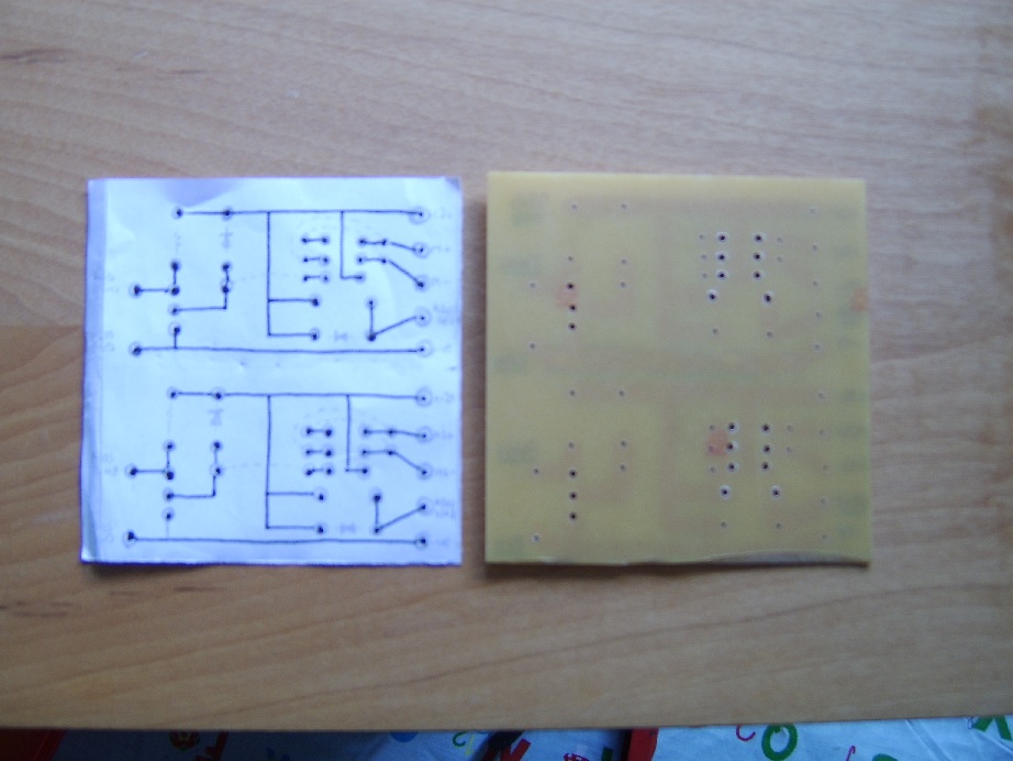

    Couple of images for anyone interested:
    As Frakk says, this could be made on pretty much any experiment board... now I didn't think of that, and chose to make a PCB... :blush:
    ...but thats ok, cos I'm gonna say that it was so I could make the tracks extra big to take the current! 8)
    In case you want to try a pcb (or use the same relays) this may help... My layout for the double board was as follows:
    My layout is designed around a DPDT relay from Maplin. Their code is N08AW. The relay has spade connectors, and fits into a socket - this makes it easy to change when you go past 10 million or so operations and the contacts wear out!
    NOTE - the max number of operations is stated by the manufacturer as only 100,000 at full load, but as the motor is stopped when it changes with my setup, it never gets changed at full load! - 10 million it is!!
    BUT I guess that is something to take into account if using this relay bridge with Tronics or any other controller
    The relay goes into socket N32AW, which is soldered onto the PCB.
    It could probably be layed out better, but not by me... :blush: ...so I had to use bridging wires to complete the circuit
    (these are shown in colour on the circuit layout picture).
    BigTallTim relay pcb.jpg (if you look carefuly there are 3 wires, though 2 of them are one on top of the other so it looks like only 1 around the relay socket...)
    Now the Power.

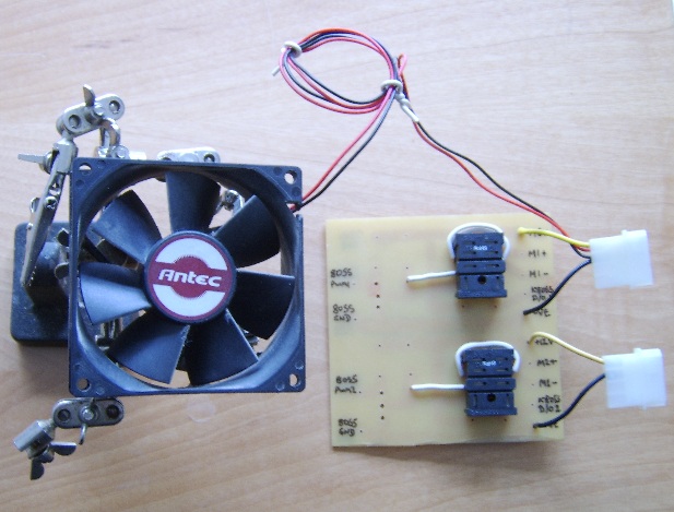

    I used connectors from old PC expansion cables (the ones that allow you to power additional drives).
    I did this to benefit from the fact that the power sockets in a PC power supply give you both 12V and 5V - both of which I need in this set up. (Yellow is +12, Red is +5V, Black =Gnd) and also that they often have fans wired in already!
    The 5V wires on the other connector (they are not shown in this picture, but will be included later when I have the frame built) are used to power the two position indicating pots on the K8055 analogue inputs.
    Using a PC power supply seems to work fine - I may decide that it needs more power when I have the frame finished and can test it under load, but for now I like the convenience of getting two voltages out of one unit, and both motors seem to be running nice and fast.

    Connecting Position Indicating Pots to K8055...
    Nearly done now - just the top of the frame to finish! :happy:
    Here is a critical piece of information for anyone wanting to try this build
    I have recorded this as a video because it involves changing a few settings in hardware...
    ...much easier to show you instead of try to describe it!! ;)
    http://www.youtube.com/watch?v=gamF95vtads
    The layout to connect pots to the analogue input is as follows:
    Tim 8)
