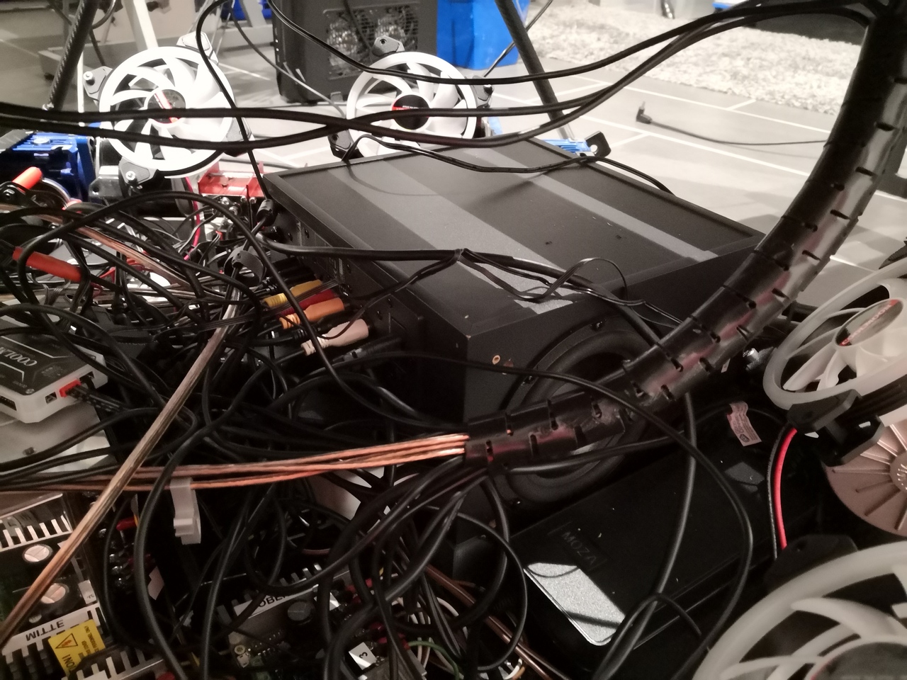

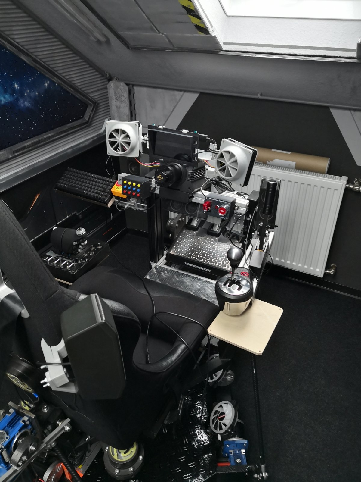

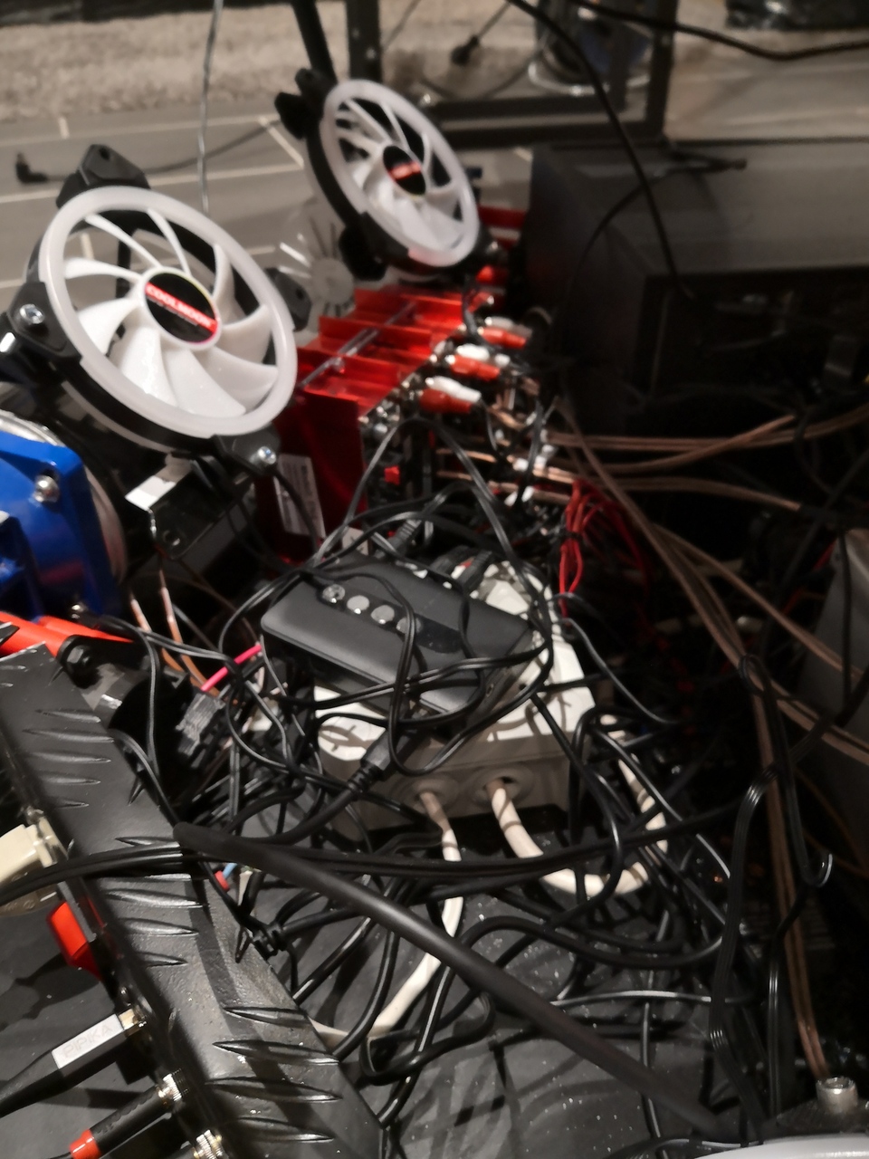

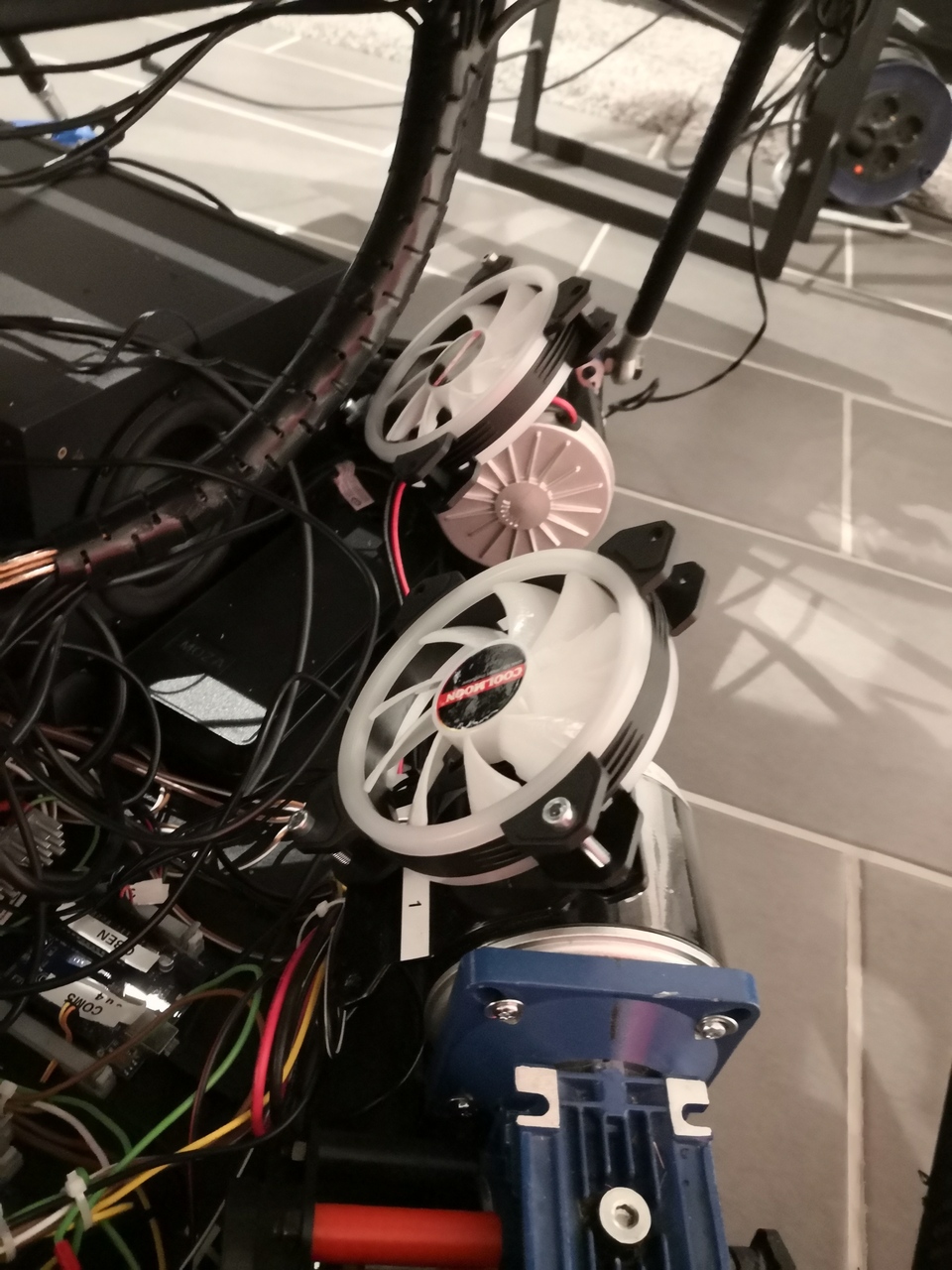

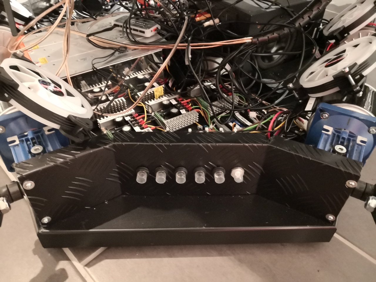

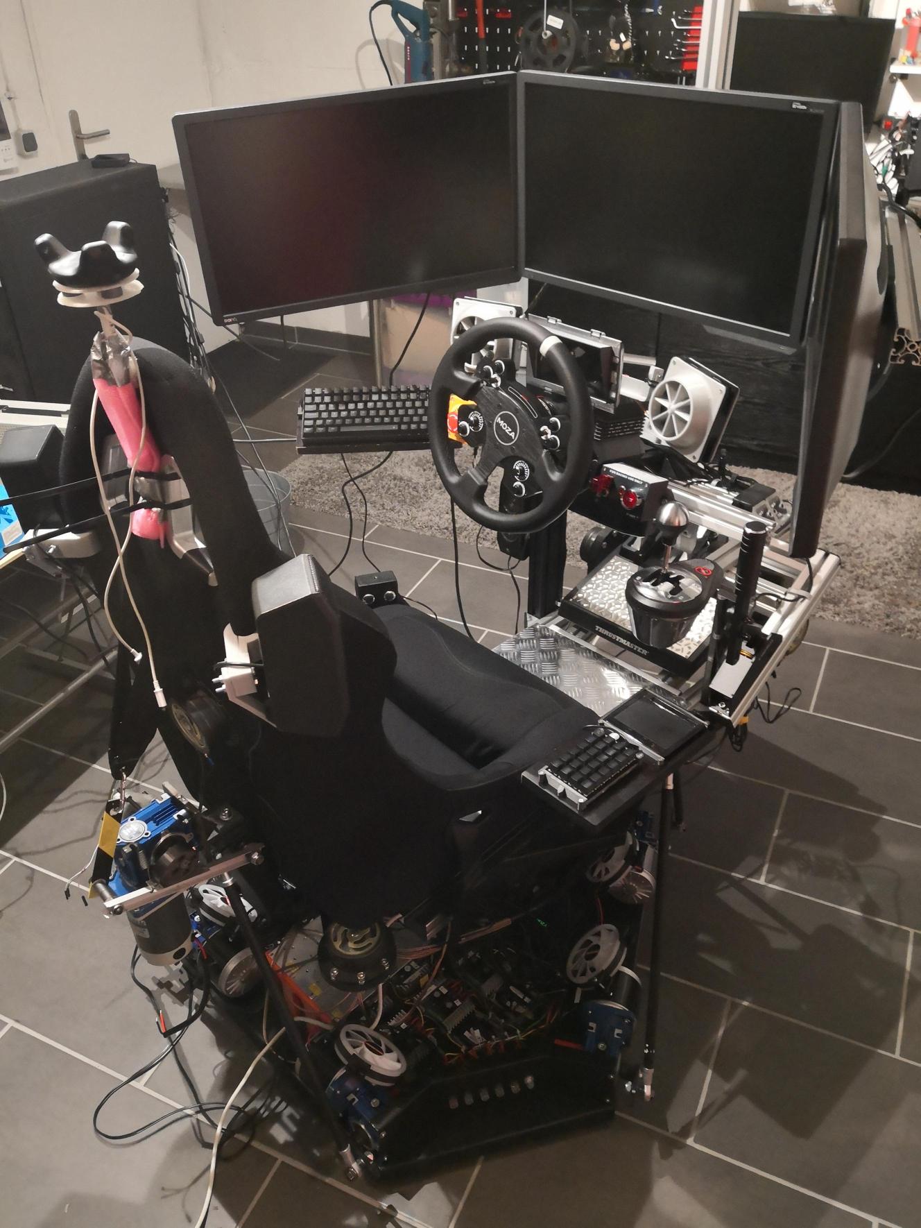

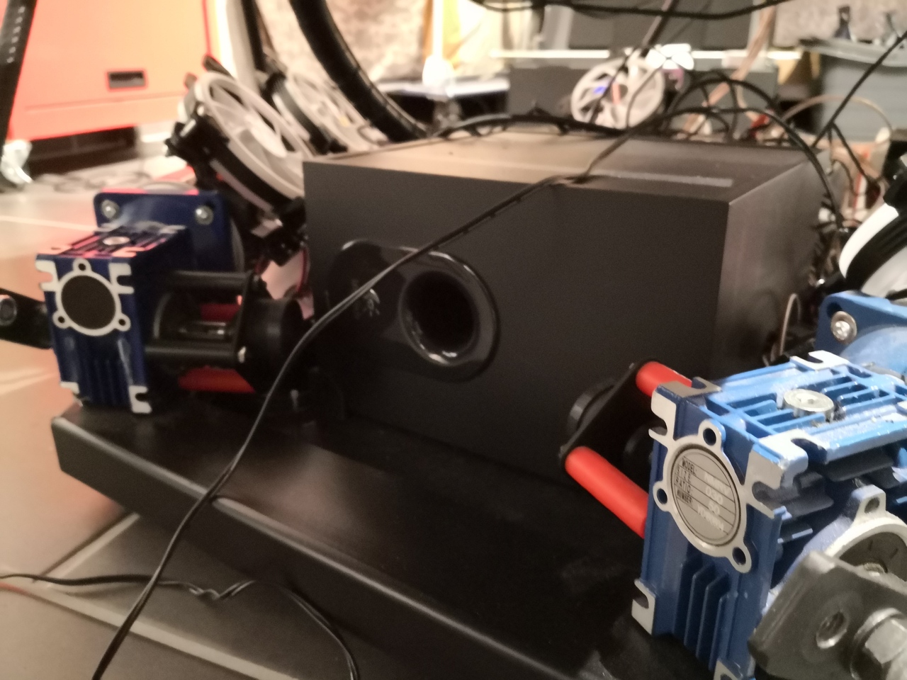

    so just a few more Pictures, i need to do some cable Management for all the USB and sound Cables ;DDDDD

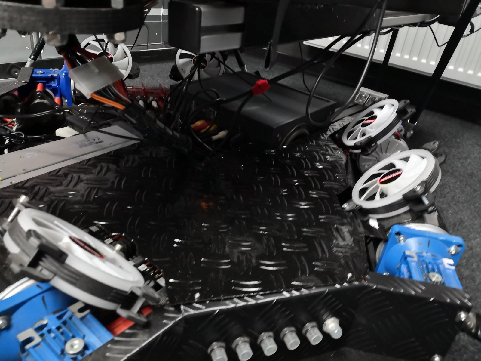

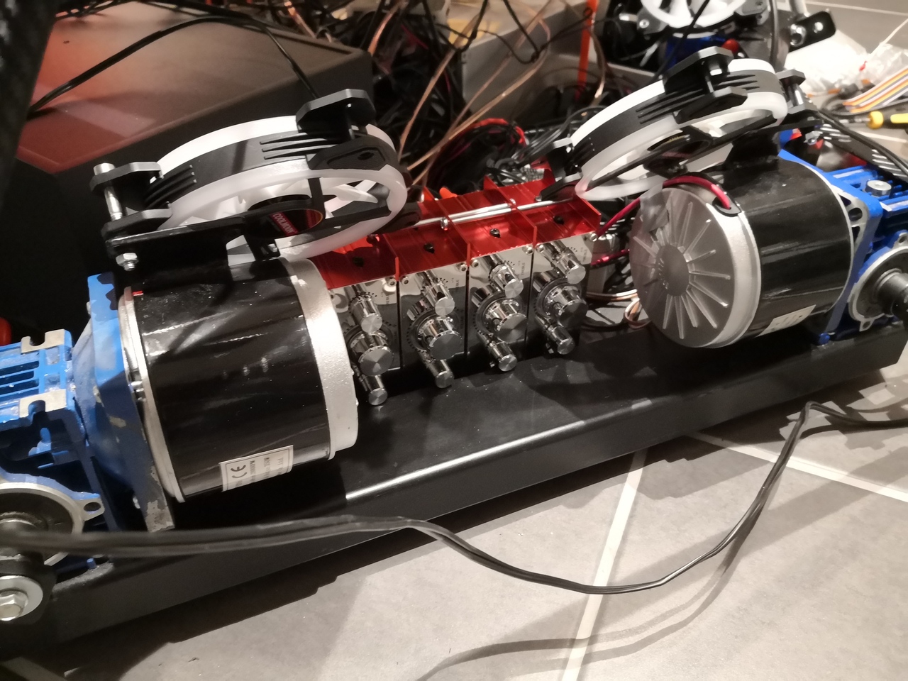

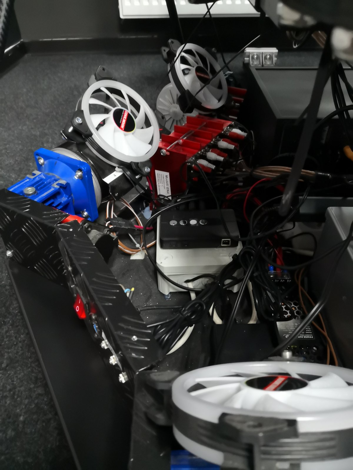

    soooo, there are one Push Fuse per Motor
    for cooling i use just a cheap ARGB Fan set from Coolmoon (ebay, amazon, ali express)
    because the front and side motors getting a bit hot because of the front heavy rig, but with the coolers everything works well !
    Sound System, Subwoofer integrated in the Base is a Logitex X 540 from ebay (30 euros :-D )
    2 active USB 3.0 Hubs one in the Base and one in the upper rig.

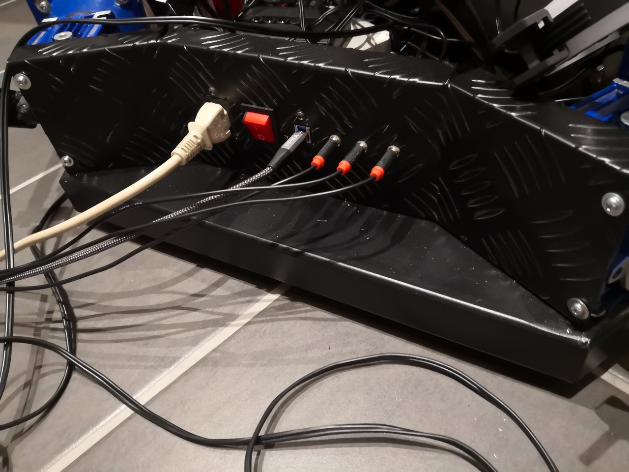

    Just one central Plug Panel for Power, USB and 3 Channels Audio for the X540 !!!
    For the Bass Shakers i use a CSL 7.1 USB Soundcard, i dont want to wire ever channel to a second PC card !
    Works very well !
    Sound card is wired up to 4 cheap Amps (the red ones - from amazon) i got 7 rockwood bass shakers

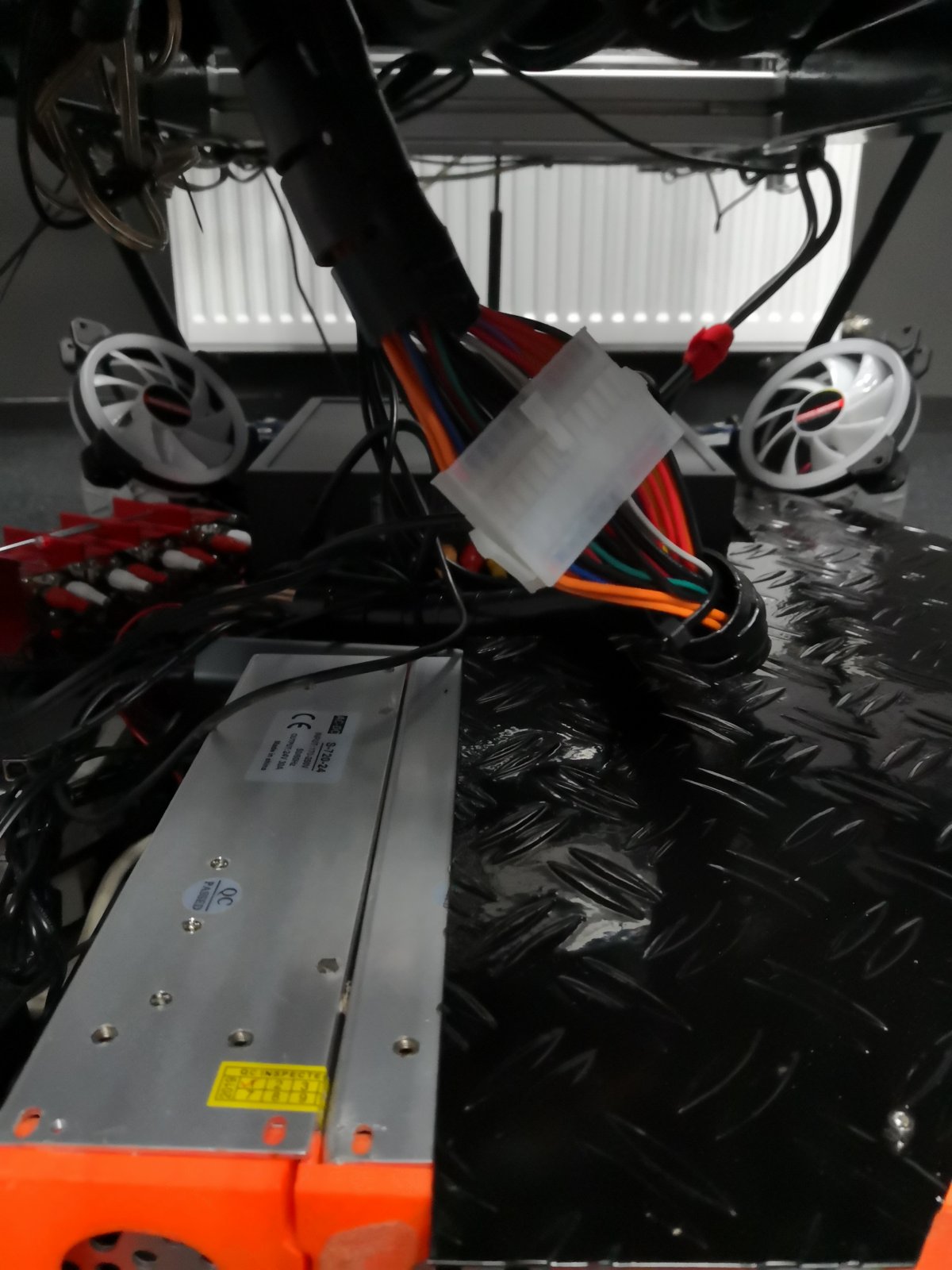

    PSU for the motors in the Back of the base 3x 720 Watts
    1 additional 70 Watt 12 Volt PSU for the 12 Volt Stuff (wind Simulator, Cooling Fans and the Emergency stop Button)
    in the electric box there is a relais for the emergency Stop fo the Motion Motors (Eltako ER12-200UC - which needs an electrical signal - in this case 12V to close the 230volt - if the signal is cut the 230volt will also be cut)

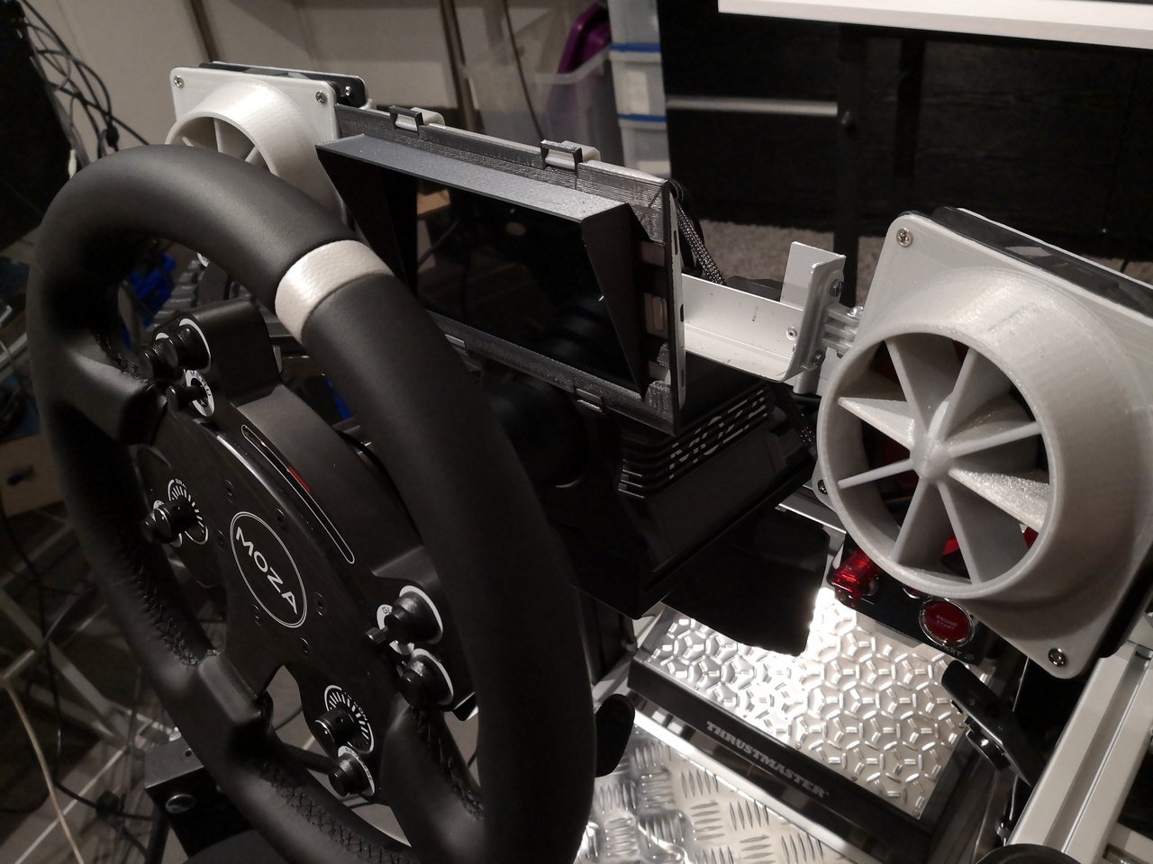

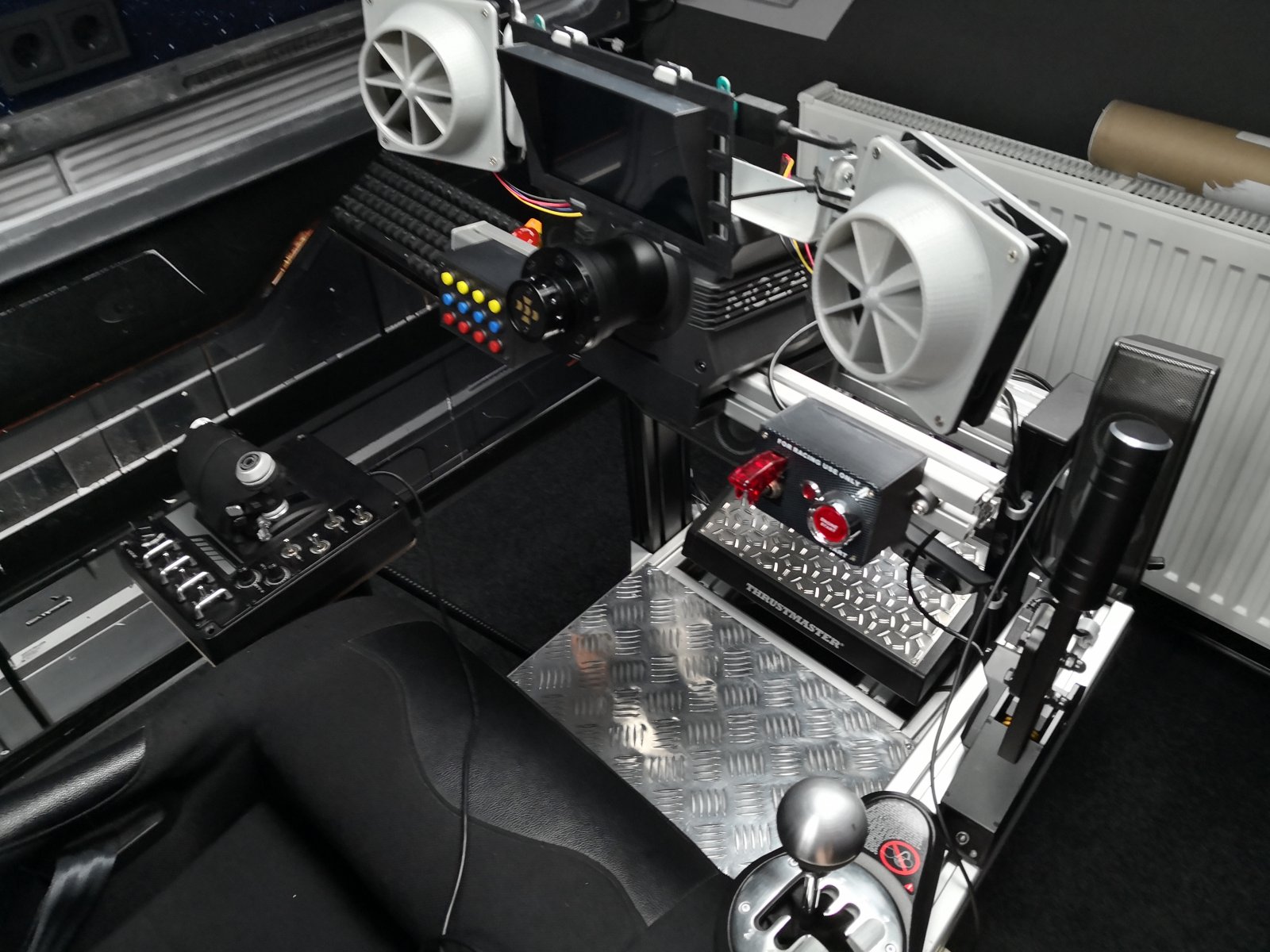

    Wind Simulator is an Arduino with relais which is driven by Simhub

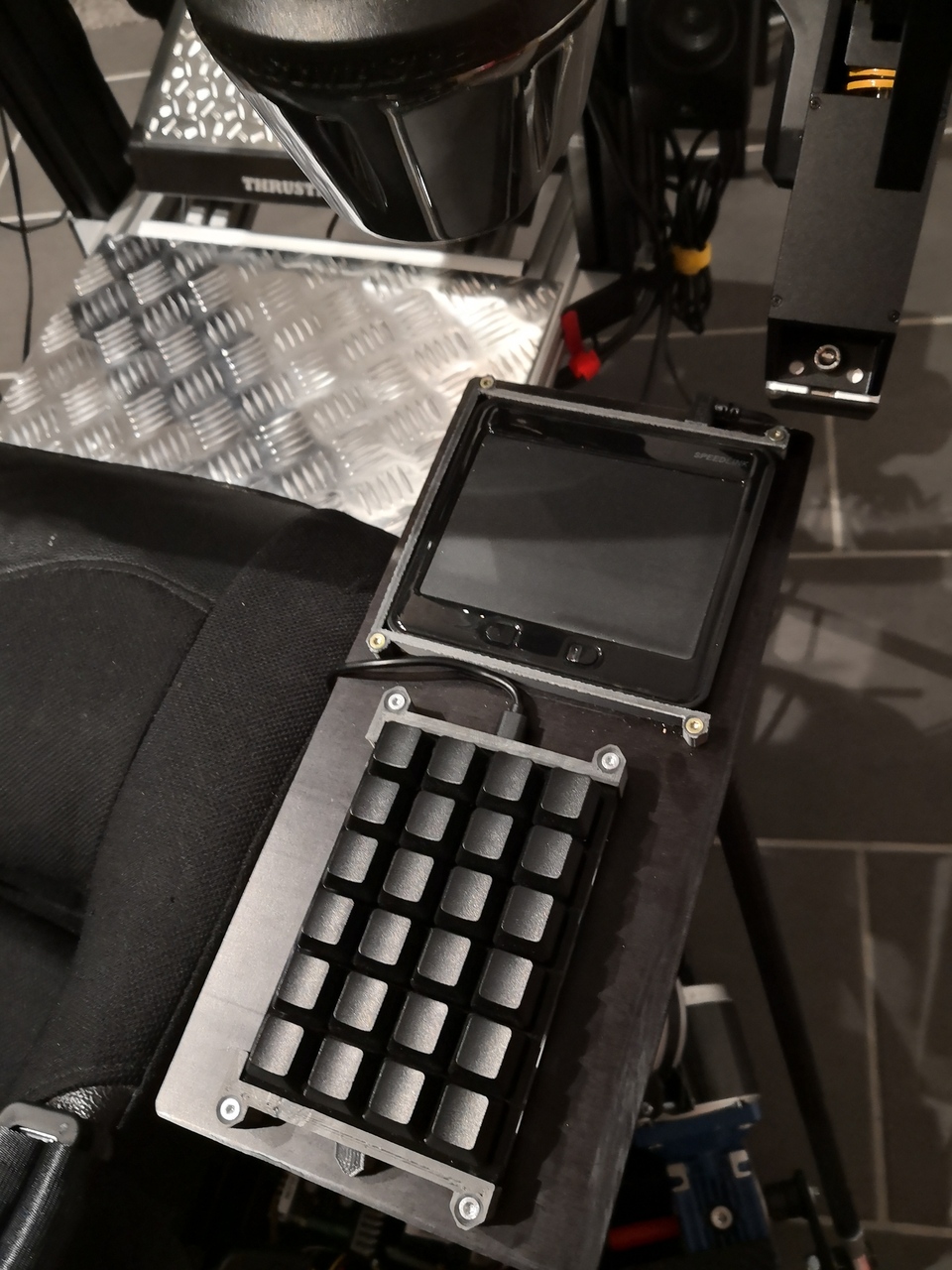

    Dash is an old Samsung 7 Inch Tablet which is useless for other Task these days ;D Dash via Simhub.

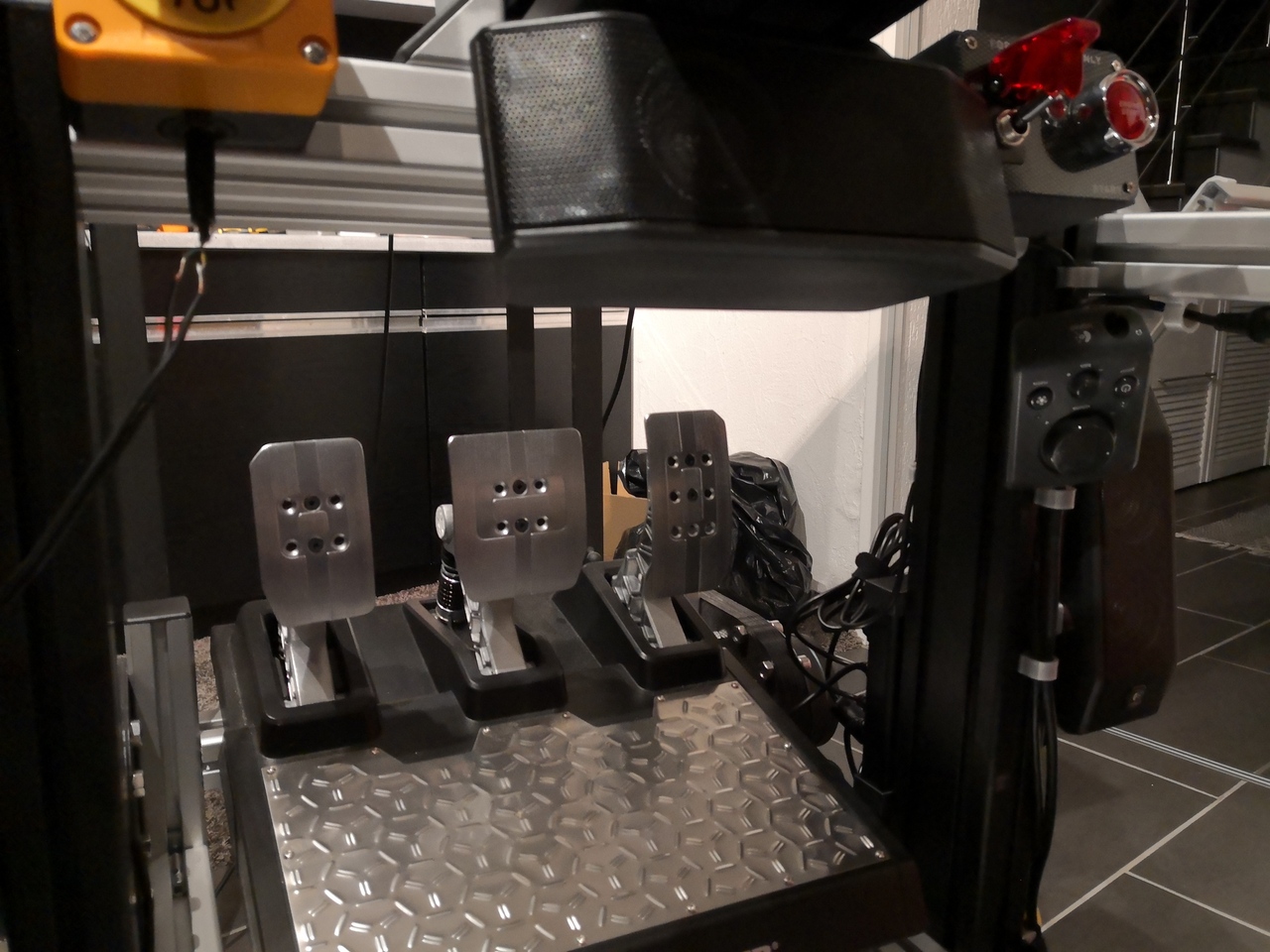

    There is a Touchpad and underneath a mechincal 4x6 keypad from aliexpress which can be remapped in any way you want.

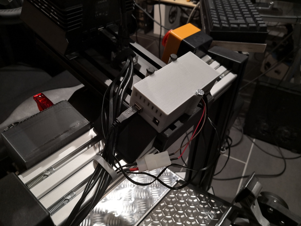

    the ignition Box is also arduino based with a racingcar button plate from ebay/amazon/ali express

    next step:
    -do cable management
    -make a hood for the electronics in the base
    -fine tuning in the Software
    -find a solution for the bad working vive Tracker for motion compensation

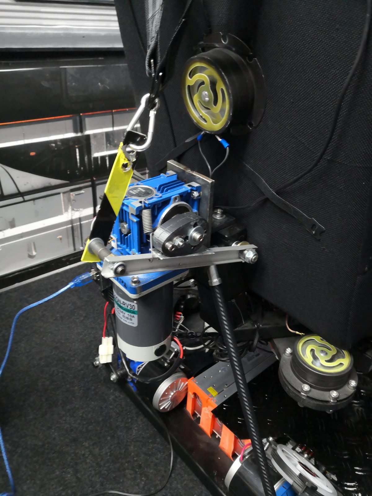

    Small Update:
    triple Screen bolted to the ceiling ;D just small 24 inch 144Hz Monitors, maybe later update to something curved ... main purpose for the rig is "VR" !
    Belt Tentioner in the Back with one of the previous 120Watt Motors - Doubled Surge Channel with "mechanical"cancelation of Belt loosening

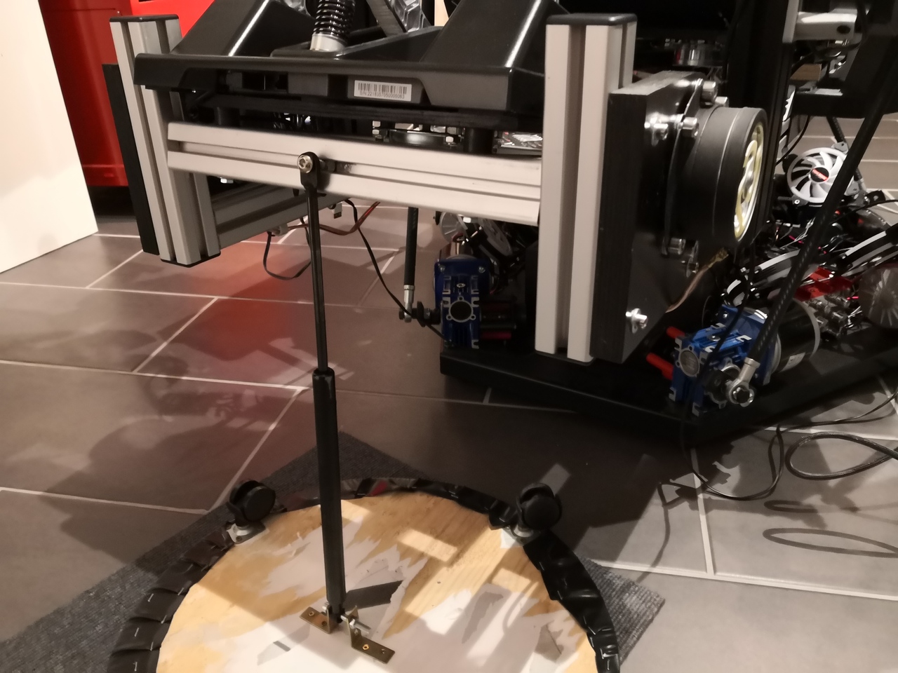

    experimental Gas Strut to eliminiate the heavy front weight:
    the wood circle thing just laying around so i used it as test base :D will be changed to something other
    the gas strut is from my old cars trunk hood ;D
    i tried it because the front motors getting very hot due to hard load and with this it is totally fine ! and i didnt notice any negative impact, smoothing or something like that ... its very well balanced like this. i can raise and lower the front part with 1 finger and it stays in position

    i have many bass shakers on it. 1 for each wheel, 2 on the seat and 1 on the pedal unit which emulates ABS and breaking events. i think theres no need to attach it directly to the breaking pedal. but thanks for the offer!

    some updates, i moved to my new gaming room with it and redo some cable managment, make cover plates for the electronics, new gas spring holder for the heavy front. pictures will follow :)
    i think i didnt post the installed belt tentioner ?!
    Planned: redo the car Cockpit with some dashboard cover and make it interchangeable for a flight sim yoke.

    1,210Coins
    +72 / 0 / -0

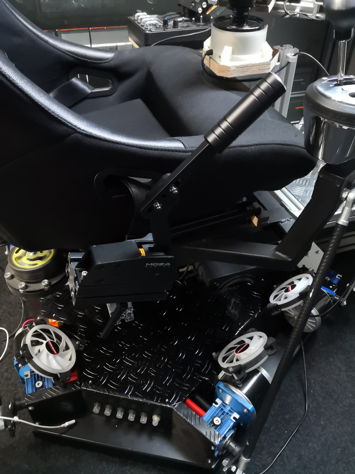

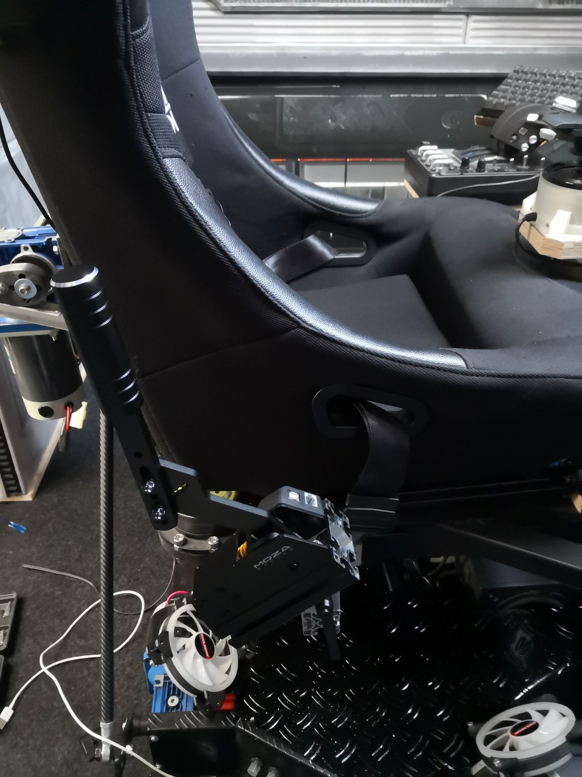

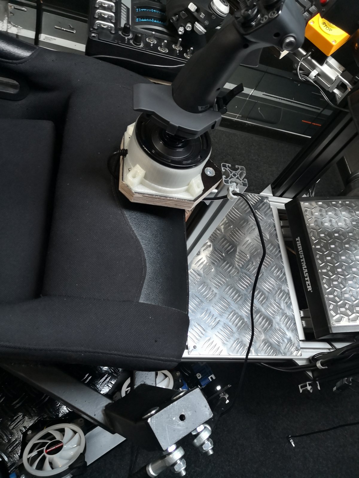

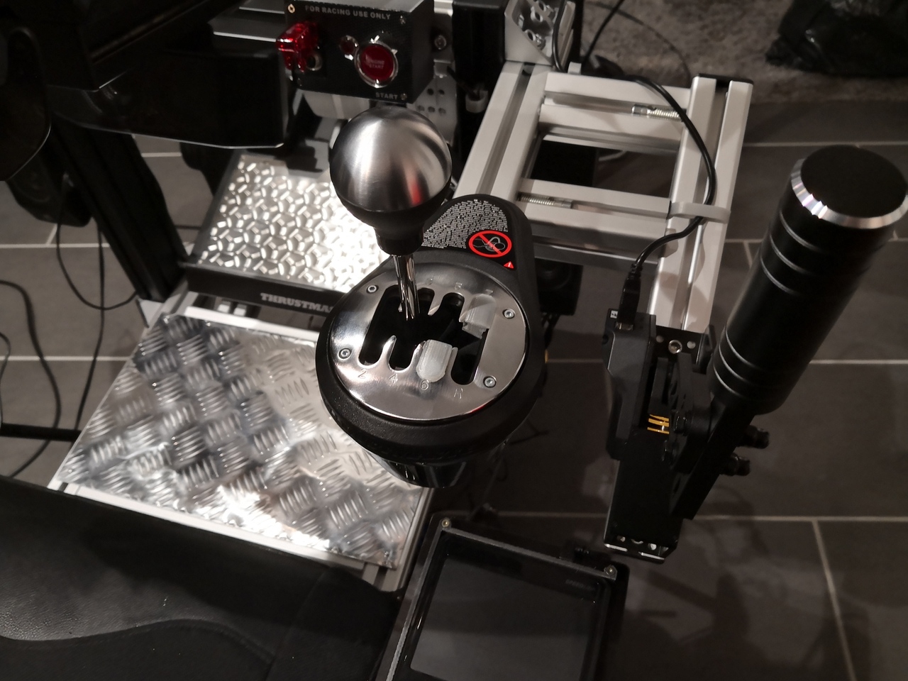

    Another Update. I 3d print a smaller housing for the logitech x56 Stick. So i can place it in the middle or the right Position. I change the Position of the handbrake again to the classic position. I can tilt it backwards when i dont need it.
