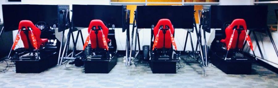

    I had an opportunity to play on some bernard units today
    Simx , SCN5, fanatec wheel , pedals and shifter. Rfactor v8s on Melbourne track. I paid my $15 for 10 mins.
    Now being a "hire" unit, I expected less than normal motion.
    Overall, yes there is a delay in motion with simcommander compared to simtools.
    As for my first actual ride on SCN5 actuators, I can confidently say that DC motors and JRKS match if not better the performance of SCN actuators and are considerably less cost.
    I thought it had a bass shaker, but they just bolted the sub box to the frame and turned up the bass which worked well in fooling me to think there was a bass shaker.

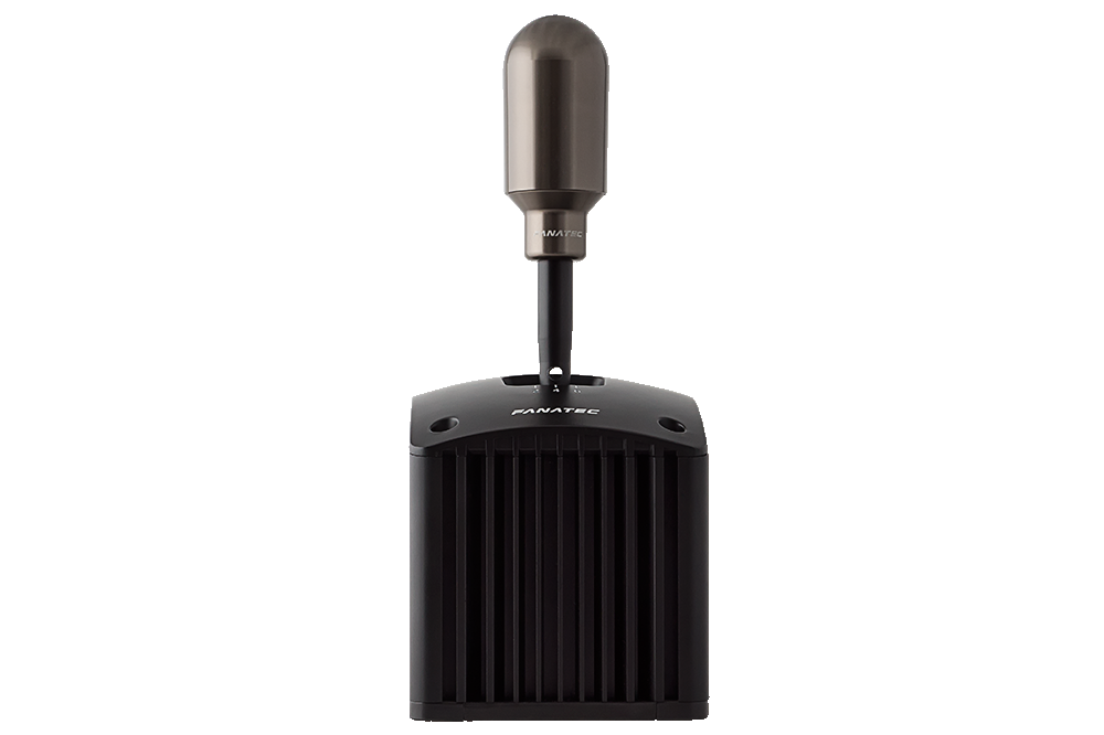

    The shifter clubsport SQ is very good though. $229 AU price.
    Considering I have my own DIY sequential shifter, the sequential setting on this was excellent. Firm and just the right amount of throw.
    A good shifter for the price for sure. But I will stick to mine.
    Thats my review on simx units. I suggested to the owner about simtools, I directed him to the site and told him to register.
    He told me of the nightmare setting up simcommander. I said your setup would need an adaptor plug for the wiring and there is help on site to get simtools going. That and it supports more games than Bernards.
