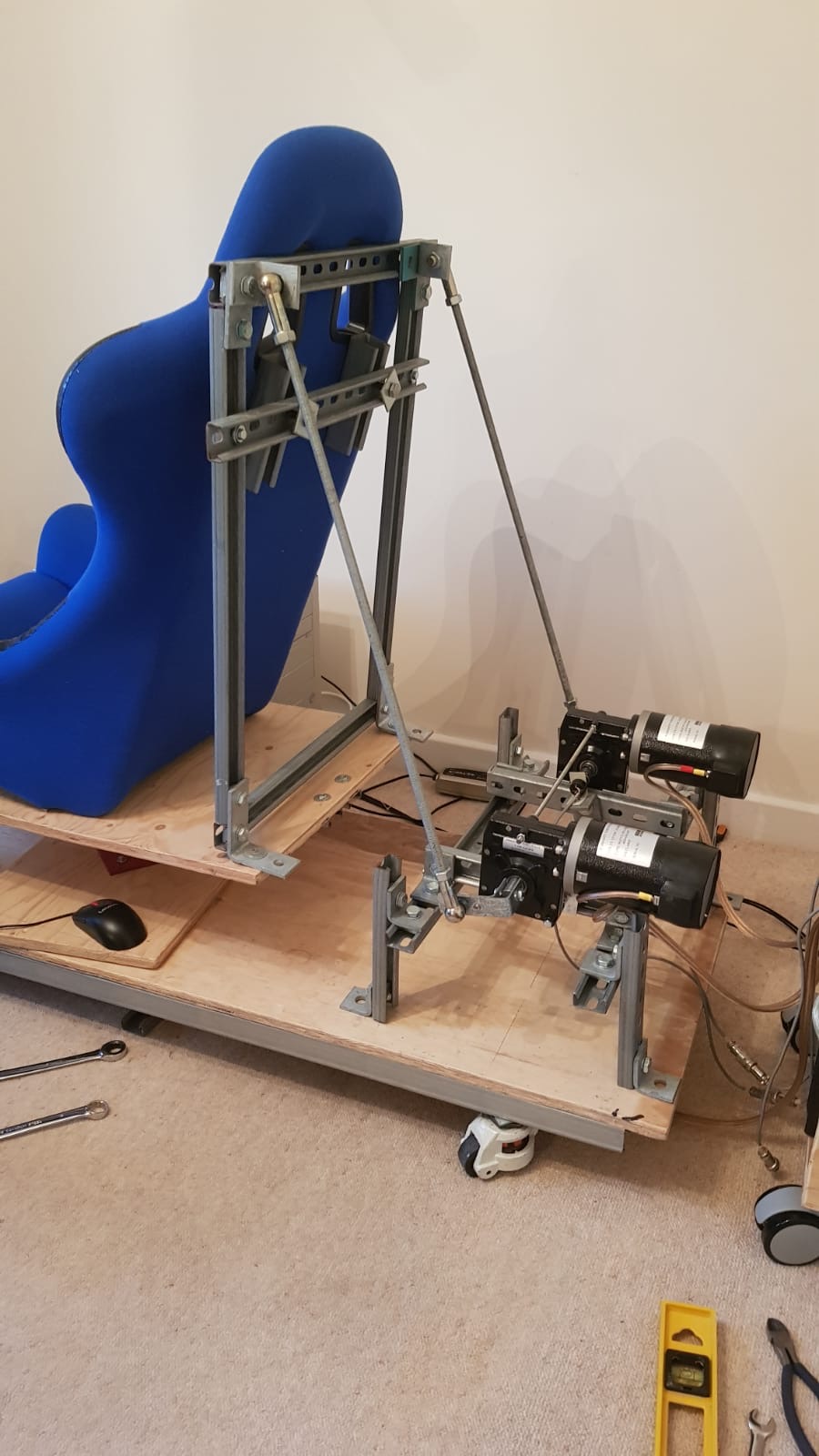

    Something else about 2 dof rigs is full frame or seat mover? Seat movers don’t need as big of motors or as low of gearing since the mass to move is lower. Full frame is generally better if you favor flight, seat mover generally for driving but there are other factors too - available space. Seat movers can be quite compact. You know your requirements and what you want to use it for. By looking through the Showcase, you can start nailing down the broad stroke design and then start homing in on what parts would be best for that.

    thats what i want to build:
    found it here on the forum

    You will find plenty of helpful information in the FAQs to get you started, in particular check out the design section: http://www.xsimulator.net/community/faq/
    You can go through existing member projects for specific ideas or inspiration: http://www.xsimulator.net/community/forums/diy-motion-simulator-projects.22/
    Or search for specific types of projects using the Google Custom Search function on the Recent page: https://www.xsimulator.net/community/find-new/posts?recent=1
    What motor you need also relates to design choices, so use SimCalc to get your head around design Vs Physics: https://www.xsimulator.net/communit...e-linear-speed-and-forces-of-your-design.270/
    Good luck with your project.
