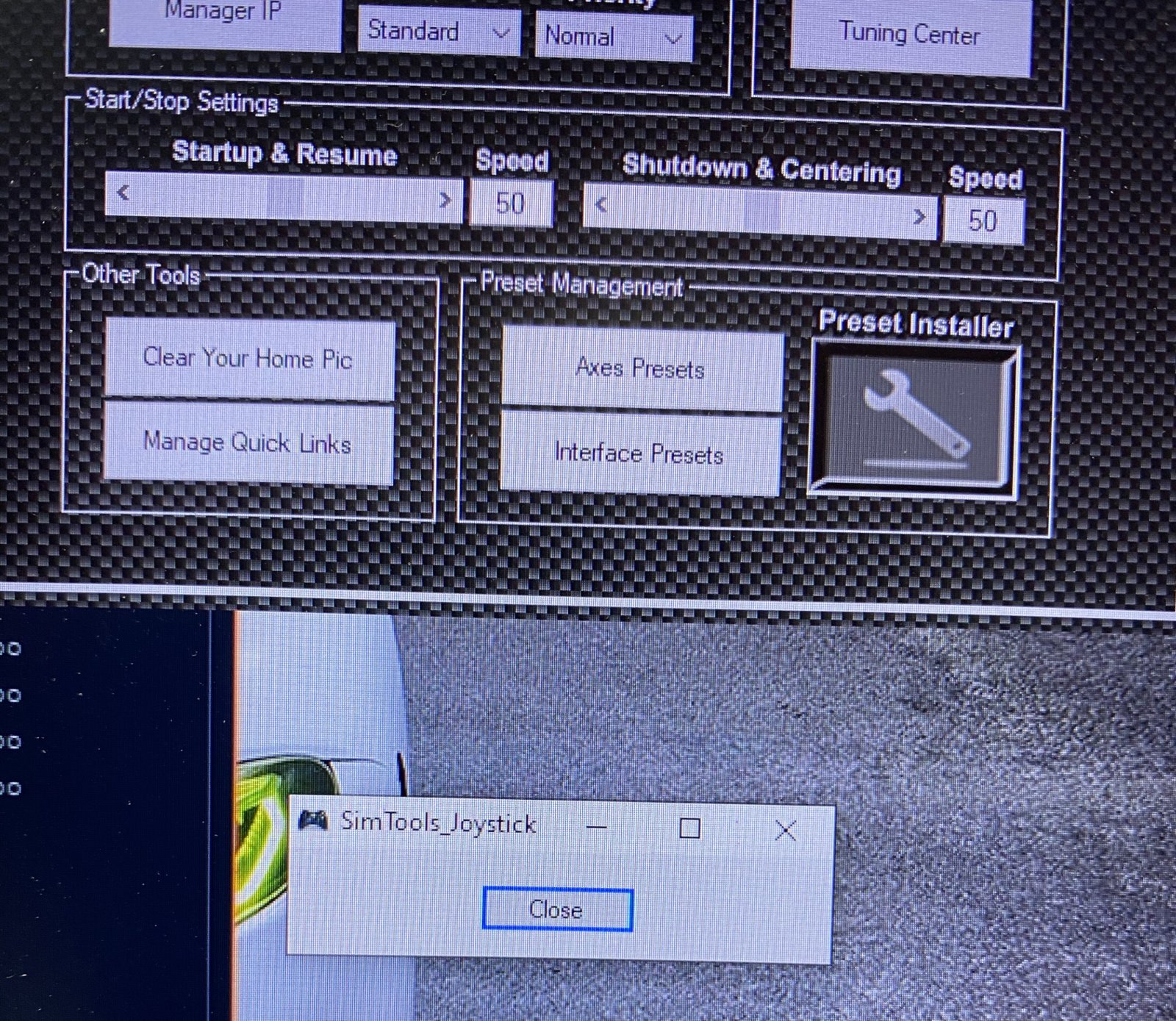

    the plugin patches fine but when I run SimTools joystick.exe I do not get a list of joysticks and my USB game pad is seemingly not recognized. Selecting Joystick in Game Manager does not initiate the actuators and moving the joysticks on the game pad do nothing.

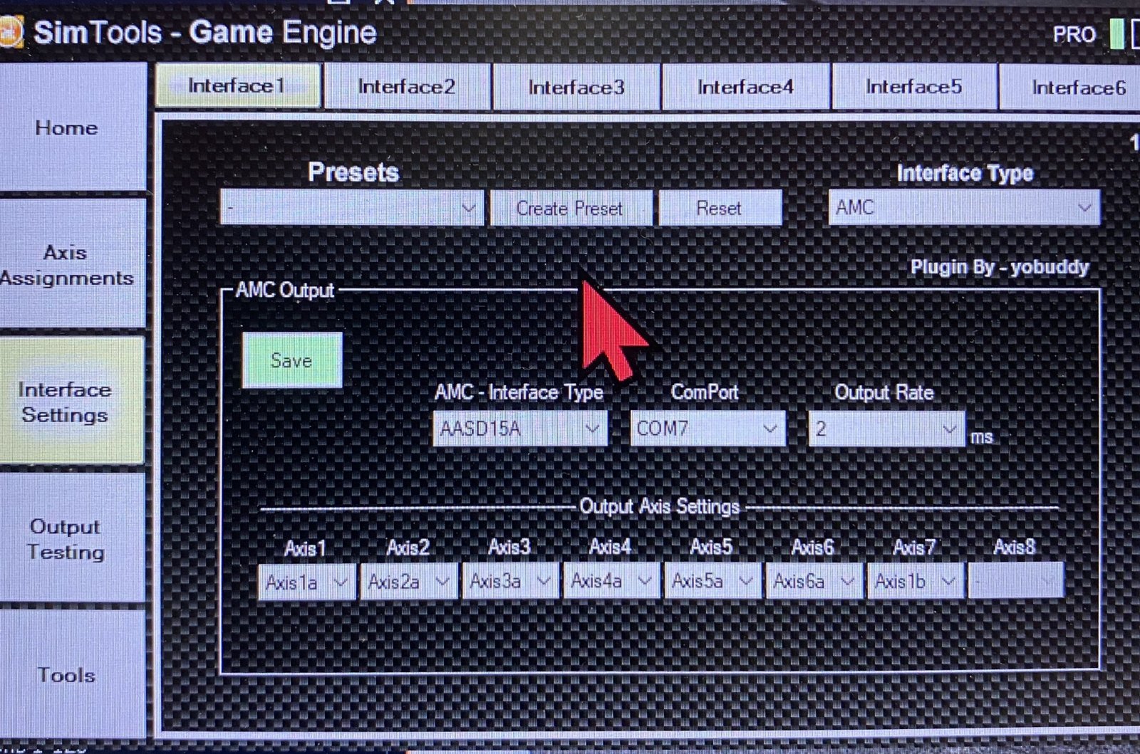

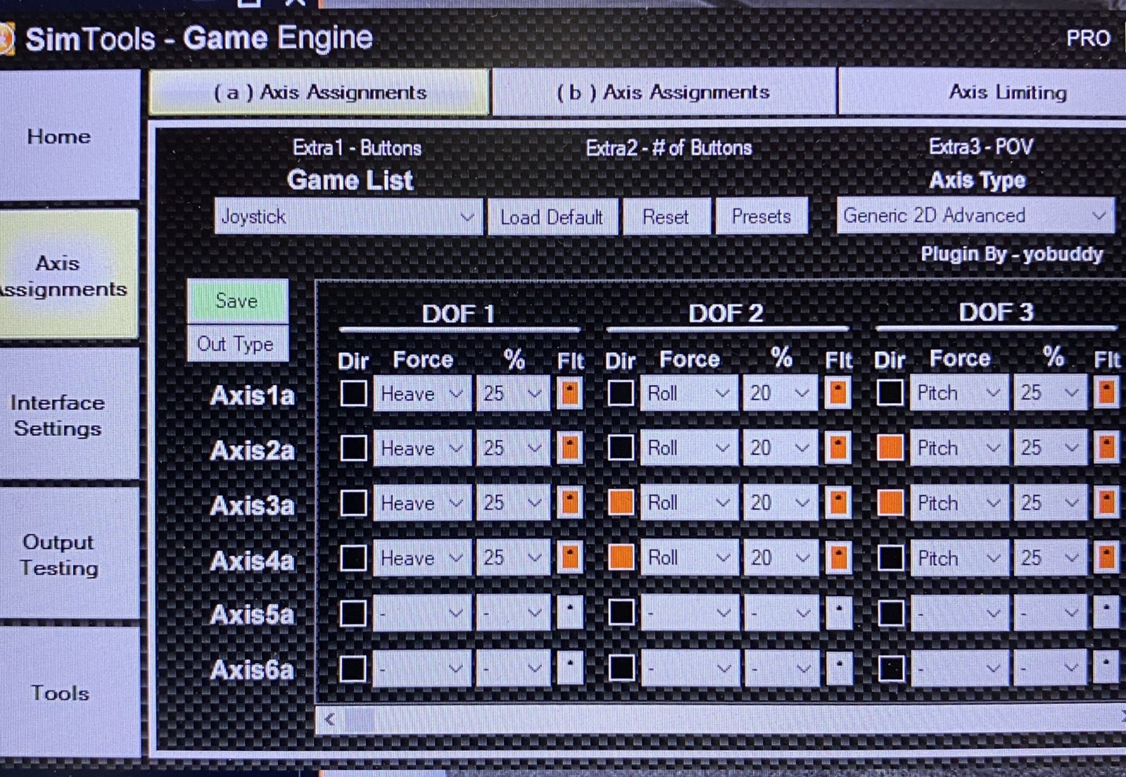

    Not sure what other setting you would want to see. When I run SimTools_joystick I get the dialog box in the middle picture.

    Can I just confirm that you followed the instructions to the letter, in particular using Admin mode for Game Manager:
    How to use:
    Run GameManager in Admin mode.
    Select the "game" Joypad.
    Patch by selecting the installation directory of SimTools.
    The patch installs a program "SimTools_Joystick.exe" and "SimTools_Joystick_Recorder.exe". These programs do nothing than trigger SimTools to read the Joystick values.
    Run GameEngine & GameEngine.
    Run SimTools_Joystick.exe or – if you want to record the data – run SimTools_Joystick_Recorder.exe.
    Play with your joystick and observe the values in TuningCenter.

    I updated to Simtools 2.5. Re-checked GM was in admin mode and tried again. Now I get the green ‘patched’ light. The actuators go to standby position when I select “Joystick” and get a list of 16 potential inputs when I run SimTool_Joystick.
    Is there a way to know which one is my gamepad? If not, do I need to select one at a time, click done, and see if it registers in Tuning?
    22,225
    154,819Coins
    +11,226 / 57 / -2
    You likely want to follow @MarkusB's setup guide for multiple controllers: https://www.xsimulator.net/community/faq/feeding-multiple-controllers-into-the-joystick-plugin.378/

    Yes, trying them one by one seems to be the only way. At least this is how I do it: I select an entry, click done, move the controller handles, and check if this movement changes the Tuning Center values. If it was the wrong controller entry, I close the plugin, restart it, and try the next entry.

    It works! I need to have the Gamemanager window ‘clicked’ for the rig to move but it does work. Is it normal to need gamemanager window active?
