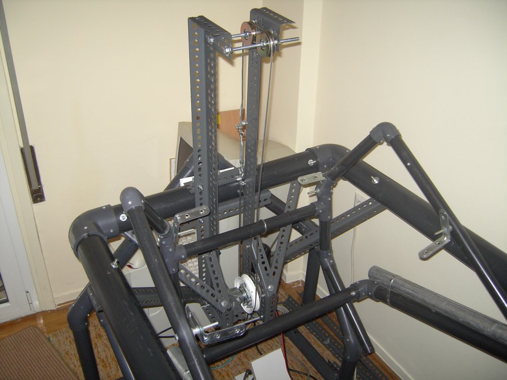

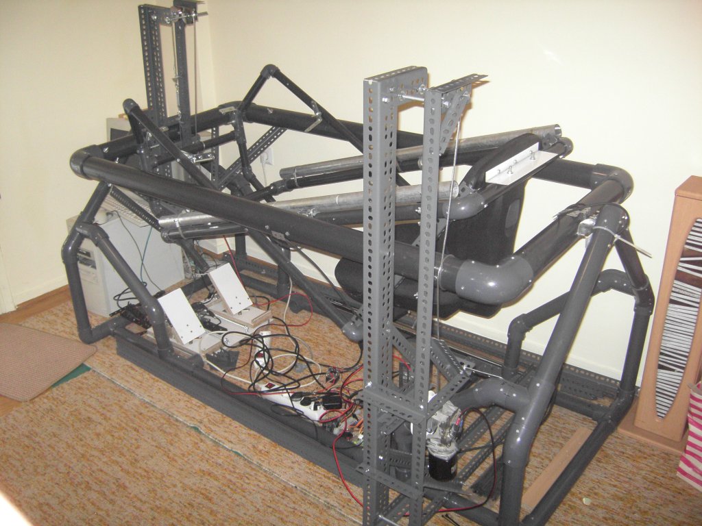

    The pulley - cable system thanos used allows more travel with less actual overall force
    Found the photo I was looking for
    a pulley system with cables attached to the frame is how he did it.
    The pushrod link doesnt work that you sent. However, a push rod on the corner of the frame will work well.
    either set up will depend on what size motors you plan to use, actual overall travel, what the frame will be used for , flight and or race.

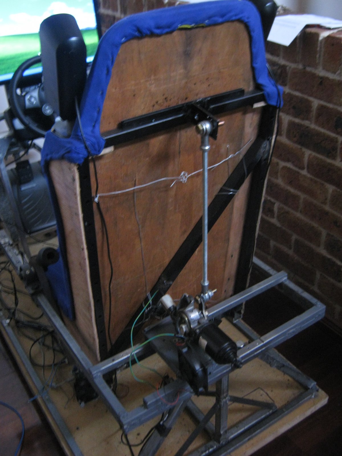

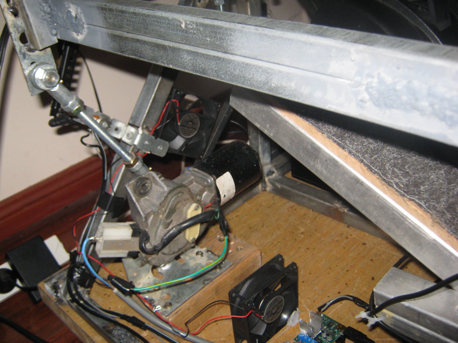

    Pushrods will work and if you use wipers, you really best use best point of leverage to get the best reaction in motion.
    Refresh my memory, was the sim for flight or race?
    Also, I have done wipers and pushrods on a joyrider
    I put them on best point of leverage, being on the corner of the roll frame and at the back on my head at the pitch frame.
    Granted I only used the standard lever on the wiper, 40mm ctc I think it was.
    It moved just fine.
