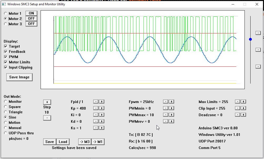

    Also, motor 2, its not working at all!!!!

    Motor 2 results

    i donno much about your configuration but at first look you have wrong numbers
    in the SMC3Utilitis.IMO for example first you have to try PWMmax between 150 & 255,
    MAXlimit and Clipinput to 0 with care!others seems OK for now,

    @noorbeast
    Sorry i had a wrong connetion, inverted the feedback. Let me correct and let you know. Thanks
