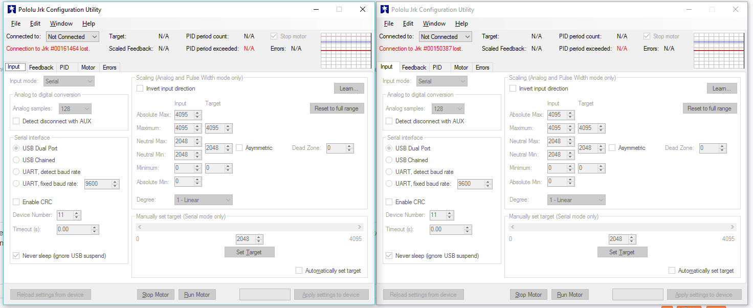

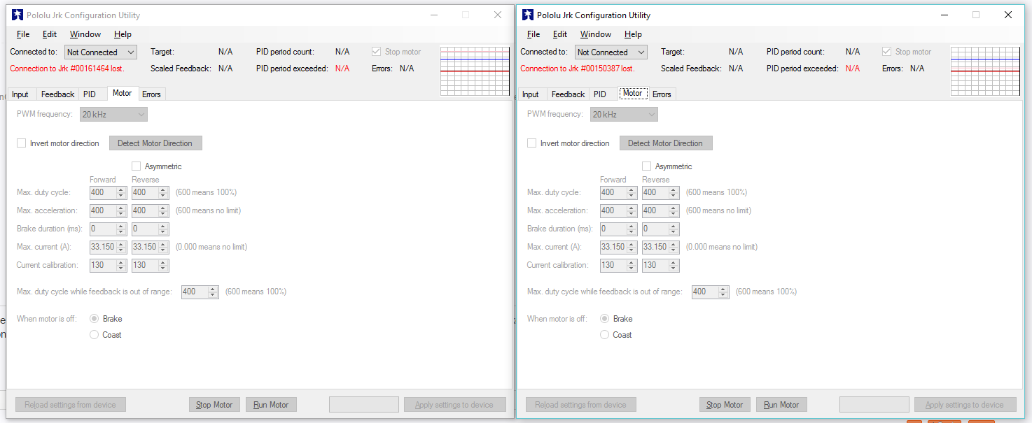

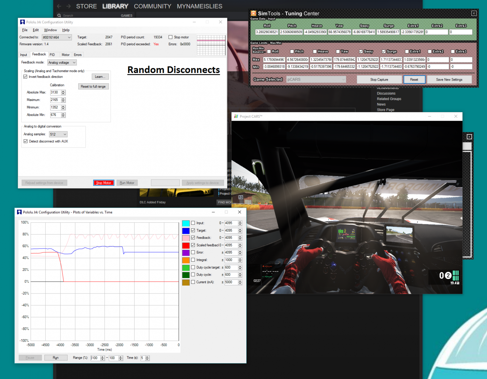

    1. The left JRK will start getting a repeating disconnect until I pull the seat back into position. I grabbed a screenshot while that was happening. It's the one that spikes at 80%. I haven't figured out how to repeat this problem, right now it is random.
    2. Losing power on heavy breaking. This is a repeatable problem and I've attached a screen shot from right after the power loss.
    Here are screen shots of my config.
    21,523
    150,758Coins
    +11,019 / 55 / -2
    In the JRK config your PID Period should be 20, which will stop you getting the constant 'PID period exceeded: Yes' error messages.
    If the disconnects are in big hits try lowering the Main Level % to something like 97% in the Profile Editor of Game Manager.
    PSUs and USB cables are other possible culprits.

    Thanks @noorbeast. The Main Level % definitely helped. I've had my best lap around Spa so far with the only disconnect coming at the bus stop.
    I can pretty consistently cause a disconnect on a hard breaking left and for the heck of it I tried a hard right in reverse and got a disconnect on that as well.
    21,523
    150,758Coins
    +11,019 / 55 / -2
    You may need to tone down your jrk pid and motor settings a little more.
    Another thing that can help is to get some clip on Ferrite ring cores for all major cables, they are pretty cheap and will help eliminate interference issues.
